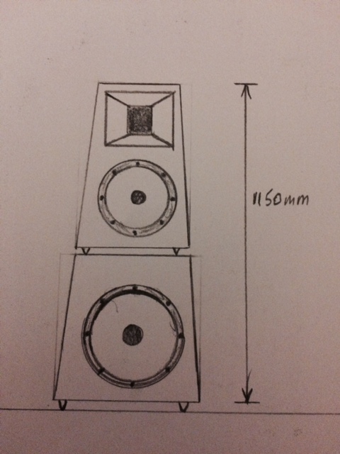

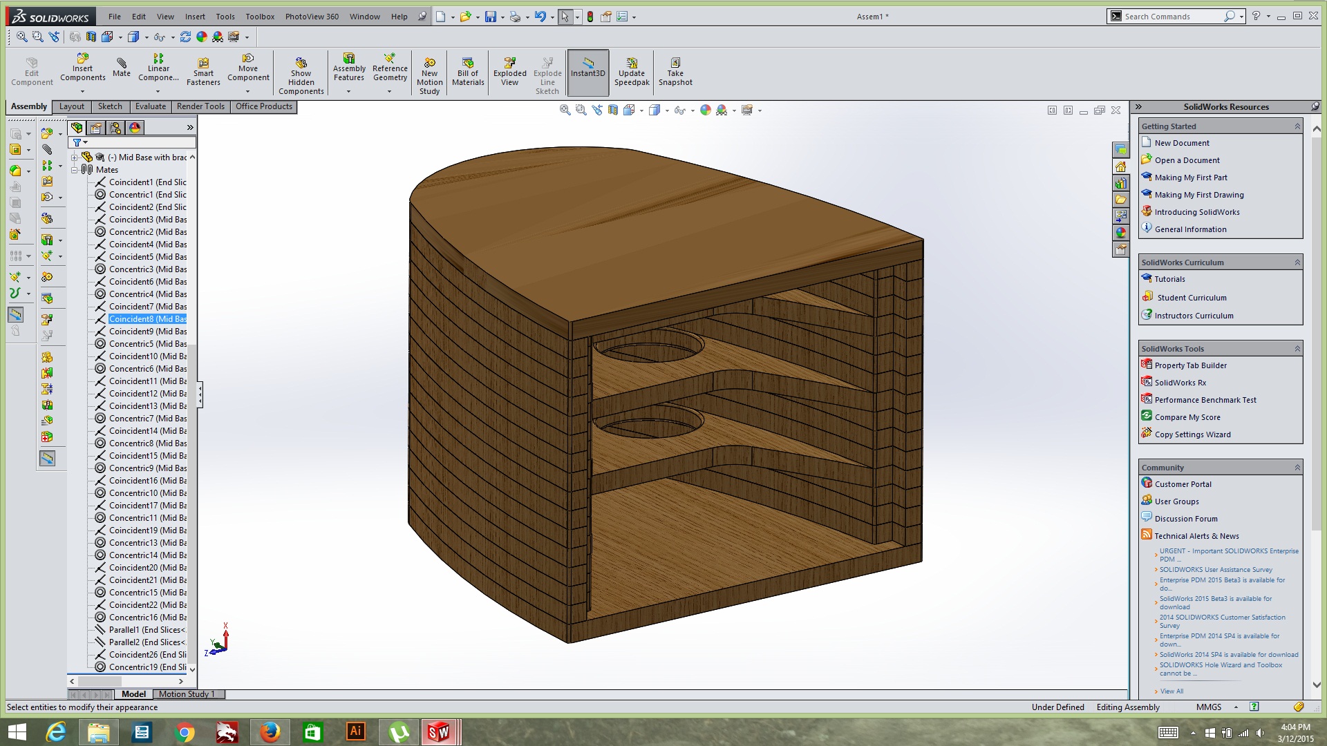

Bass – 560mm x 560mm x 500mm deep, sealed. Birch ply construction with uber bracing. I'm yet to finalise the shape of the bass unit, with one drawing showing the angled sides with matching CNC'd ply curved add ons.

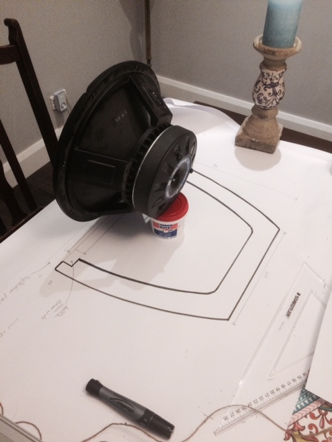

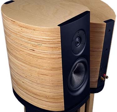

Mid bass – lovely curved CNC’d layers of Birch Ply....similar to Magico S2. The attached pic shows the to-scale drawing showing a 12-inch driver...this was helpful to test measurements.
Tweeter – simple L shape stand to start with to get the location/alignment sorted.

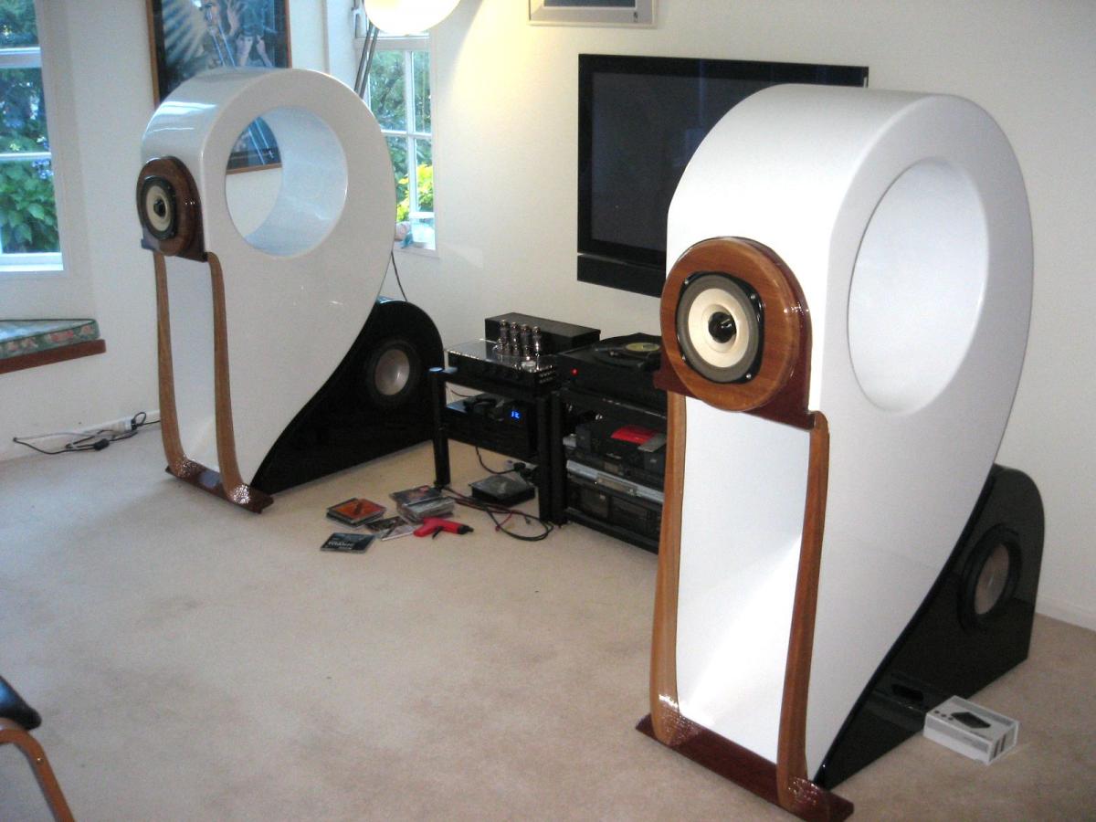

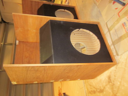

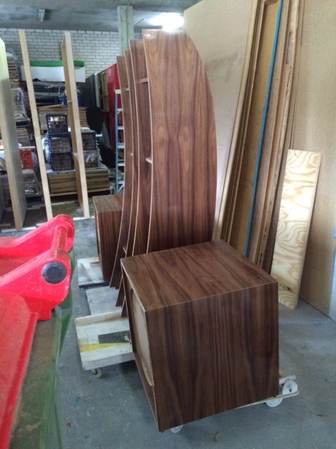

Um, not sure. I have access to a new pair of 1030's from the FP importer here in Sydney. Also, I used them before in a Cessaro/clone project I did. See pics of the woodwork for it.

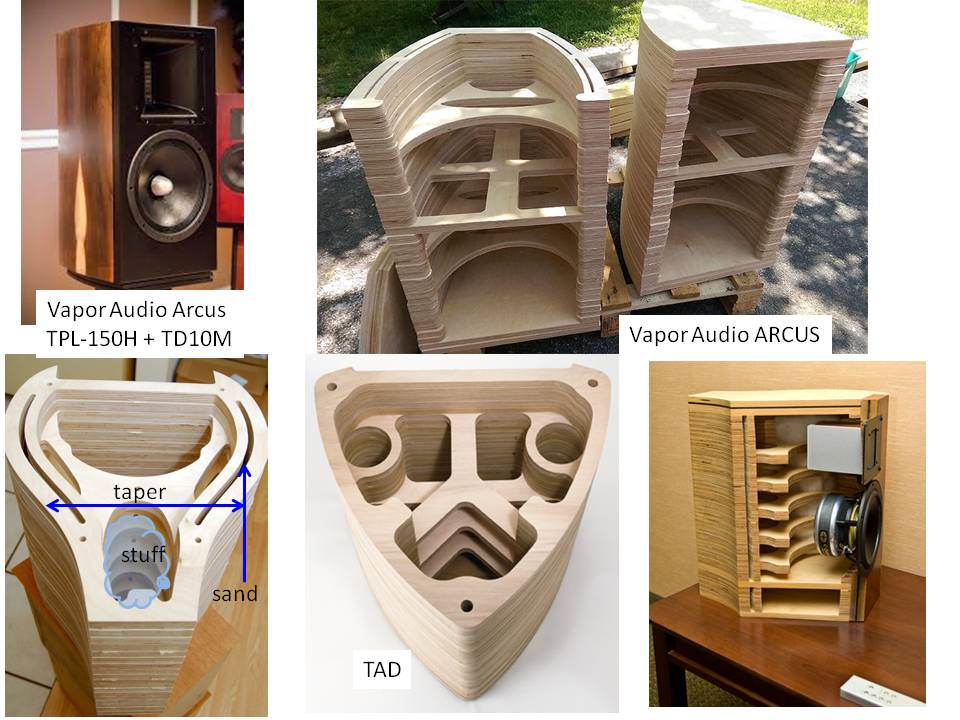

Companies like Vapor Audio have amortized the high cost of translam cabinets by designing-in a rich set of features:
--super-duper strength from thick multi-ply walls;
--large radius edges for reduced diffraction;

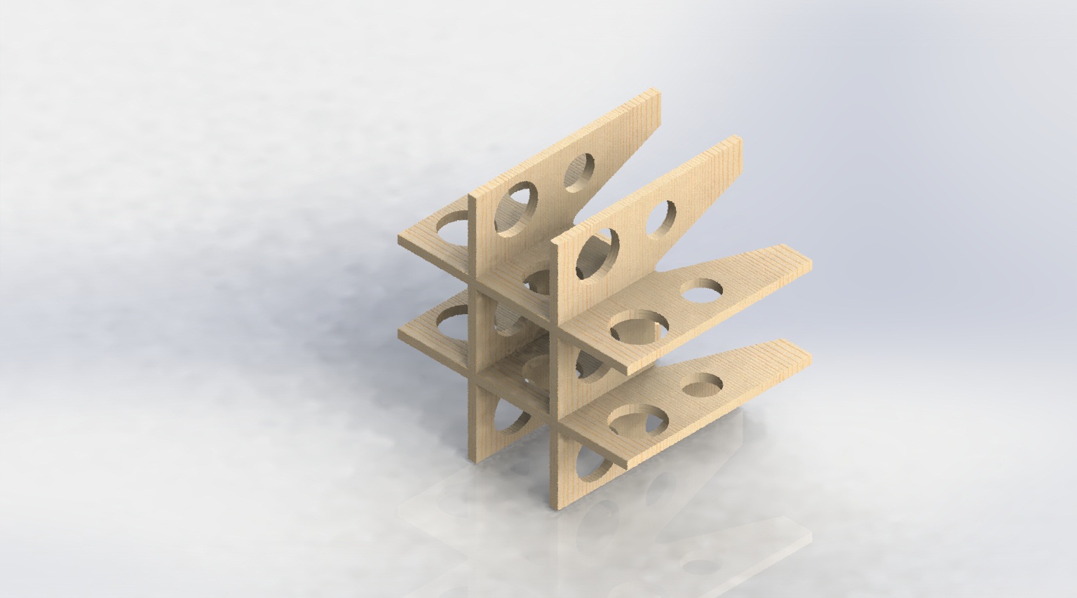

--tapered tube rear volumes for reduced resonances without execssive stuffing;
--internal odd-shape bracing to reduce both panel and volume resonances;
--slots for sand dampening;
--sexy curves
--naked birch ply laminates are "high-tech chic", you may be able to save finishing time and money
---->IF YOU CAN AFFORD TRANSLAM....the forum brain trust can help you add a clever SET of design details.

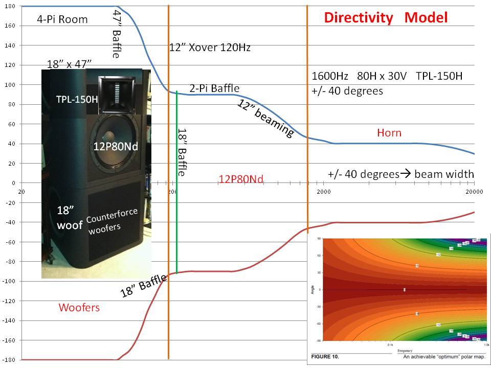

Controlled Directivity is a popular design goal. 80H x 30V horn polars --> 180 polar cabinet --> 360 polar room. You can download a free room simulation program to select the best locations and equalization requirements. Room modes often affect 200Hz and below, and the cabinet height/width can be selected for smooth room integration.

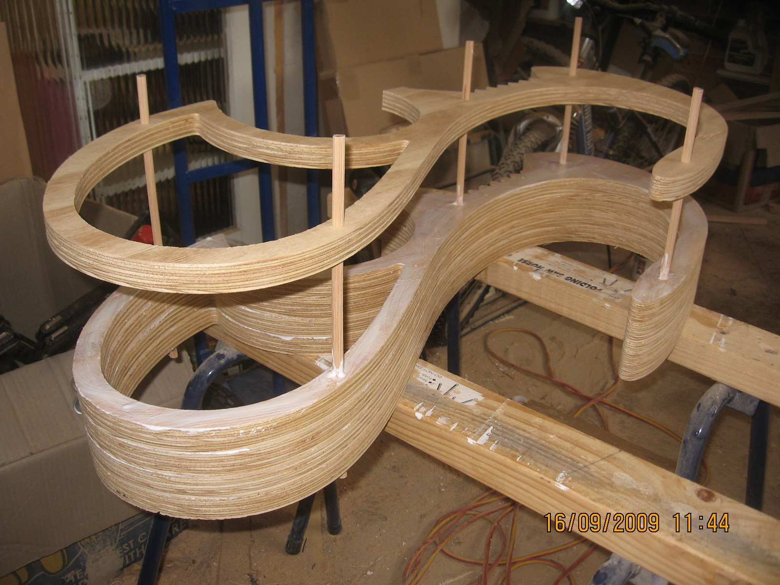

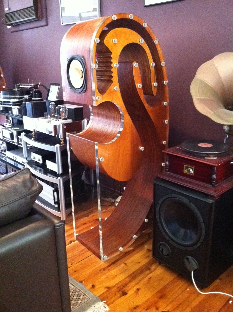

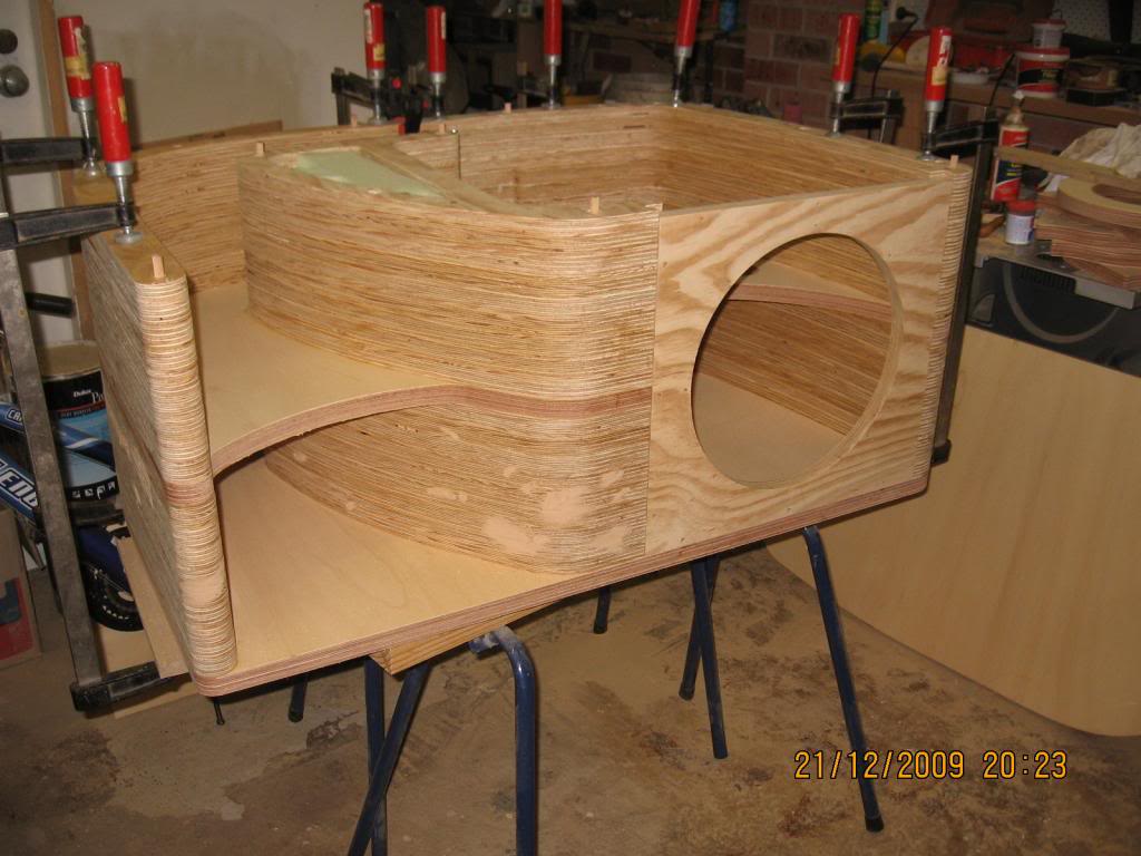

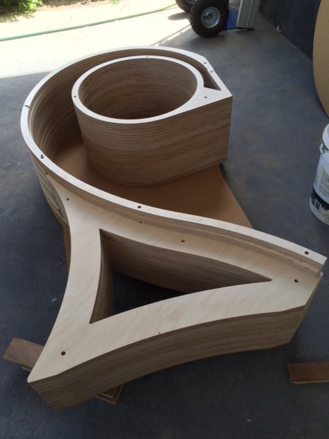

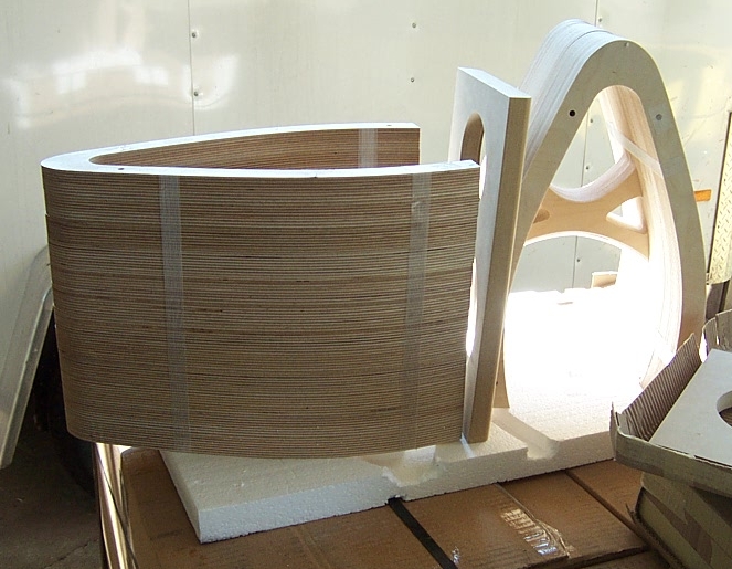

I've already done a fair bit with CNC and ply, including my own Lowther C-Horn design, GOTO bass horns, and Yuichi/TAD. Plus I use this approach using MDF slices for Tannoy and other horns.
