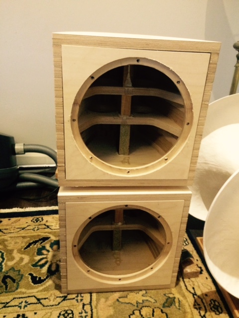

Hi Lewinsky,
Yes he Beyma 10G40 is a really nice driver, I suggest a total cabinet volume of 18 litres will give you a 0.707 Q.
I get the simulated Vb to be 10.7 litres.
Add 2.7 litres to allow for the air volume which the driver will displace when front mounted on an 18mm thick baffle.
Then add approx 5 litres for internal cabinet wall dampening ie I usually line the inside of the cabinet with 9mm of bitumen or self adhesive underfloor insulation material.
If you are using twin Beyma's per side I suggest two separate 18 litre cabinets, not one shared 36 litre cabinet.
A pair of these will be fantastic covering the 80Hz to 1,000Hz.
Even without a sub, they will have superb bass, -3dB @ approx 35Hz and still good output at 25Hz.
This assumes you want to be able to reach a MAX or 105dB continuous SPL with 110dB peaks @ 1 meter. Your room / ears / neighbours may vary!
Adding a good sealed box sub will obviously give even more bass, but more importantly it will free up the 10G40 drivers from all the heavy lifting and extended cone travel required to reproduce bass.....
In otherwords the biggest improvement when you add a sub is better midrange!!
Hope this helps and all the best.
Derek.

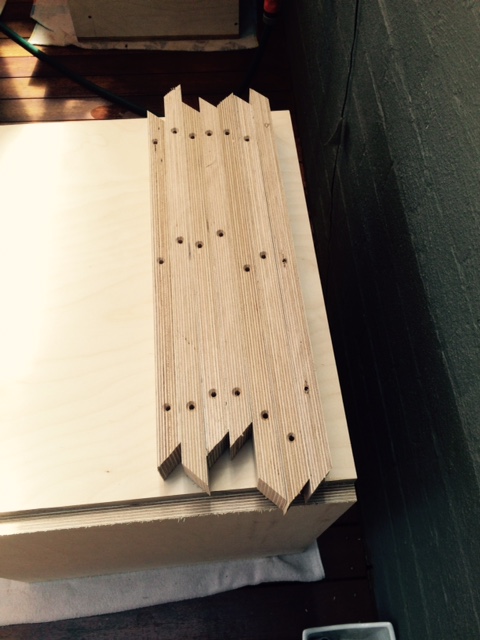

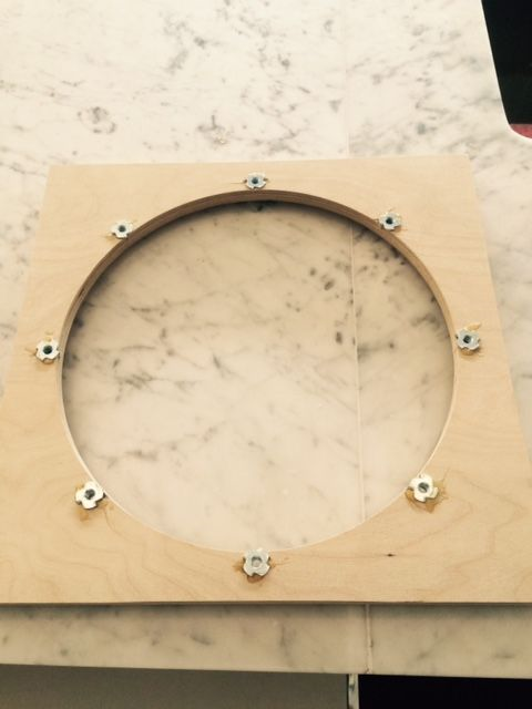

Today I:
Trimmed the mid bass baffles.
Glued in the T-nuts for the midd bass drivers.
Added the vertical braces to the mid bass.
Cut the plinths for the bass using one inch Birch Ply, mitred, screw holes frilled, counter-sunk drilled.
Pic of dry fit only, ignore odd angles.
