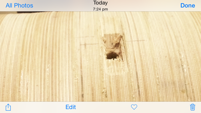

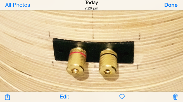

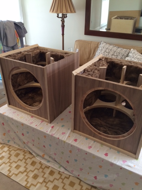

Solid core cables used, 4 strands for bass, while I used 2 strands for mid bass and tweeter.
What kind of cables are you using? Enameled copper wire used for electric motors, transformers, etc? Gauge?

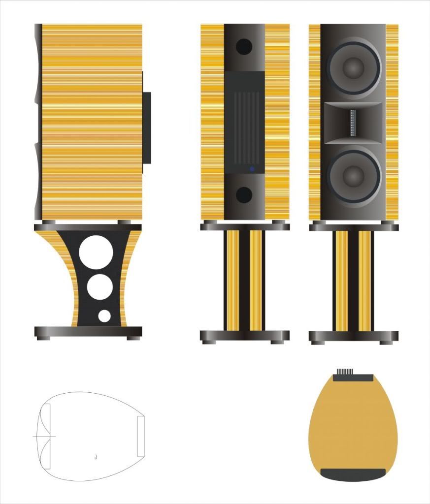

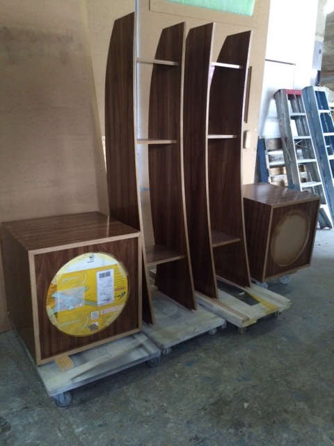

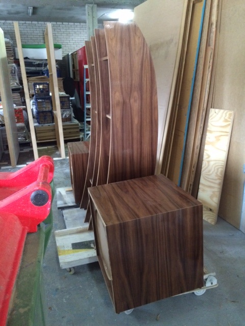

great project. I love the Magico designs. the curved front pannels look beautyful. The looking and finish is key for their success. The looks of the TPl150 wave guide sucks. Imagine a wave guide made with a cnc router, and a 12p80nd in a separate modul with a magico-alike front pannel with the gorgeous curving, and cnc cabinet like the magico mini, and sub moduls. That would be world class performance, combined with world class design. Offer it at a reasonable price, and enough pr and show going, and commercial success will be garanteed. If i'd live in the u.s. australia, or europe, i would maybe try such a venture.

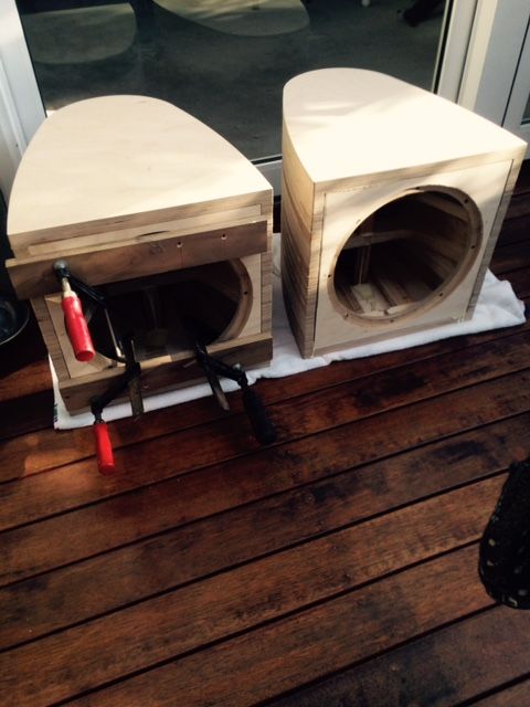

Thanks Angelo, I've long admired your work. I've been building speakers for 15 years, and watch your projects with interest. If visiting Oz, happy to host you.

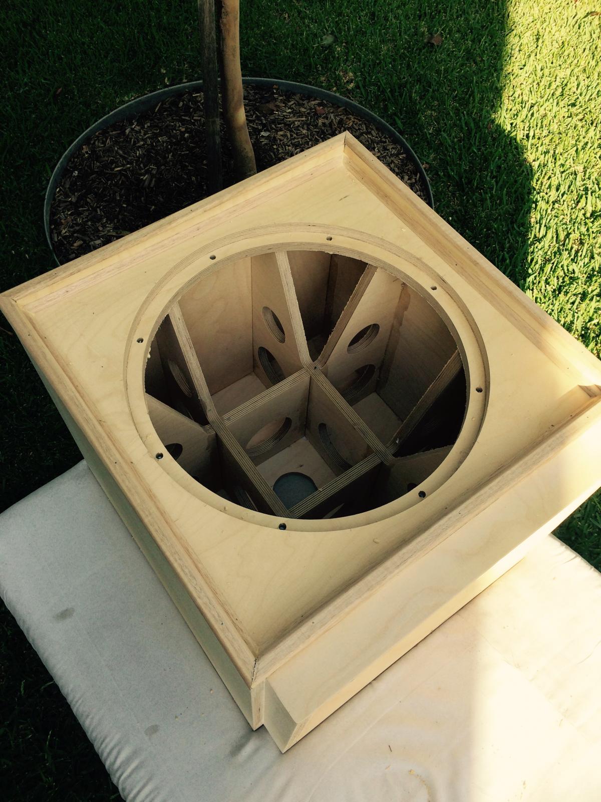

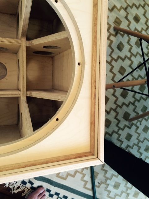

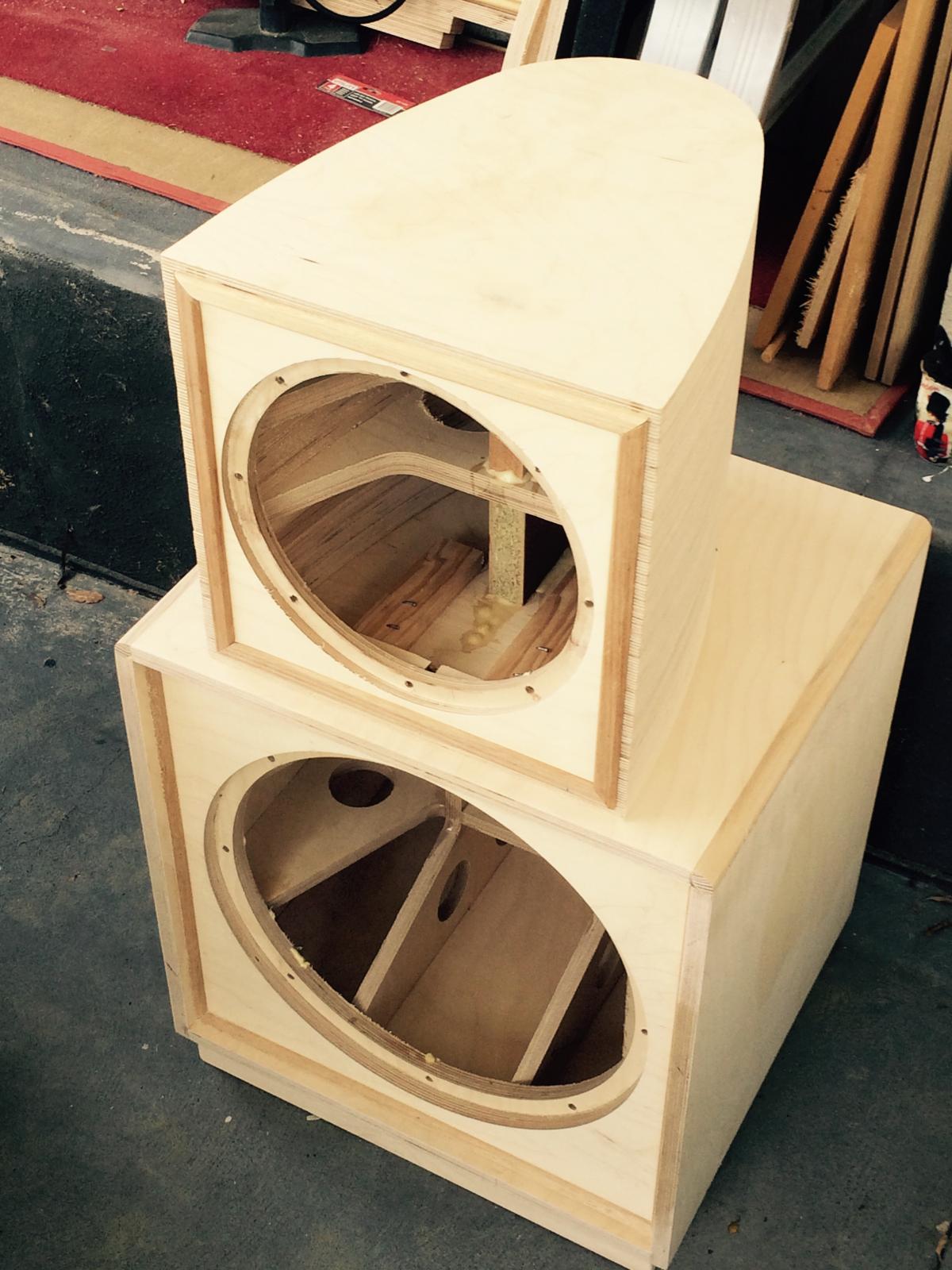

We debated custom Birch horn for tweeter, but for now, I'll build curved housing like the mid bass.
Today I spent 5 hours with putty and sanding.

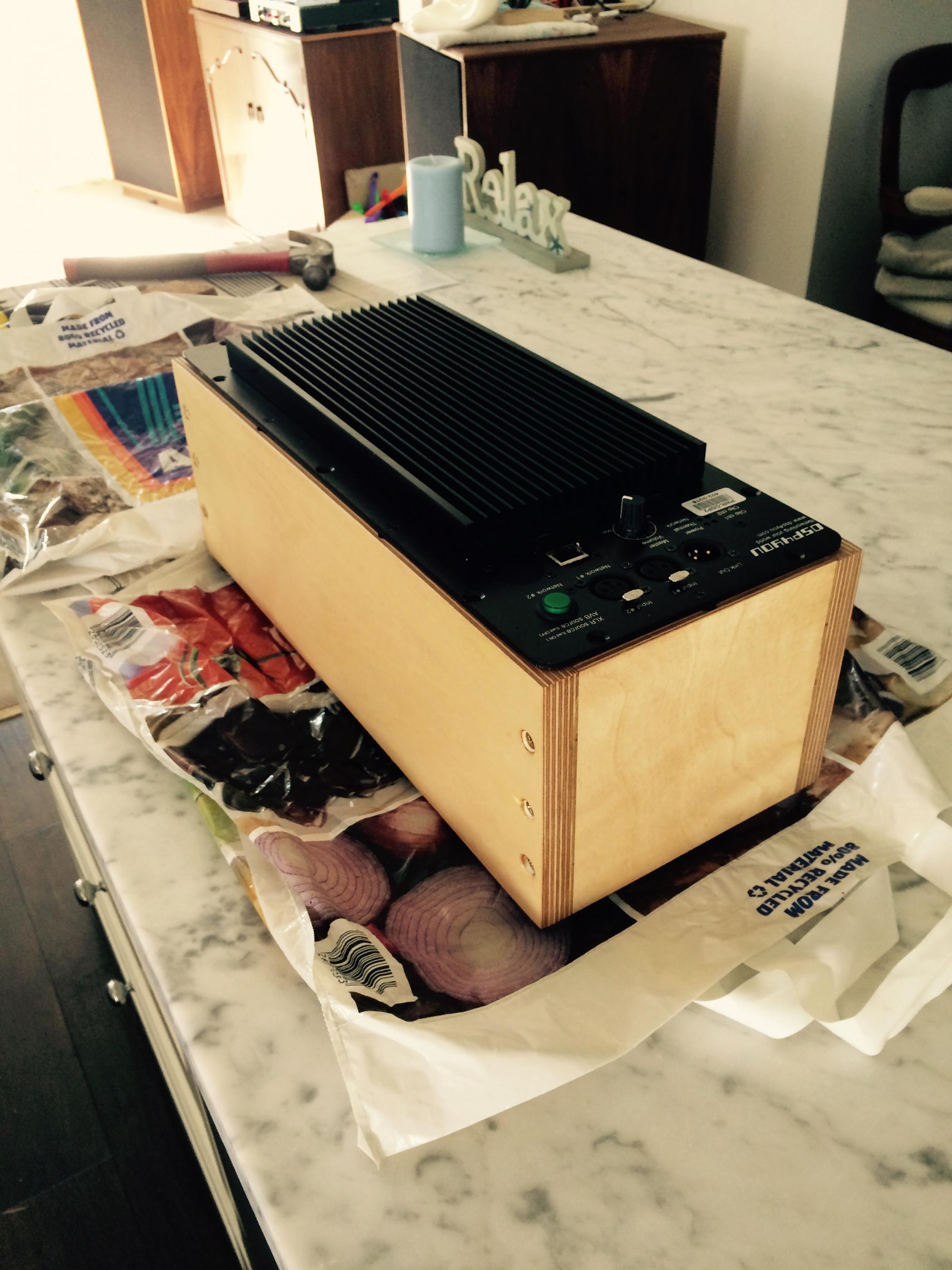

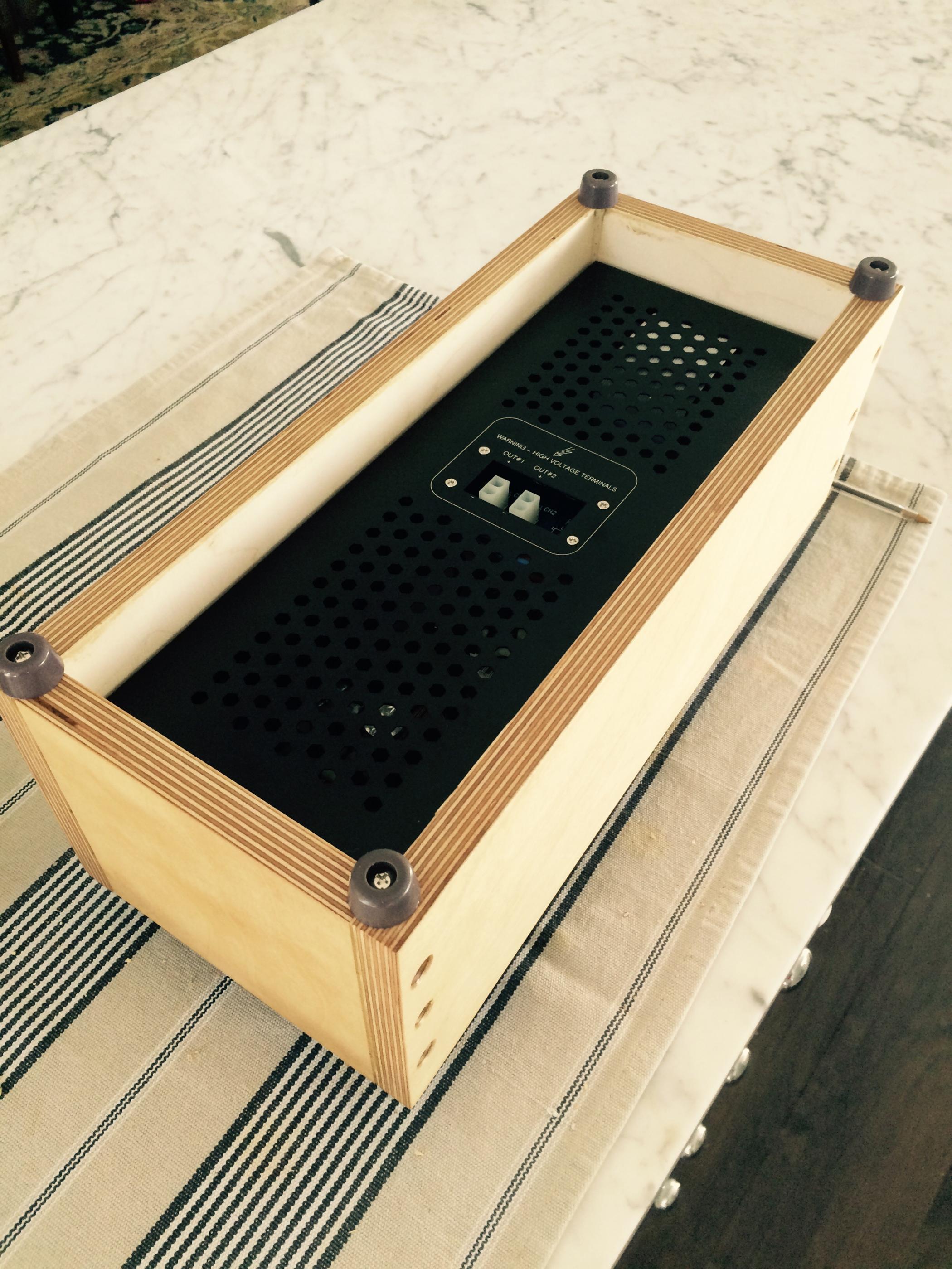

I'm quite interested to read your thoughts on the MiniDSP dsp/amps in the completed system. I also like how you put it in a simple birch ply box. Makes it look much more fitting in the overall system, IMO.
Great progress as usual sir.
Thank you for your kind remarks.
Shortly, I'll be able to provide some feedback on the individual components. I have already tested the Beyma tweeter/horn.
In regards to MiniDSP, I have used the 2x4 and 4x10 products. Also, my technical support is provided by the principal of Redefy Audio, Henry, who is very experienced in MiniDSP applications. Henry will be setting up the bass module plus building the passive components for the mid and tweeter.
