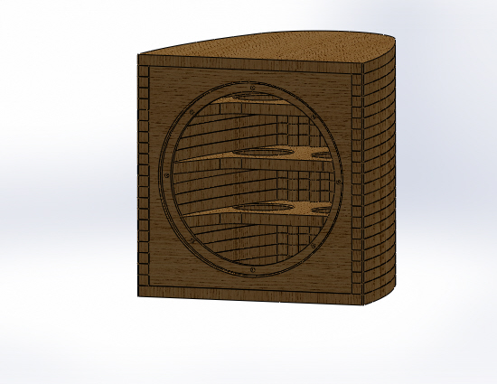

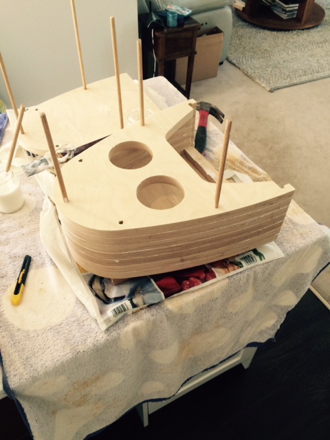

Mid bass CAD and bass unit CAD underway.
Looks very similar to the Vapor Audio Arcus translam design for the TPL-150H + Lambda TD10M.
Do you have other 3D-CAD which pushes translam technology farther?
Large radius on sides+top front edges to reduce diffraction.
Rear exponential taper'ed volume behind the M to remove internal resonances.
Reduced vibration.... slots for sand? baffle isolation? Magnet Support?

No, not really. But will hone the design as I go. I don't want to copy others, I'm my own designer. Already, the units will be over engineered, with the thick Birch Ply.
What do you mean by these and how are they beneficia?

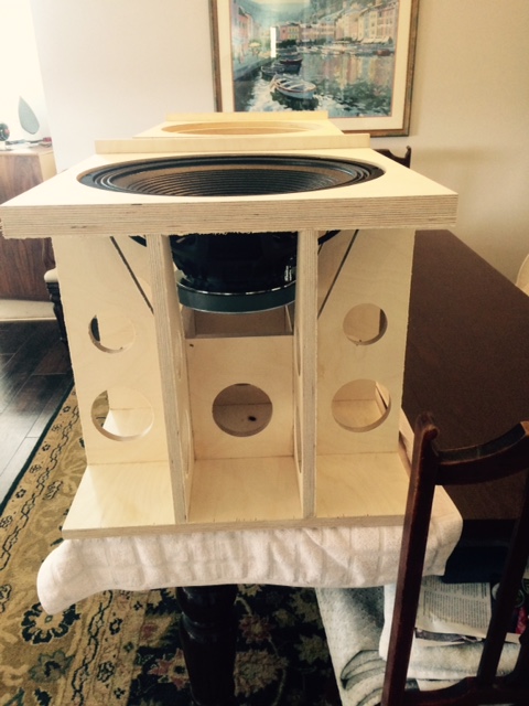

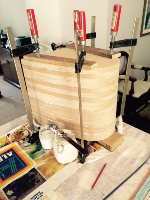

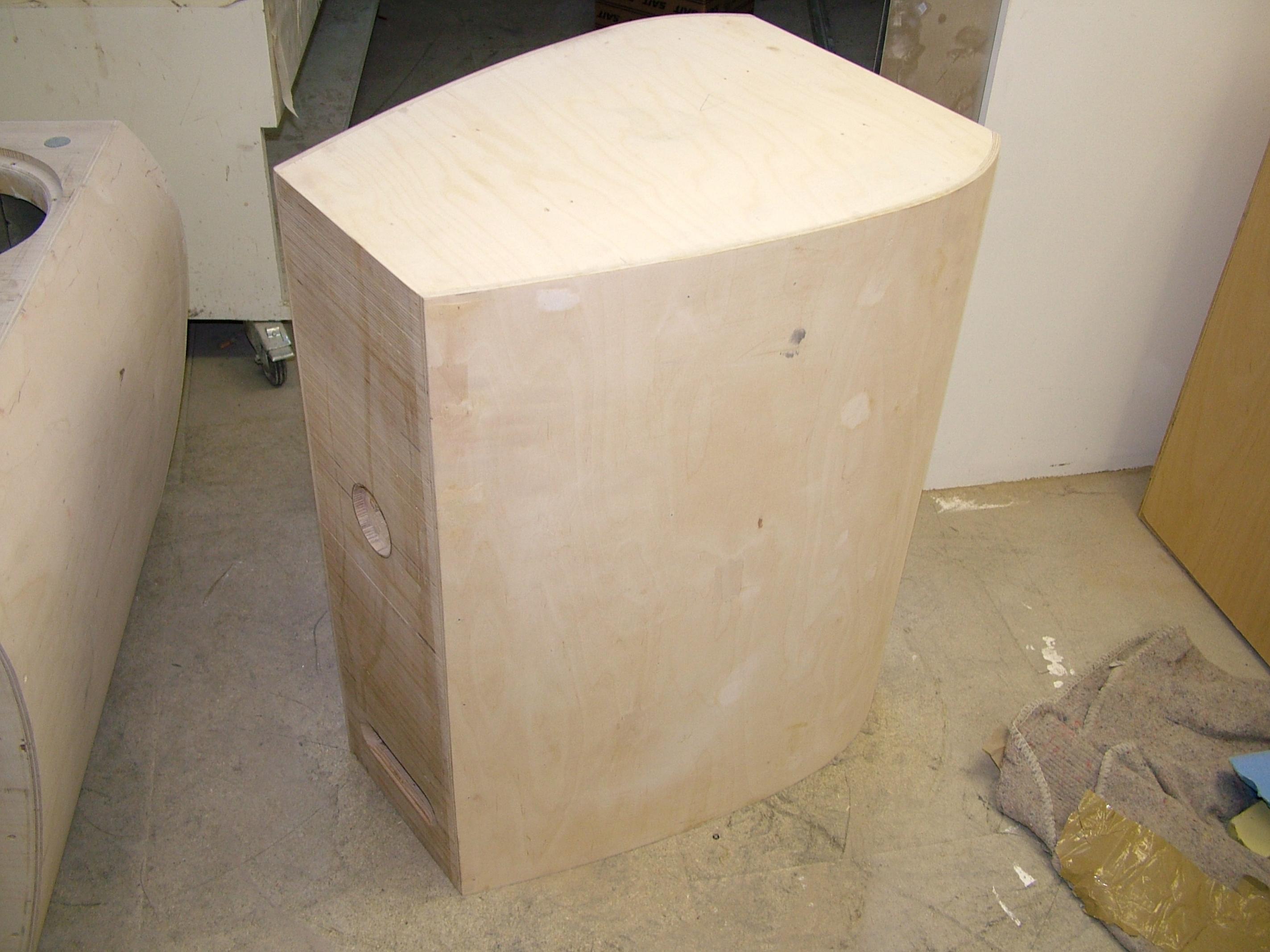

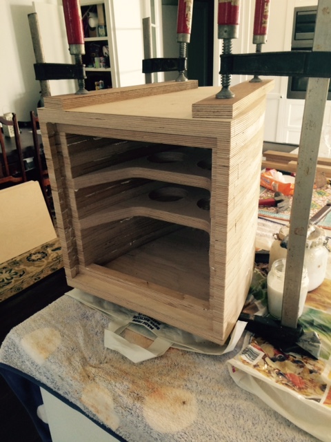

Birch plywood vertical stack cabinet construction
Stacking Birch plywood is a great way to build non resonant beautiful looking cabinets, but be prepared for extra costs if you want a high end paint or veneer finish....I had to clad mine in curved ply to avoid the joins showing through the painted sides.
Nowadays its popular to just leave the raw stack construction visible so its much cheaper....just sanding and varnish and your good to go.

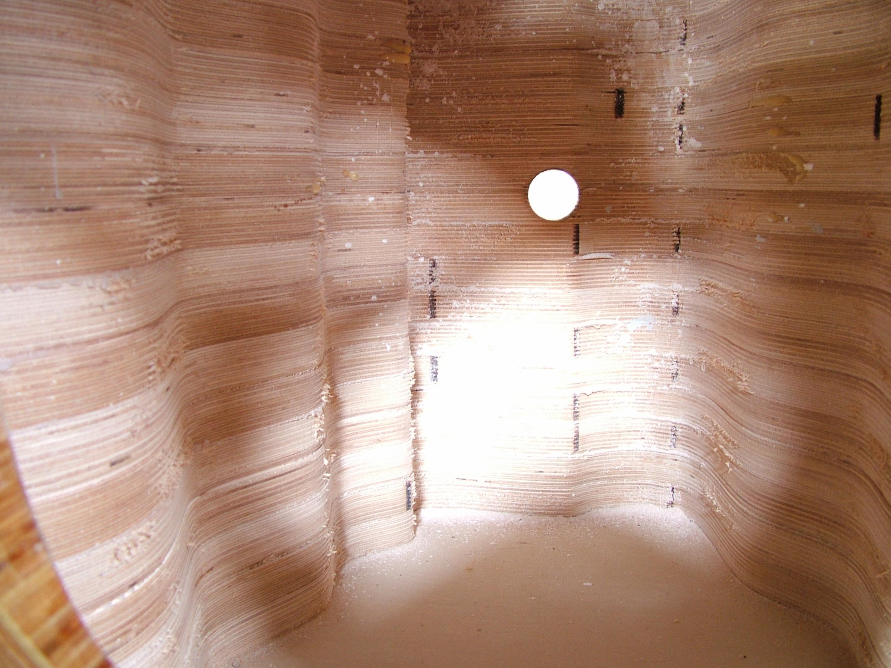

I cant tell from your render, but its good to make the interior curved / wavy asymmetric / to help break up internal reflections and standing waves.
Good luck and hope your customer appreciates all your hard work!
Cheers
Derek.

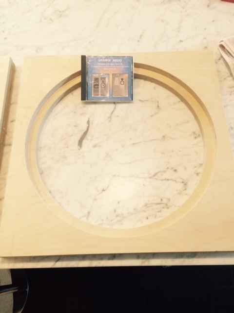

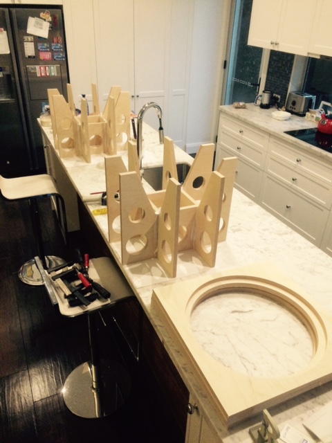

Baffle made in CAD....buying the ply shortly.

I'll keep the ply exposed.
The rear of the mid bass has wavy pattern, the sides taper in (non parallel).

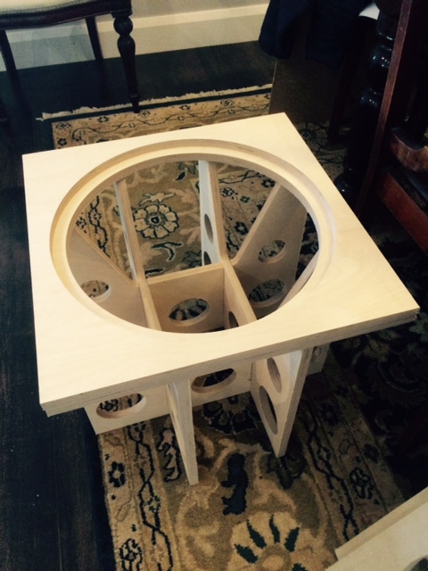

Your bass cabinets are looking great. Are these sealed? What Qtc did you design the for? I'll run stereo subs up to 80Hz and dual sealed 10" Beymas 10G40 from 80 to about 400Hz. I'm shooting for Qtc of 0.71 for the sealed Beymas but it's coming back as a very small enclosure.

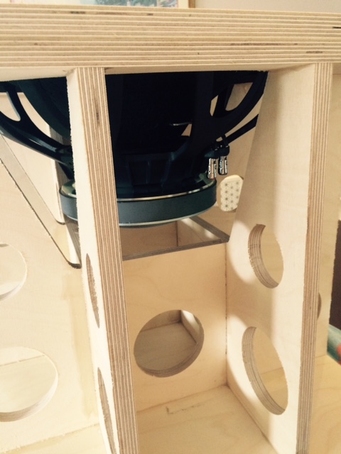

Thanks. Im note sure I went that far in my planning re setting the Qtc.
The driver specs for the FP 18 provide ample overlap with the Beyma 12. We'll probably go with 200-300Hz.
The subs are sealed to avoid complexitiy with porting/chuffing. It's a bit academic, as the driver is so efficient, plus we will use 800 watts/side amp.

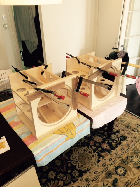

Mid bass starting to be glued up tonight.

Interesting you don't look into Qtc. How do you determine the volume of the sealed box you need? My understanding is the box Qtc, for a given driver, and in a sealed box, will determine the low-end extension/decay slope and the transient behavior (under/over damped). But you are experienced and not looking at Qtc so maybe there is a different approach to it? Very relevant to me as I'm heading towards a sealed translam 80-400Hz box construction now. My subs are sealed too.
Sealed box, Qtc, extension, max SPL and quality.....Juggle!
Hi Lewinski,
I am sure Andrew has his own views and ideas and he certainly knows what he is doing so you can be sure there is a good reason for doing it his way!
I have made a few enemies on this site because I am dead against ports, transmission lines, back loaded horns or any form of delayed resonance systems.....For me its got to be VPL open baffle or sealed.
To answer your question as best I can hear is how I work out my sealed box sub volume / performance.
Take a good 15 inch Pro driver ( Beyma , Precision Devices, 18 Sound etc) with a good 4 or 5 inch single layer voice coil, look for a low Qts and Qts, good Xmax (8mm to 10mm will do) and a powerful motor ( Bl 20 to 25) and you are done....The rest is just a big amp and good Eq.
Exact box volume is almost irrelevant, well more a by product of the Qtc you want.
