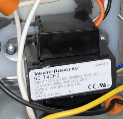

Again, this is where we are with troubleshooting: Line voltage (wall plug, 120 vac) to primary of transformer, secondary not connected, transformer overheating and going into protection mode. It doesn't matter what's on the other side of that switch on the secondary, it's having as much affect on the circuit as the box of loose resistors under my work bench.Apparently there is no schematic,
When this first happened, before I got to isolating the transformer for troubleshooting, I replaced every part and still had the issue. 3 relays, the timer, replaced one relay socket and tested all the switches.
I think the original transformer is poorly made and speced incorrectly for continuous work (regardless of what the manufacturer claims). This is supported by the fact that lift sales person says this is a common issue with this type of lift.
I purchased the 250 va transformer before posting here. It's incased in epoxy in a 16 gauge metal box and that box is getting pretty hot. Again, plugged in with nothing hooked to the secondary, it gets hot. The manufacturer says this is normal (although I'm not sure how much I trust the tech I talked too). I'll keep running it to see if it shuts down.
If that fails, I'll come back here to see if anyone can recommend a better made, continuous duty transformer. Toroidal has been mentioned.

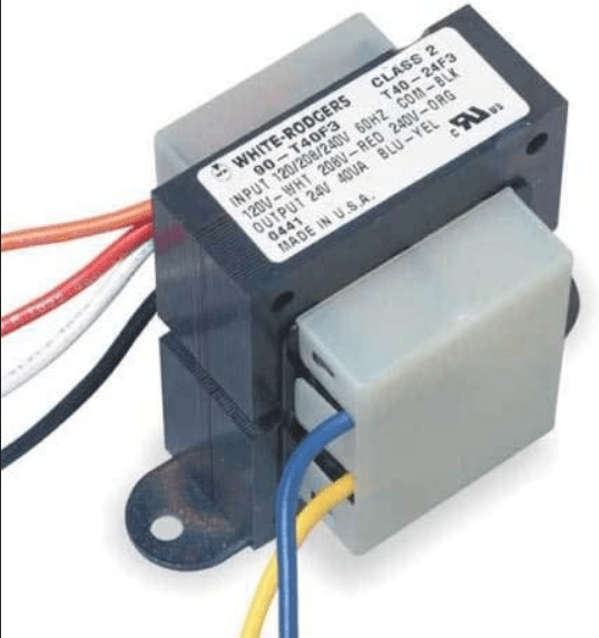

Look at a NEW Class 2 Transformer,40VA,24VAC,Foot WHITE-RODGERS 90-T40F3 from amazon, it covered with plastic end caps and made in USA. Perhaps your existing one is poor quality that made in China?
I don't know about getting the same model # from the same manufacturer. That one looks identical to the one I have EXCEPT the sticker says made in USA. Mine is new, purchased from Supply House a few months back.
I'm up for trying something different but that isn't different enough!

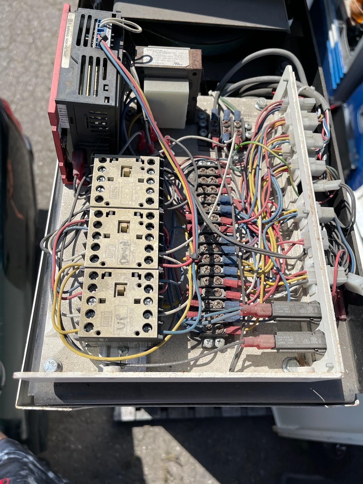

You guys suggestion conversion to DC may not have been too far off. Attached are pictures of the control panel of a newer version of the same lift, the one I'm thinking of getting for out backyard. I also attached a pictures of the part list for that unit:
2 - auxiliary relays (I think for gate controls or lights, I can't identify them in the pictures)
1 - transformer (Identical to the one in my lift)
3 - relays (Just like mine, UP, DOWN, POWER RELAY)
1 - Bridge Rectifier (!?!) I'm assuming it's part of the unit in the upper right side of the control box, has red trim piece and high voltage warning. Although, if you look closely at the picture, you can see another transformer in that unit.
I'm going to try and get more info. on this unit. I'm a little worried about the amount of oxidation on the control panel, I'm assuming this was used outside or stored outside for a while. It works. If I can work a deal with one set of spare parts I may be good after a thorough cleaning.
