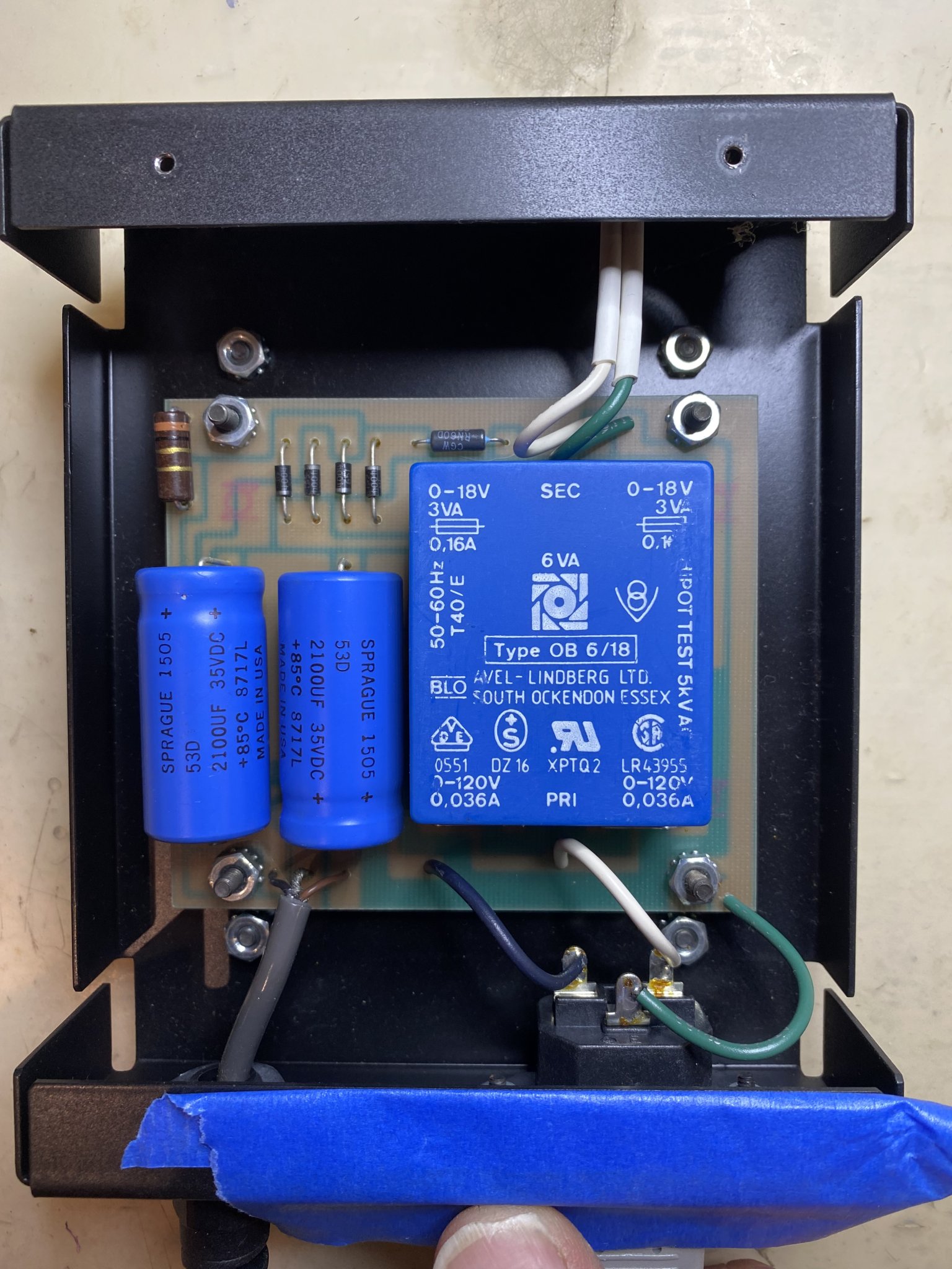

Let's add to all this. Below is a picture of a Threshold Universal power supply for preamps. It's been plugged in for 24 hours, no preamp is connected but the rectifier, 2 resistors and filter caps are still in circuit and it IS NOT running hot. It's rated at 3 VA. Is it just a better quality transformer?

Eric M, that is a 6VA transformer. The mains does not even feel if it is connected or not.
