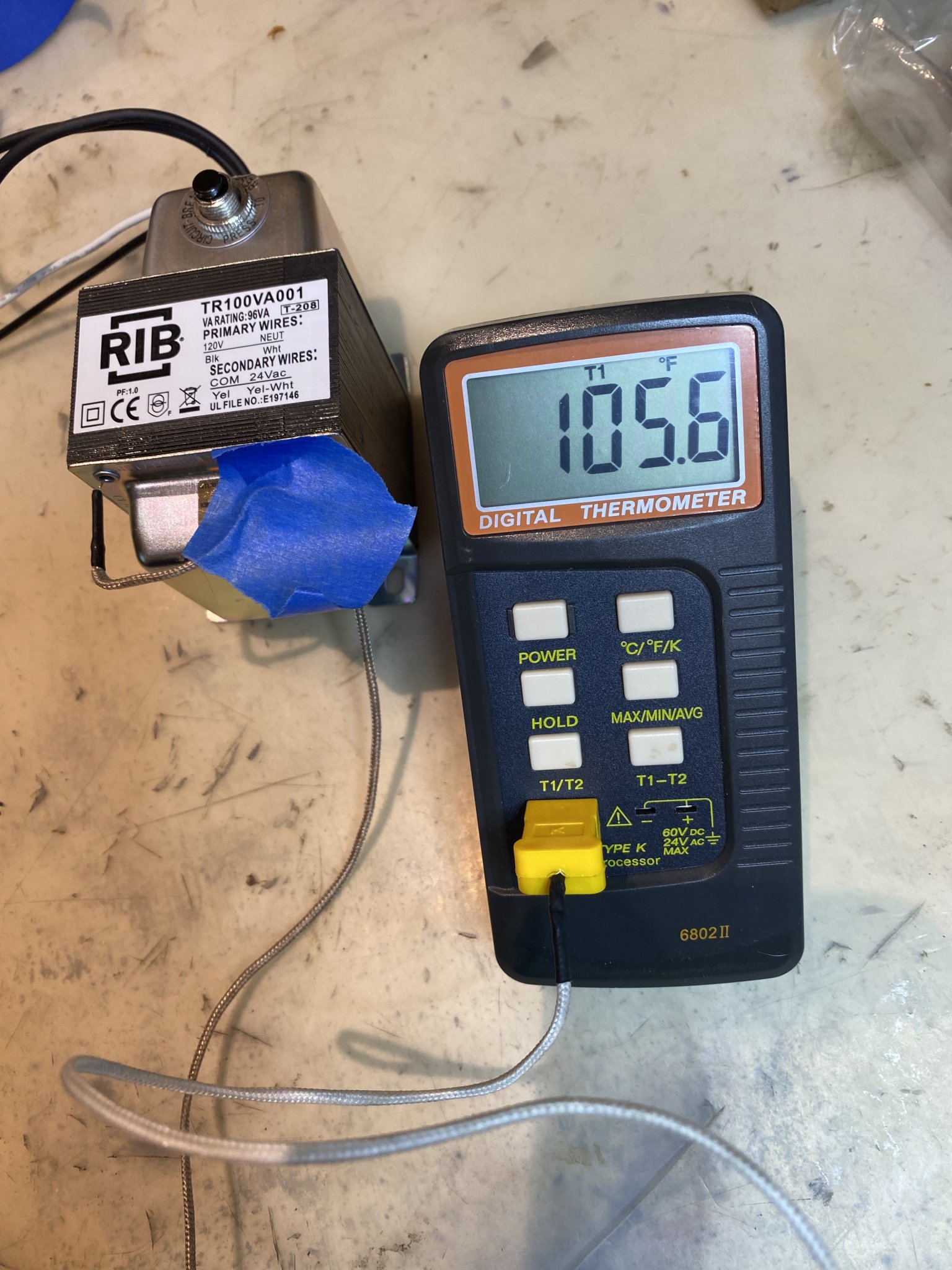

Results of the 96 VA TR100VA001 Functional Devices transformer with the primary powered and no load on the secondary: 106 degrees F or 40 degrees C.
A question for the transformer experts here. This is now the 4th transformer I've tested like this with no load on the secondary. All get hot, I'm assuming this is normal. (Although I did test the trans in a Threshold power supply and it did not get warm at all).

Good transformers get hot with no load when the primary voltage is higher than spec value or the mains waveform is distorted. Both conditions will cause saturation/losses on the iron. High quality transformers may have extra turns and more iron to cope with that, but standard control transformers are not built this way and their mitigation strategy is to tolerate high temperature. This explains why the Acme transformer tech support stated that it is fine to operate the transformer on your measured temperature. It would probabily still work just fine at 50+ celsius - so hot you will not be able to keep the finger on it. The timer next to it may not be so happy about the situation. Industrial environement often has this power supply issue. Before the widespread adoption of DC SMPS, it was common to see disproportionately big transformers to supply small loads inside a control unit. The transformer was already hot with no load, therefore the additional dissipation due to resistive losses in the copper had to be small, so the transformer had to be oversized.
Thanks. Sounds like I'm OK with either the 250 VA or 96 VA transformer and their heat. I know my voltage is good at 117 VAC, but do not have a scope to see if the waveform is distorted.

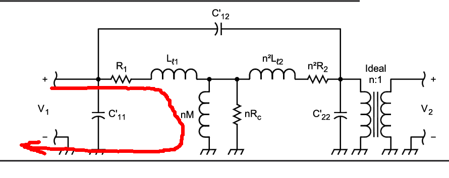

An equivalent model of a transformer sometimes is shown like this:
Current flow it the primary winding that causes no load heating is mostly due loop indicated in red color. The part labeled nM is the mutual inductance which relates to the magnetic flux shared by both the primary and secondary windings. The other inductances (L1 and L2) may be referred to as leakage inductances, since they arise from flux that is not shared by both primary and secondary. Much of what causes heating under no load conditions is current flowing through nM which results in heating due to current flowing through the lumped equivalent resistance R1. Voltage across Rc also produces heating. Problem is that it costs money to make nM bigger, Rc bigger, and or R1 smaller, so less heating would occur under no-load conditions.
BTW, the letter n represents the turns ratio between the primary and secondary windings. Also, V1 is the primary winding voltage which in your case would be 120vac, and V2 is the secondary voltage which in your case would be 24vac. Rc represents a source of losses and heating related to iron core eddy currents and or hysteresis.
Don't know if that helps at all, but maybe it will?
