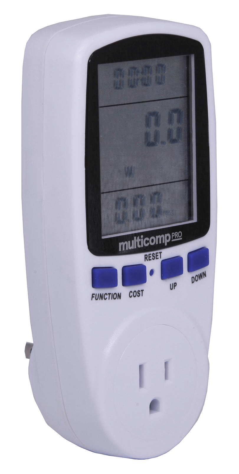

Most meters do not have AC amps range. Those that do are on the expensive side, and bulky.
Use a digital clamp meter, or the plug in type units, as in the picture, they will tell you power factor, you may not need a scope after that.
Random image off the net, no ties to seller, in the $25 range here for decent units.
Very handy on small single phase loads.
