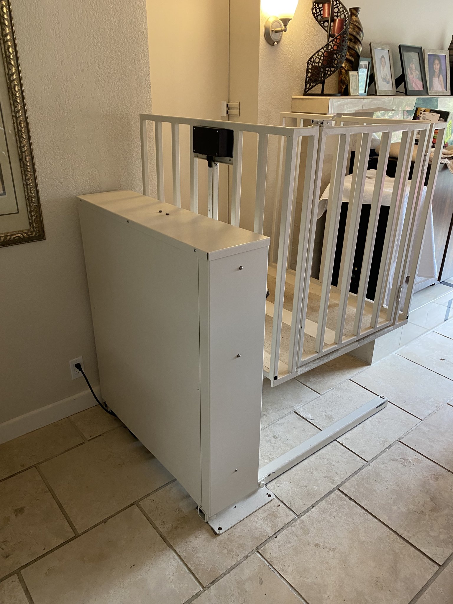

Well, the lager transformer is now beginning to over heat. If I unplug and let it cool for a few hours, it will function again. Surprisingly I got a few months out of it before this happened. Now, after cooling down, I only get a few hours before it shuts down again.

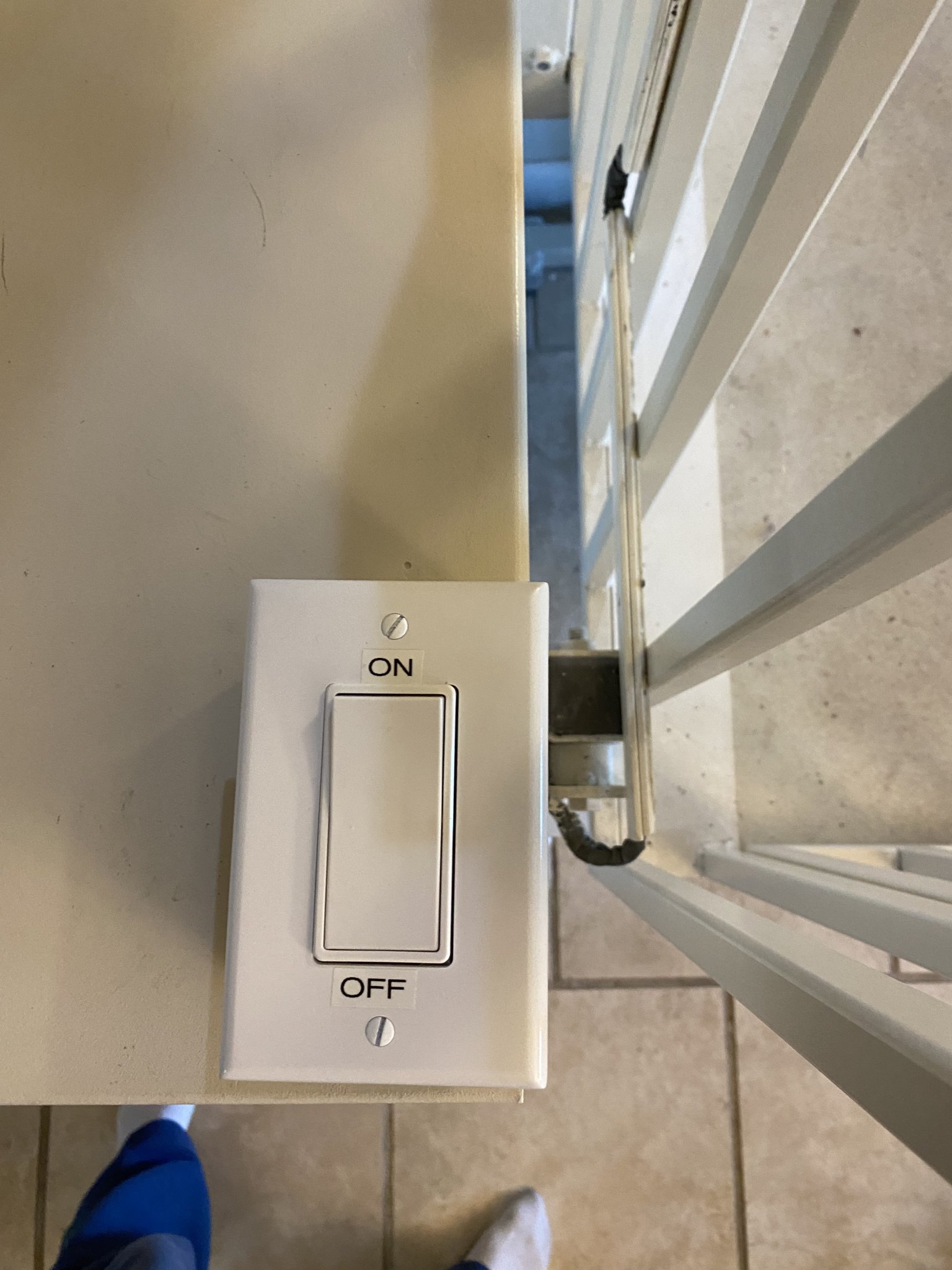

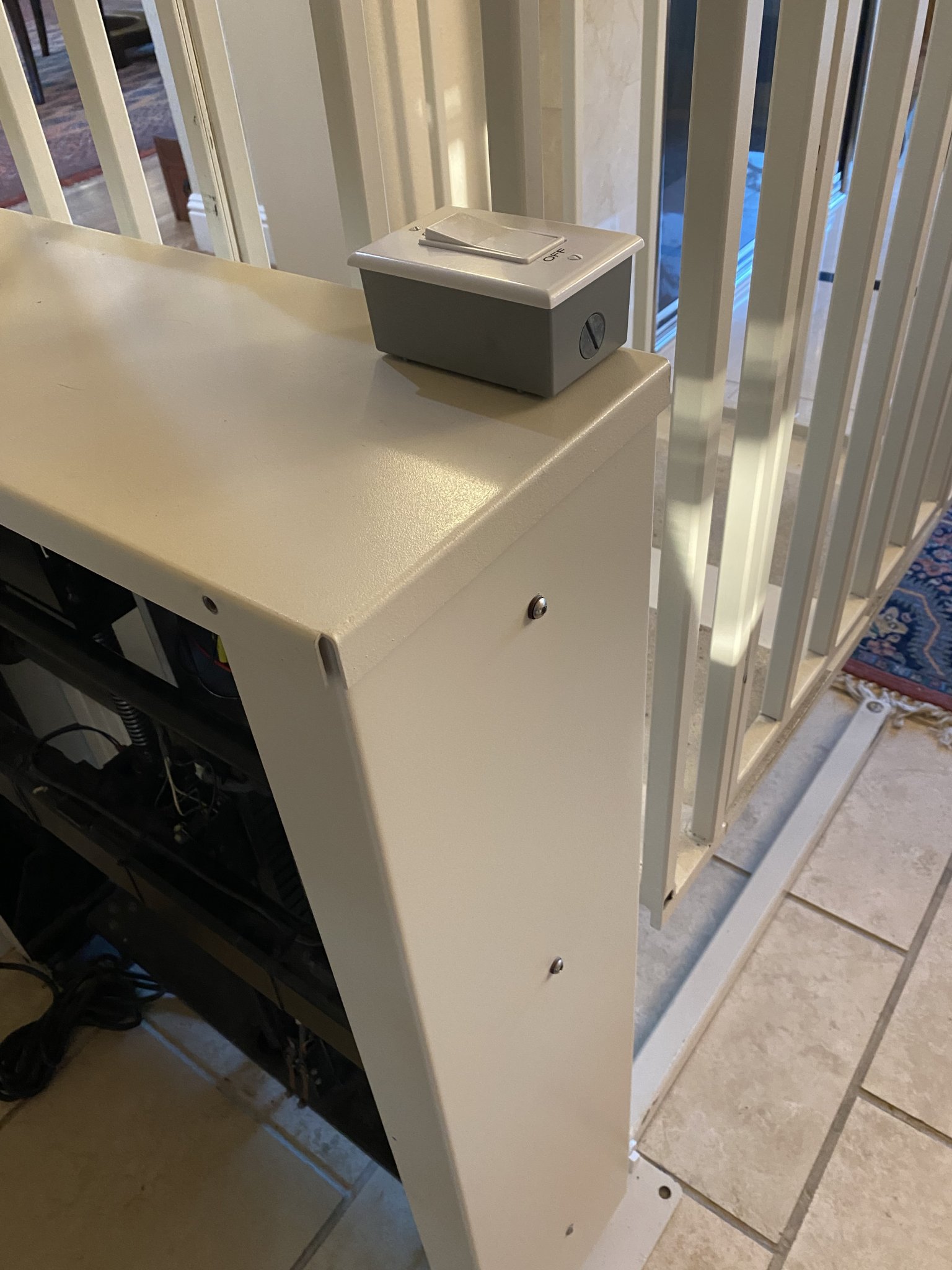

I'm moving to plan 2. I'm going to install a switch on the primary. We'll just switch the entire unit off when not in use.
Or maybe try to figure out what is going on? I suspect there is a dodgy component in the chair control somewhere. At minimum I would measure the load current on the secondary of that transformer to see if it is constant or creeping up over time. Is there a correlation to long term variations in line voltage?

Ohh yes! It's been hot around here. I suspect that may have contributed. But as you said, "the circuit was barely meeting standards". It's either a poor design or as others mentioned, "dirty A/C" coming into the house. Either way, I think we all agreed a switch on the primary will solve the problem, not the cause and I've spent enough time trying to remedy the cause. I'm going to install the switch and put this behind me .... I hope!A change in weather
