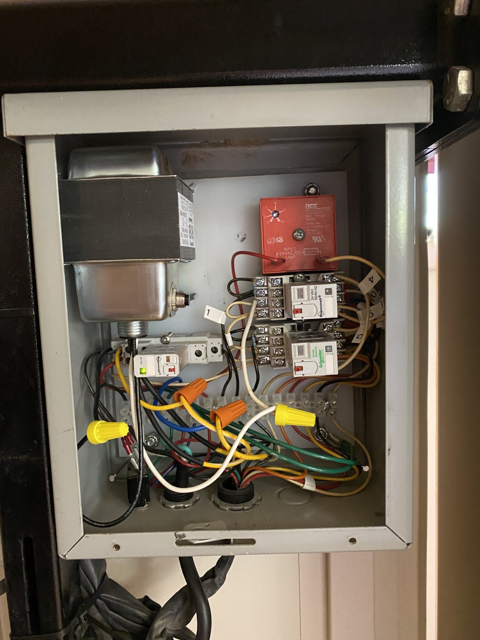

I put the 96 VA trans. in. I think I've tested the 250 VA long enough to know it will work, hopefully the 96 VA will also and I can just leave it in the control box and be done with it.
I'll run it for a few weeks. If no issue, I'll put the cover on the junction box and run a few more weeks. If I have an issue with overheating after installing the cover, I'll remove and see if that is enough to keep the transformer cool and not tripping.
At some point I'll need to put the housing cover back on. I guess that will be the real test.
I'm not going to do any more testing of the house mains. I can't change it so will need to find a work around if that is truly the issue. Keep in mind, everything else in the house works with no issues. I suspect if there was a real issue with "Dirty" AC power, myself and everyone in the neighborhood would be having issues with much more than handicap lifts.

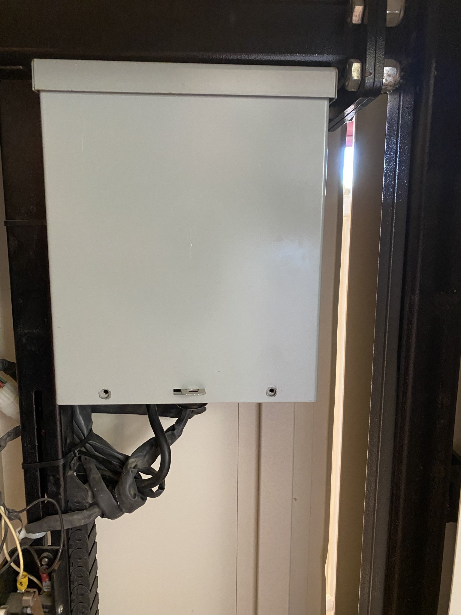

Pics are with new transformer installed and cover on junction box. (I took the cover off after the picture)

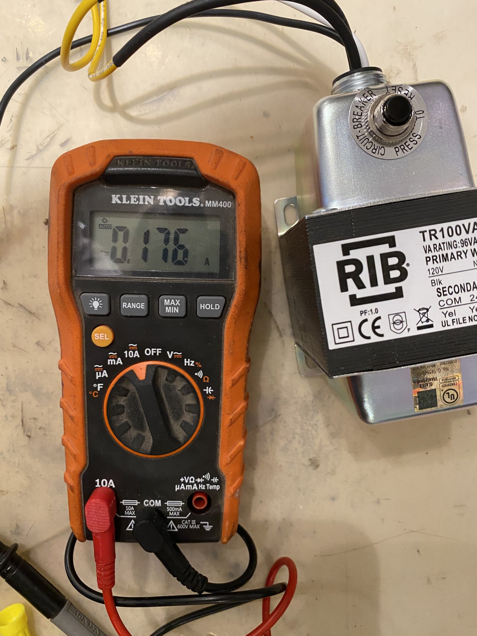

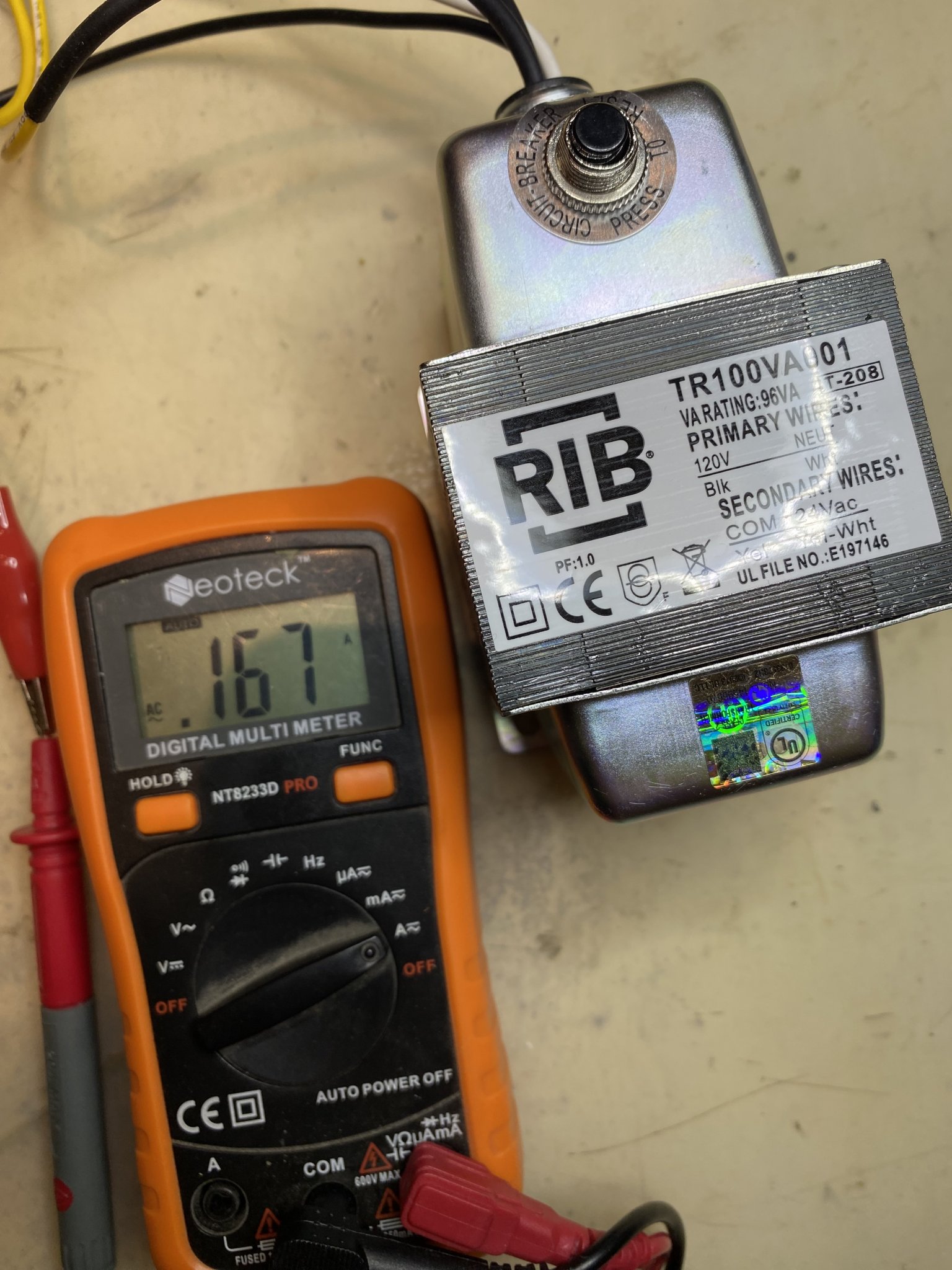

It is considered warm and perfectly Okay!!!Results of the 96 VA TR100VA001 Functional Devices transformer with the primary powered and no load on the secondary: 106 degrees F or 40 degrees C.
I think about 0.17A is quite reasonable, 25mA seems quite low for this transformer. What is the reading if you set the Neoteck meter to mA range?96 VA trans, primary current draw, secondary open.
2 meters, 3 different settings, you tell me which is correct.
Good job, that control cabinet looked a lot larger until you mounted the 96VA in! 🙂
Let's hope they used decent double insulated high temp magnet wire in the '96', the operating temp specs are pointing toward it so yes, fingers crossed.

I'm really thinking the cover on the junction box is a bad idea. I may try it but the entire box did get pretty warm before, that may be why it was missing. The cove for the lift protects from the electronics.

It is a Class F transformer winding, if I understood the label on the 96 VA unit.
Good to 155 Degrees C.
So I would check up, and not worry too much.
Make a hole in the cabinet to allow ventilation, as posted earlier, simply a precaution for longevity of the other components.

It's been a month and no issues. BUT, I didn't reinstall the cover on the junction box which the transformer was installed in, just the cover of the lift itself.
Someone mentioned that the missing cover may have been part of the design to minimize trapped heat or part of the solution / fix since this is a known issue. Remove the cover, reduce trapped heat in the junction box where all the components are housed, makes good sense.
I remember taking the cover off the last time I had an issue and it was quite warm. Regardless of whether this new transformer would have worked with the cover on, I decided it might be a good idea to leave it off and spare all the components the additional heat.

So, the bigger transformer with the cover off seemed to fix the issue. Maybe the original transformer with the cover off may have worked. Again, too lazy to take apart and test, but I think we all would agree the newer, bigger transformer was a better fit for this unit.

I would make a cover from wire mesh, as accident and pest protection.
There are mains voltages present, and you have children and old people in the house, somebody may slip.
It is just a small thing to do, to prevent mishaps.
Mesh will allow ventilation, choose one which is having holes small enough to stop pests and fingers, and not too small, dust balls can build up.
You can also cut holes in the original cover, and fix wire mesh, or drill many 4 mm or so holes in it, to ensure ventilation and safety.

Remember, there is a cover on the lift that covers all the mechanisms, gears, wiring and that box. Once that is on, nothing is getting in.
Maybe I should post a picture?
