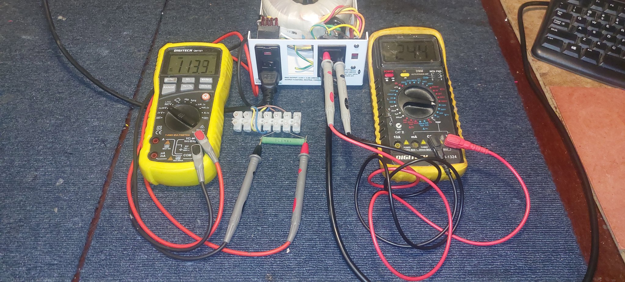

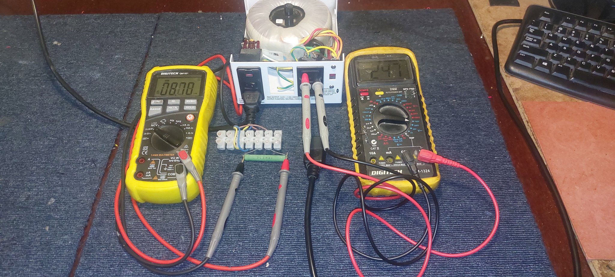

I've measured probably thousands, I used to work at a transformer manufacturer.
This is a particularly well designed transformer, looks about 300VA with very low core losses.
On the left with approx 25W light bulb load = 114 mA. On the right we have a massive 9 mA no load current.
Note I am measuring AC voltage across a 1 ohm resistor so there is no discrepancy, my current monitor attached to the Variac that is feeding this gets a bit flaky at these low currents.
If I wind the no load prim voltage up the core saturation current knee is quite high at over 260 V, it's a VG transformer.
If I measure a less efficient EI core transformer with a cheaper non grain oriented core (Toroid uses GOSS) the no load current will be higher, sometimes significantly so.
Terry
