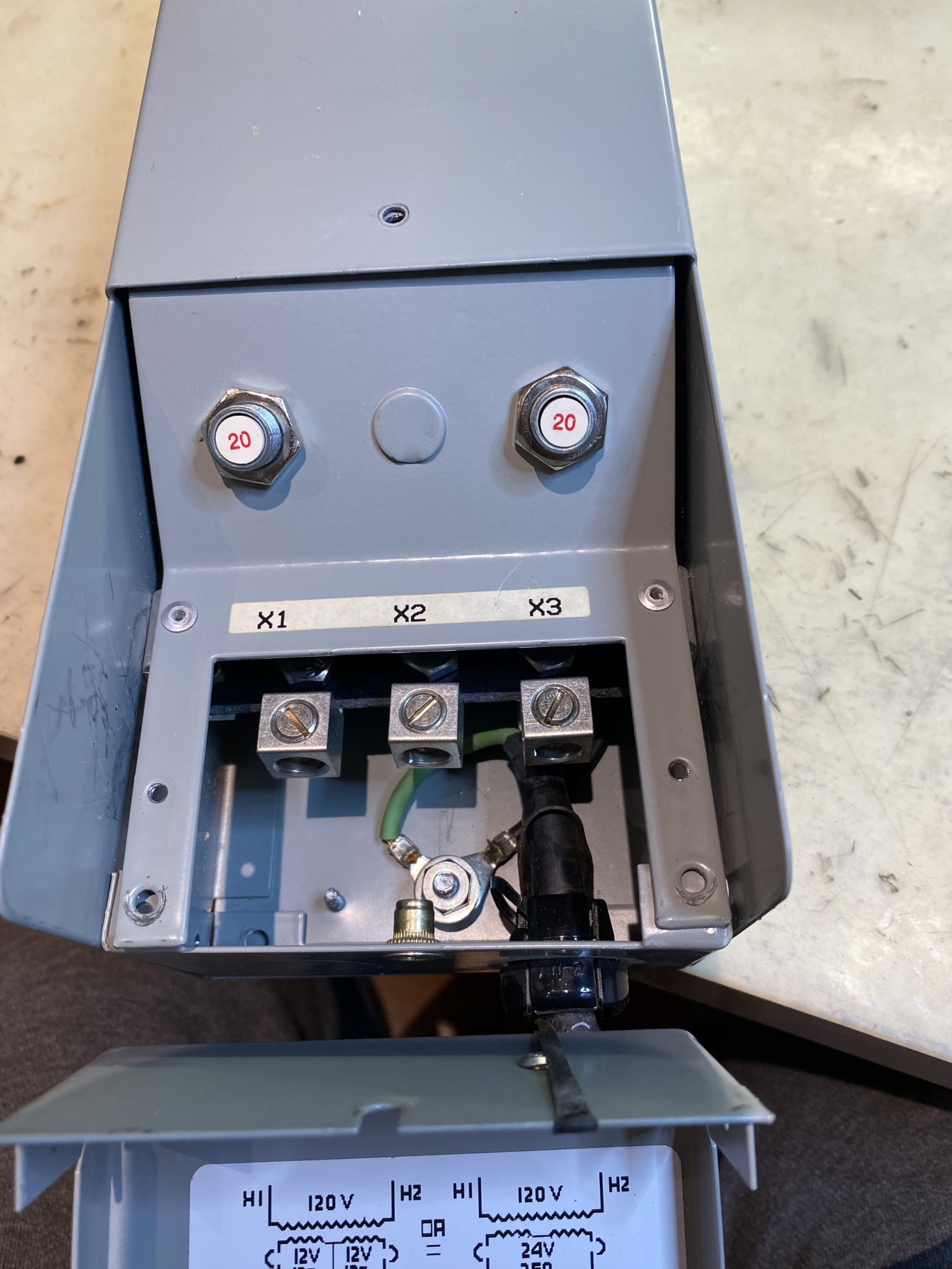

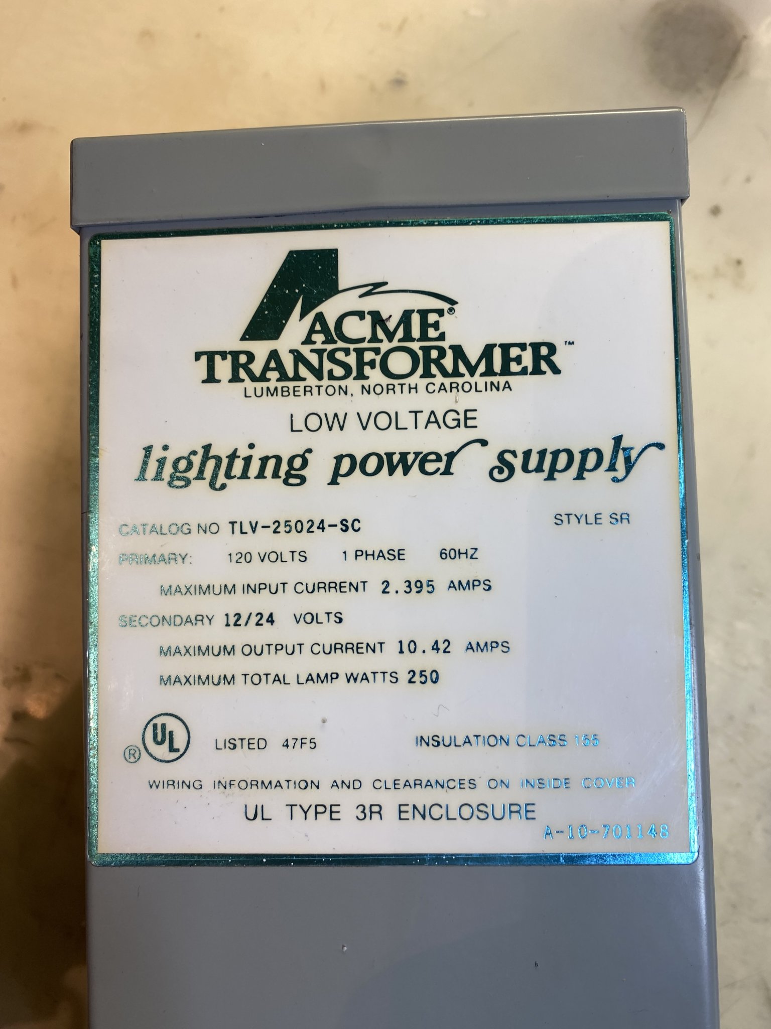

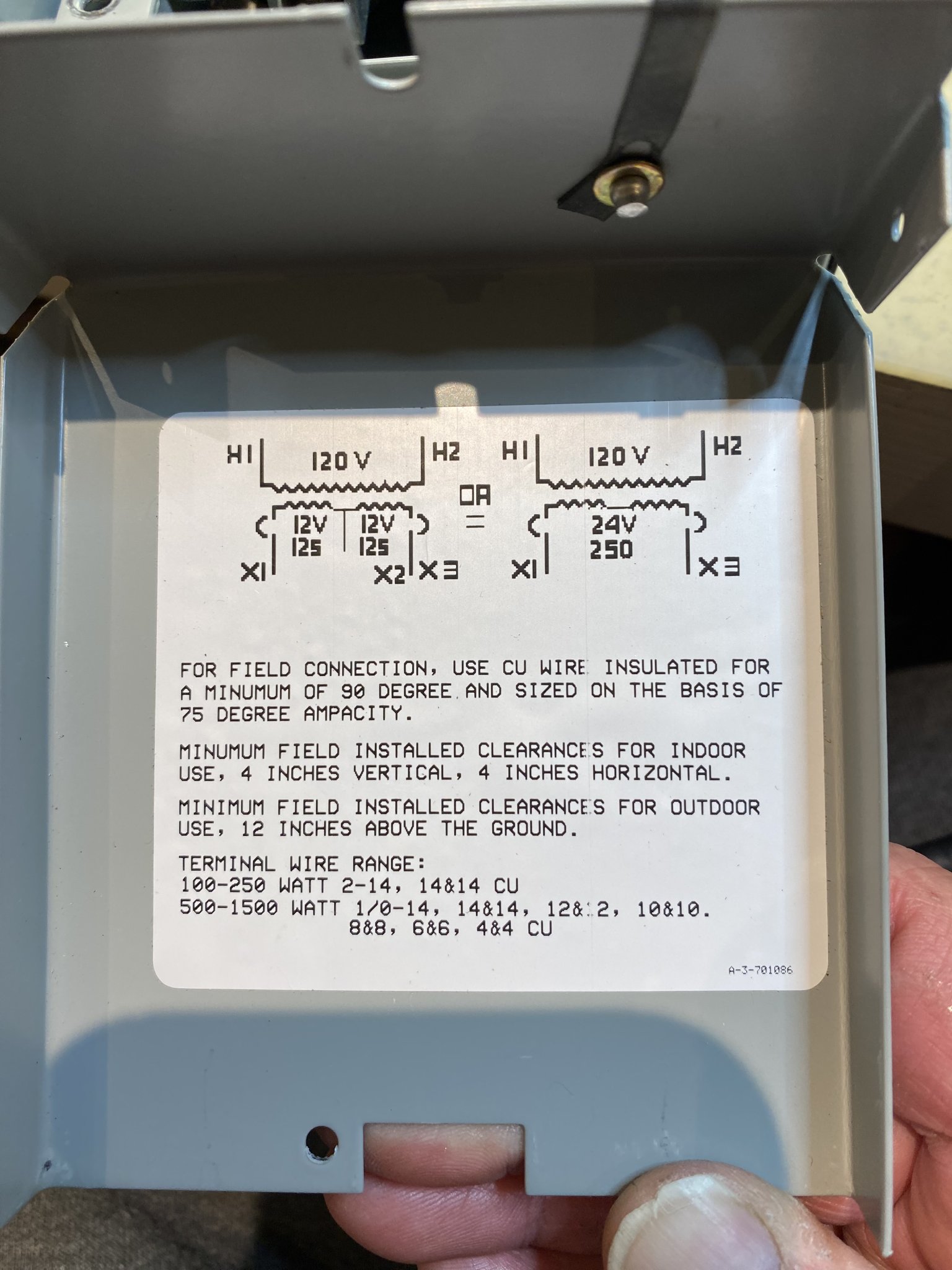

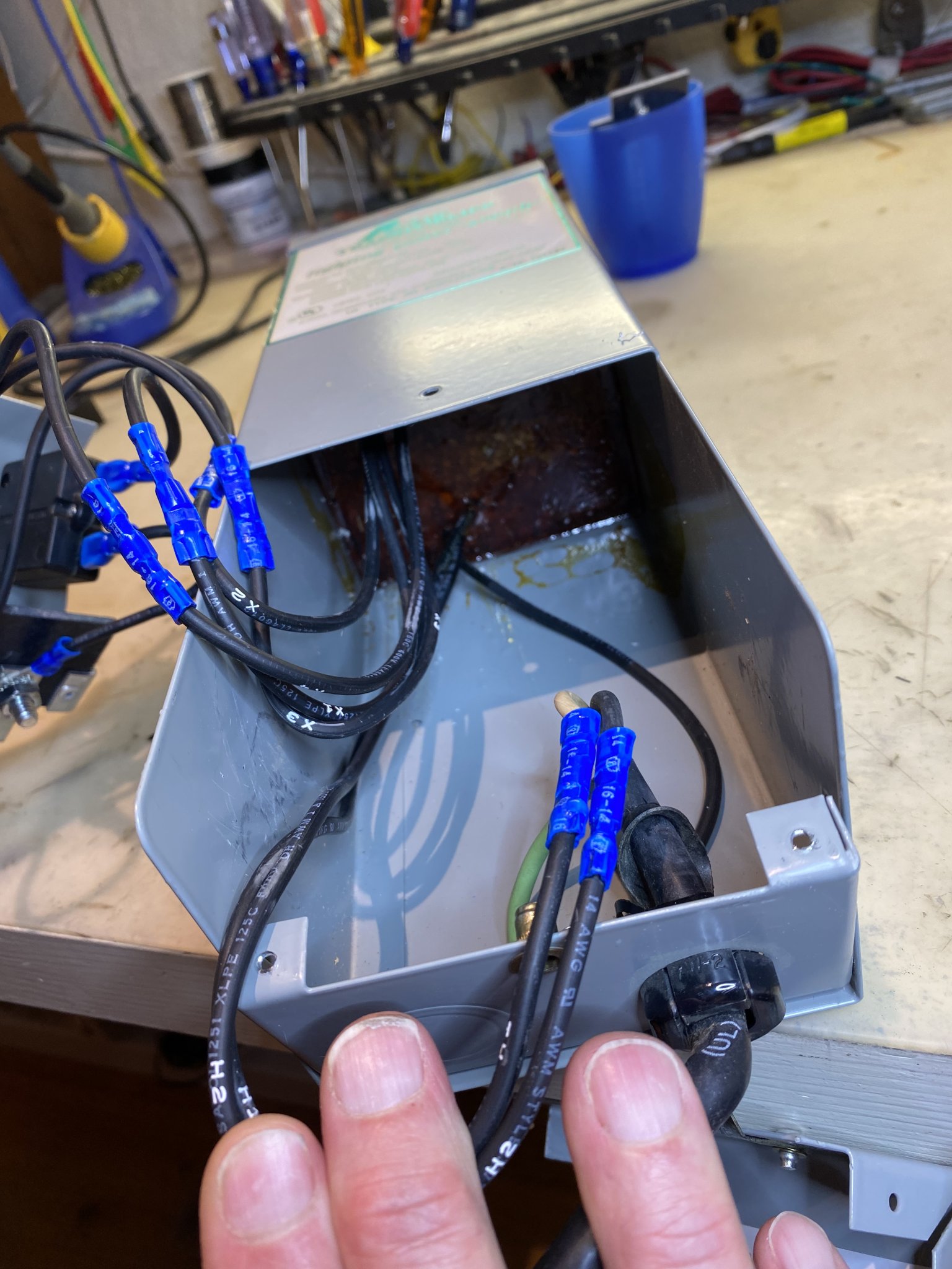

Attached are pictures of the 250 VA transformer I'll be installing. It's an exterior landscape light transformer that has breakers on the secondary, I'm not sure what sort of thermal protection it uses. The transformer is incased in some sort of "epoxy", all you see are the wires coming out. I'll hook it up tonight and report back if it's getting hot or not.
Thanks for all the help.
"Check it closely, possibly bad components on the DC side," No DC in any of this. It's all AC, 120 volt or 24 volt (well, 27.5 volts!)
