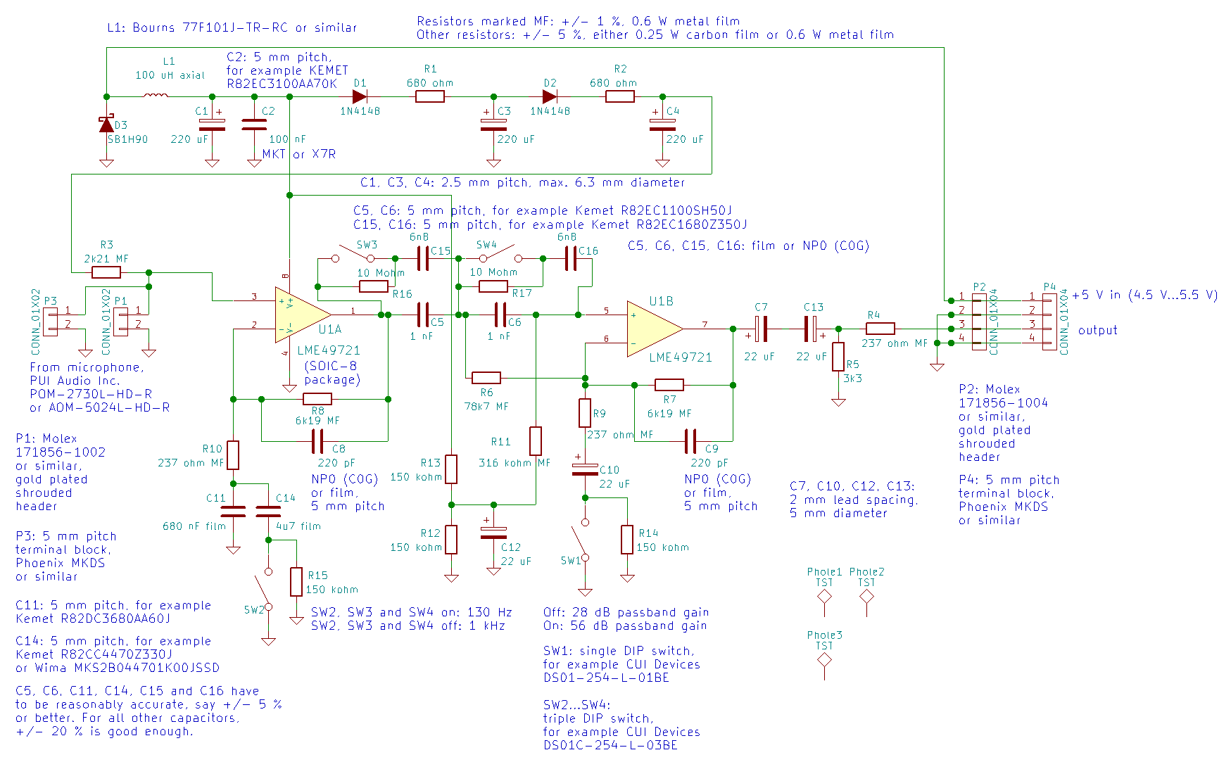

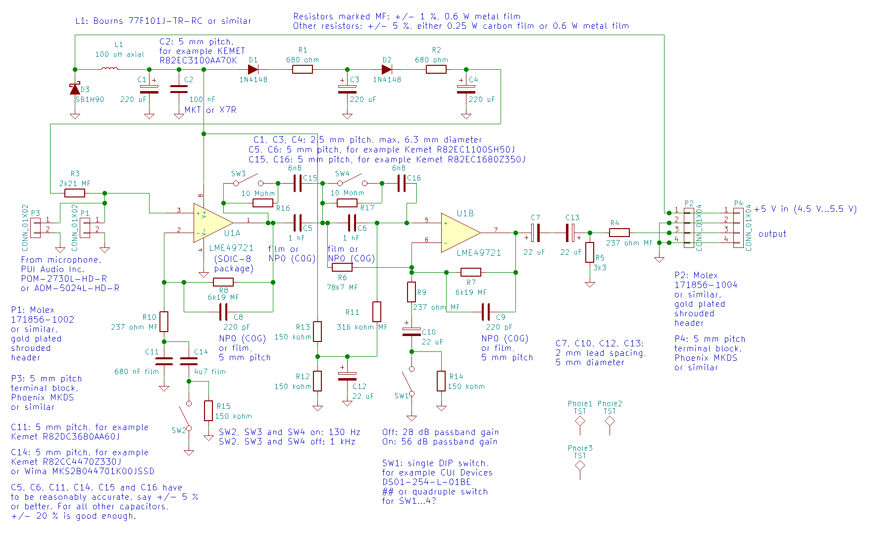

I haven't tried to fit it on the PCB design yet, but the version with switchable cut-off frequency would be something like this. The lower cut-off setting is about 130 Hz. The modified amplifier needs about 5 seconds to settle instead of about 1 second.

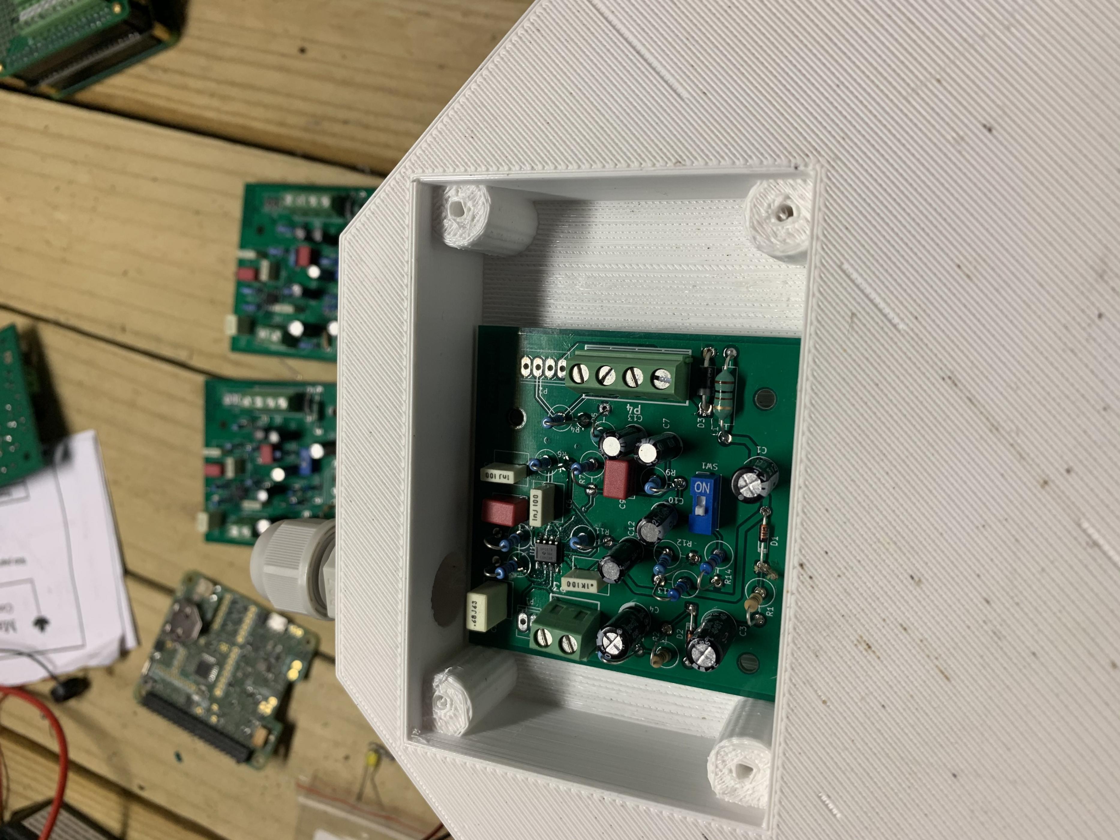

What about calling it the "ecotone" or "ecotones" preamp? One more thing that came up I wanted to ask about. The current PCB footprint fits near perfectly in the microphone housing as previously designed. There is room for expansion horizontally. There is about 1.2 cm of room in that direction. I have attached a photo to illustrate. Would it be possible to add the new switches and stay within those dimensions? If not, no big deal. Thanks!

See the attachments. Switches SW2...SW4 together are one triple DIP switch; each of them has a single switch footprint in the KiCAD database, but as I placed those at a 0.1 inch pitch on the board, you can actually not use three single switches but only one triple switch. Everything (only just) fits in the area you asked for.

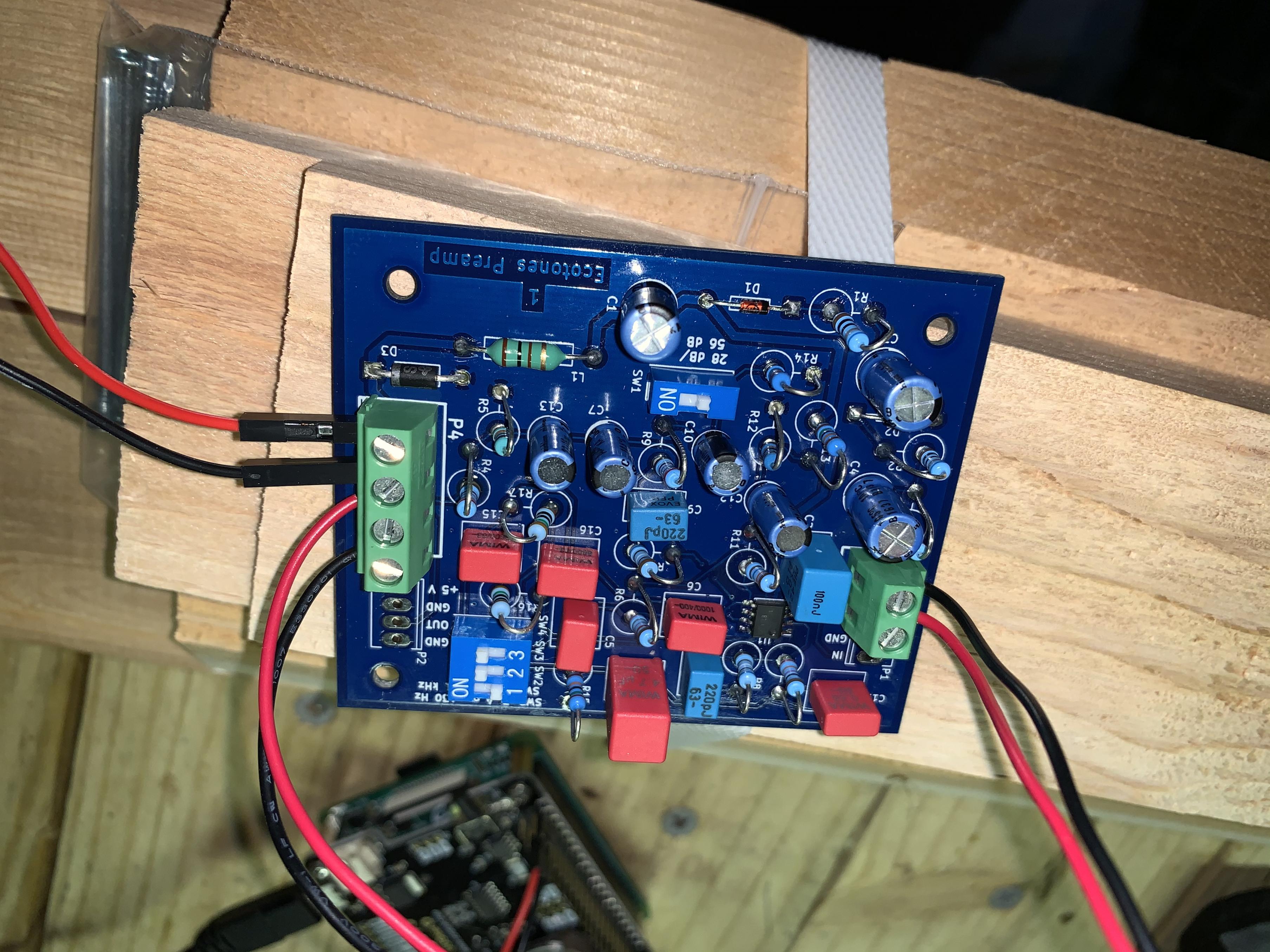

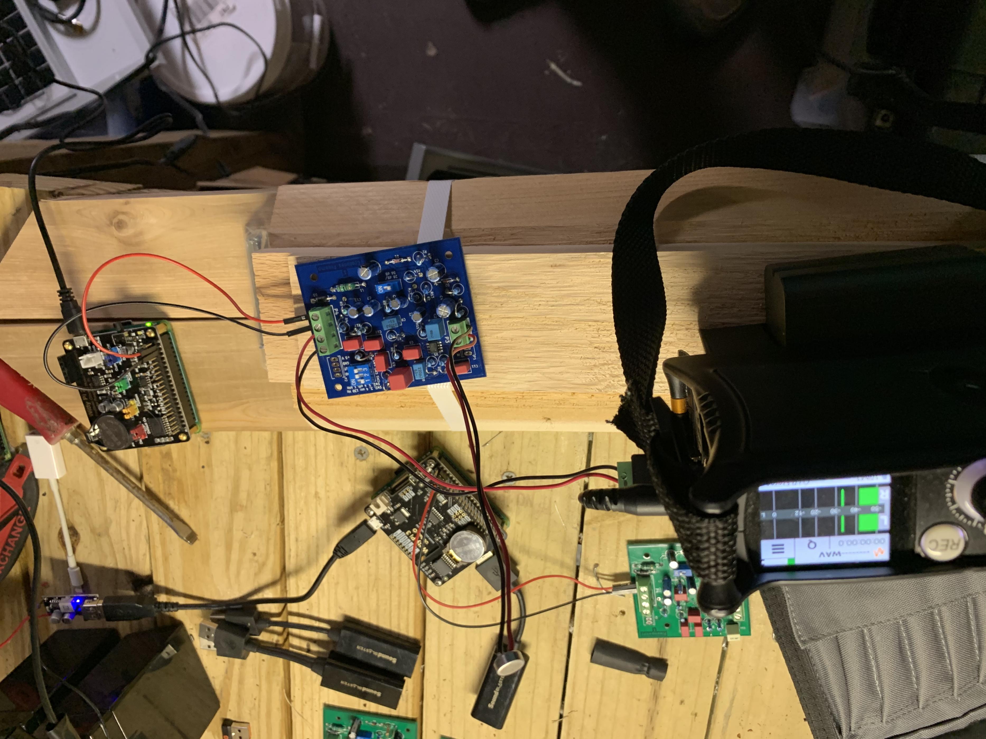

Hey! Yes indeed. I meant to make a post last week but got too busy. I built it a couple weeks ago and been testing since then. I attached a couple photos of the setup. Switches 2,3, and 4 work well. One thing I noticed and wanted to ask about is if there is levels of filtering depending on which switch is used. It seemed like with just switch 2 pushed it was filtering some. Would love to know your thoughts.
