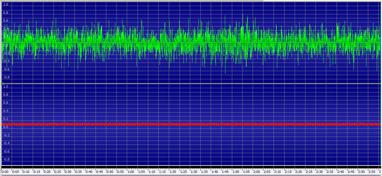

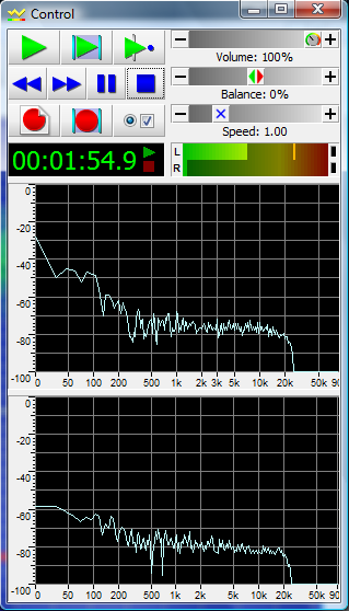

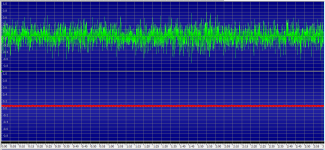

When you look at the waveforms, it seems like the microphone dominates by a huge margin, but this is actually almost completely due to the microphone's noise below 300 Hz (condenser microphones always have a large noise increase at low audio frequencies). When you look at higher frequencies, the microphone still dominates, but not by a large margin.
In the frequency range of interest, so above 1 kHz, the noise would drop by about 2.32 dB if you could somehow completely eliminate the noise of the sound card. Of course any practical microphone preamplifier has some noise of its own, so you will never reach that 2.32 dB, but maybe 2 dB?
To give you an impression of how much (or how little) 2.32 dB is, I WeTransferred an edited bird recording where the noise level is increased by 2.32 dB from 40 seconds onwards (I didn't know a way to decrease it). Link: WeTransfer

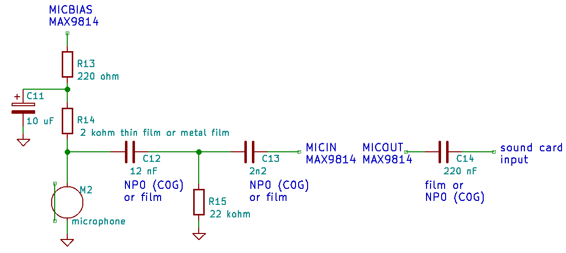

Is there a way to add some high-pass filter to the setup? I would rather stay away from digital filtering if possible as it increases time in my workflow and I suspect the software I use to detect the flight calls has a harder time picking up the sounds. The other question I have is where to place the amplifier. Is it ok to place it at the end of the cable run (~25 feet) close to the sound card or should it be up near the mic? It would be easier to place it near the sound card as that is where the power source is located and I wouldn't need to run more wiring. Thanks in advance!
With the MAX9814, you get a noise floor that is about 1 dB higher than when you connect the microphone straight to the Sound Blaster card and set the card to maximum gain, so I guess you do this because the compression makes it easier for your flight calls detection software?
Presumably you don't want the compressor to respond to low-frequency sounds that get filtered off, so that means you need a high-pass between the microphone and the MAX9814. On the other hand, a high-pass between MAX9814 and sound card can suppress some of the low-frequency noise of the MAX9814.
The simplest solution I can come up with, is to replace C9 (cap between microphone and MAX9814) with a 2.2 nF NP0 (a.k.a. C0G) capacitor and to add a 100 nF capacitor (either NP0/C0G or some kind of film capacitor) between the output of the MAX9814 and the sound card's input. I will see if I can come up with something better than that.

This would be a better solution if you can get it onto the PCB, but that will require quite a bit of three-dimensional soldering.
Splitting the 2.2 kohm microphone bias resistor into 220 ohm + 2 kohm with a capacitor at the junction (R13, R14, C11) is an optional change to reduce the noise slightly, it has nothing to do with the high-pass filtering. The microphone supply of the MAX9814 is rather noisy, C11 now filters off that noise.
C12, R15, C13 and C14 are the actual high-pass filter components.
Marcel, you are awesome! Thank you so much for that diagram. I ordered the parts and will check back in when I get something made.

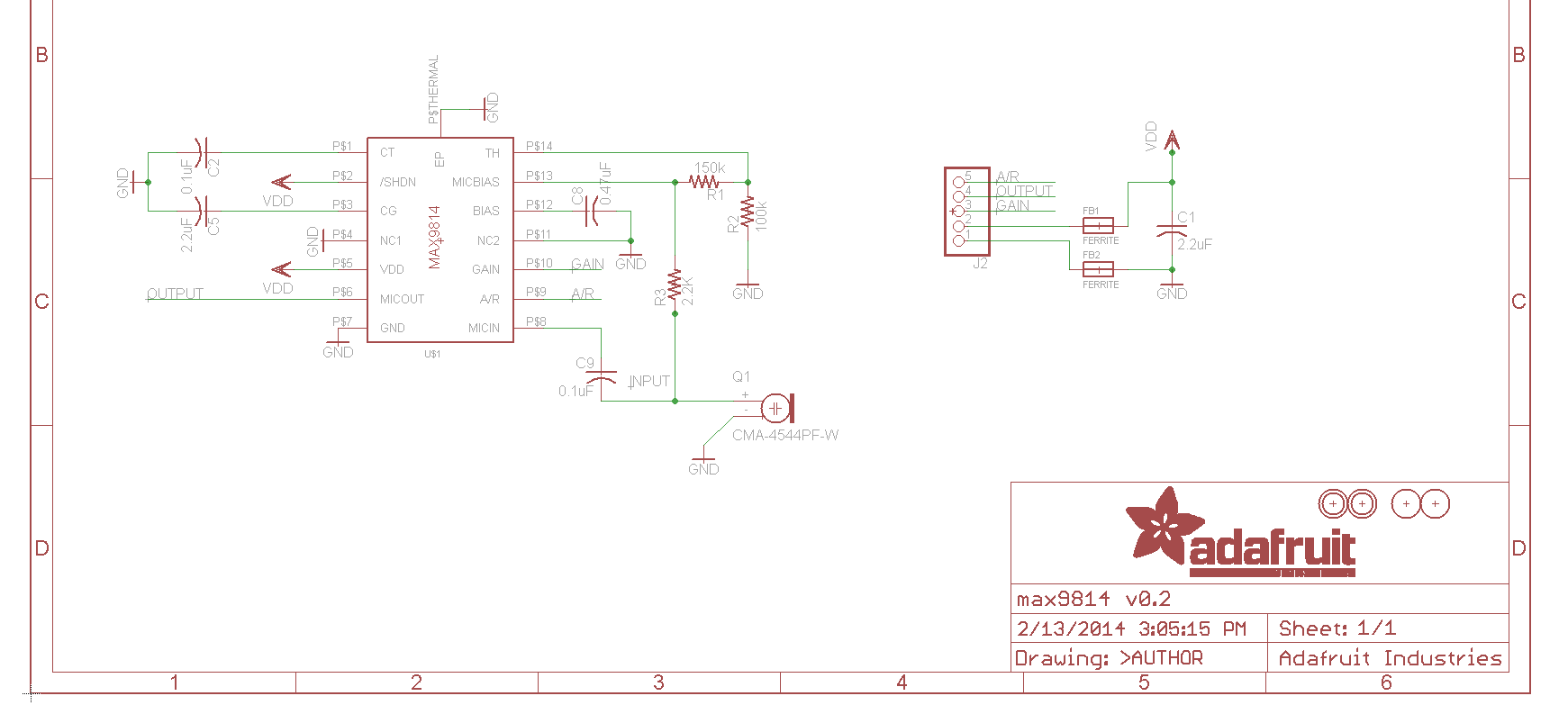

Got the parts in late last week. I may have gotten the capacitor for C11 as it doesn’t appear to have a +/- side to it. It’s also fairly large. In the schematic is MICBIAS the same as vdd on the amplifier? Thanks!
MICBIAS was meant to be pin 13 of the MAX9814, but using VDD (pin 5, or pin 2 of the connector) may also work if your supply is clean enough.
Attached is the schematic of the Adafruit module (from Downloads | Adafruit AGC Electret Microphone Amplifier - MAX9814 | Adafruit Learning System ), the idea was to remove R3, C9 and the original microphone and connect my circuit to the corresponding pins of the MAX9814. If it is more convenient, you can also leave C9 in and connect my C13 to Adafruit's C9 (series connection of C13 and C9), you then only need to remove R3 and the microphone. In either case, you need to find a way to mount the extra components.
Removing two-pin SMDs is easy when you have two soldering irons, one for each side. If the SMDs are small enough, you can also heat up both sides with only one iron and shift them from their pads.
Can you post a picture of the capacitor you got for C11? (You can attach it to your post using the Go Advanced button and the Manage Attachments form.) A film capacitor will work fine as C11 in my circuit, it is just a lot larger and more expensive than the aluminum electrolytic capacitor I had in mind.

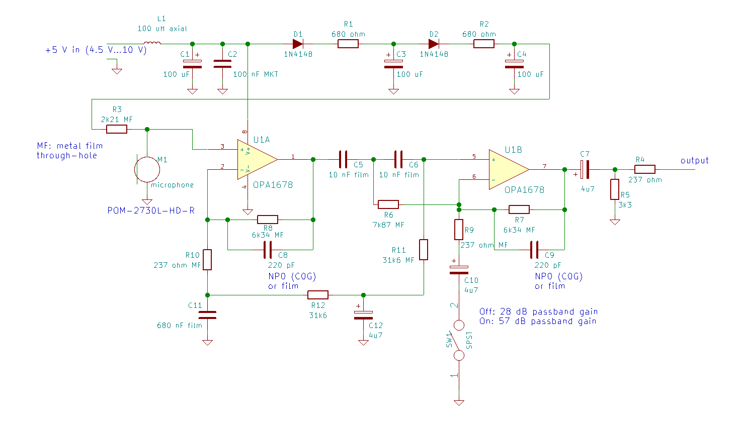

How about this? Runs off the 5 V, has only one component that you can't get in a through-hole package (the dual op-amp in an SO-8 package), the gain is switchable between 28 dB and 57 dB and it includes a fixed third-order Butterworth high-pass filter at 1 kHz. If you don't need the 57 dB position, R7 can be replaced with a short and C9, C10, R9 and SW1 can be removed. The output is not balanced anymore.
Oh Marcel, I could kiss you! Thank you so much for this. I will work on trying to get some PCBs made and make some for testing. I will check back in soon.
