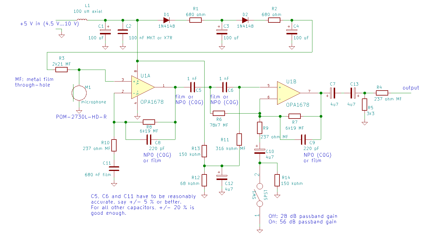

I hope you haven't ordered the parts yet, because I woke up this morning and realized I had made a mistake. I have to add one resistor and recalculate some component values.
No worries. I am still trying to find someone that can do the PCB layout for me. Thanks for double checking!
Here is the corrected circuit. The main change is in the way the second op-amp's bias voltage is made (circuitry around R12 and R13).
I made some additional changes as well:
A. R14 added to prevent thumps when switching the gain, R8 slightly reduced to compensate for R14's effect on the gain in low-gain mode, R7 also reduced to keep it equal to R8
B. C13 added to improve reliability when the phantom supply of the sound card's microphone input exceeds the bias voltage at the output of the second op-amp
C. Impedance of the network C5-C6-R6-R11 scaled up to make the filter response in low-gain mode a bit more accurate (smaller error term due to the current flowing from R6 to R7).

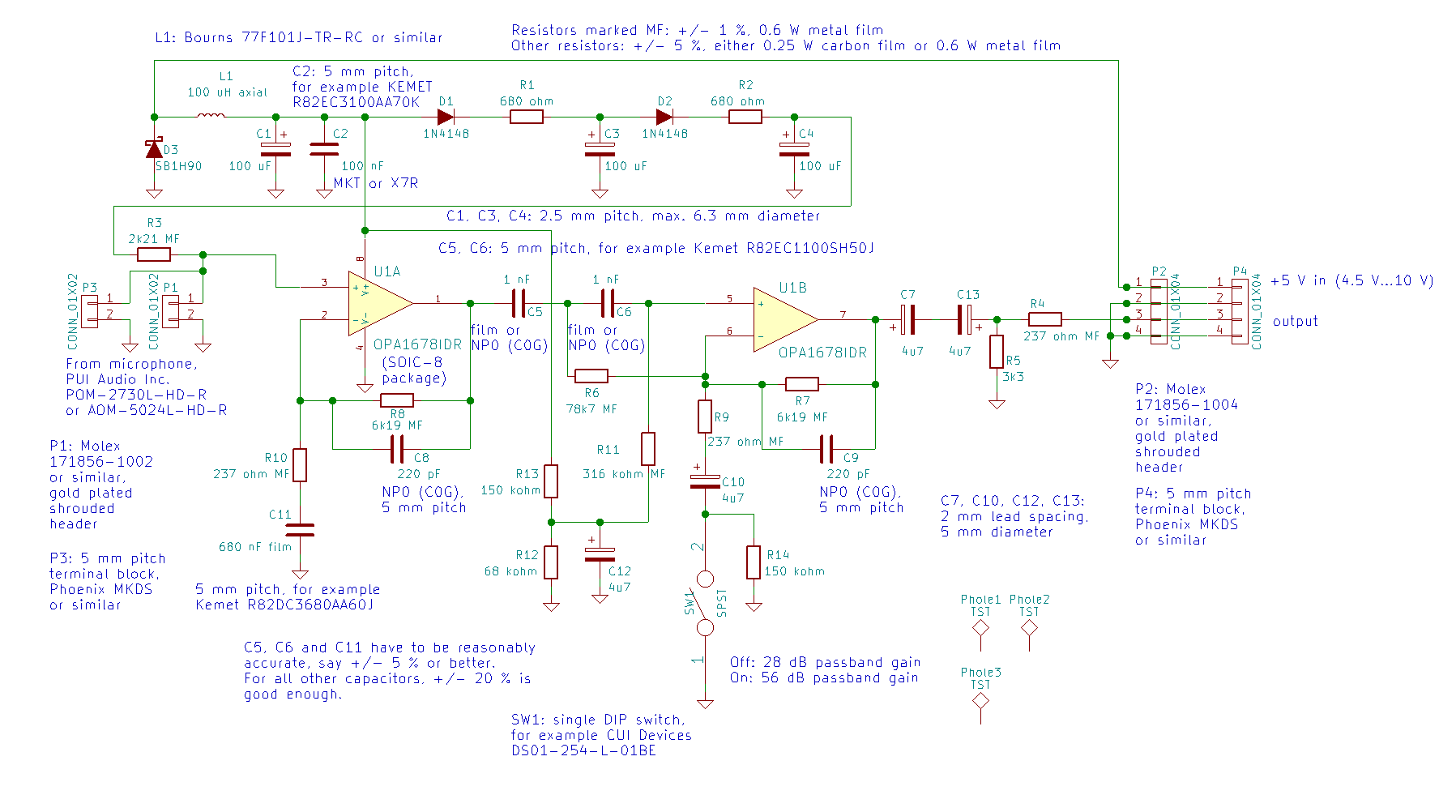

See the attachments, which are a zip file with Gerbers and a zip file with what I hope to be a complete KiCAD database. I write "hope to be", because I have several projects in one directory, which made KiCAD include lots of irrelevant stuff that I had to remove myself. I hope I didn't remove too much. For your information, KiCAD is an open source PCB layout program.
Anyway, for the connectors I included two footprints, one for a 0.1 inch pitch (shrouded) header and one for a 5 mm pitch terminal block, so you can mount the one you prefer. The advantage of the headers is that you can buy them in gold-plated versions that don't oxidize and therefore keep giving good contact, even for low-level signals, but you may need a special crimping tool to connect cables to them. The terminal blocks only require a screwdriver, but as they are meant for power applications, they are never gold plated.

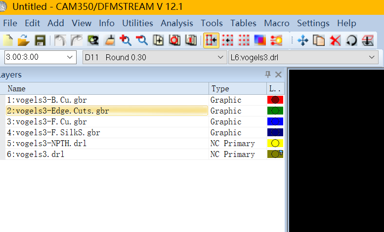

I went ahead and tried to order the PCBs from PCBway and ran into an issue. It through an error mentioning the solder mask layer was missing. I attached an image of what they sent. Thanks again for all your help! Very much looking forward to testing this board out.

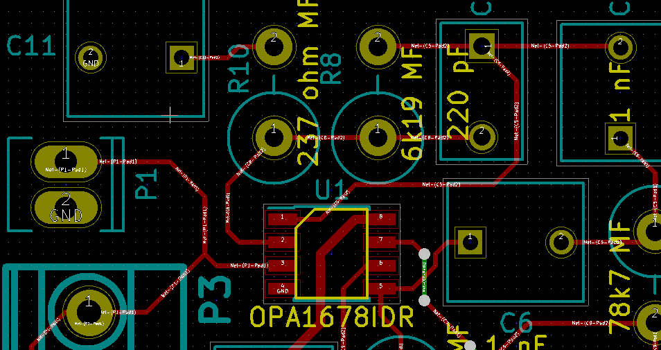

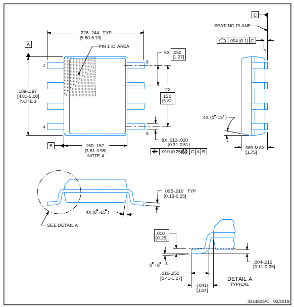

Hey Marcel, I ordered some of those mic elements to test. I have all the parts in and the pcb came in today. I am in the process of assembling and don’t know how to orient the op amp. There is a white line on the op amp but can’t make sense of the traces to figure out which direction goes where. Hope all is well.

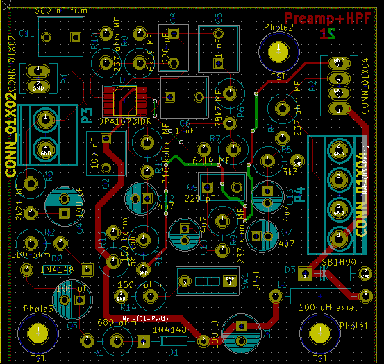

Hey Marcel, thank you for the info. I was able to get a board together, but I wasn’t able to get it to work. For p3 the positive is on top and negative on the bottom? For p4 it would be 5v voltage in positive on top and ground beneath then output positive then output ground? When assembled this way I don’t get any voltage at the input to power the mic. I will try to put another one together tomorrow morning to see if I may have cooked something. Thanks!
Hi Hal, you connected P4 incorrectly. If there was no other connection between power ground and output ground when you tried, you have a good chance that the circuit survived. Otherwise it could be that you either blew up the dual op-amp (which is very difficult to desolder without hot air station) or the Schottky diode D3.
The 1 mm (0.039 in) wide trace to D3 is the +5 V, so with P4 on the right, you have from top to bottom ground, output, ground, +5 V.
