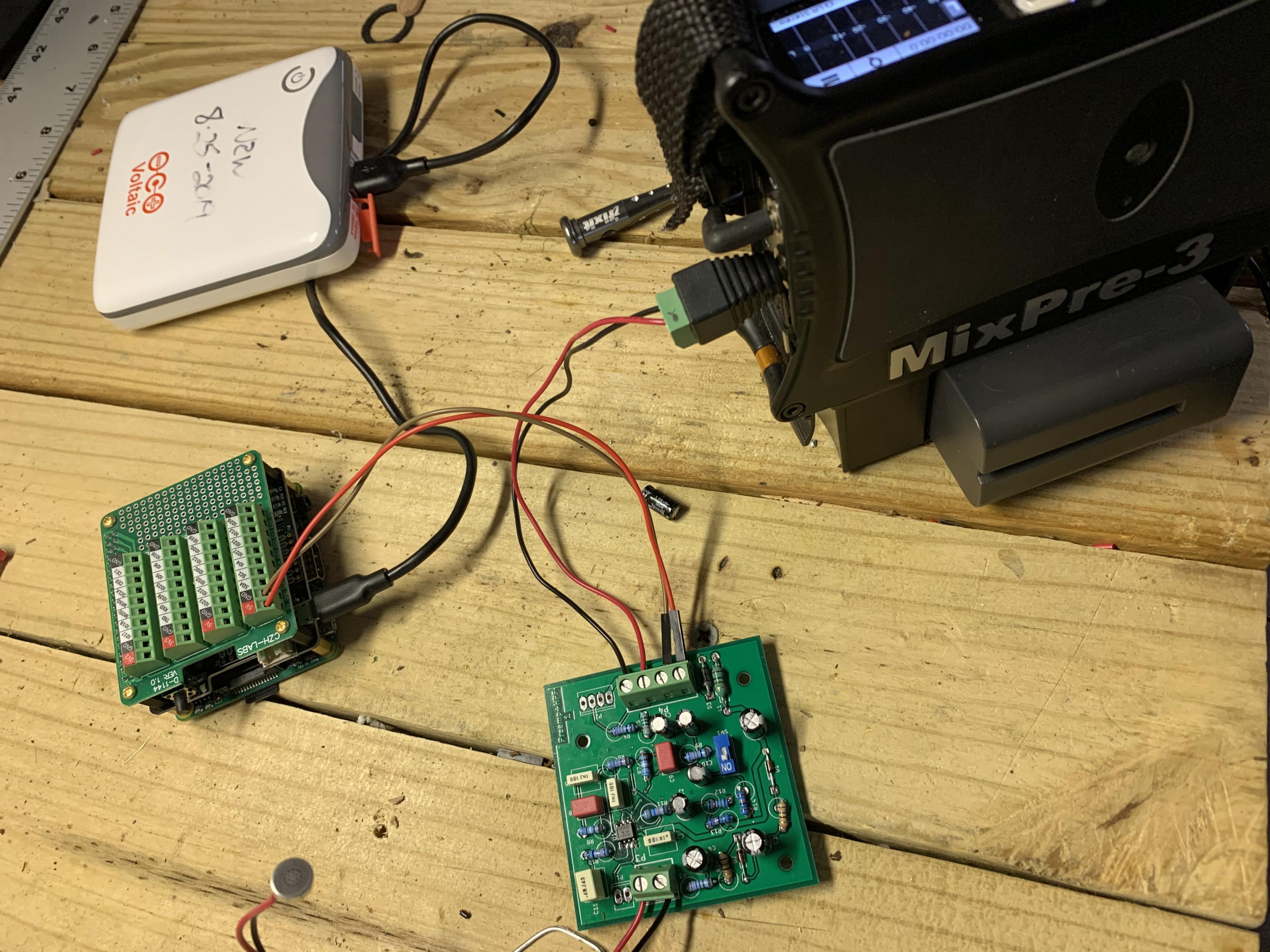

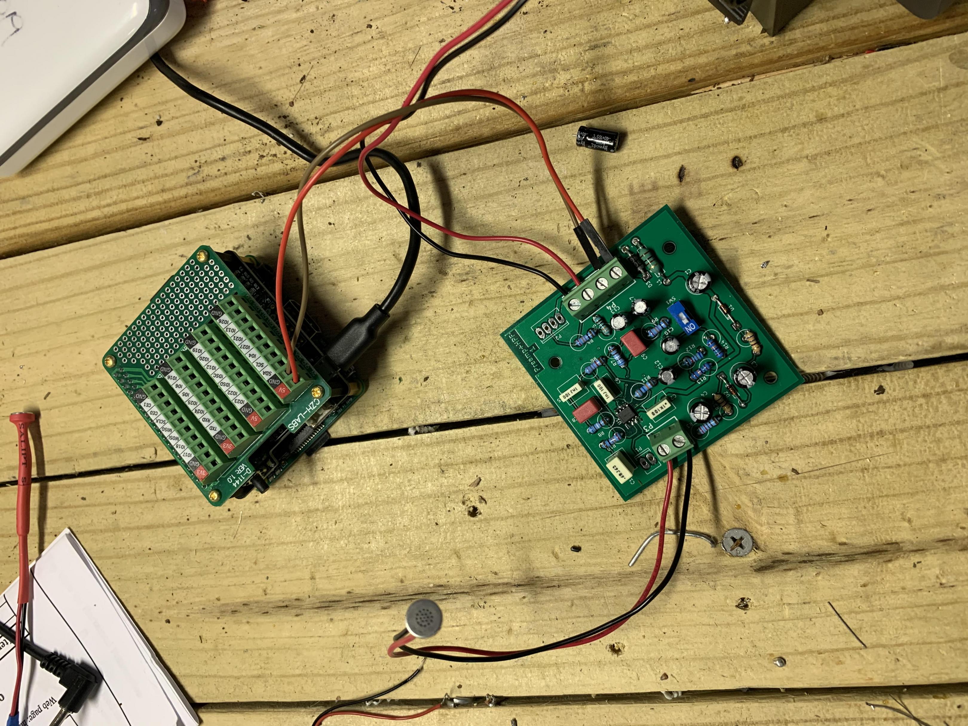

Hey Marcel, I am such a bonehead. Yep, I cooked the first one. I built another this afternoon and I am now getting a signal from the mic. It doesn't sound right though. It sounds muffled and muted. There is also a lot of interference buzzing and pops coming from the raspberry pi. I confirmed the mic is getting a little over 2v. Any ideas on what could be going on? I attached a photo of my setup. Thanks!

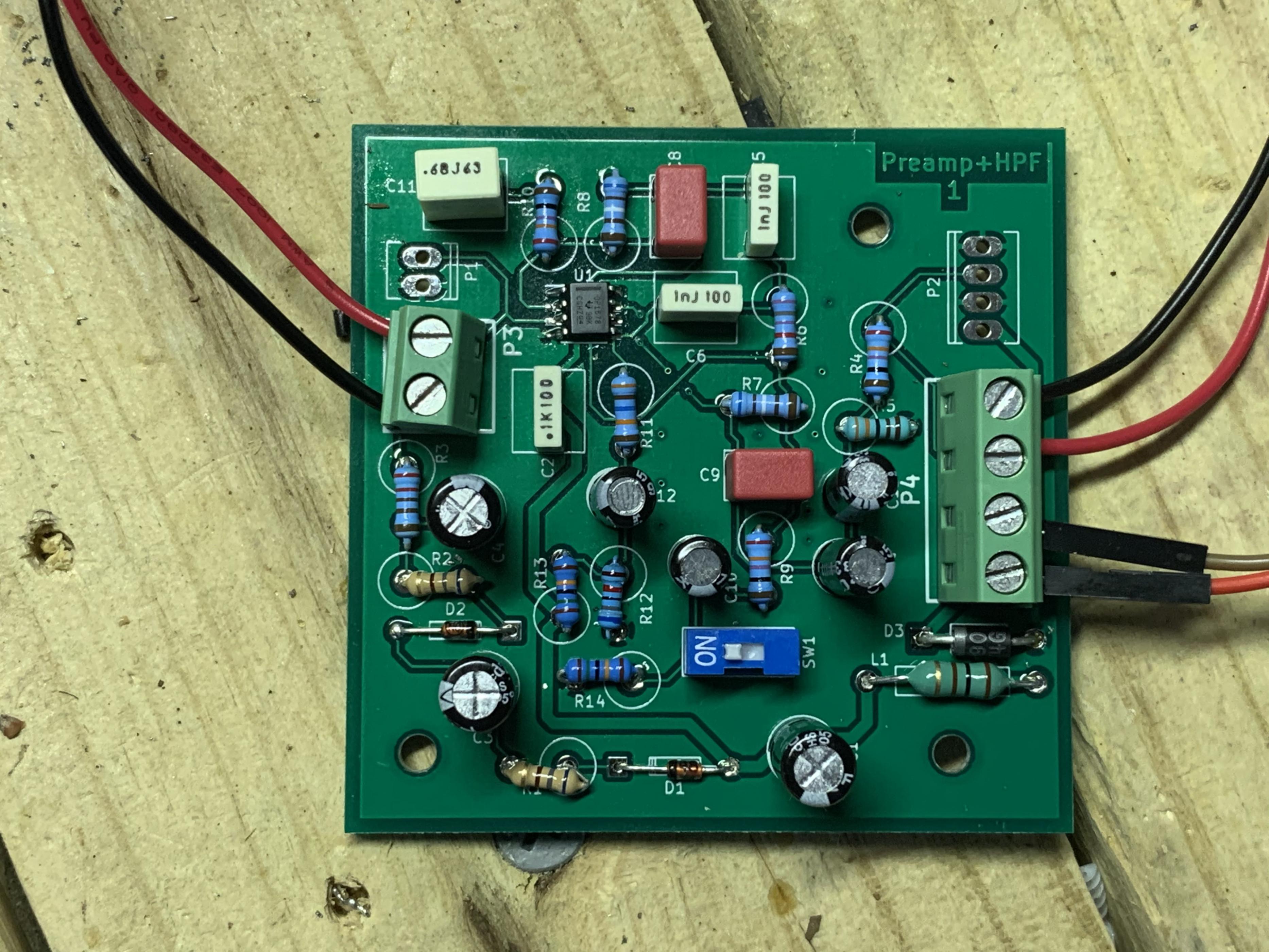

Could you check a couple of things?
1. Are pins 5...8 of the dual op-amp soldered properly? It looks a bit funny on the photos.
2. Are C8 and C9 really 220 pF and not 220 nF? I can't see it on the photos, but they seem rather large for 220 pF NP0.
3. What DC voltages do you see at pins 1 and 7 of the OPA1678 with the microphone connected? It should be about 2 V (between 1.4 V and 2.96 V) for pin 1 and about 1.5 V for pin 7.

Hey Marcel, not sure about how well those pins are soldered. Anyway I could check? The voltage between pins 1 is 2.3V and I am not getting a reading on pin 7 at all. Pin 8 is reading 4.9V. Attached a pic of the caps I used for c8 and 9. Thanks again for your help!

Could you switch off the supply and check the resistance between pin 5 of the dual op-amp and the upper pad of R11, between pin 6 and the lower pad of R6 and between pin 7 and the left pad of R7? (With "upper", "lower" and "left" I mean the orientation on the layout plot when P4 is on the right.) They should all be close to 0 ohm, any value above 2 ohm indicates poor soldering of that specific pin.
If all these connections are 0.2 ohm, apparently the soldering is OK, even though they look bad on the photos. Are you sure the pin of the meter was touching the pin of the IC and not its pad on the PCB? With the supply applied again, what DC voltages do you see at pins 5 and 6? How about the DC voltage at the side of R11 that is closest to C12?
Marcel! Third time was a charm! I re-did my solder job on the op amp and it is working beautifully now. Sounds really, really good for my purposes. This preamp is far superior to the other I was using.

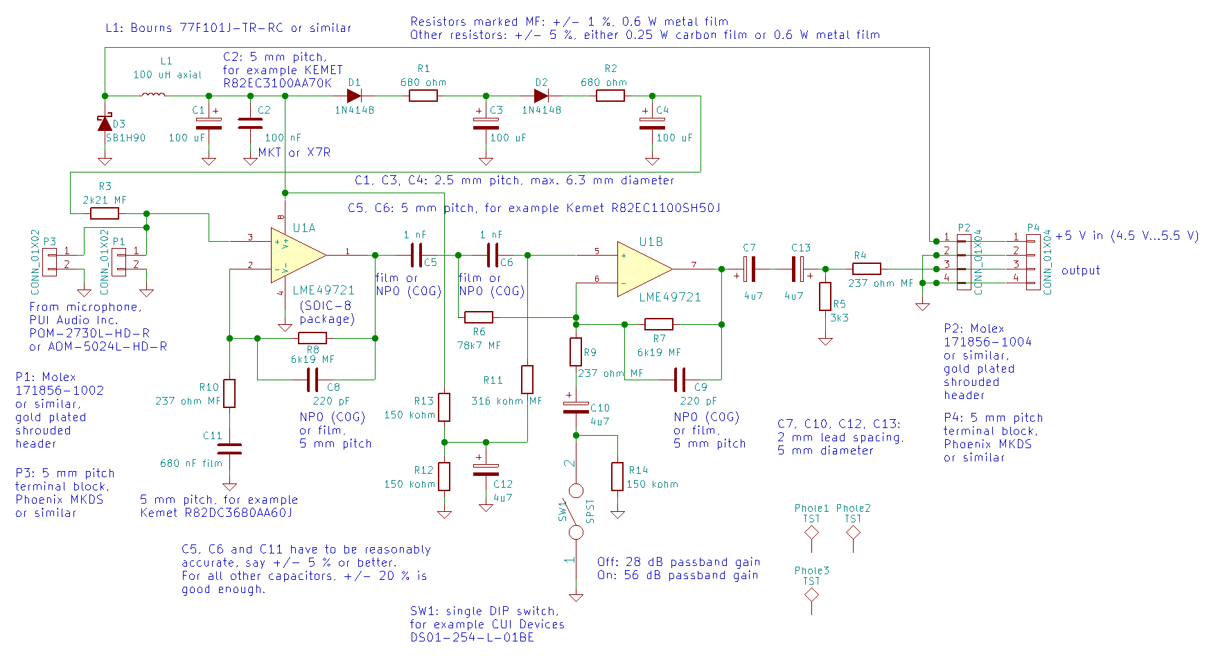

Of course you can name it. I chose those file names vogels3.*** because vogels also means birds in Dutch (unlike the Germans we don't spell all nouns with a capital), and it was my third circuit in this thread (after the preamplifier with 12 V supply and first-order filter and the proposed Adafruit module modifications that didn't work out). By the way, bird song is vogelzang in modern Dutch, but a few centuries ago it could also be spelled with an s, like in German.

The LME49721 should work very well in this preamplifier when you change R12 to 150 kohm. The DC bias voltage at pin 7 of the LME49721 should then be 2.5 V. You will have a bit more headroom than with the original circuit.
Mind you, with the LME49721, the supply voltage range will be 4.5 V to 5.5 V rather than 4.5 V to 10 V. No problem when you supply it from the Raspberry Pi's 5 V directly, just make sure never to connect it to your 9 V boost converter by mistake.
