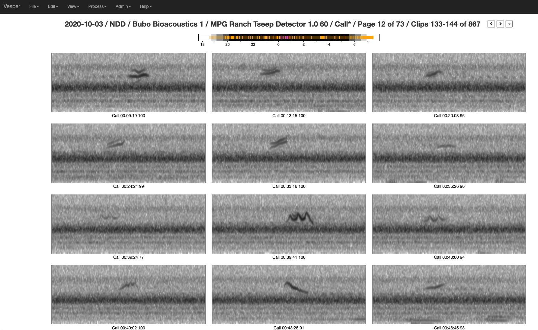

I wanted to circle back to this thread and post some results. I was able to successfully conduct a fall season of night flight call monitoring using this preamp design and microphone setup. I ran into moisture issues that I remedied with some conformal coating products and installing a moisture vent. Once I was able to configure the recorder correctly to the preamp it worked perfectly. The attached photo shows some of the many spectrograms that were processed from the collected data using this setup.
I have a question about using electrets in parallel in order to help the SNR on this setup. Would using 2 or 3 mic elements work with the current preamp design and would there be any advantage in using multiple elements for reducing self noise?

Great that you managed to solve the moisture issue and that it has all worked out well!
Regarding your question, in the circuit of post #97, you could scale down R1, R2 and R3 by a factor of n, scale up C3 and C4 by a factor of n and connect n microphone capsules in parallel. This will result in non-standard component values, but you can round R1 and R2 to the nearest E12 value, R3 to the nearest E96 value and C3 and C4 to the nearest E3 value.
As long as you manage to mount the capsules such that the bird or frog sound reaches the n capsules essentially in phase, you will get about the same signal level as with n = 1, but with almost 10 dB*log10(n) less noise. So that's about 3 dB with two microphones and 4.7 dB with three microphones. The difference in path length from the bird or frog to the various microphones has to be much less than a quarter of a wavelength.
There is more that needs to be changed when you want to use 100 microphone capsules or more, but it will probably be difficult to keep the acoustical signals in phase then anyway.
Thanks Marcel! In this case n is the number of mic elements that I would divide or multiply the resistor and capacitor values by? So, if I wanted to add 3 mic elements in parallel I would need to change R1 and R2 to 220 Ohm, R3 to 732 Ohm, C3 and C4 to 680 uF? My plan would be to cram them into the parabolic dish to be as close as possible to each other and hopefully allow for the signals to be in close phase. Thanks again for your help!
