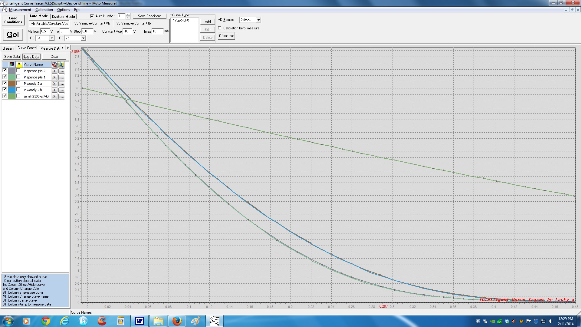

I agree that they look like GR parts. What I was thinking was that if they
are in fact not 2sj74s at all, then we have a pretty impressive imposter
since both Idss and Yfs are within the GR spec.
Given jackinnj's comment in post #46, it would be interesting to see what
the noise is like.
BTW, I neglected to mention that the parts I traced are supposed to be 2sj108V.
Dennis

Agreed IMO.
..nice curves
and nice parts
congratulations 🙂
Thanks. Now I can see if I can get more and try to match them
for an Aleph J.
Dennis

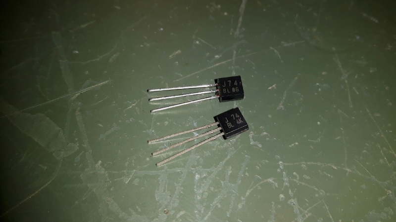

Here are 2SJ74BL's from Spencer, Woody (group buy few years back), and eBayer janeh2100. The Spencer and Woody Fets are 36mS & 32mS, but the janeh2100 Fet is obviously counterfeit at 6mS.
Also the 2SJ74BL sold by UTSOURCE at the moment are fake low-gain P-channel JFETs. At a cost below 0.5$/pcs I could not help buying a couple out of curiosity.

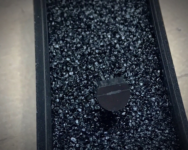

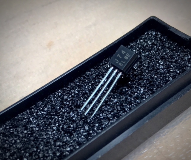

Here's a picture of a genuine part, the upper one, and what I belive is a fake, the lower one.
They don't look the same. The cut on top look different to.
I'm no expert in Gm-testing but this is what happened:
With 0.2VAC 1kHz sine wave to the gate, and 10V D-S with 1k in series, it first had higher Gm but when it got warmer and ID got up it fell like a rock. When I tested the genuine parts they behaved totally opposite.
They also had higher IDSS than the bad ones.

Fakes are definitely in the market! 😡
My genuine J74s looks similar to your genuine one.
