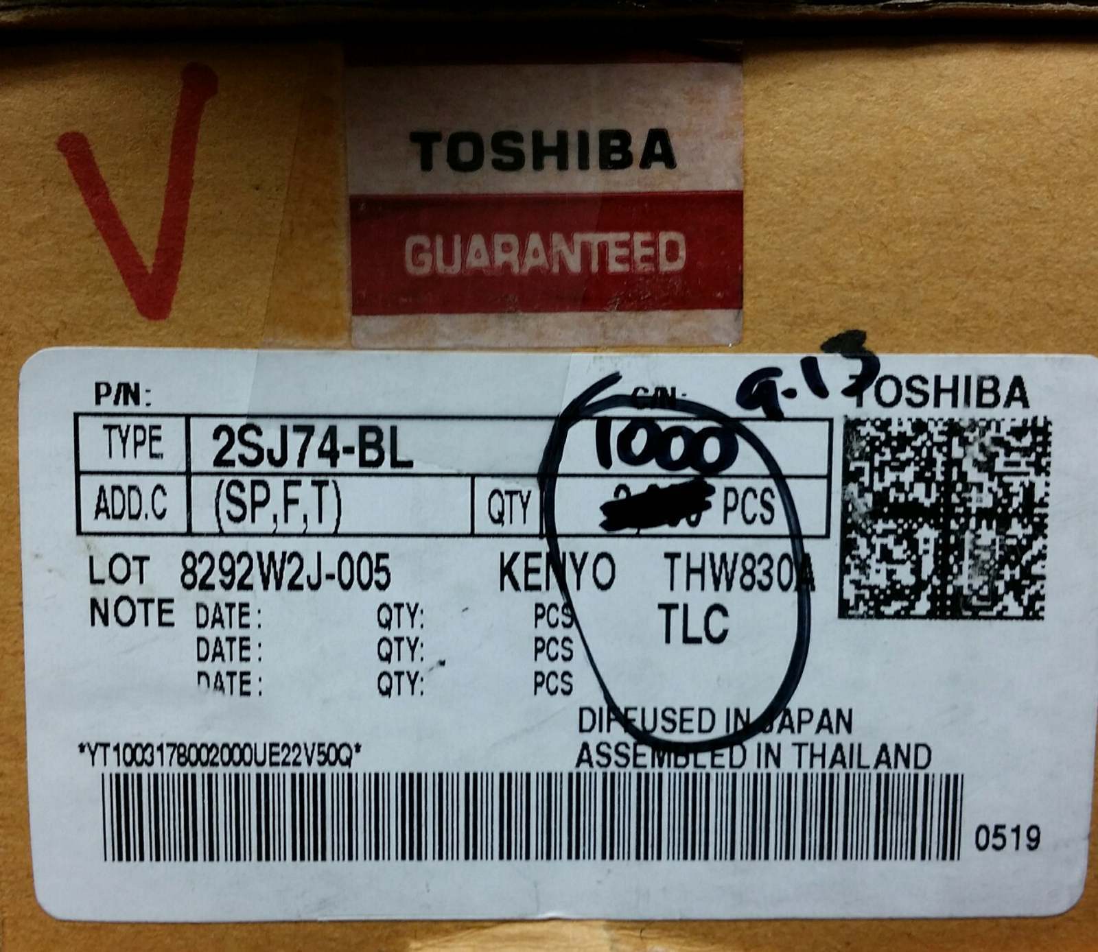

If the box is full you are a lucky camper
Unfortunately the box isn't mine:-/ But I have bought 2 matched sets of 4pcs for the front end of my new Aleph-XJ project
