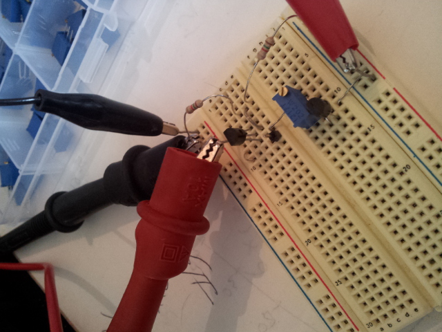

@AndrewT I did indeed do the Vp test as detailed by Borbely, I'll be redoing this morning. The jig I've set up is as per Borbely...ish. It's on a protoboard, and isn't particularly neat, but is reliable.
@WalterW. I used a J310 and a 2k trimmer to make a variable current source, and did a run with it set to 2mA and then a run at 5mA (Target current is within .1 of the target mA value. I also did a few sims of the setup so I could sanity check my results. Attached below. They are labelled as BL's and I found a matching photo elsewhere online somewhere on a Czech site that seemed to be discussing fakes. I'll try and get a decent photo later.

Attached are pics of data and jig.

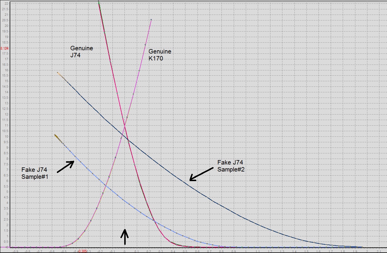

So the fake's i have have an even lower Gm than these two sample curves (thanks BenY - really quite helpful to see this visually).
Correct me if I'm wrong, but if you paralleled (for discussions sake) fake sample #1 and fake sample #2 the curve would be #1+#2? And this is the workaround to create a pseudo high Gm Jfet?
