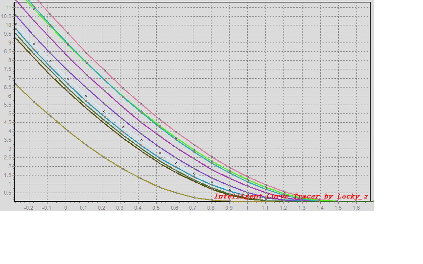

Advice on 2SJ74BL Devices
I tested 10 2SJ74BL devices I recently acquired. Attached is the distribution of Idss from lockey's curve tracer.
Using the Yfs calculation method: (Idss(Vgs@0) - Idss(Vgs@0.1))/).1
8 of the Yfs values were in the 8mS to 11mS range. 2 were about 15mS. Toshiba's spec minimum is 8mS. Parts appear to be OK; they have the yellowish marking (no silver) and no sign of any impairment or funny stuff on the body. See attached photos. (sorry, a bit fuzzy)
Can anyone with some knowledge provide some input as to probable authenticity? The only thing in doubt is Yfs, so I'm curious if anyone else has done some testing and found "real" 2SJ74's to be at the low (minimum) end of the scale.

I think they are fakes, with testing I have never found a real J74 that low on Yfs...
They are always easily around 25 to 40 mS.

...And I I understand it, the Vp should be rather less also. Particularly judging by the curves shown on page 2 of this thread...
Bogus J74s have noise densities well over 10nV/Rt Hz while originals should be under 1nV/Rt Hz. Often those bought on EBay are P-channel switches with relatively high noise.

Using the same tracer and calculation my 2SJ74BL have much higher Yfs. See here.

Thanks for your responses. I concur with both. The reason: I have a pair of 2SJ74V that I know are genuine. These tested at 15mA Idss, with Yfs at 45 for both, well above the 22 typical. I also tested my LSJ74 A grade and these came in at 23 to 30 range.
This "sample" I received from a source could have been selected for similar Idss and could be much worse had I bought an actual lot of them.

I was very skeptical on these based on the Yfs measurement. You're right, all other Toshiba parts, and even the new LSJ74 were nowhere under 20mS.

I also have the Locky_Z curve tracer and the SJ74BL's I have range from 32 to 43Yfs. I have not managed to find legit SJ74's on eBay, but surprisingly there are some genuine K170's, 372's and 369's.

Thanks for posting this information. It reaffirms what I have received are "legit" fakes (hmm.....had to think about that...oxymoron maybe?)
Any other postings I've seen support what you are saying, alazira - that Yfs values are in the range of Toshiba's published typical values, or higher. I was also able to confirm this with 2 genuine 2SJ74V devices. One had a Yfs of 43, the other about 50. Curves matched data sheet.

I have no idea what he said about "middle of the pack". I've never said anything to him about what I've seen because I've never had much experience with this device. However, I do have a bunch of genuine 2SK170 and 2SK117 I bought from Mouser years back, and they are absolutely in the Yfs ballpark from the data sheet.
The only other thing I noticed on these samples was that the plating on the leads was tight to the body, that is no copper showing. Although I'm not convinced it's a 100% verification, it seems most posts that discuss it say their valid devices are not plated all the way up, exposing some copper.
