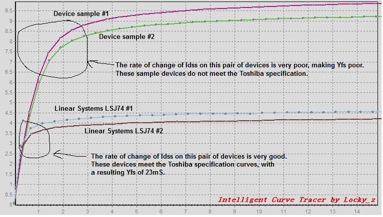

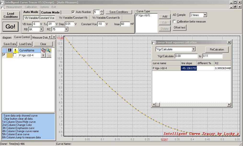

Some 2SJ74 Test Results
Last month I requested and received 10 samples from a ComponentsMax (an obsolete component vendor) who understood and believed his supplier had genuine devices. Below are some images of test results.

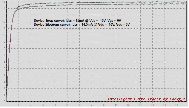

Image 1:
These are Idss curves from a pair of 2SJ74V devices I know are genuine. Note the sharp knee as the devices reach > 95% Idss.

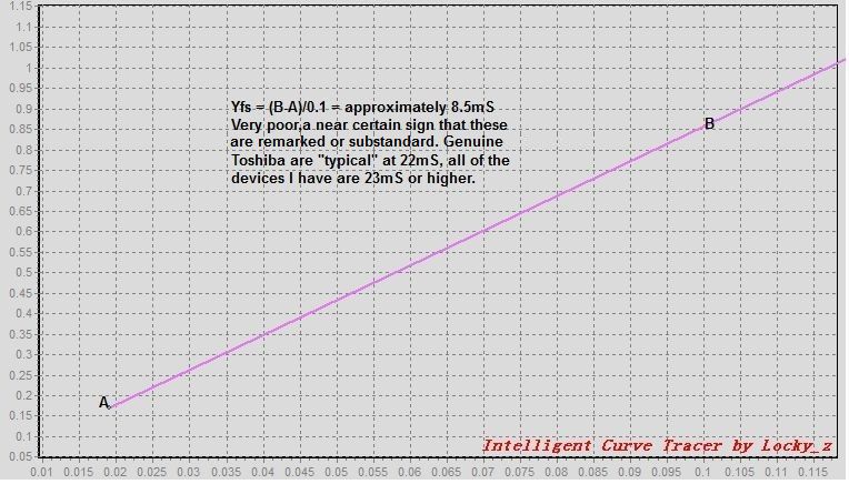

Image 2:
The objective was to clearly display the Idss change at the "knee" between the 2 pairs of devices. The image text provides what I observed in comparing a pair of known good devices (LSJ74) against the poor "samples" I received from the vendor. Note: I did not use my 2SJ74V devices here as the Idss of those was close to 15mA on those devices and wanted to display devices that were closer in value. Although I indicated they don't meet the Toshiba specification, in fact they do, but at the very lowest value.
Image 3:
This is an image showing the calculated Yfs for one of the "sample" devices I received. The other tested device was identical. Although Toshiba's 2SJ74 data sheet says a minimum Yfs of 8mS, I have yet to test a known genuine device, or new manufactured device that is lower than 23mS.

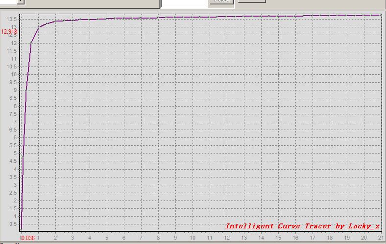

Image 4:
Yfs for one of the 2SJ74V devices (as in Image 1)

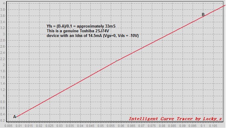

Image 5:
This group of Idss curves is from a lot of 4 genuine Toshiba devices I purchased from DIYA member Tony Woods. I didn't ask Tony what test setup he used, but he included his test numbers. My absolute value was out by just 600uA, but the lot variance was identical to his numbers. I think this is important information for anyone needing to know how close (or how far) the locky_z tester to someone else's test data.

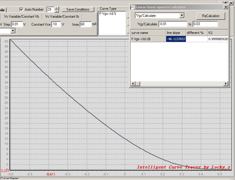

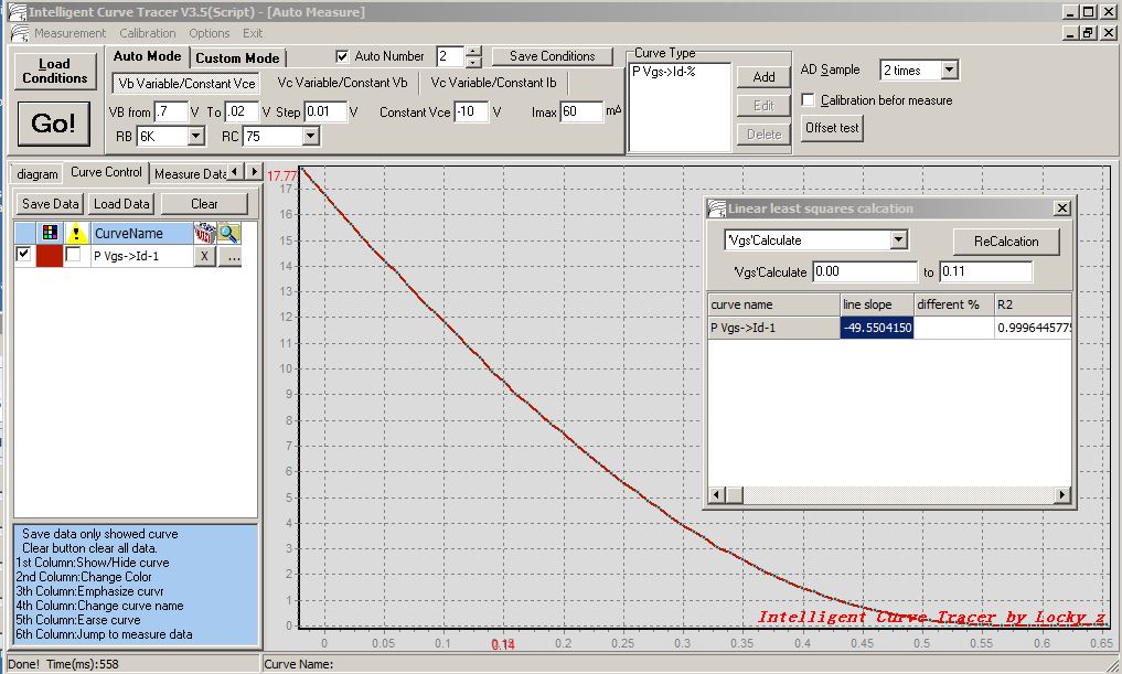

Is this real?
I received a locky_z tracer recently and just started learning to use it.
I did the following traces on a V-grade part I got recently. I think it's genuine.
Does it look ok to you?
Thanks,
Dennis

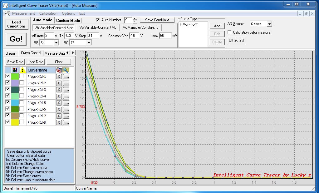

An idea: instead of using the right-click function in the software "copy to clipboard", just use the Windows snipping tool. This way, when you post the test, it's easy to see what the settings were. See the attached image of some devices I bought from eBay seller "polida". They are marked 2SJ74BL, but there's just no way they are BL grade, these are GR grade. There isn't a single device out of 8 pieces over 6mA, and they are grouped closer to 4mA. Yfs seems about right for GR grade as well, about 20 to 30. Can't imagine how these could be marked with a BL, given those measurements. I have genuine BL devices that measure exactly in the middle of the 6mA to 12mA range, Yfs about 40-ish.
The second capture is a closeup of the 0 to 0.1 to see the Idss to calculate Yfs.
By the way, I bought some 2SK170BL devices as well from ebay seller polida, those were genuine and tested perfect in the center of the BL range, about 8.5mA to 10.5mA.
Another way to tell suspicious (possibly re-branded) devices: under a good desk magnifier, notice the face of the device where the printing is; it seems to be a shade lighter than the rest of the device's body, as if it were sanded off and then printed on. I have several genuine Toshiba devices and the gloss of the black face of the device is consistent with the rest of the device.

Gentlemen, thank you for your suggestions.
I traced the same part again, as well as a second one I have.
If I'm interpreting things correctly, the idss and Yfs
of the two parts are ~12mA, ~45mS and ~16.5mA and ~49mS
respectively. These seem consistent with the V grade marking.
Roger, I'd like to think your "BL" parts with the low Idss are
either badly out of spec or relabeled 2sj74 GR. If they are not
2sj74GRs they certain mimic them well.
Thanks,
Dennis

Agreed IMO.
..nice curves
and nice parts
congratulations :)

Yes...as I pointed out, the curves seem to be for GR devices, not BL.
I've notified the seller and awaiting their response.
I also have V spec devices whose Idss at VGs = 0 @ -10Vds is about 17mA.
