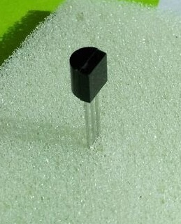

If you wish I can test them for you, but you should be able to find somebody much closer to your place😉I could ship a pair of 2sk170/2sj74 for anyone who would like to help me to test on curve tracer?
Hi WalterW
top side will be posted when I back home tonight!
yes correct, these look like real JFET's from Toshiba, the shape is good and the stripe is in the middle.
Where did you source them? 😀🙂

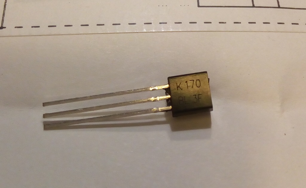

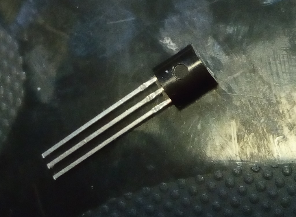

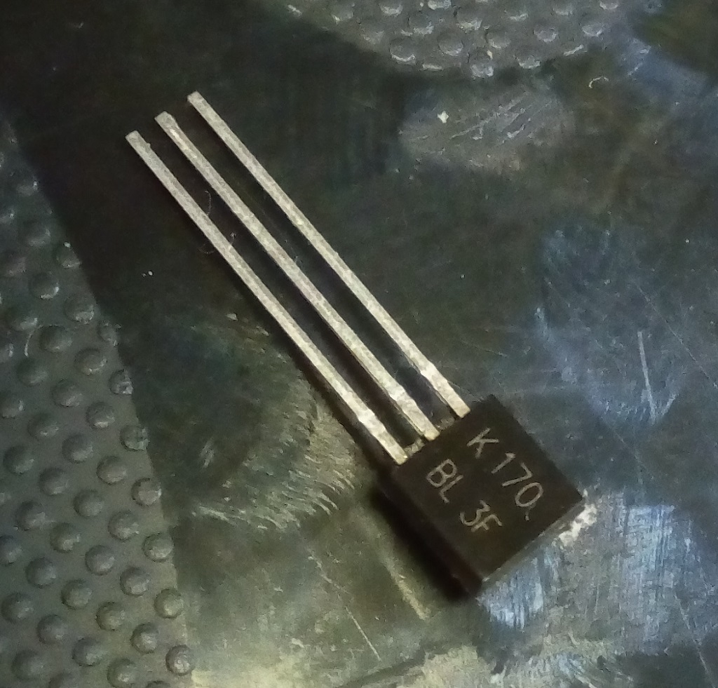

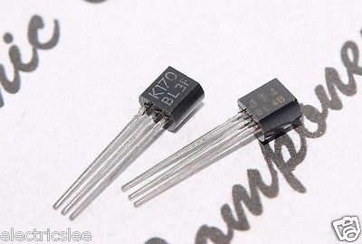

2sk170 verification
Hi there,
I received this few days ago, from ebay, so I had no time to measure them (yet), and considering price they have slim chances to be genuine, but they "look" decent, including stripe few posts earlier (edit: I have rechecked, stripe is not in the middle, so there may be some concern).
Until they are checked (well, with my limited resources and knowledge, I could use 9V battery to measure Idss, and maybe find someone with dual 10V PSU for voltage check), what do you think, based on pictures?
Normally, I buy from member alweit, for any project that has importance 🙂
Photos have been taken with mobile phone so quality is not the best, sorry.

It's Toshiba jfet crisisHi there,
I received this few days ago, from ebay....what do you think, based on pictures?

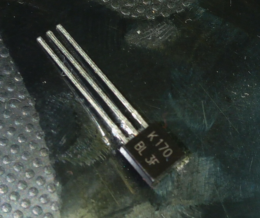

here are some more photos

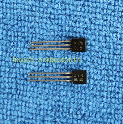

Fakes indeed. 🙁😡
Look at the font: the '1' must be just a straight line, with no 'rooftop' on it. The '7' should be slightly bent.
The stripe on top should be in the middle.

I'm not sure they are fakes and I'm not sure your attitude is right.
I have seen a lot of genuine devices with very different writing. Also, genuine K170 are not that rare - yet. Very different story for J74.
Official components distributors don't sell K170/J74 - so not an option.
The LSK170/LSJ74 from the diyAudio store are not Toshiba K170/J74 (lower Yfs, higher noise), and as far as I know no free shipping from the diyAudio store.
Reality is a bit more complex than you think.

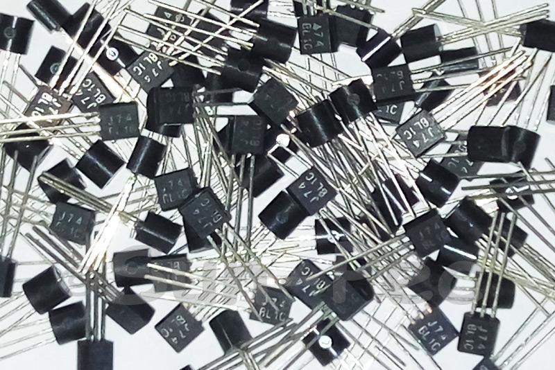

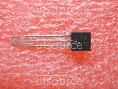

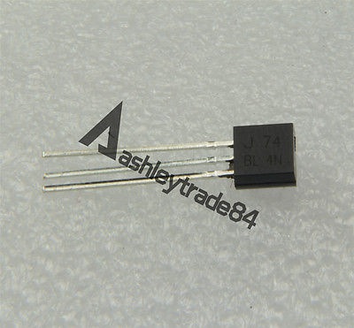

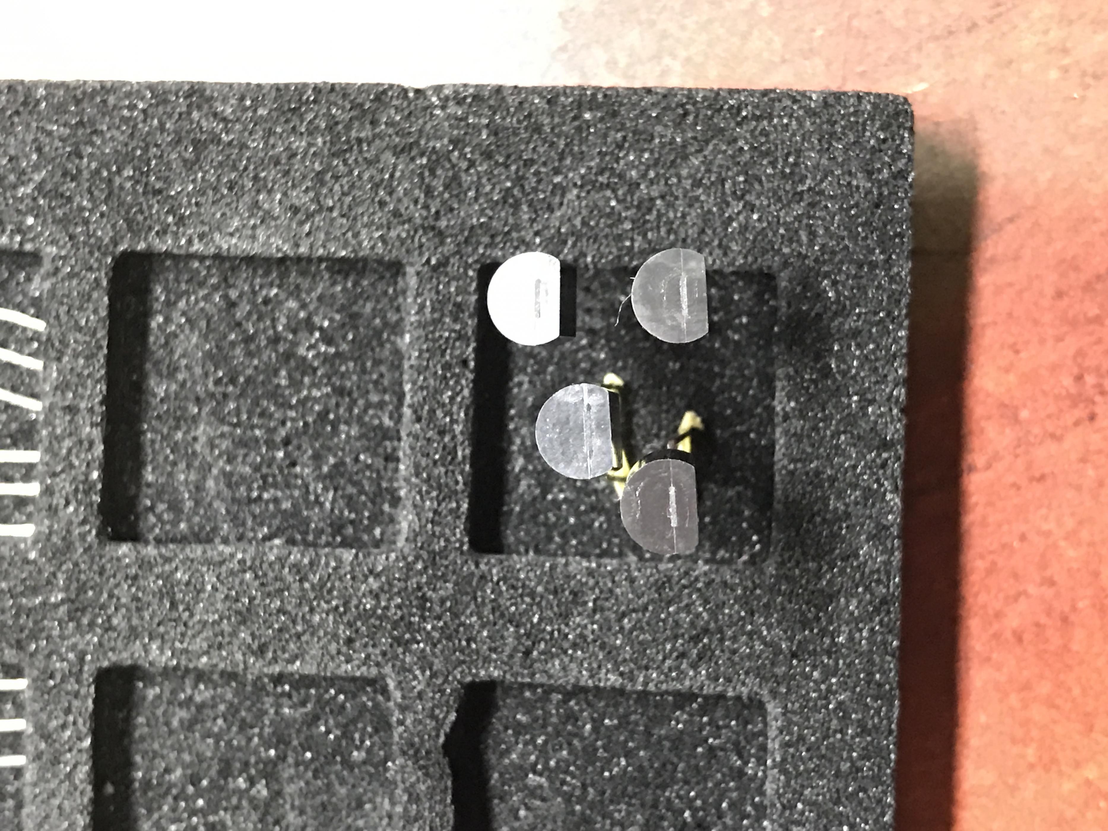

Hahaha photo ok i write you what the story
but please could you explain me meaning of this photos first ?

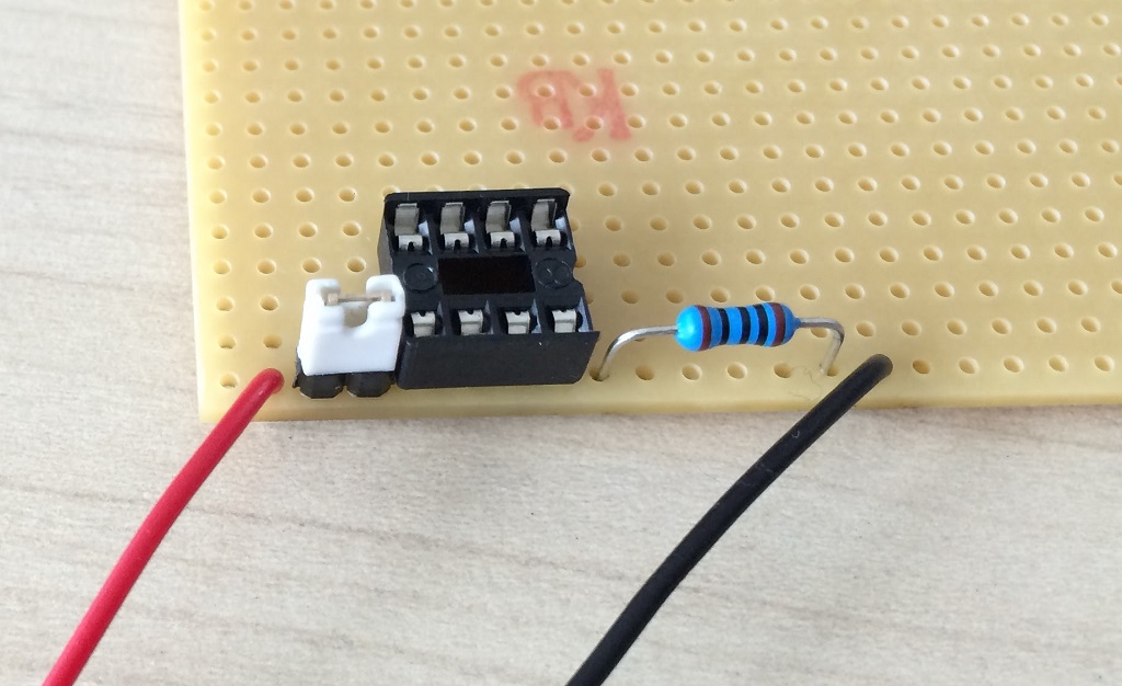

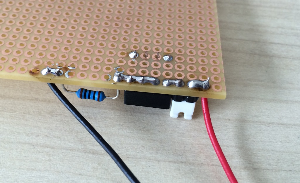

Okay,
test time 🙂
Well, basic one, Idss measuring. So, by (many times repeated) on this forum I assembled a small jig.
Jumper is there to disconnect battery when switching components (anyway, it's late now, but, do I need to disconnect battery when swapping transistors ?).
My soldering isn't best, but will do.
Resistor is 100 OHM, power supply will be 9V battery, I need to find one 🙂.
O coruse, I will keep my eye on duration of each test, and voltage (that is what I am measuring) rise or fall.
Ill post results, and maybe (I am pretty sure it wont be needed) I'll assemble jig MK2 for Vp measuring and some calculations, but dual psu is slightly problem for me..
