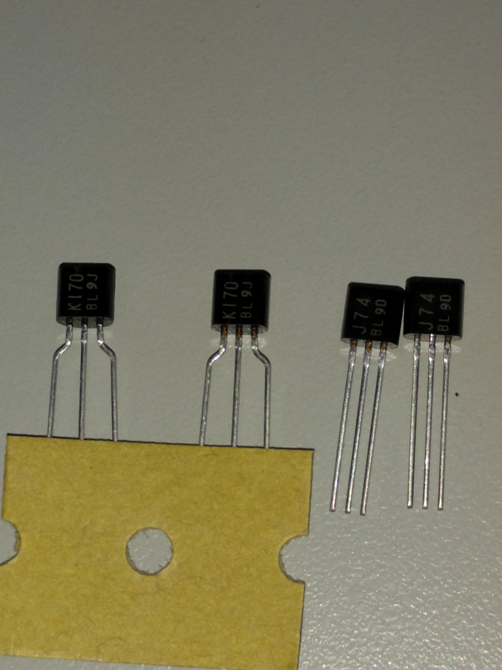

My genuine ones exactly like this.

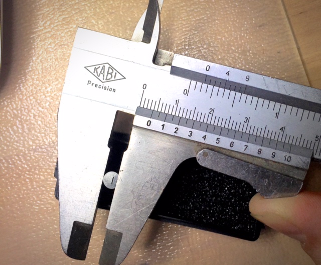

Have you measured diameter between flat front and rounded back?
Original ones have a diameter 3.9mm.
Fakes are of course have a little smaller, say 3.4-3.6 mm.
Fakes are definitely in the market! 😡
My genuine J74s looks similar to your genuine one.

Well, time runs fast sometimes, but some measurments have been done.
At first I had no current diodes for the Borbely rig. But I hope that I got this right anyway.
The result are as follows (10% measured=4psc each N/P). 10V.
For transconductance 0,1Vpp 1kHz sine was applied and output was measured with Rd 1k at Idss. Gm calculated as in Borbely papers.
"2Sk170BL"
Vp 1,304-1,350 V
Idss 15,27-16,92 mA
Out 1,32-1,34 V
Gm 23,42-25,18
V-grade should have higher Gm so what may they be ?
"2SJ74BL"
Vp 1,929-2,098 V
Idss 7,30-8,20 mA
Out 0,200-0,270 V
Gm 7,51-7,81
One intresting thing is that the current goes down when they get warmer. On my genuine parts the current goes up a bit before stabilizing...
They were bought at Banzai music. I will contact them 🙁
But the SJ103Y and SK246 GR they sent seem to fit the specs. Sadley they didn't send the same grade, but one can't get it all 🙄

the first group of 2sk170BL have too high an Idss.
That makes the markings = fake
The second group of 2sj74BL
have too high Vpinchoff (for that range of Idss) and that leads to a calaculation of the gm that is too low.
That makes the markings = fake.

More than 10000 of J74 came through my hands, so I just want to share my experience.
Most of 2SK74/2SK170 has laser marking and the font all the time is the same, marking
is very sharp - I saw some fake J74 with very similiar font and laser marking, but the lines were not so well-done, although most of fakes has printed marking with color similiar to laser, but this making easy removable by acetone. Some items of old production (I had a box of 2SJ74BL 1998 production) has white print marking - but is is impossible to remove it with acetone, alchohol, etc - fake marking usually easy removable.
IDSS of genuine items always according datasheet - I have never seen even one outside the range. During IDSS measuring, the current of GR/BL slowly goes up (till some value, of course) - fake often has idss that reaches maximum at the beginning, then goes down - exception is "V" grade with high IDSS - it also goes down.
All things that people told about the item thickness is right - usually fakes are thinner.
I testednot a long time ago faked 2SK170GR, good laser marking, font a bit smaller than original - this was suspicious, and IDSS is in range(!!!), but curves were different - looked like J310 as I remember.
You can post pictures of your J74/K170, and usually I can say by picture, is it genuine or not.

Dear Alweit,
Thank you, that confirmed my observation about diametre!
Last batch SJ74BL I've bought, seemed to be original, according to Idss measurement.
Also it have a shining surface with laser marking, quite good font types and colour,
Although line of 7 is straight, rather than curved a little.
But they didn't behave well in my Sony VFET amp.

Last week I got a refund for the fake Jfets.
I hope they will investigate if they have sold to others of the same batch, but I guess not

Hi alweit,
Genuine or fake from the pictures?
Hi alweit,
I could ship a pair of 2sk170/2sj74 for anyone who would like to help me to test on curve tracer?
show us the top side, they look real for now 🙂
