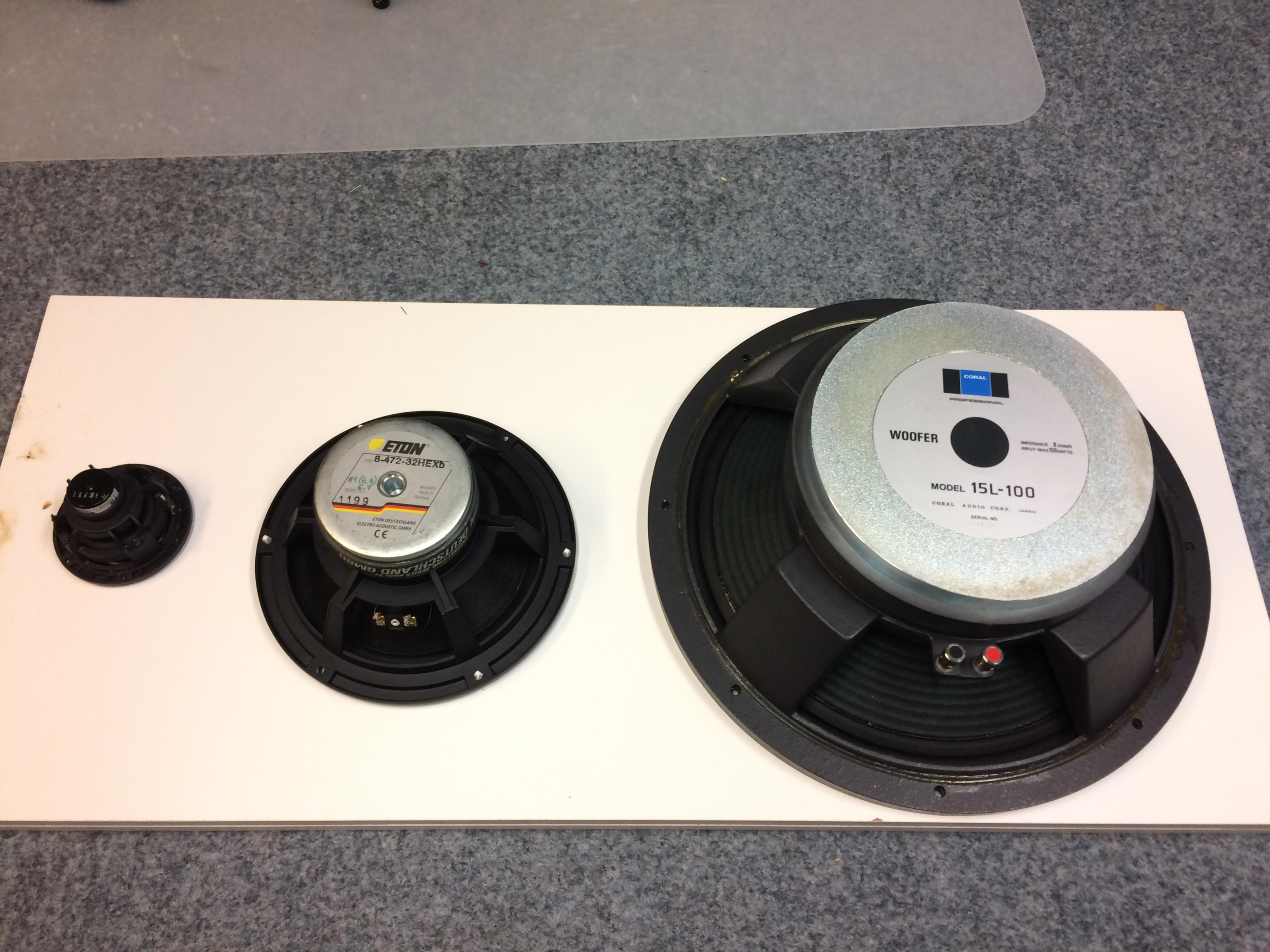

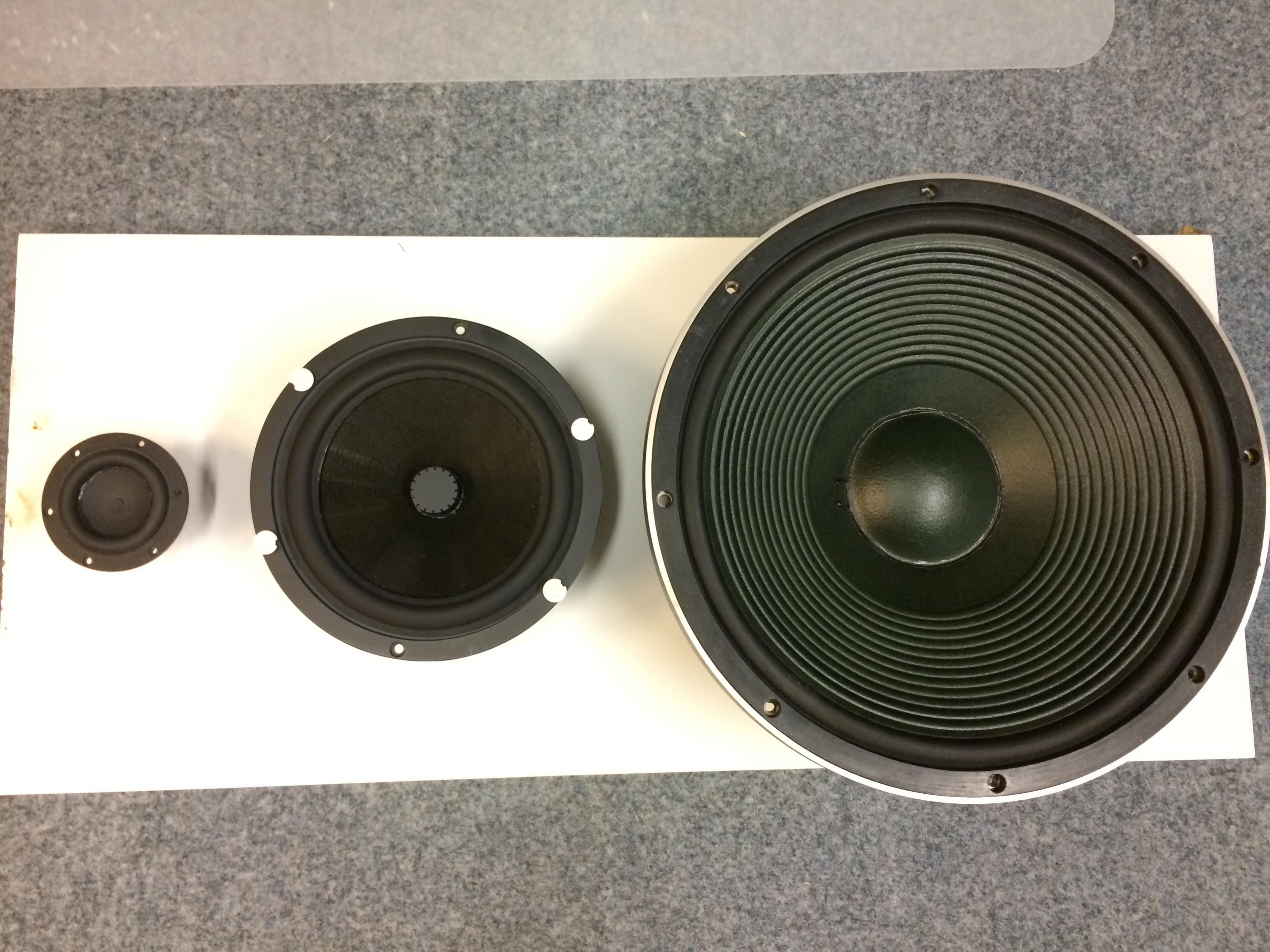

My first MFB project might be with focus of one of the three speakers as in the photo. A 15# Coral bass with underhung voice coil, a 8" Eton with stiff carbon fibre cone and long throw voce coil and finally two TangBand 3# with longthrow voicecoil connected i series.
Targets
1) Reduced volume
2) Reduced distortion
3) Low -3dB Fs
Most interesting I find the two 3" bass in series with only one sensor in a smallest cabinet. Is that at all thinkable? And anyone, is this thread the place to start the project?
Cool! Some observations/suggestions that come to mind based on my limited experience:
- small enclosures with higher system Q's are entirely possible and can even be beneficial in some ways (e.g. for larger drivers, shifting amplitude up at higher frequencies to provide a higher feedback factor at harmonics requiring suppression)
- need to evaluate where/how an accelerometer can be mounted (and what accelerometer and what accel I/F circuitry...)
- watch out for high system Q at new resonance due to increase in effective mass (m+m')
- with reasonably matched drivers an accelerometer in only one should work reasonably well, but you will have to closely match including the added mass on the second driver
- the accelerometer mount needs to be extremely rigid and resonance free in band
- the F3 goal needs to be reasonable for the size of driver. It is unfortunate that drivers have excursion limits. 🙂

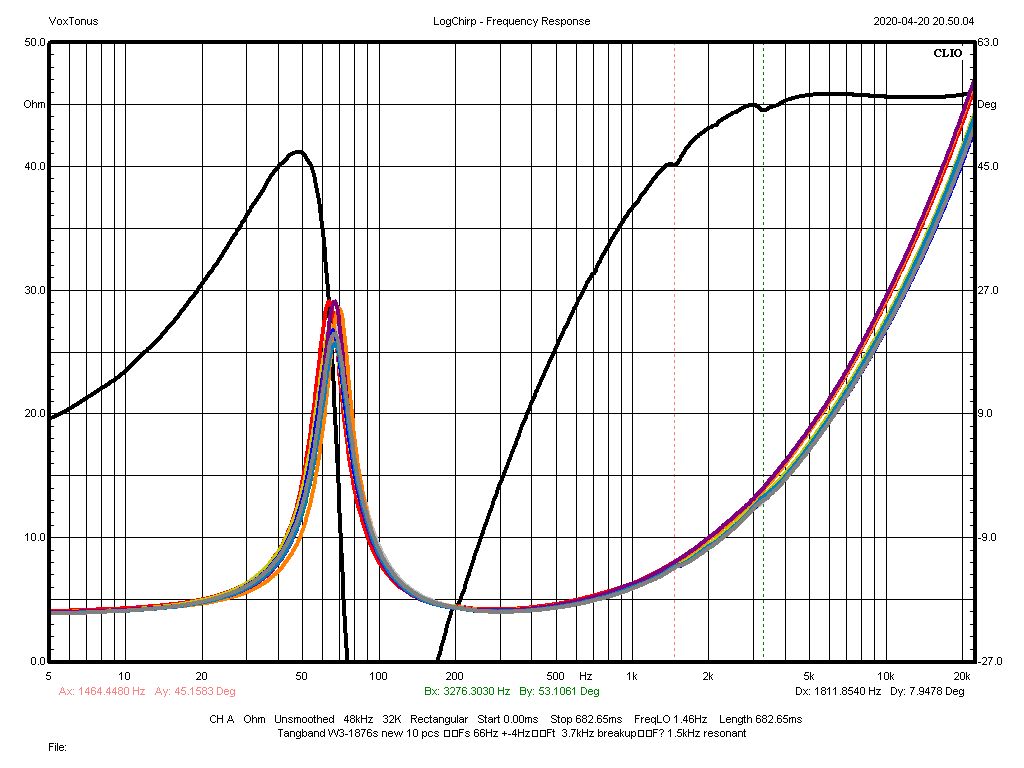

To start with I have measured impedance and phase of 10 bass drivers tangband w3-1876 with the purpose to find 4 candidates for the MBF project. Resonant frequency variations Fs 66Hz+-4 Hz. The impedance is very clean whith a first small glitz at 1.5kHz and at breakup frequency Ft 3.2 kHz.
The cone is made from PP, forming an inverted dome with a double injected suspension of santopren. At the center there is a centering hole for the injection inlet. This seem to be perfect for fastening a 3D printed sensor holder that will reinforce pistonic behaviour.
Spec of driver show there is a fairly strong motor and not to soft suspension. Cone weight is 10 g and cone area 27 cm2. Thus not very much SPL. A closed 0.4 litre box with two drivers gives a Qts 0.94
The question is if its a good driver for MFB and second is there a sensor that will fit and weigh only 2g or less?
