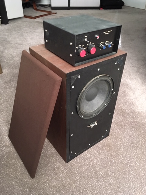

I don't have any pictures of the original prototype, but attached is a pic taken recently of one of the two speakers that were built for my own use back in 1982 along with the MFB control box for a stereo pair. Note the drivers are P/N AD80671/MFB which were round versions of the original octagonal driver P/N AD8067/MFB. I think these were available in the later years the MFB drivers were produced. You could just order these drivers and 12" versions directly from a Philips distributor at the time.

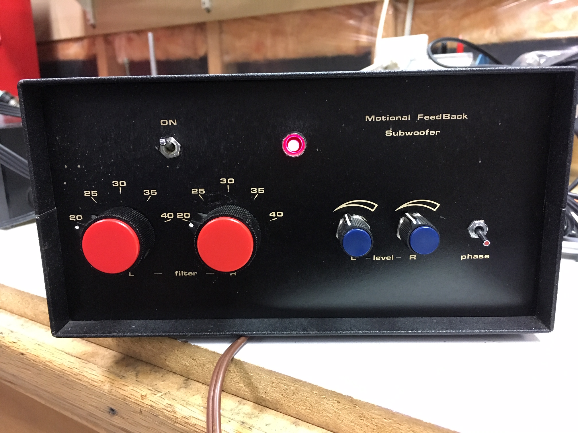

I dug out the MFB control box and took pictures of the front and rear panels. Note the unlabeled connectors at the rear! Fortunately, I found a note in the file that defines the connections so I won't have to take it apart to figure that out. IN is from a preamp, OUT goes to a power amplifier and ACC OUTPUT (IN) is the signal from the accelerometers. The two holes provide access to multi-turn pots to adjust feedback gain.

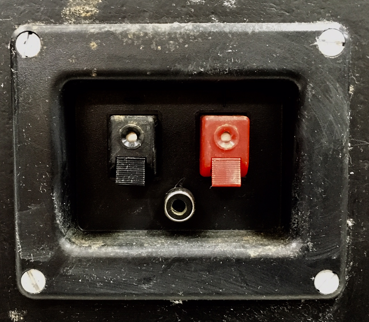

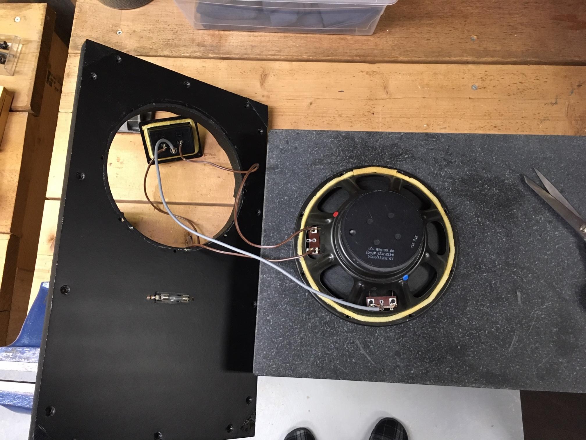

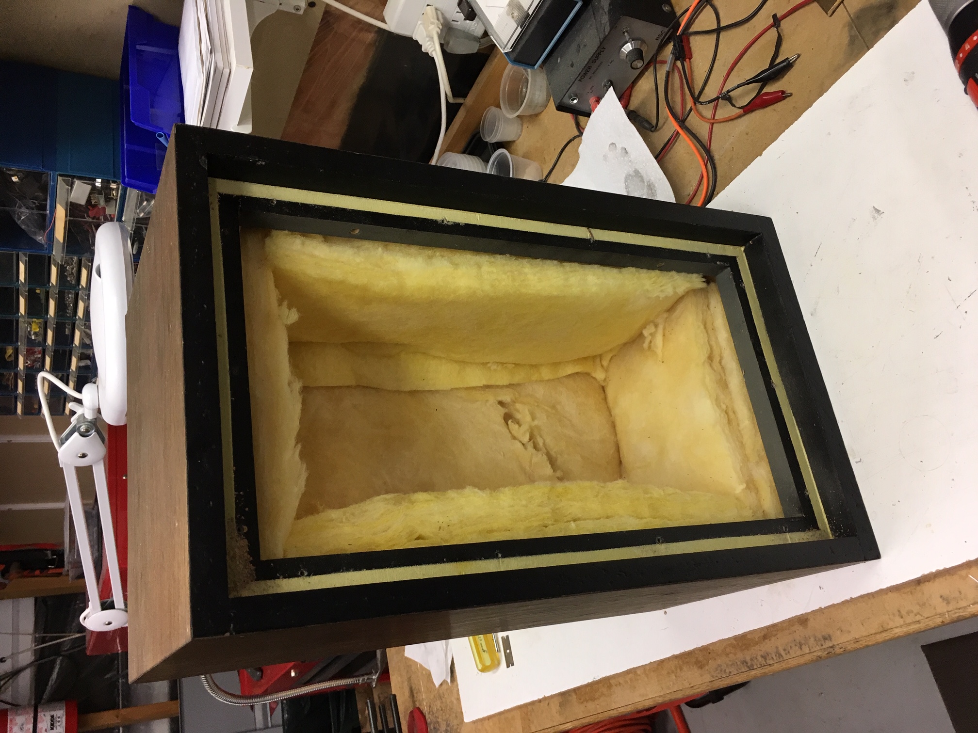

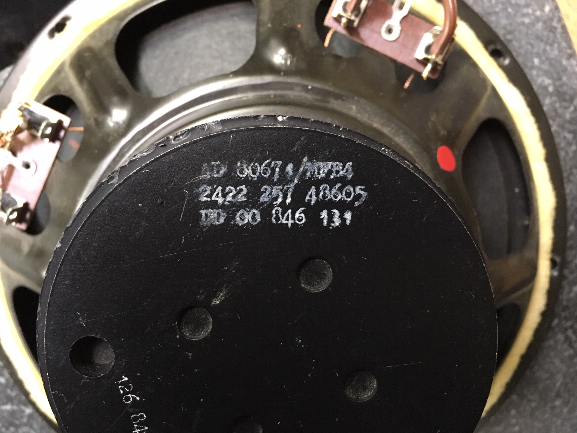

I took some pictures of one of the speakers and took it apart to get a look at the driver. I'll also measure the T/S parameters while I have it apart. I was surprised at the contamination on the exterior surfaces. I guess this sort of thing happens when something sits in the basement for a long time.
Note the extra connection for the accelerometer on the speaker connection plate. I don't know where I found this plate but it was exactly what I needed. Note also the fuse in the front baffle. I usually used a 1.5A Fast Blo to be extra safe but up to 2A was okay. With the fuse I didn't have to worry about damaging the driver if I adjusted the feedback too high or turned the volume up too loud for a particularly "bassy" recording.

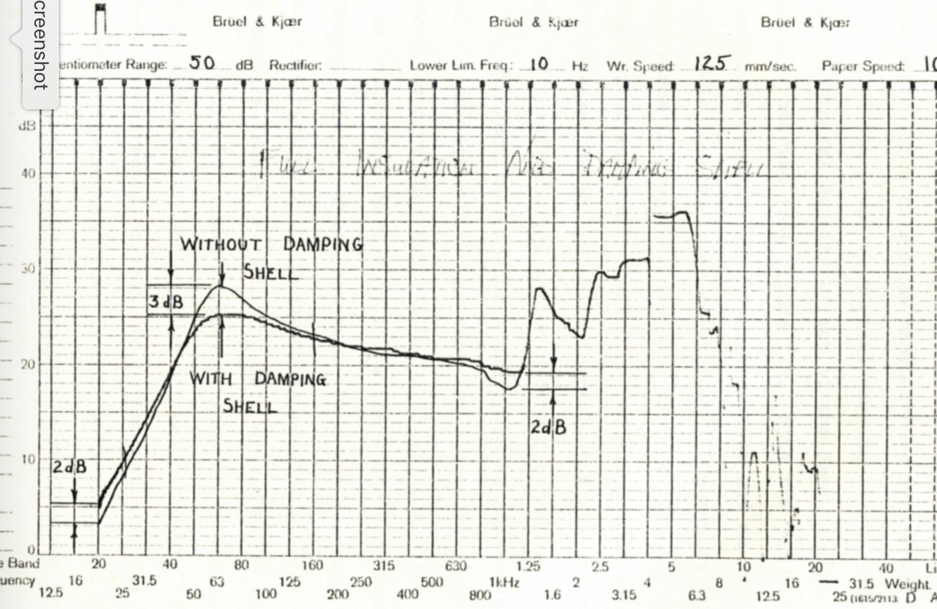

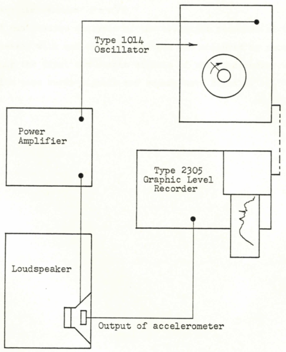

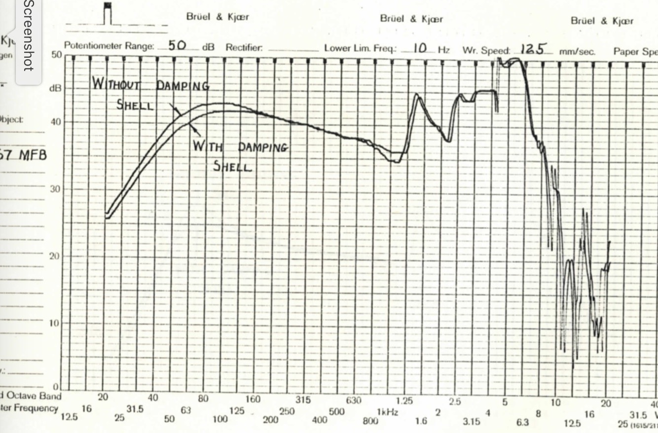

Here is the original test setup to measure the output of the accelerometer and the amplitude response curve. This is a bit of a sidebar, but at the time I was also experimenting with the effect of additional mechanical damping. The difference was more obvious when using a tube amplifier with low damping factor as shown in the last chart.

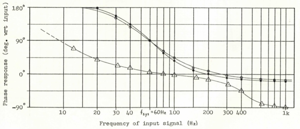

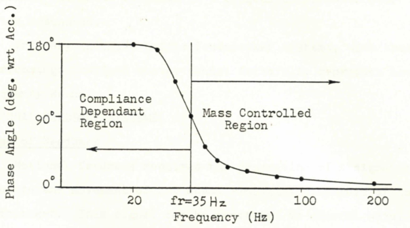

This is a generic graphic from the report I should have included earlier just to illustrate the phase shift that occurs relative to acceleration as a speaker mounted in a closed box goes through its "corner frequency".

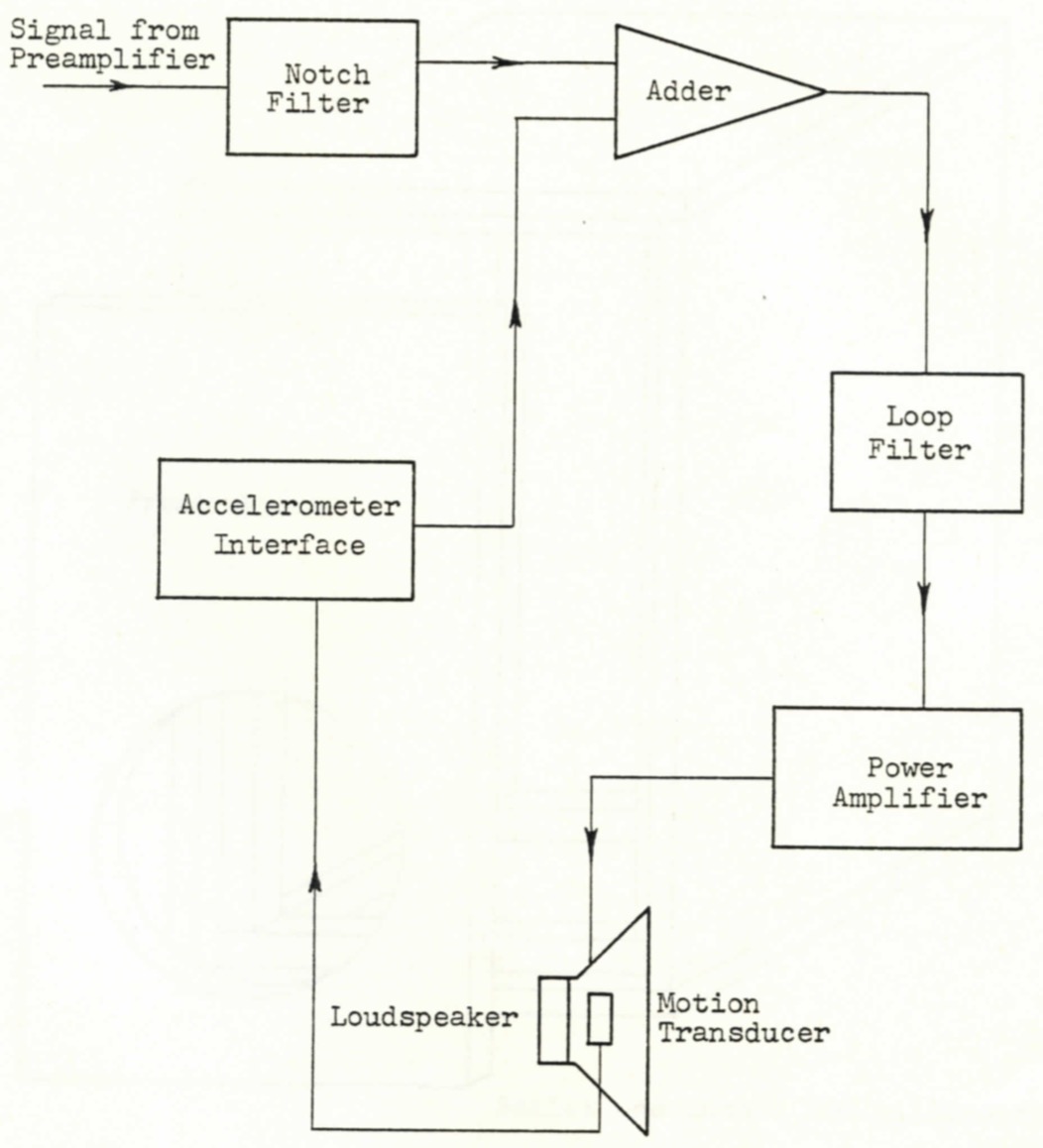

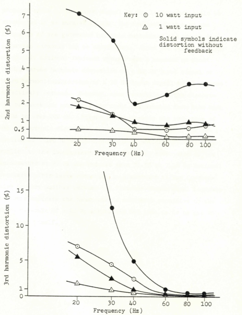

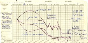

Skipping to other observations and results, here is a block diagram of the system tested, the closed loop amplitude response and the open and closed phase response as documented in the report.

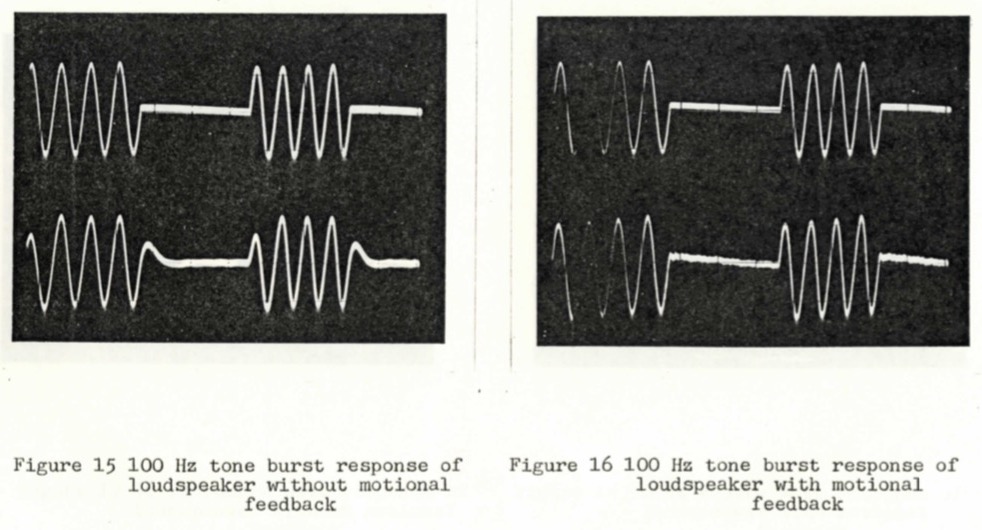

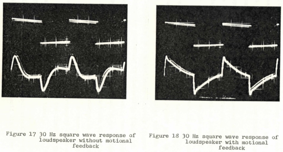

Tone Burst and Transient response as documented in the report. Note the overall system Q without feedback was above one - more on this later.

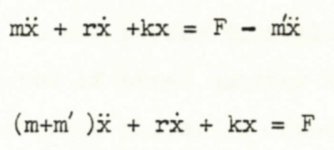

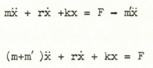

The equation of motion that equates acceleration, velocity and displacement forcing factors to total force provides some interesting results as feedback is applied. Put simply and as originally documented in the Philips paper of 1968, adding different types of feedback impacts the system in different ways:
- acceleration increases mass and Q,
- velocity increases damping reducing Q, and
- displacement feedback increases stiffness increasing Fr and Q

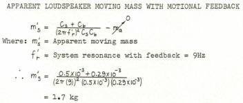

The images show the equation with acceleration feedback. Negative feedback reduces the Force and rearranging indicates the increase in "apparent effective mass". This increase in "apparent effective mass" was clearly observable by forcing the driver with the fingers. It really did feel very heavy.

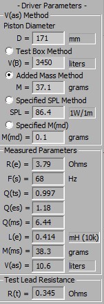

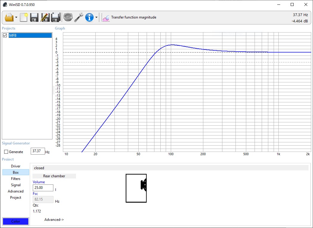

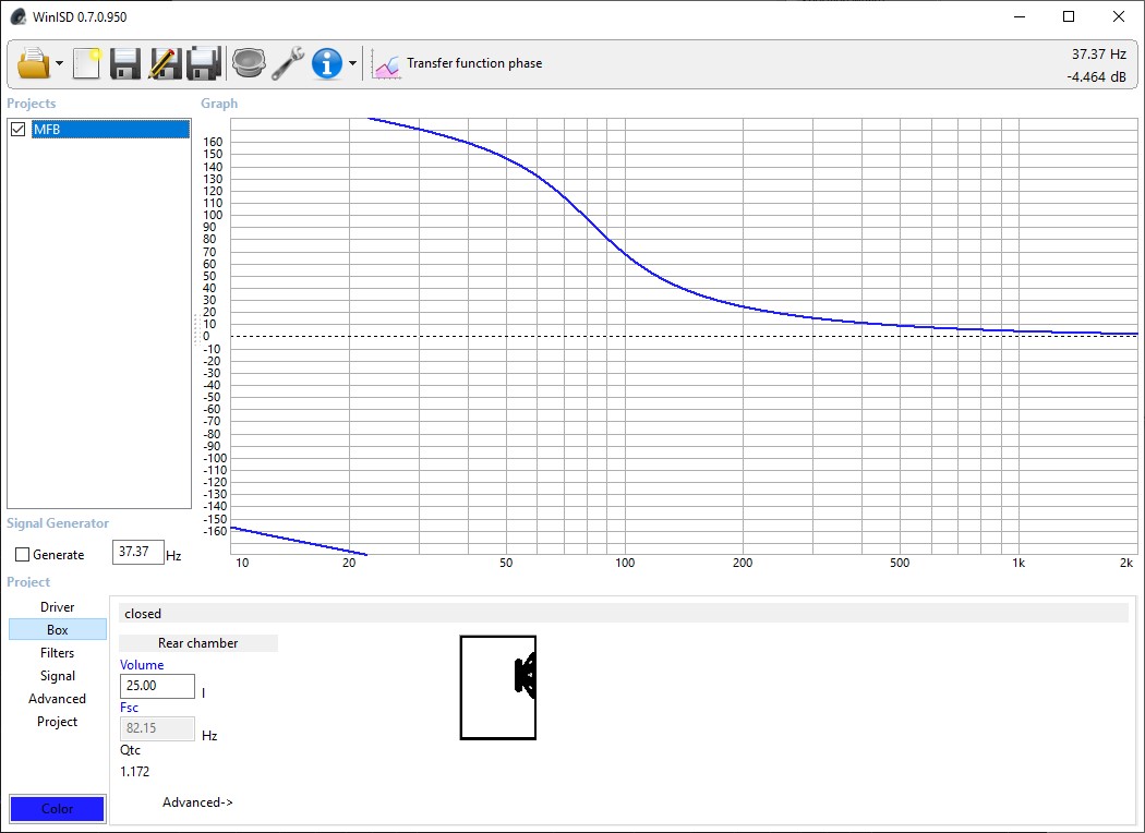

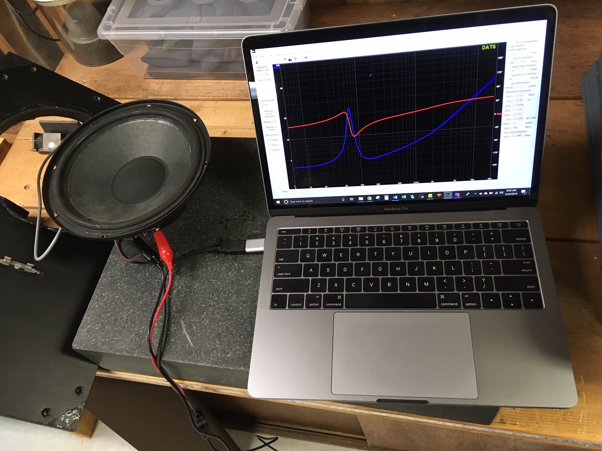

The spec sheets available for the AD8067/MFB driver didn't have T/S parameters back in those days. I tested one of the AD80671/MFB drivers and got the results in the first image from a "DATS V2" measurement tool.
Putting these parameters into WinISD with a 25 litre enclosure and it yielded the transfer function in the next two images. Note the overall Q is almost 1.2. Go back to Post #8.

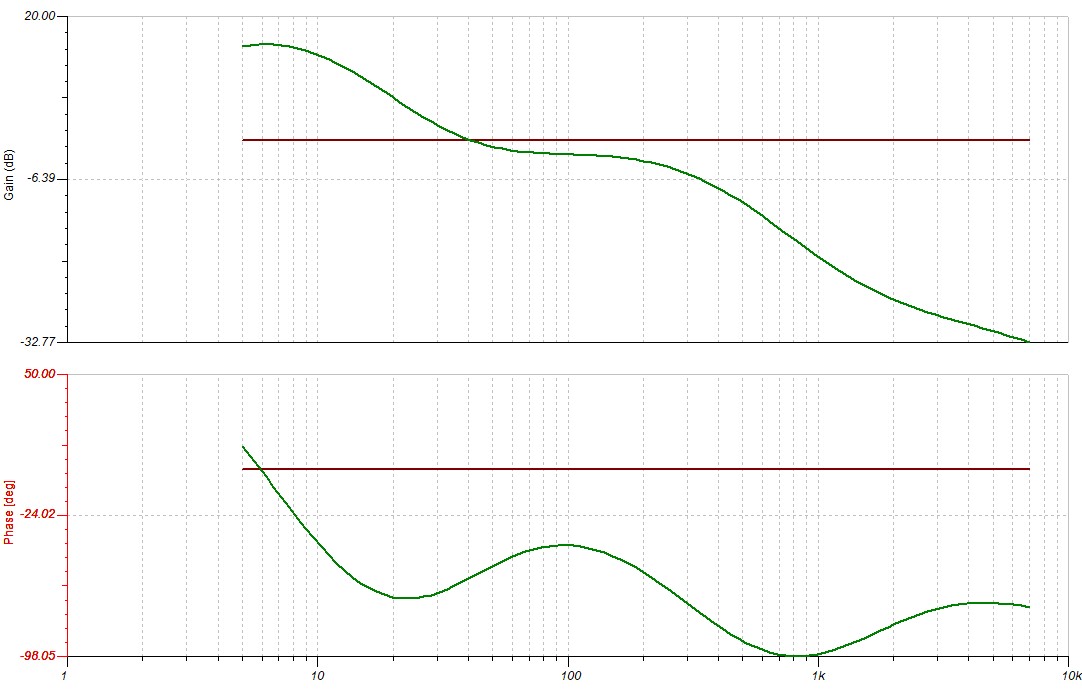

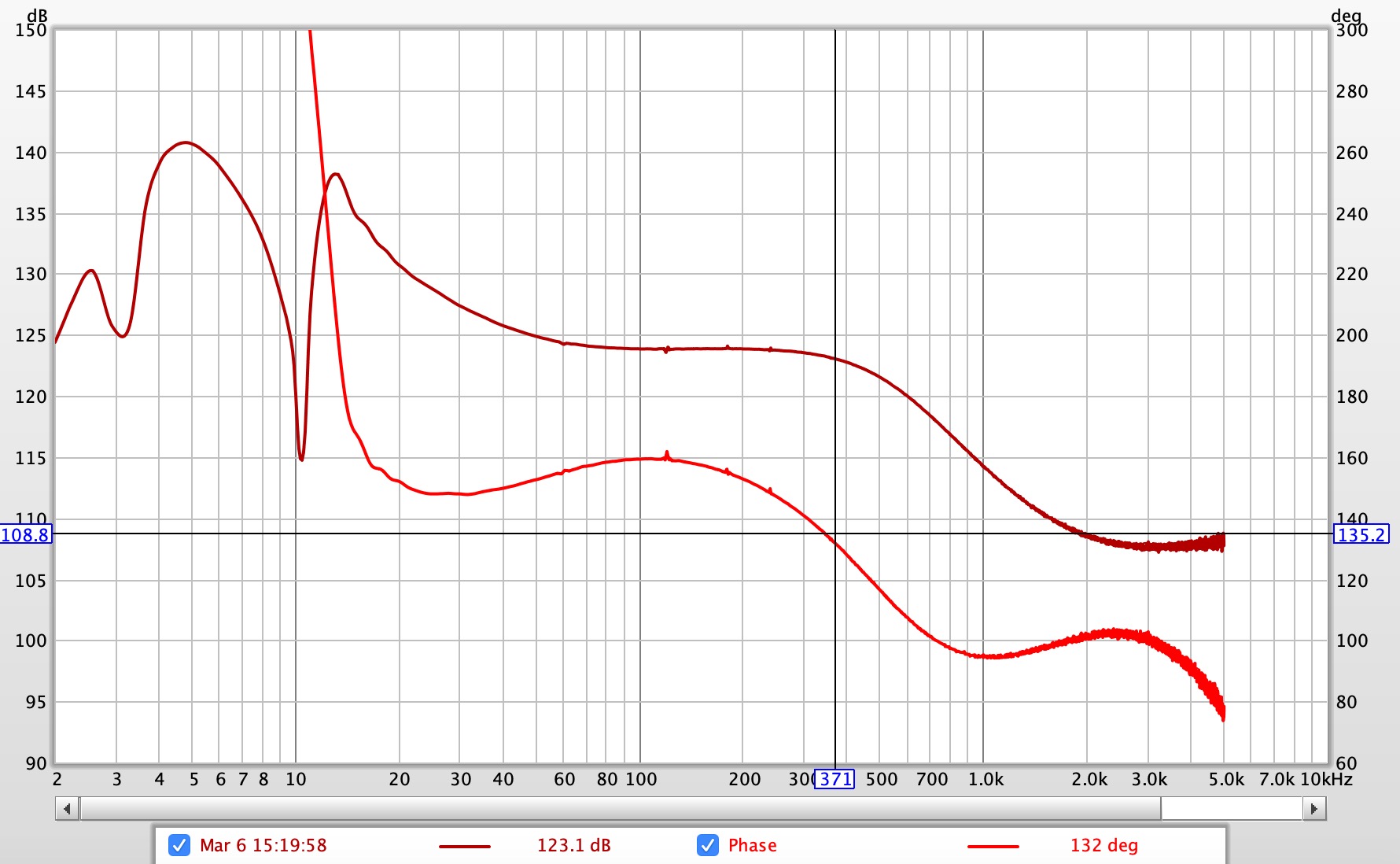

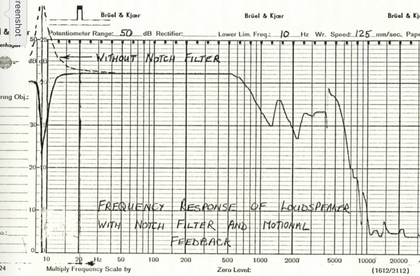

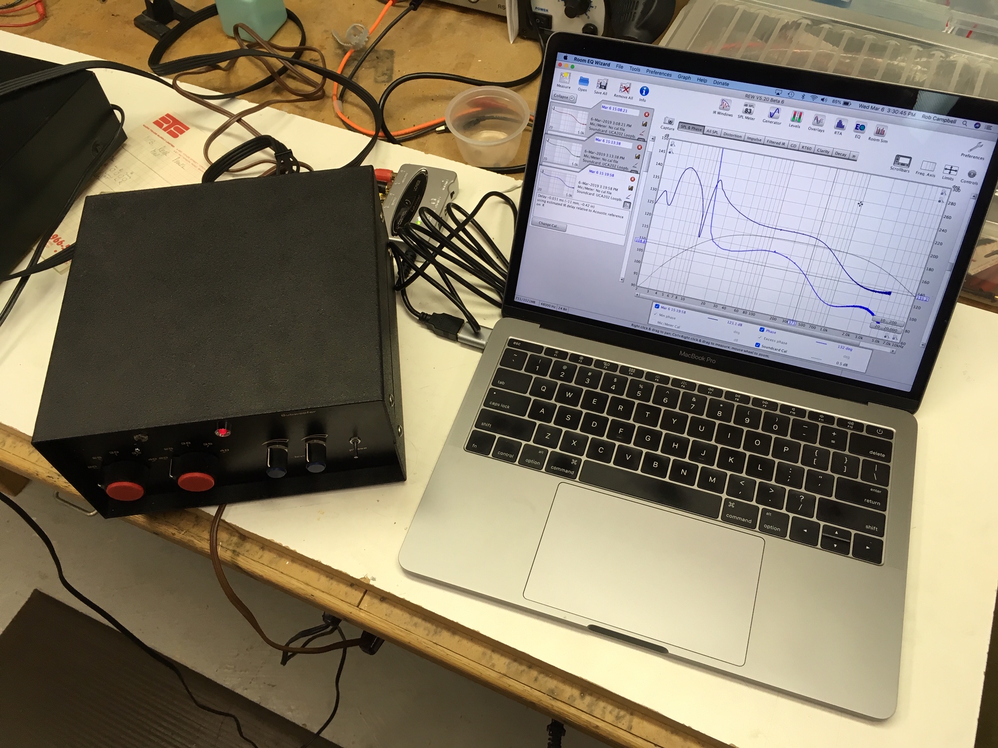

I purchased a USB sound card and figured I could use REW to get a Bode plot of the open loop response of the MFB control box from Line In to Line Out. The first problem was the toggle switch for power was seized and had to be replaced. The second problem was no output. After opening up the box and re-seating all the op amp chips (they are all 8-pin DIPs in sockets) I finally got a signal to measure.
The plot is attached. Note that the path measured includes other circuitry in addition to the Loop Filter within the feedback loop. Namely:
- overall level adjustment (to match the main stereo pair with which these are used), and
- 2nd order high-pass filter (adjustable from 20 - 40 Hz), and
- 10 Hz notch filter (to address system resonance with feedback)
Once these are taken into account, the response seems to look like it should.

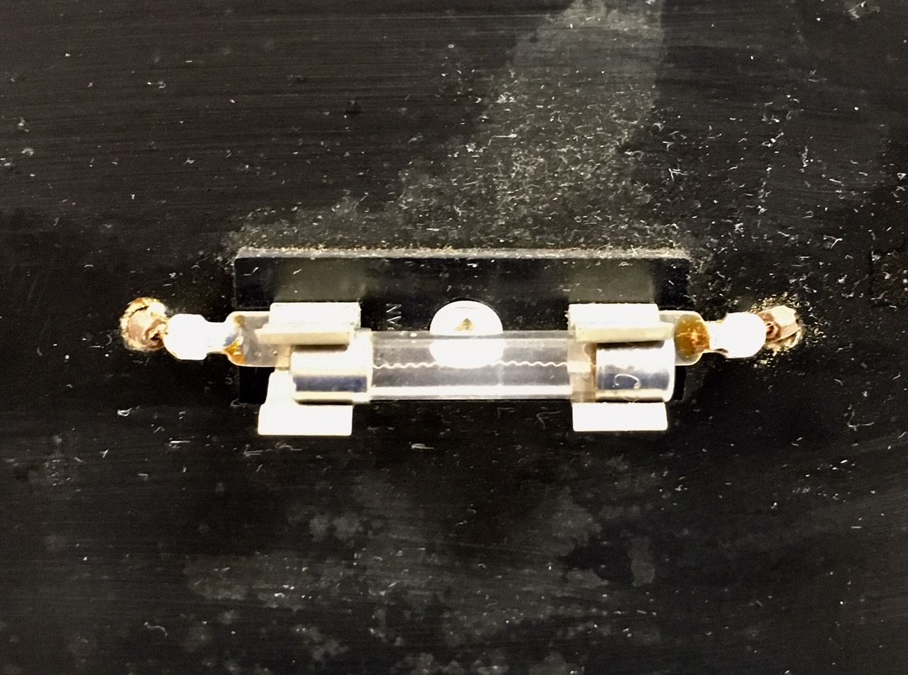

rscamp was clever enough to put a fuse in series with the element... i fried several peerless 831857. Fuse is a good thing!
I built 10 systems in total based on your article back in the early 90s. This was the reason for me to study electronics. I was a student and the first day with "regulation theory" I went bananas asking too many questions about phase margins and Q-factors.
My 80 or so class mates, who was tired on my questions didn´t really like the subject.
However, me myself loved the lessons and i still keep your magazine in a plastic bag!
+1...rscamp was clever enough to put a fuse in series with the element... i fried several peerless 831857. Fuse is a good thing!
Ha, ha, I fried a Klipschorn.... one very sad day, 40 years ago.
Not sure a fuse would be fast enough for protection against one real big pulse.
But many of today's muscular sub-woofers can handle more watts than the amps that drive them*. In light of my sad experience, I bought a DVC woofer for experimentation named "Brutus".
B.
* kind of dumb engineering to design drivers that have massively heavy voice coils just to protect crazy audiophiles and MFB experimenters
