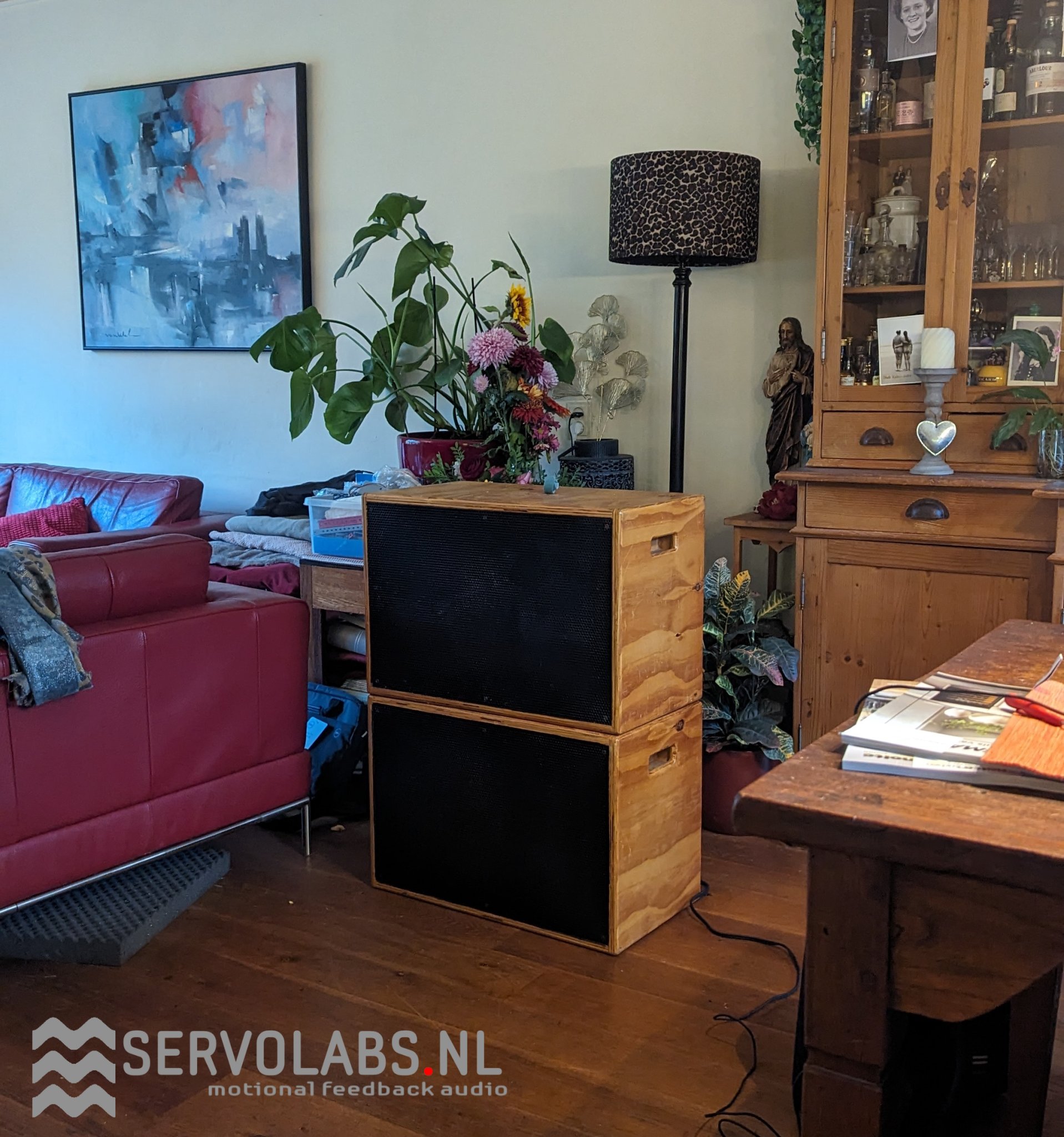

Pirate logic, the people that have evolved the Phillips MFB principle and sell reasonable priced, complete sensor systems, make the same mistake. They promote it to make small driver sound like large ones and irgnore the real strenght of the system: Improving the response of full size speaker or large sub woofer. Audiophiles don't want a speaker to be smaller, they want it to be better. Deeper, louder, faster.

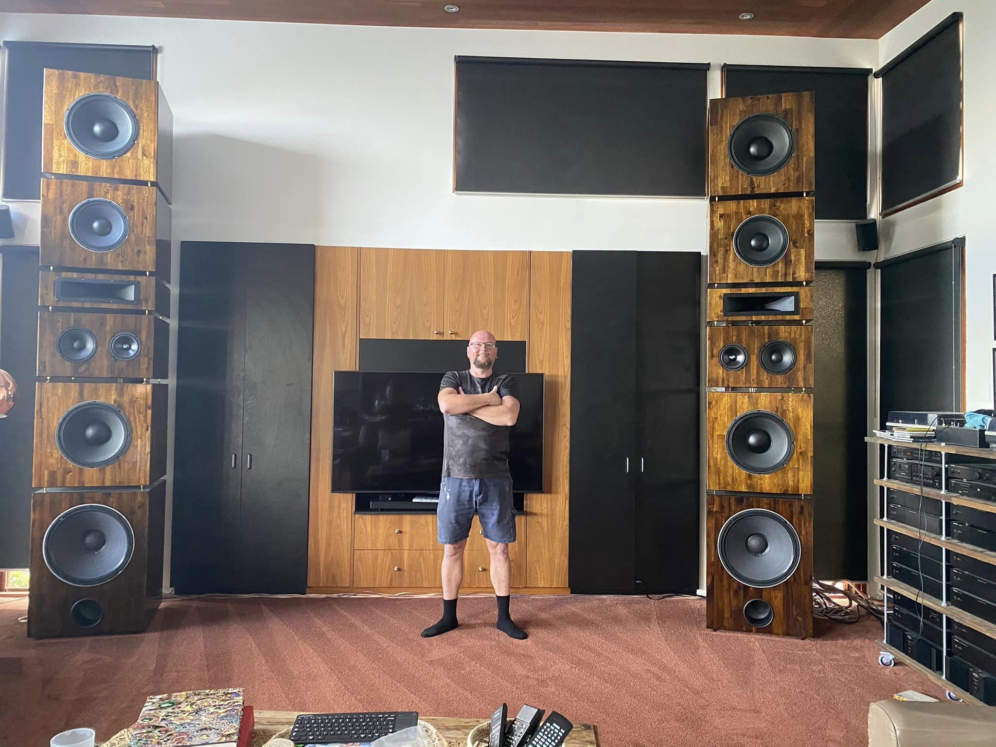

Most females I know tend to detest large speakers and tell me they're a typical male thing ;)

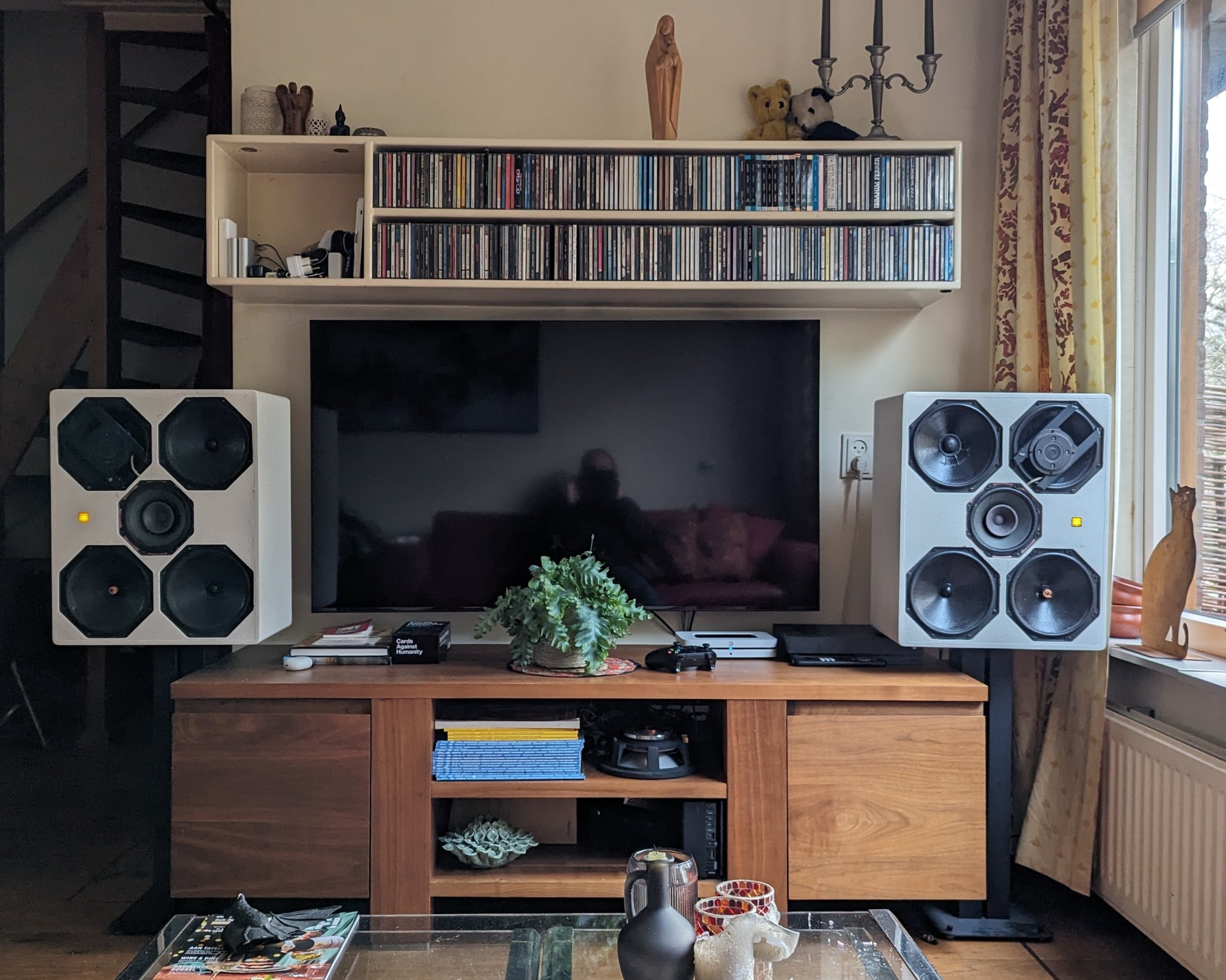

The real strenght of small drivers is that they don't suffer from cone breakup the way large ones do allowing you to extend feedback loop bandwidth to achieve better THD resdults. The larger a cone gets the harder it is to maintain pistonic motion and the smaller your usable correction bandwidth becomes. From an acoustic radiation impedance standpoint you want Sd to be as large as possible, from a servo standpoint you are better off combining Sd of smaller drivers then to use a single large driver. I actually tested this myself over last years xmas holiday using recycled Philips chassis comparing 4 x 8 inch with 2 x 15 inch and found the results both SPL & FR wise to be pretty much comparable.
4 x AD8066 series / parallel with 1 driver equipped with an accelerometer, AD7063 midrange and AD0160 tweeter. Xovers at 400 and 4Khz, 12dB servo loop between 30 and 300hz.
Mc Kenzie C200 15 inch bass, 7 inch audax midrange, JBL slit tweeter. Xovers at 400 and 6Khz, 12dB servo loop between 30 and 150hz.

Quite interesting that you use 4 chassis with a single sensor. Are they critical to match?
