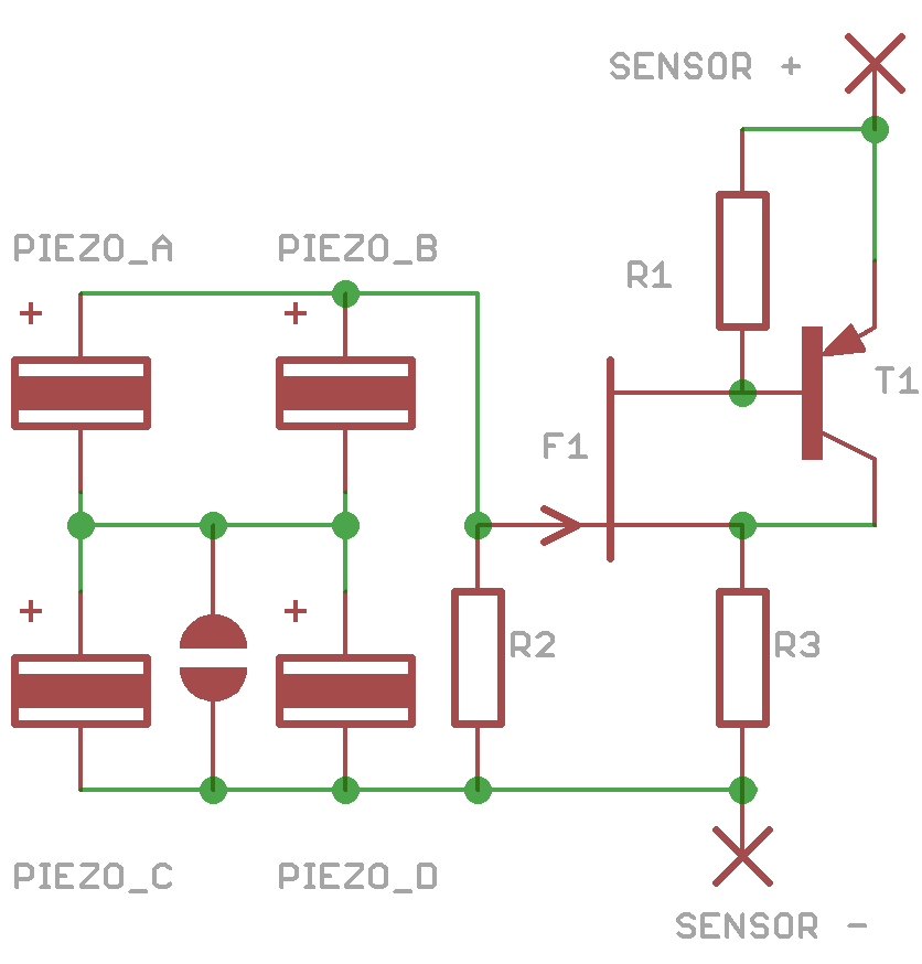

Would it be beneficial to place 8 accellerometers on the board. 4+4 series and parallell, where 4 of them is mounted up side down giving invers signal, (i guess you are already doing that) giving 4*voltage out and half impedance?
In order to produce a similar SPL large driver can do with less excursion then smaller ones resulting in a lower accelerometer output, to compensate for sensor signal loss you may choose to put them in series. The downside is that sensor capacitance wil also decrease (1/Ctotal = 1/C1 + 1/C2 + 1/Cx) upping the sensors lower F3 resulting in Lf instabilities requiring fuses To compensate for the lower C you might increase the value of R2 - like Philips actually did with their second MFB series, the original R2 was 10M, the 586 LejonKungen dissected has 33M - but that will negatively affect the loop S/N ratios. The best solution for increasing sensor output is like esl63 described: putting sensor elements in series/parallel like done with early StarBass 54 versions: for 2P operation upto 8 inch (2 elements A,B) sufficed, for larger cone diameters 2S2P (extra pair - C,D) - was used:

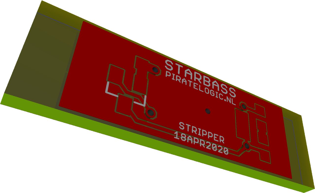

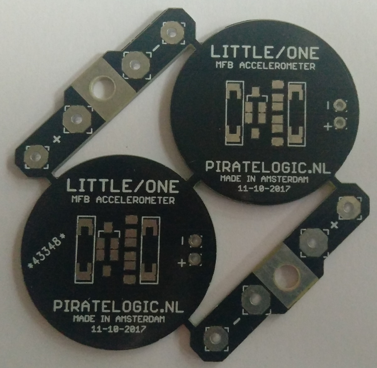

Since delivery of my new Stripper proto suffers from Corona delays and you seem anxious to get started I dug up some old Little/One accelerometers to get you started started:

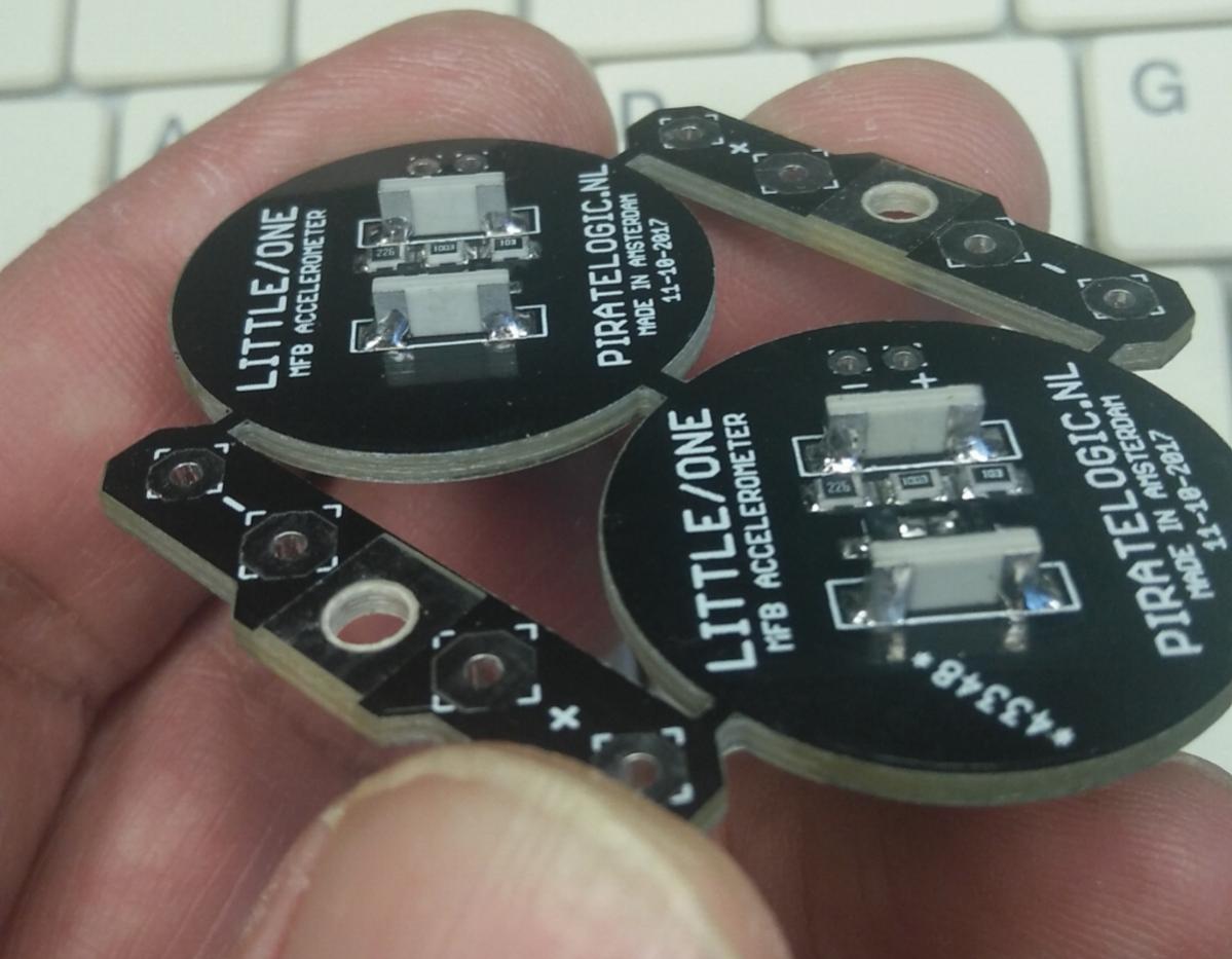

This is what they look like assembled:

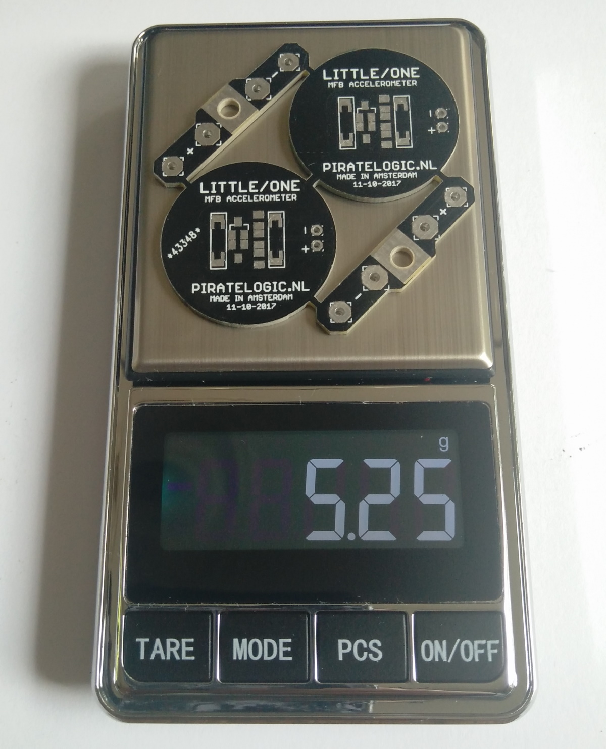

Total pcb weight for two sensors including connection strips, I assume a 19mm mod will weigh between 1 and 2 gramms :
Their diameter is 26mm so you need to Dremel some FR4 material away:

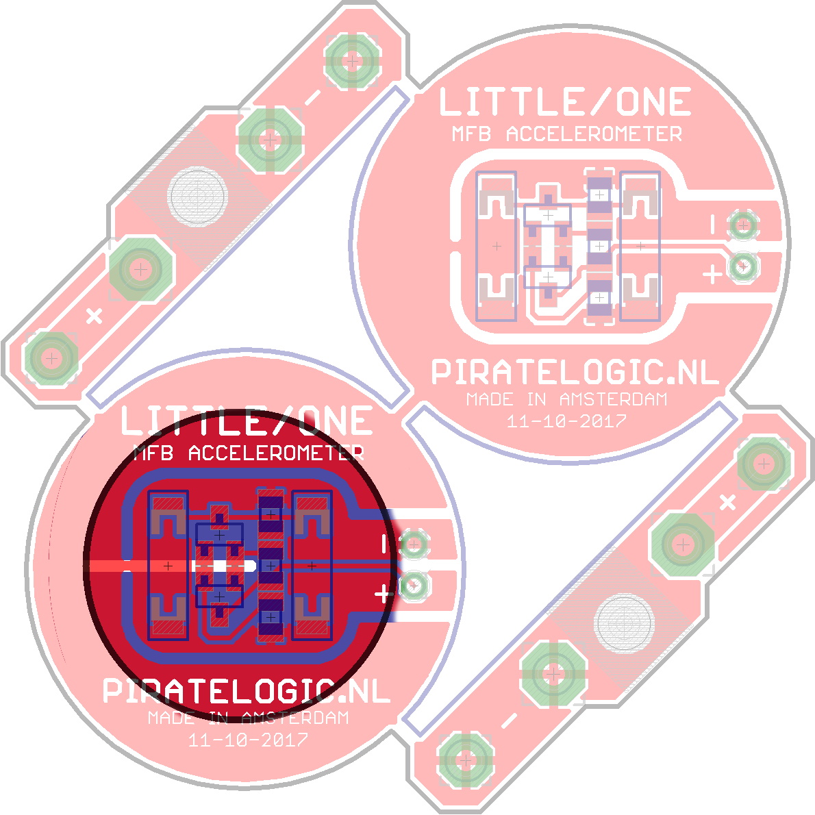

Due to an error in the used PNP shape it needs to be omitted when building the sensor, here is the component layout:
