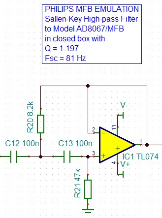

Back in Post #12 we modeled the transfer function for the AD80671/MFB in a 25 litre enclosure. I used an online filter tool to make a circuit that provides a similar response. I'll put this in the feedback path to model the speaker response. I think this would be a valid way to model it with the obvious exception that higher frequency nastiness will be present in the real transfer function for the speaker.

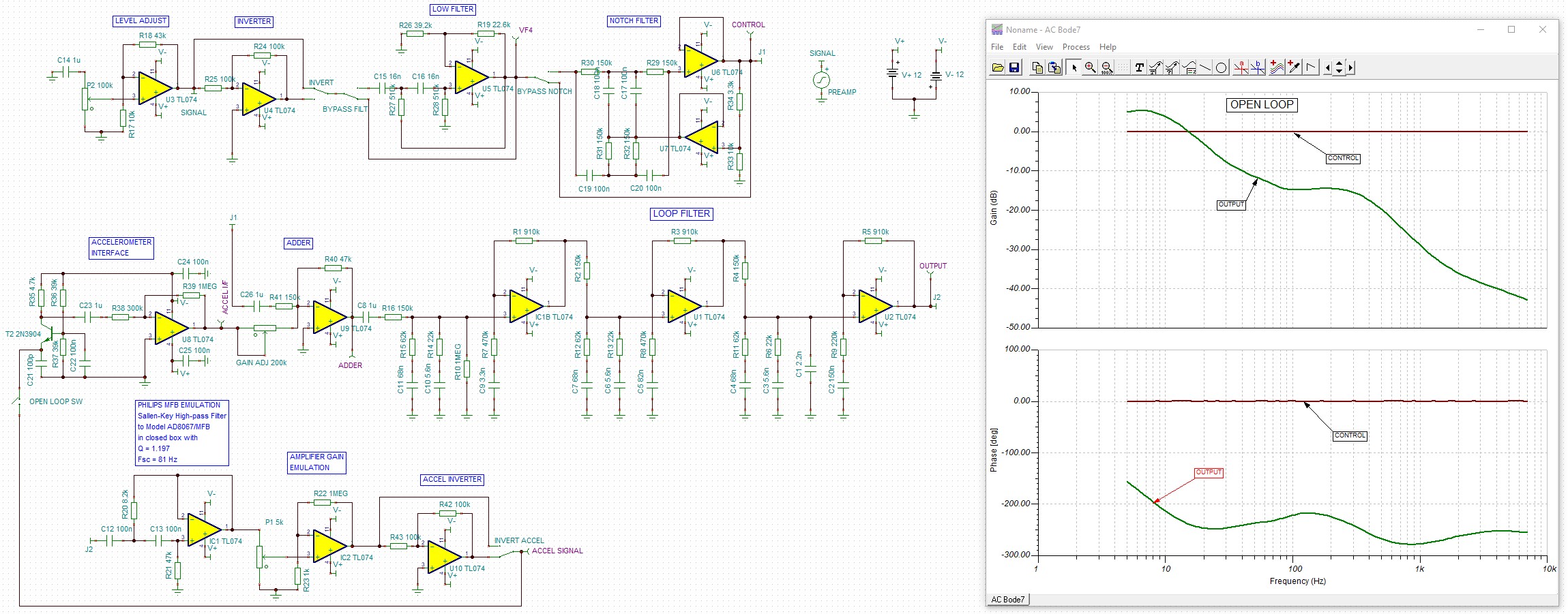

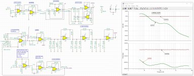

Here is the complete circuit modeled in TINA along with the Open Loop response.
An emulation for the speaker's accelerometer signal is in there but it isn't being used yet.
I bypassed all the "conditioning" circuitry before the feedback portion so an unaltered signal sweep from 5 Hz to 7 kHz is analyzed. The phase of the Loop Filter output confused me at first but I think it has a -180 shift due to the Control Signal going into the inverting input of the ADDER.
  • Open Loop Response with PreConditioning Filters Bypassed for MFB Project Complete Control Circui.jpg

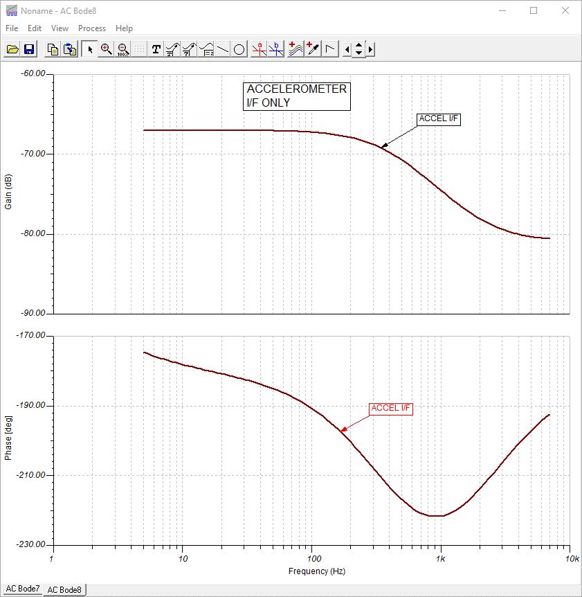

Well this is a surprise. I thought the Accelerometer Interface on its own was going to have a flat frequency response but far from it.

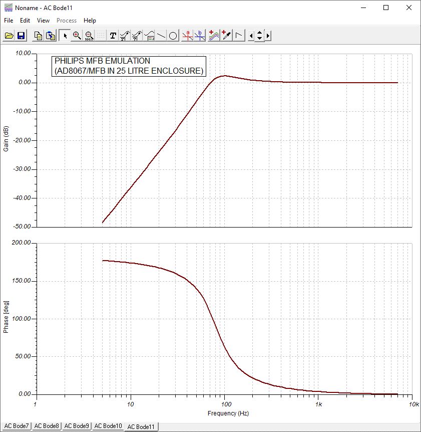

The Philips MFB Emulation filter on its own as analyzed by TINA seems to be a very good match with the speaker response modeled with WinISD in Post #12.

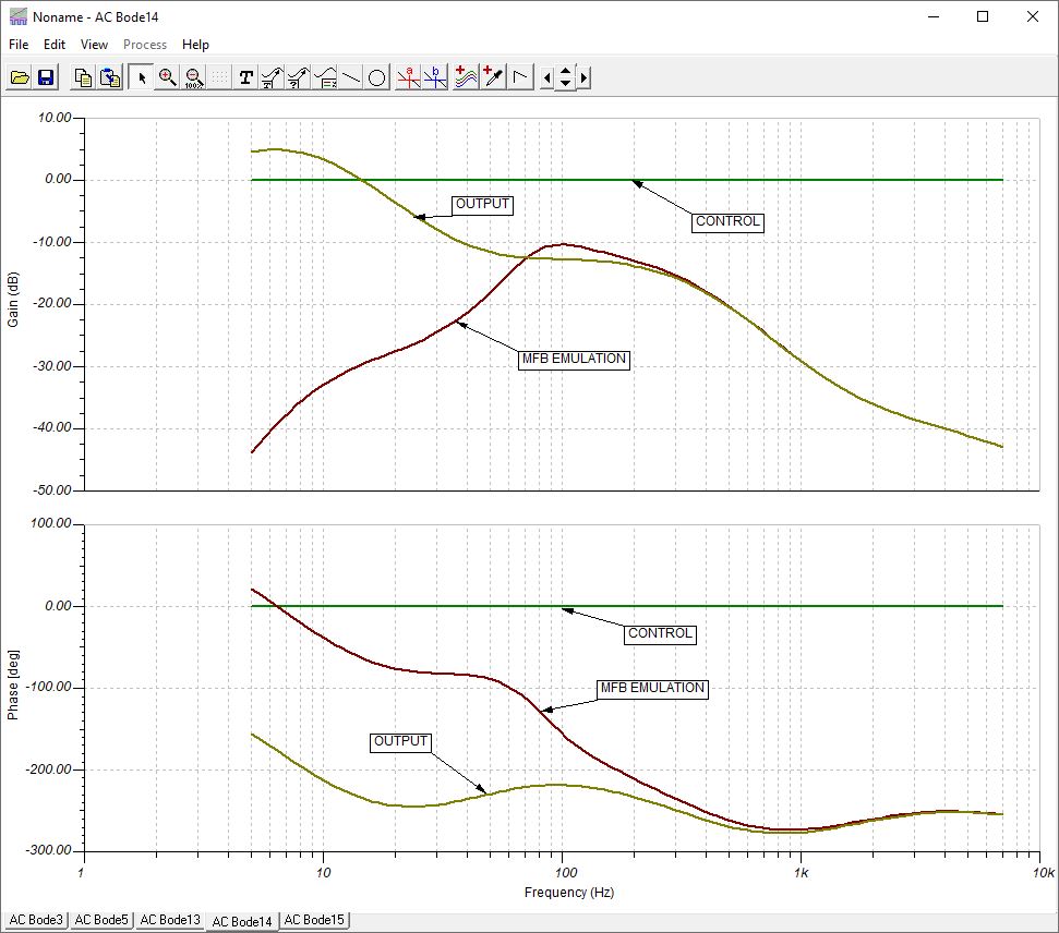

Moving forward with the circuit modeling, here are the combined transfer functions for the CONTROL (Signal In), OUTPUT (Signal Out of the Loop Filter) and MFB EMULATION (Signal Out of the Accelerometer using the modeled response of the closed box speaker). So "MFB EMULATION" represents the predicted Open Loop response of the speaker but as already modified by the Loop Filter.
