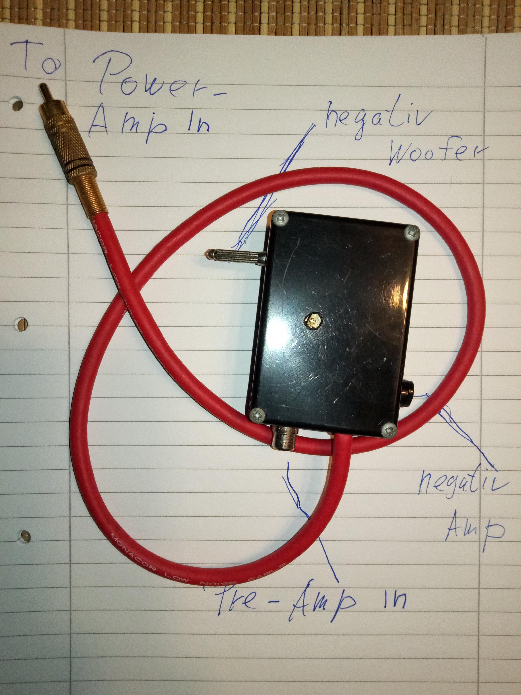

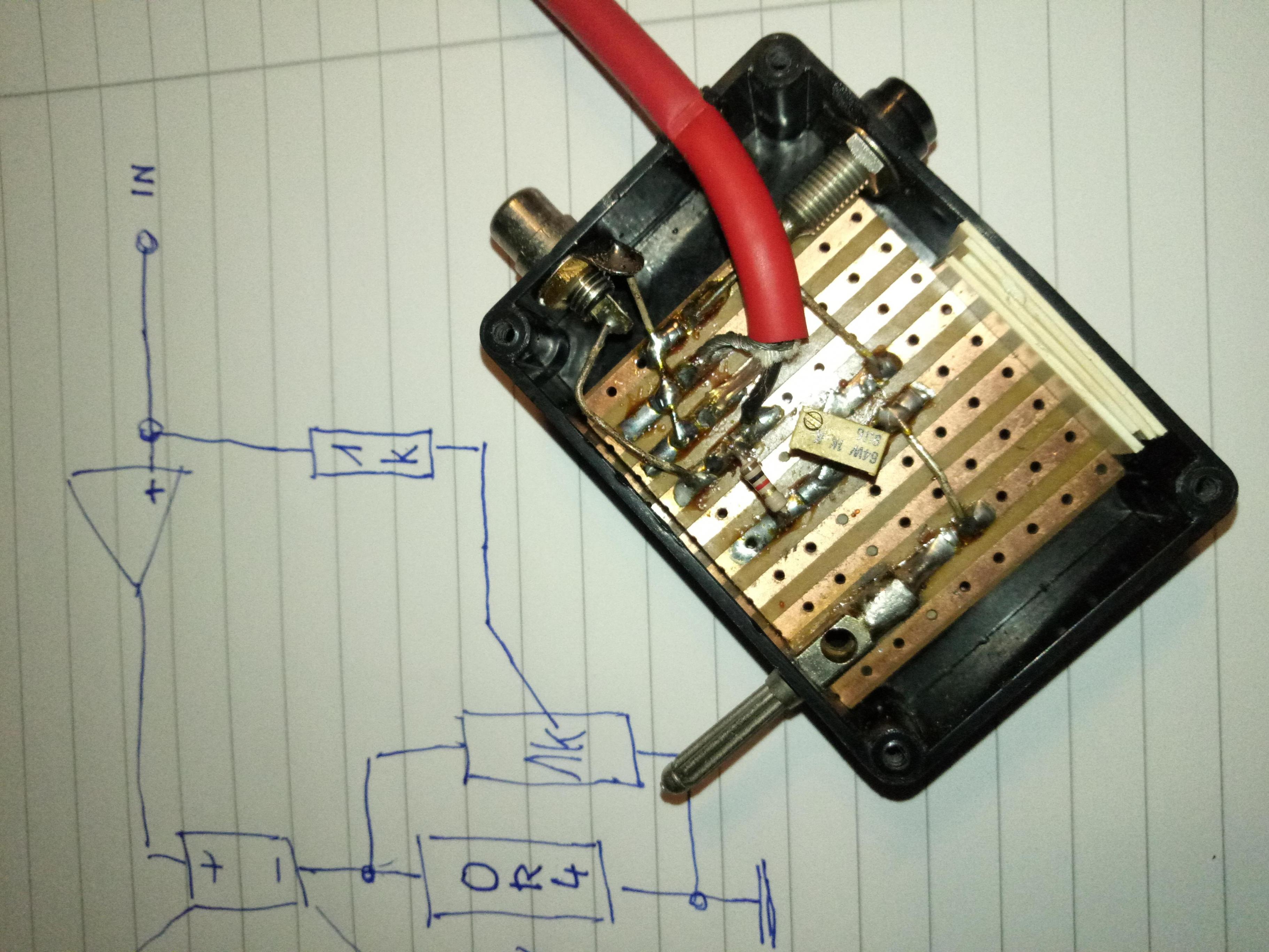

I will try to find my circuit and make a picture, the woofers surround vanished after some years and I moved and build other speakers. But I still have the construction somewhere.
OK, this is how I realized some kind of feedback for my sub about 30 years ago. The signal from the active x-over goes to the small box which is plugged into the sub woofer, the feed back is mixed in with the potentiometer and the red line leads to the power amp. I had a 12dB/Oct x-over at 100 Hz.
Please be sure there is no DC to the amp or the input is AC only, which means a capacitor at it´s input. I had a really strong mono amp for each sub, with a 600W toroid.
The difference with and without this little tweak was unbelievable, the bass virtually exploded. Percussion put pressure on your chest, as if you where standing at the stage. Only limit where your ears ringing and the voice coil hitting the pole piece. All from two low budget 12” woofers. As costs are near zero, it is a nice thing to try.
Be careful adjusting when you first connect the circuit, things may go in the wrong direction. A 1A slow blow fuse in the positive lead to the speaker may be a very good idea.

There is a 0.4 Ohm 12 Watt resistor under the PCB. as it was a 8 Ohm woofer, it should be able to handle 240 Watts, which is much more than the woofers rms. The other resistors are 1k Ohm. Today I would make the load resistor smaller in value and the others probably larger, but that is not too critical.

Please take my values only as a starting point and be carefull. I refined them for my last build, so other speakers may respond better with other values.
The basic idea of the publication I had at that time, was to reduce Qtb of a woofer that is build in a much too small enclosure. The article was very brief, from the “Elektor” magazine, that often only published ideas stolen from British or US publications, as I know today. Maybe the translator had not even understood the principle.
I used it with woofers that where housed in acceptable volumes, to extend the low end. To my surprise the precision of the reproduction extremely improved. I heard most of the best and most expensive DIYS speakers at that time, like Focal, Dynaudio, Vifa and Scan Speak, but not one could match this low end reproduction. (I replaced them with a pair of 15” bass bins, but the low end was disappointing)
The woofer I used had medium size magnets, low Fs with medium Qts and high Vas, typical for driver you would use in a large closed box. Maybe a Qtb of 0.7-0.9 in the box, data where not very reliable at that time. Please, what you see on the picture is 30 years old! But I just measured the values with a DMM.
I have found the ACE-bass now, that shows many similarities, with a lot more and active parts. My simple passive version worked perfectly for many years, until the woofers surround fell apart.
Anyway, I also had high and low pass, but indirectly, in the x-over and amps input. I used only a CD player as source, as my record player would resonate with these subs at medium level.
IMO all these solutions are basically the same, only refined and combined with other principles. As long as you only use the resistor in the negative speaker wire, there is only one active component. Sure, you can limit, bend and lift the input signal, but the all important and unique part for woofer control stays the same. I saw one circuit that had a very simple way of inducing some DC to the amps input, so it´s offset could be compensated. Nice idea, but with most amps offset is temperature dependent, so maybe not a solution for all amps.
Today I would put a DSP in front of the woofer, do all the fancy stuff with it and let the feed back only do the correction to lower distortion. Maybe process the FB signal with an op-amp, to make things more predictable.
PS with an op-amp the resistor in the negative line could be much smaller, like 0.1 ohm´s, too.

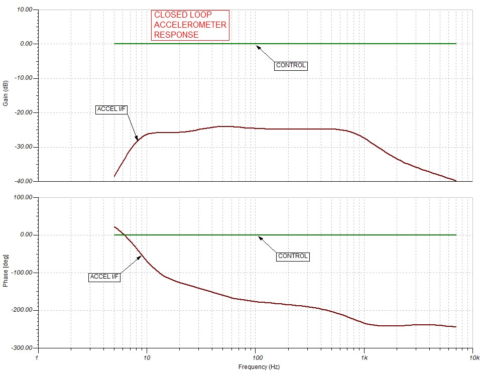

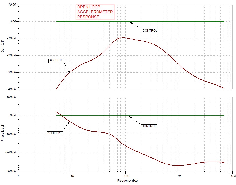

I was sidetracked a bit but now I'm looking at the circuit analysis again. Things weren't working as expected and I discovered a problem where the signal out of the Accelerometer Interface was low and clipped. I was feeding an op amp signal directly into it so perhaps it is one of these impedance mismatch issues or similar that mechanical guys like me don't understand. 🙂
In any case, I bypassed the Accelerometer Interface and obtained the following plots without and with about 15 dB of feedback.
