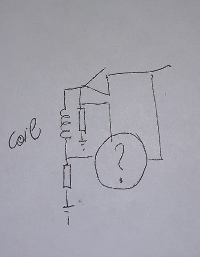

... In an ideal world current feedback would give the same results as accelerometer feedback ...
This is seductive.
Could we adjust the gain on the feedback signal, sensing the current in a reference resistor?

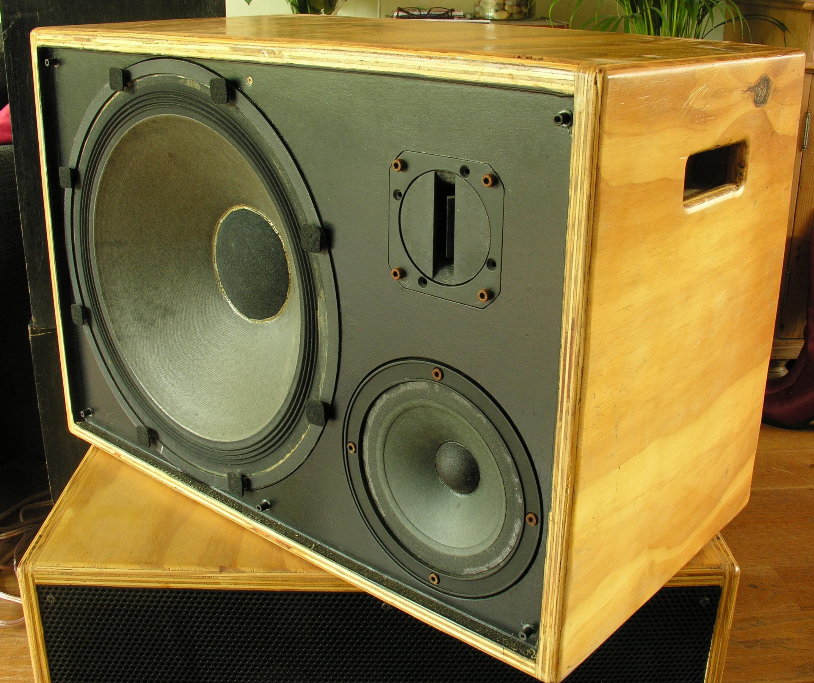

During his time he made "The Ferrari of loudspeakers". (Not my quote, one of the major hi-fi rags of the time)st-in-peace.182904/]Louis W. Erath....Rest In Peace | Audiokarma Home Audio Stereo Discussion Forums
Looks very much like the 3way 15" McKenzie with ACH01 sensor, 6" Audax pr170m0 mid and JBL tweet I build back in 2012 🙂
