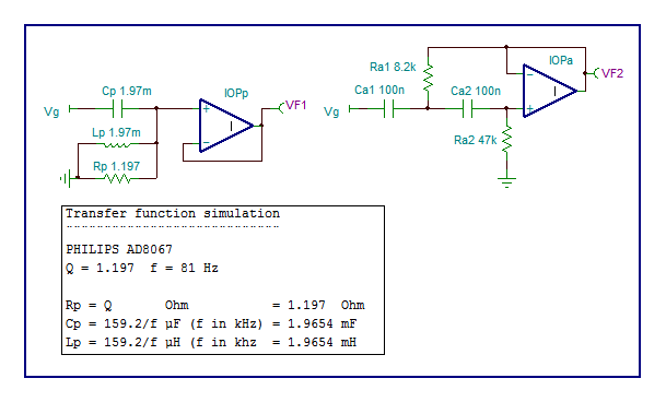

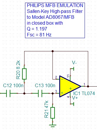

Back in Post #12 we modeled the transfer function for the AD80671/MFB in a 25 litre enclosure. I used an online filter tool to make a circuit that provides a similar response. I'll put this in the feedback path to model the speaker response. I think this would be a valid way to model it with the obvious exception that higher frequency nastiness will be present in the real transfer function for the speaker.
741956d1552238743t-motional-feedback-speaker-project-circa-1981-a-ad8067_mfb-pass-filter-model-25-litre-enclosure-jpg
I use a very fast and efficient way to model driver transfer functions. You just need to remember that the impedance of a 159.2 µF capacitor or 159.2 µH inductor is 1 Ohm at 1 kHz (160 µ will introduce an error of 0.3 % only) and to use a hand calculator to do the operations shown on my drawing. The resonance frequency is set by the same numeric values of C and F and the damping by the numeric value of the resistor. Values are unrealistic if looked as filters but the aim is to get fast and easily modifiable simulations. I invented this method fifteen years ago when studying transforms and servoed drivers.

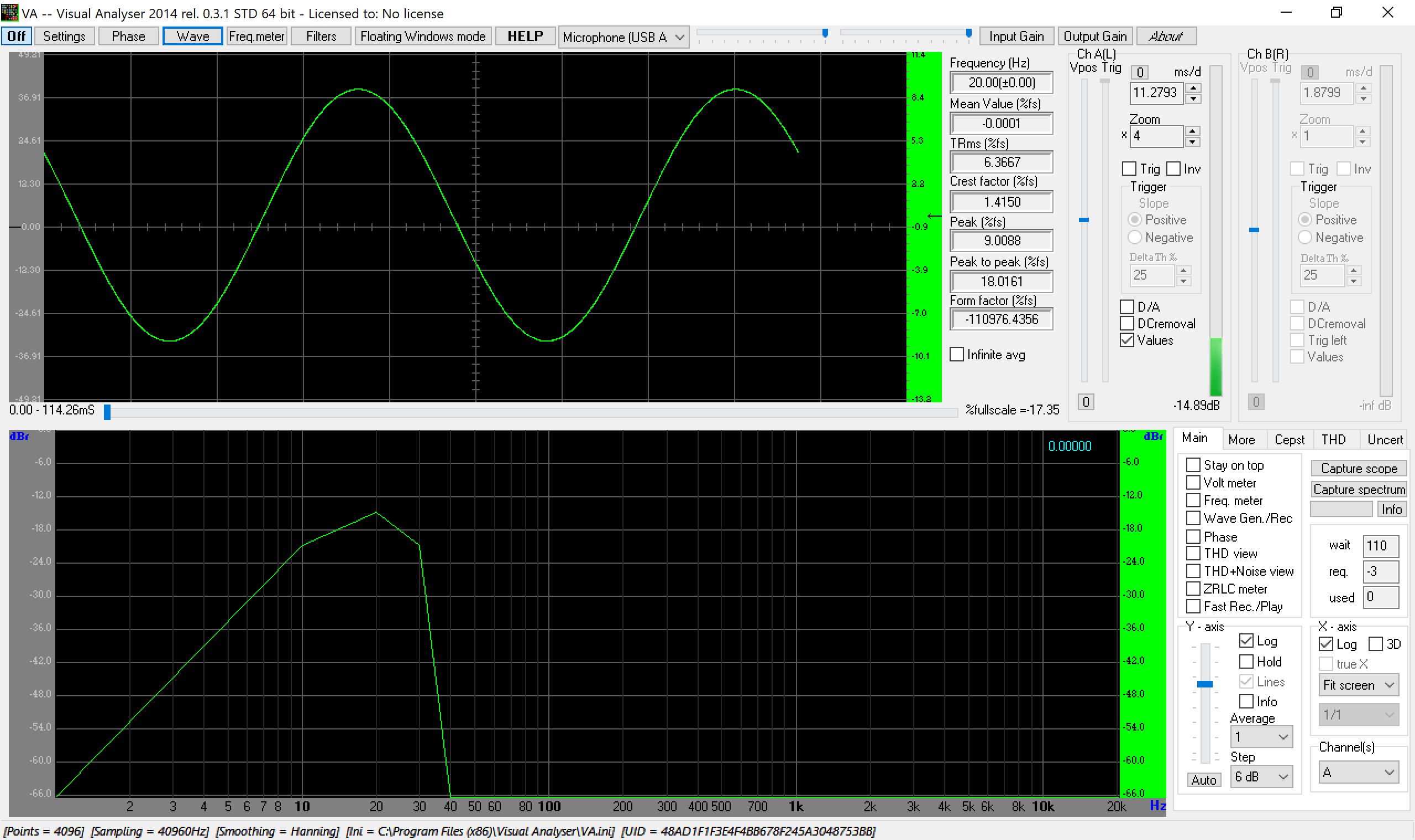

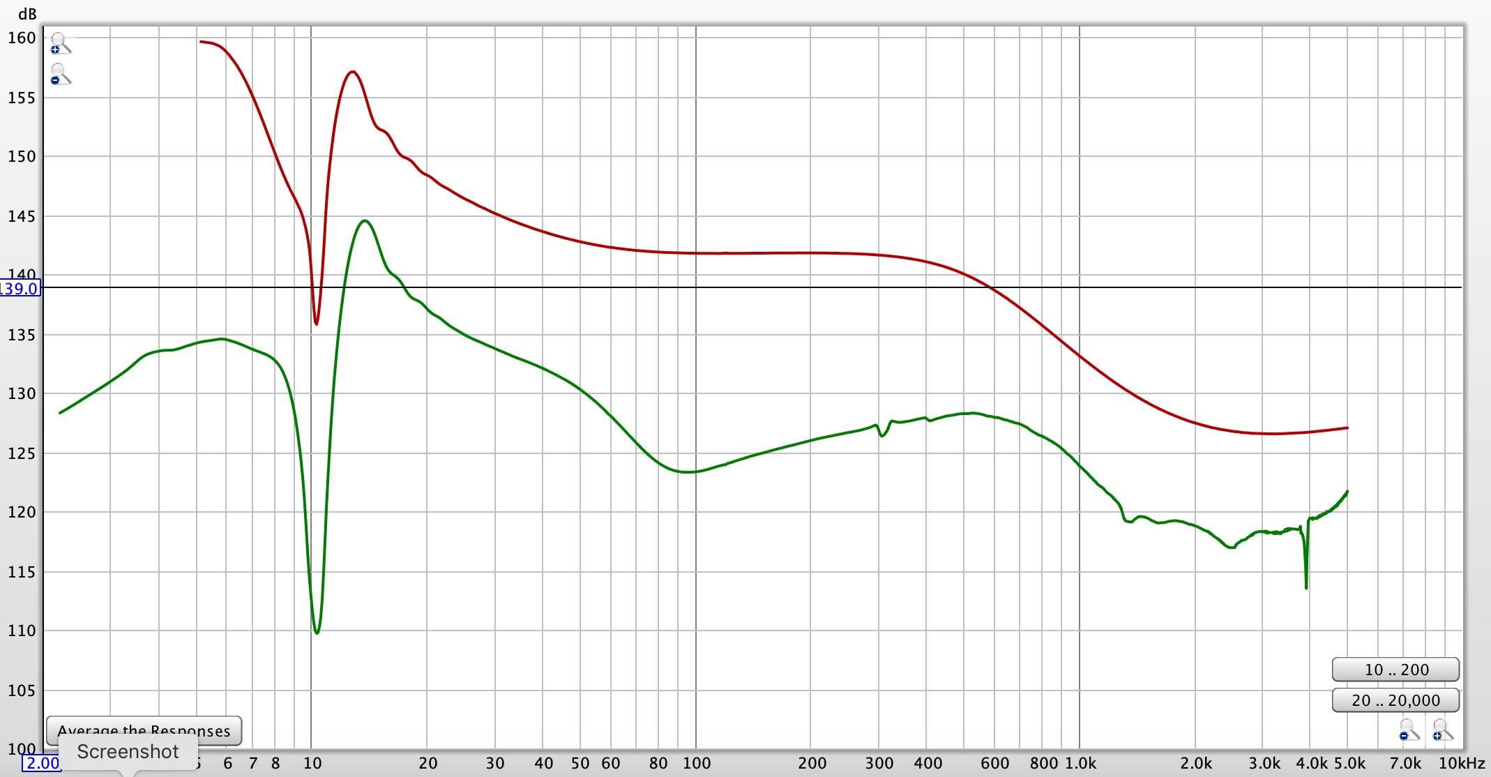

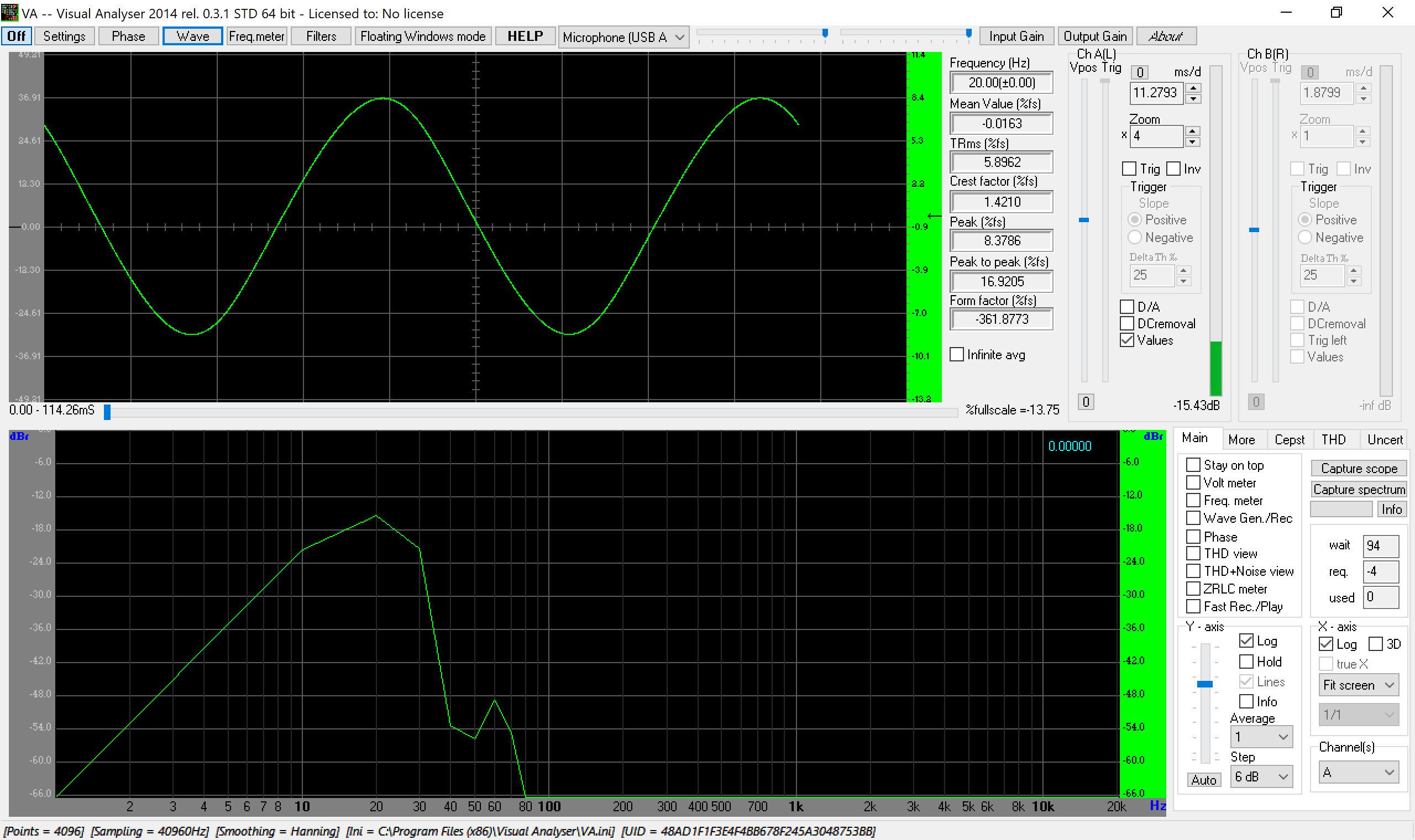

These charts compare the Output to the amplifier with and without feedback.
In the amplitude response from REW, I didn't match the input amplitudes so these can't be directly compared, but note the relative reduction in Output with feedback where the speaker response would be greatest around 100 Hz and the indication of resonance issues, particularly close to 4 kHz.
In the scope/analyzer view from VA, the loudspeaker was driven with a fairly high amplitude 20 Hz signal. I would guess p-p motion was in the order of 7mm or so. A small change in waveform shape is visible when feedback is applied and this is manifested in the ADDITION of 3rd harmonic energy applied to correct the 3rd harmonic distortion in the driver. I probably could have set these views up better but it is the first time using this software.

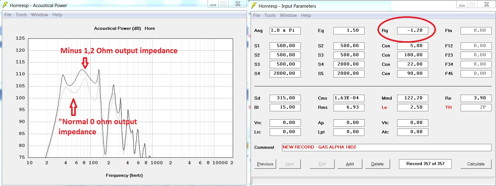

Negative output impedance works really nice with back loaded horns, back loaded offset driver quarter wave pipes and high order tapped quarter wave alignments like the ROAR.
You just have to design them to work with a negative output impedance from the beginning.
