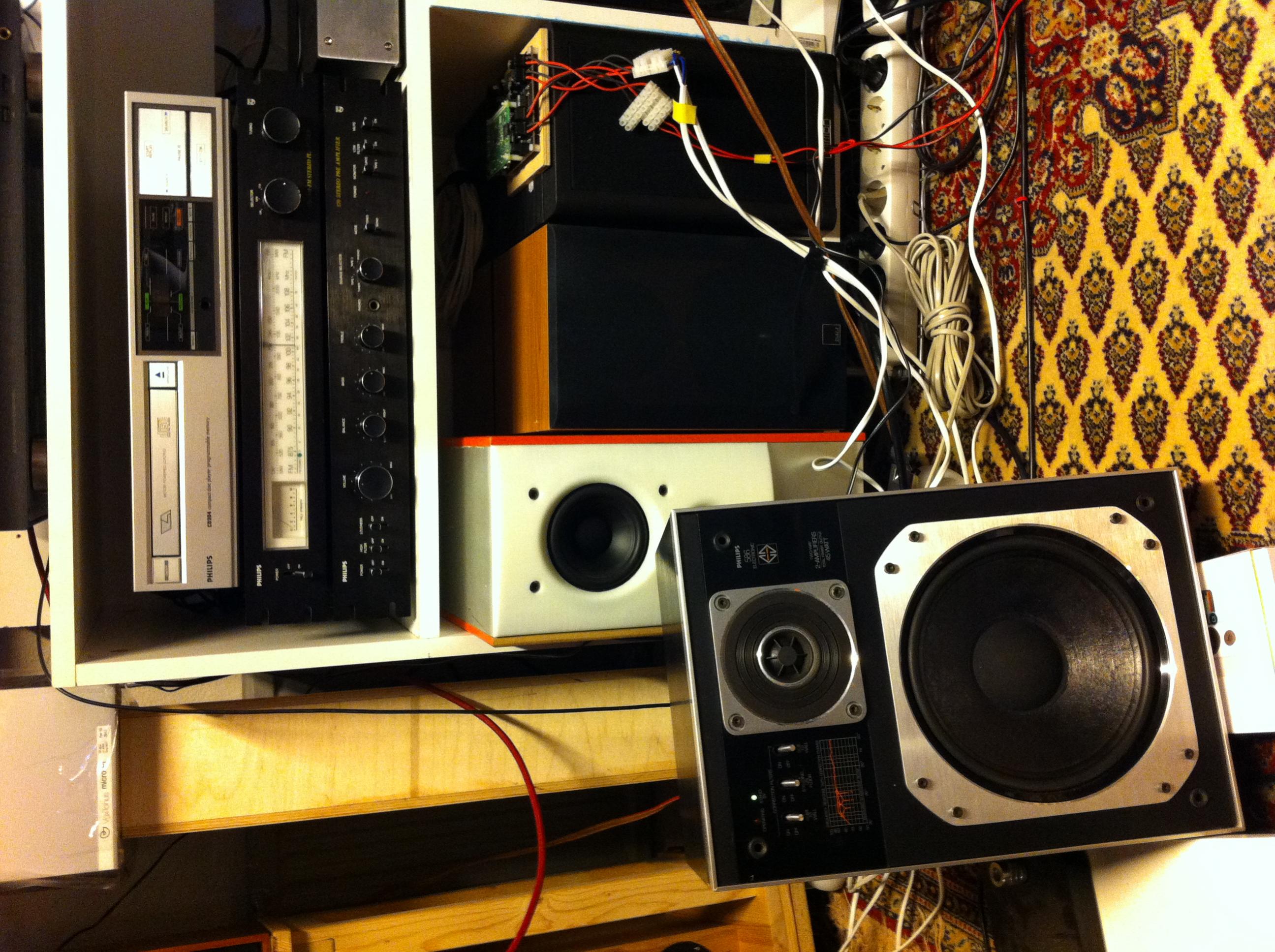

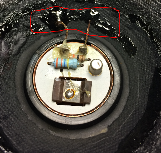

A couple of month ago I bought a pair Philips MFB 586 from the late music directors estate. I paid 35 USD including the complete Black Tulip package in its original boxes. All in mint condition from one owner only.
Initial tests of all equipment indicated bad connections in general. Changing all e-caps with guidance from MFB forum in Holland among others, I got them all to work fine, except for the MFB.
When calibrating the MFB I found the connection was broken to voice coil and MFB sensor. By resistor measuring and with help of a needle I could locate the ruptured connections to be in the vicinity of the glued joint of cone and voice coil.
The reason for the broken connections is indicated on the photo. I suspect the added sensor mass and higher acceleration by MFB increase the force above the maximum designed strength of the cone assembly. It may be a sudden breakage or fatigue stress in material.
With jeweler glasses on, bright light and a brain surgeons steady hands I managed to solder new tinsels in place and repair the rupture with 2-components resin.
After recalibration amps V p-p output and feed back according to service manual I could hear the obvious clarity and deeper bass compared to no MFB. Inspired by this work I started to look for more MFB experience and found this thread being very interesting and full of knowledge.
It's the latter, especially with modern bass rich music the woofers cone excursion easily stretches available tinsel length. Remember these drivers were designed late 70ties, early eigthies with mainly analog sources in mind.

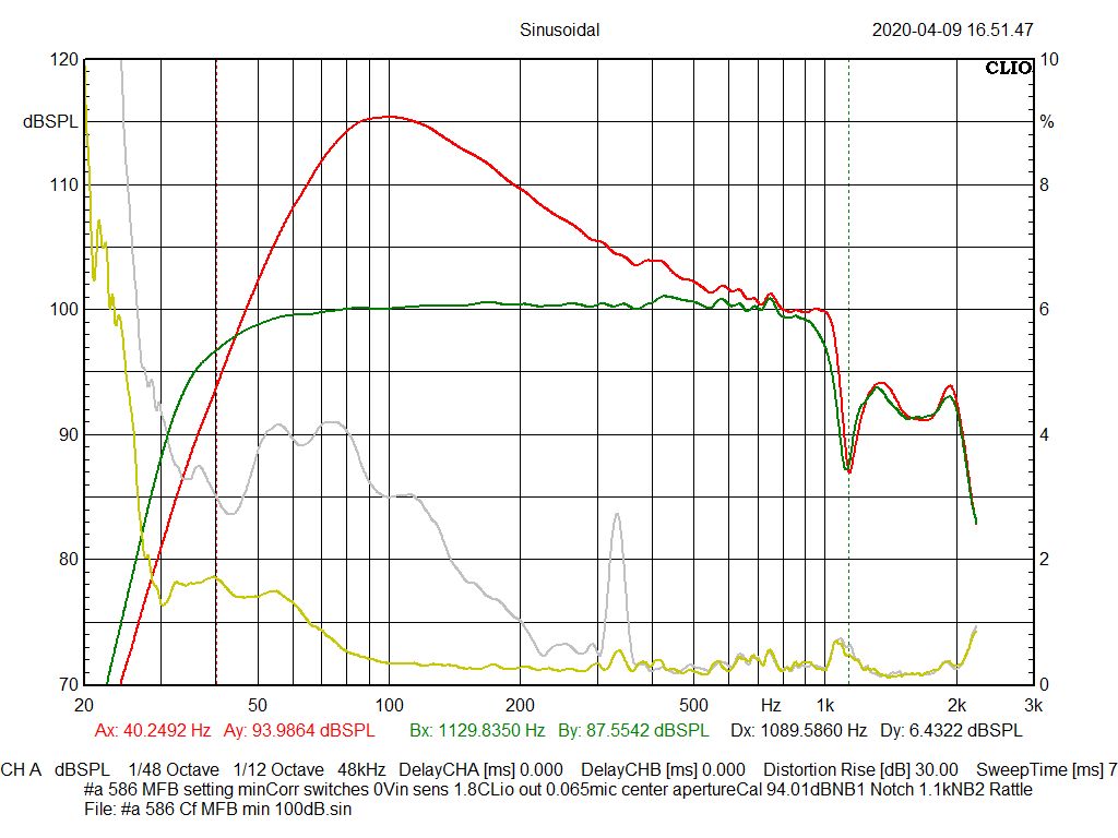

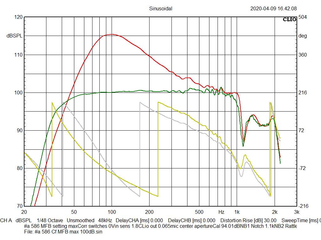

Thanks Bentoronto and Chriscam for your comments and advice. And yes, the service manual was obviously only to get the setting within a rough frame. Attached diagram show the close field SPL at the aperture of the bass in max and min setting.
The benefit is obviously both deeper bass and flatter respons at the same time as the THD is remarkably lower. On top of all the speaker pair measures are almost identical. The stage image of the speaker pair stays wonderfully solid.
There is a -5dB notch however at 1.1kHz with a negative influence in the XO area. As the pair are identical in regards to the notch I suspect this is from the feed back. Any ideas about whats causing it?

Sorry, I got carried away in the middle of night here. The set up of SPL test was made with a calibrated mic flush with center of cone aperture. The red SPL and grey THD curve is with MFB set to min. Green SPL and yellow THD curve with MFB set to max.
The dip at 1.1kHz is actually -15dB. The distance from mic to tweeter center was 165mm. This is about a half wavelength at 1.1kHz. The tweeter was connected and might contribute to cancelling? I will check.

Those plots are about the best advertisement for MFB I can imagine. The FR looks wonderful and the THD improvement is excellent and couldn't be accomplished any other way. Didn't realize the speaker's MFB worked so well. Of course, the more relevant result is measured at your chair.
One interesting plot is the MFB electric signal sent back to the amp when the system is intact. What is the MFB telling the amp?
A chance at 1kHz you are picking up cancellation (just like the folks who erroneously play L and R speakers simultaneously and the treble has mysterious dips). Measuring at a distance might be revealing.

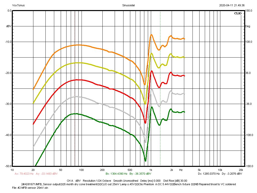

Test of AD81671/MFB in free air and well clamped. TS parameters by added mass 20g.
Curves from sensor output at no load. Dc supply 5.4V. Starting from bottom P 0.05W, 0.2W, 0.8W, 3.2W and 13W.

To further confirm a mechanical resonance, look for abrupt phase shifts around 1.1kHz.

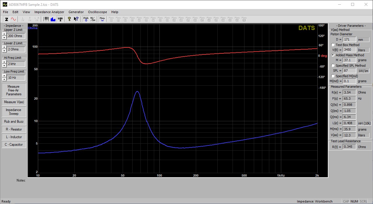

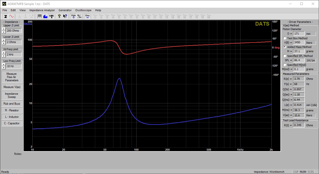

Measured T/S parameters for the Philips drivers purchased in 1982(?) currently in the refurbished system are attached for reference.

Thanks for feedback plots. The feedback (for example, red trace) nicely captures the raw speaker output (red trace in earlier plot), allowing for some oddities north of 1kHz where the system seems to struggle to remain on track.
The maximum electric feedback seems to be about 15dB: the acoustic output boost at 30 Hz looks about 15dB. The reduction in THD at 30 seems about 15dB. Seems pretty good to me.

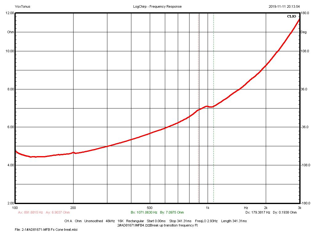

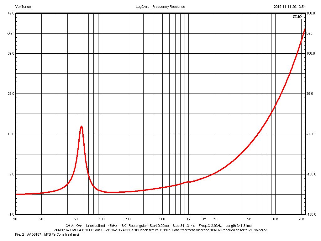

I looked at my drivers impedance curve which indicate the origin of the 1.1kHz notch. According to the litterature the stiff cone break up should be at 896 Hz. Above the Ft, transition frequency, the cone is not working as a piston any longer.
The increased acceleration at this point is fed back by the sensor. Looking at the SPL output the notch is independent of MFB set min or max. Assume this is correct, is it practical/possible to add a steeper LP filter to get rid of it?
The TS parameters of your drivers are very much the same as the ones I have. Despite old drivers considered being "cheap" I am impressed by the small variations of the parameters.

I looked at my drivers impedance curve which indicate the origin of the 1.1kHz notch. According to the litterature the stiff cone break up should be at 896 Hz. Above the Ft, transition frequency, the cone is not working as a piston any longer...
Can you look at the accel output? This would be affected by the first modal cone breakup but would also reveal resonances in other structure such as the accel mounting etc. Or maybe you have already observed this...
So there is little or no feedback at this frequency. Good thing, as it would be perilous!
Sure - but outside of the feedback loop. But if the corner for the LP response no longer meets the corner for the HF driver HP filter it will create a dip.
