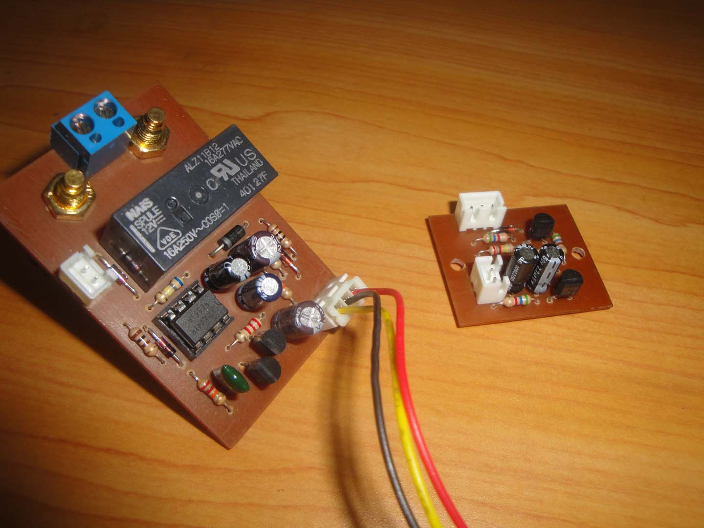

hi apex sir,
the protection board in progress.
is this protection suitable for h900?
hi apex sir,
No, PRO pins are not compatible on H900 and HV23, but if you don't want use overload protect you can use this protect with any amp.

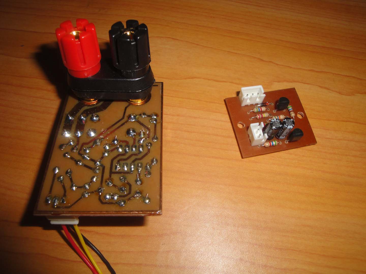

hi apex sir,
i finished and tested this protect, but not working,
what will be the problem?
Protect can't work without 10k NTC (thermal protect), but you can use 10k resistor instead NTC for test.
Regards
Regards

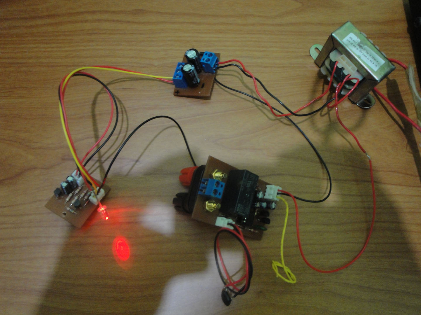

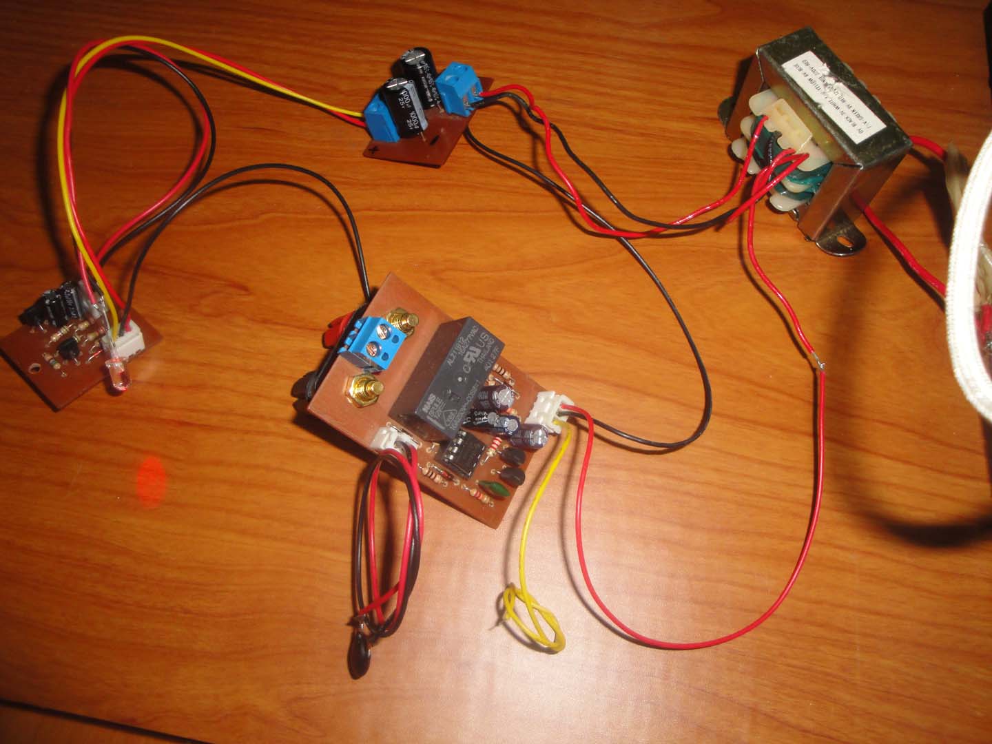

hi apex sir,
now i put 10k ntc .
now the protect circuit is working, but when power on , the relay delay time is one second ,because the led indicator only blinking once and after relay connects the led permanently lights on, how can i increase the delay time to 3 or 5 seconds?
now i put 10k ntc .
