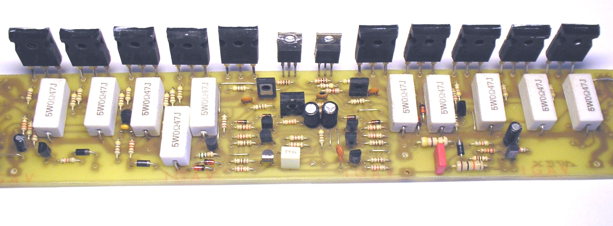

pcb size ?Simple Soft-start, DC, Thermal and Overload Protect with NE555. Use single 12vac for suply.

now i put 10k ntc .
now the protect circuit is working, but when power on , the relay delay time is one second ,because the led indicator only blinking once and after relay connects the led permanently lights on, how can i increase the delay time to 3 or 5 seconds?
Replace cap 1uF with 10uF or 680k with 2,2M and delay time will increase.
Regards
Regards
i changed the 1uf cap with 10uf , the delay time is 10seconds, and i change it to 2.2uf but delay time 2seconds, tommorow i'll buy 4.7uf and i'll check it.
hi apex sir,
today i change to 4.7uf cap, and its worked perfect, delay time is 5second,
thanks for the pcb.
thanks for the pcb.
hi apex sir,
thanks for the pcb.
Delay time is 1second per 1uF 🙂
This circuit suply 12V DC Fan activated by signal present on amp out, very simple without NTC on heatsink.

i made the fan control ,
1- is this work with amp input?, not the output,any suggestion to work with input signal,
2- the fan is not working with maximum speed, i provide ac 12v, i checked fan output, it is showing 8vdc, any suggestions.

Fan control can't work with amp input, use unregulated 15-18vdc for suply.
