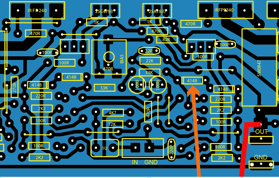

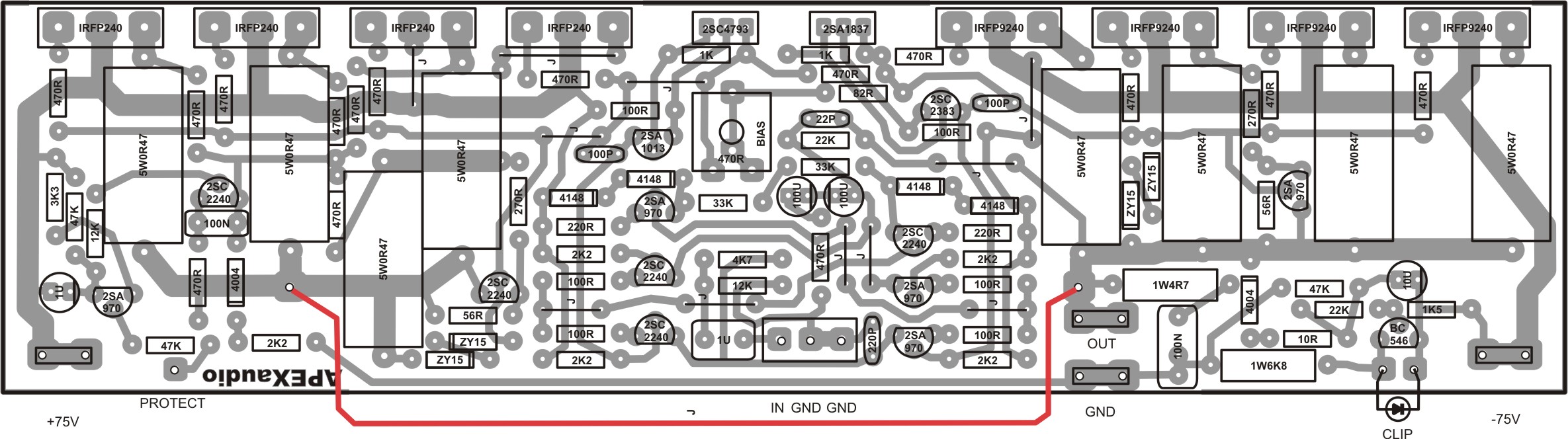

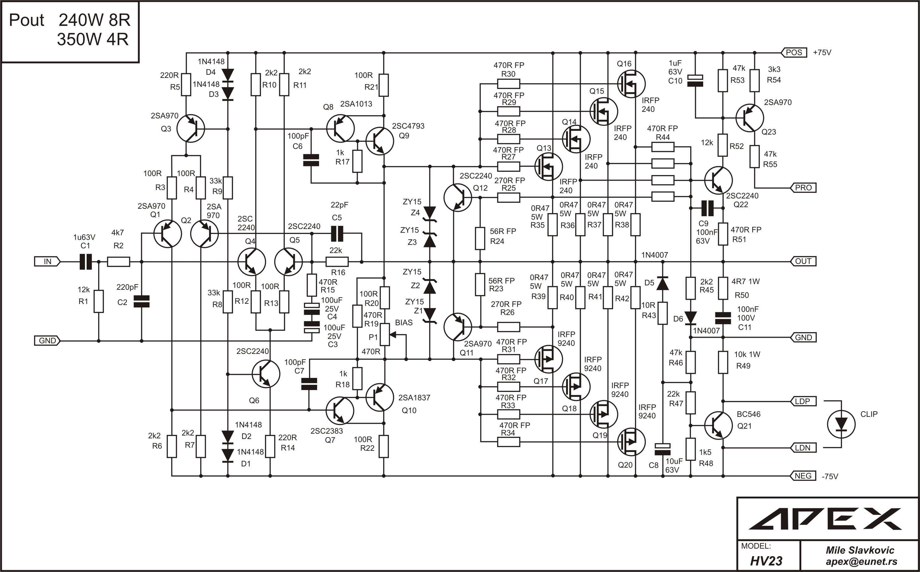

hi apex sir,
i think the in4148 wrong direction. am i correct sir.

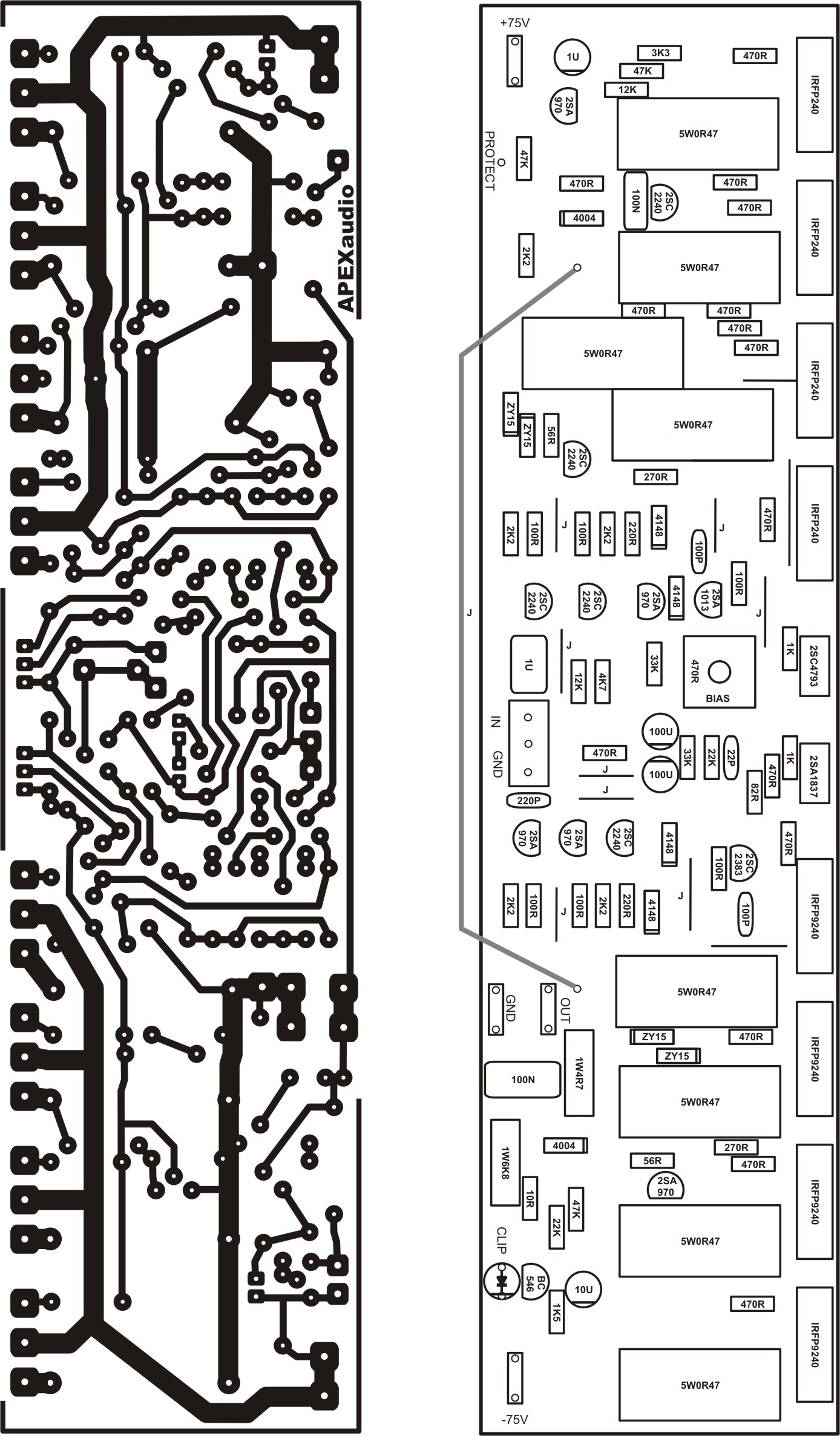

Hi Apexaudio,
Is HV25 the final design of this
MOSFET Amplifier IRFP240/IRFP9240? If so, in which post can I find the PCB layout & schematics. Going through all these pages makes me go insane. I need to build this amp. Need your help. Thanks.

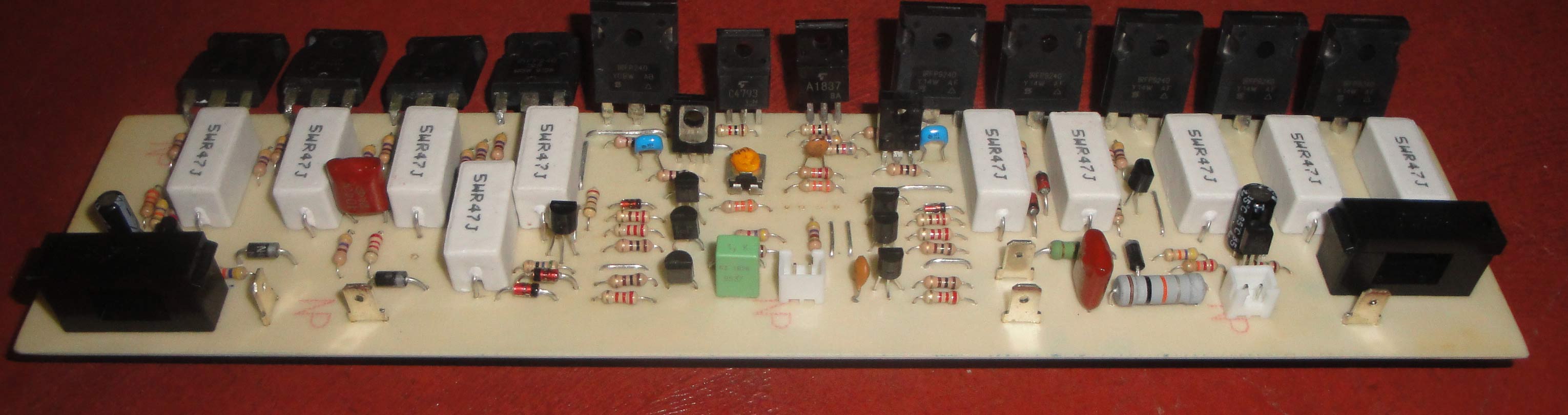

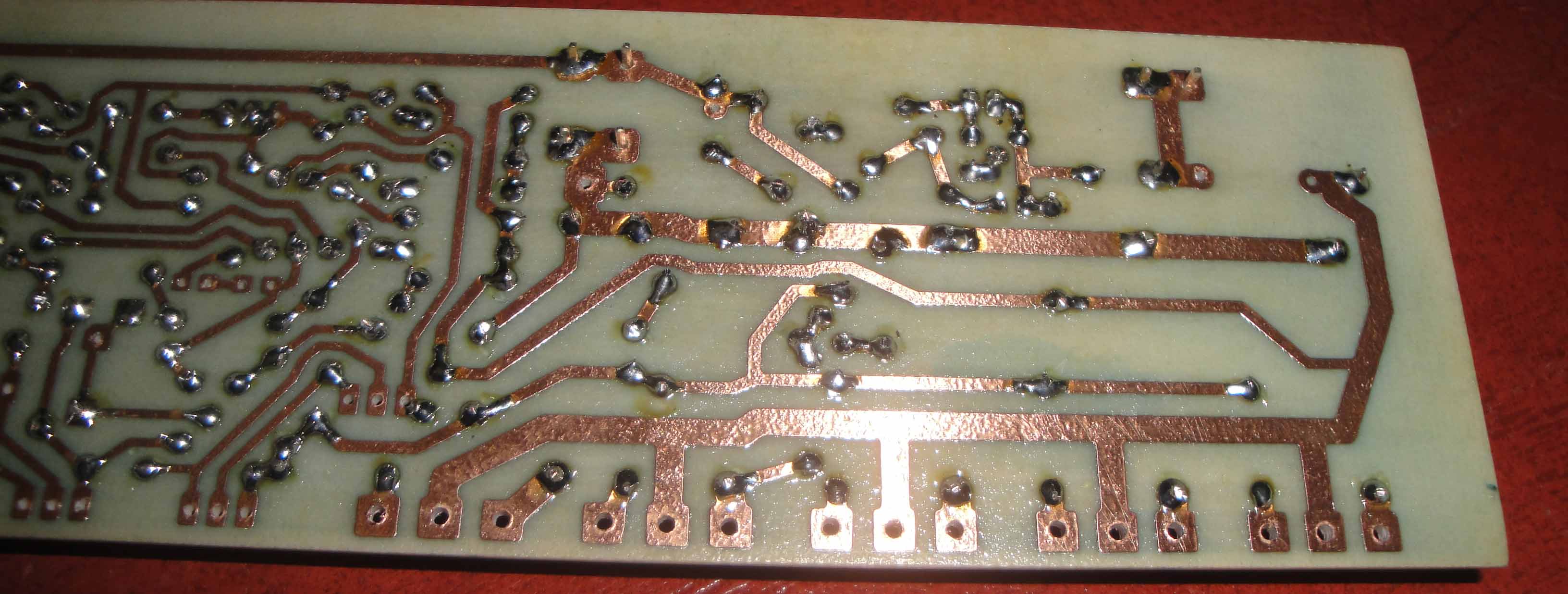

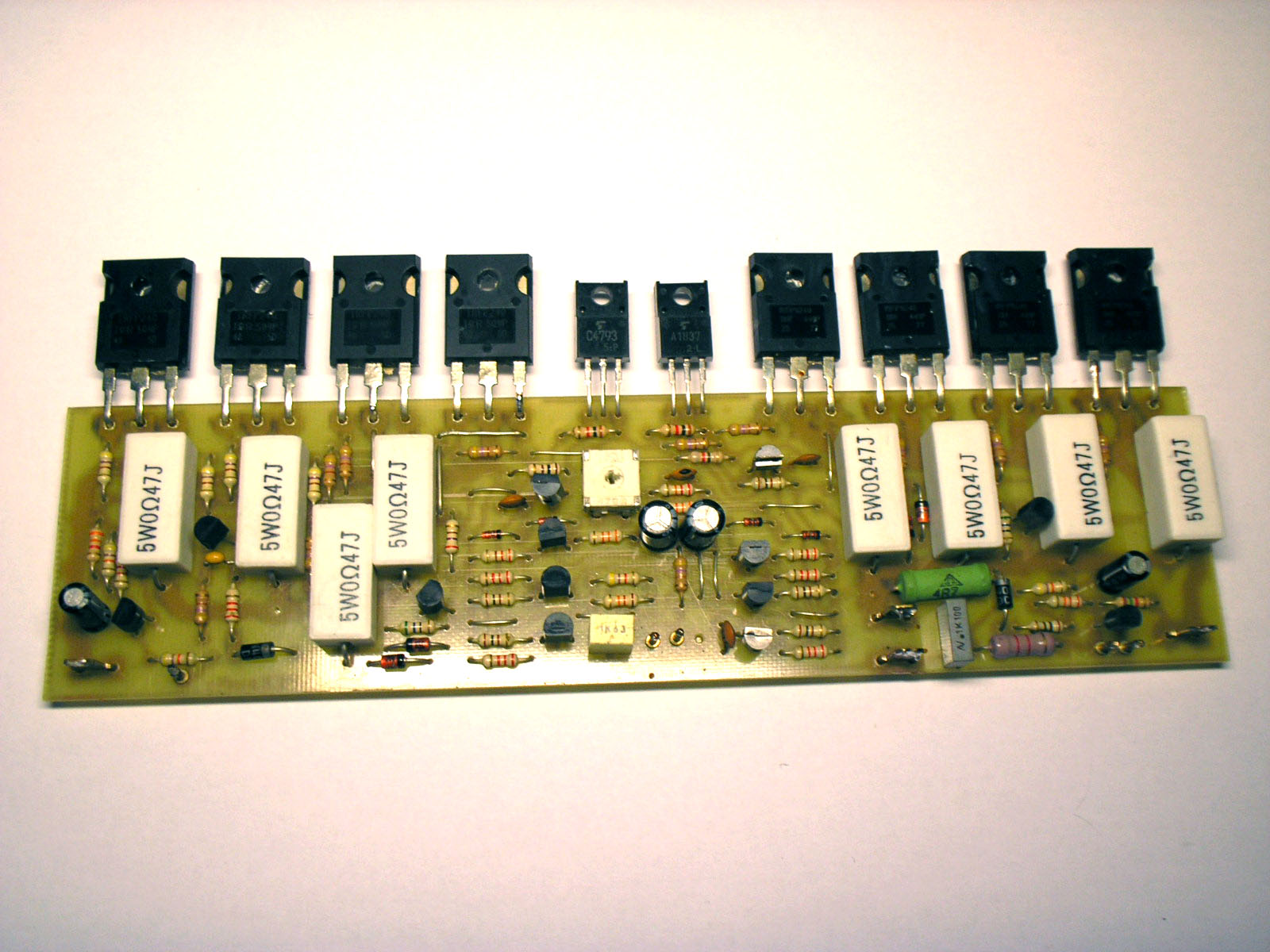

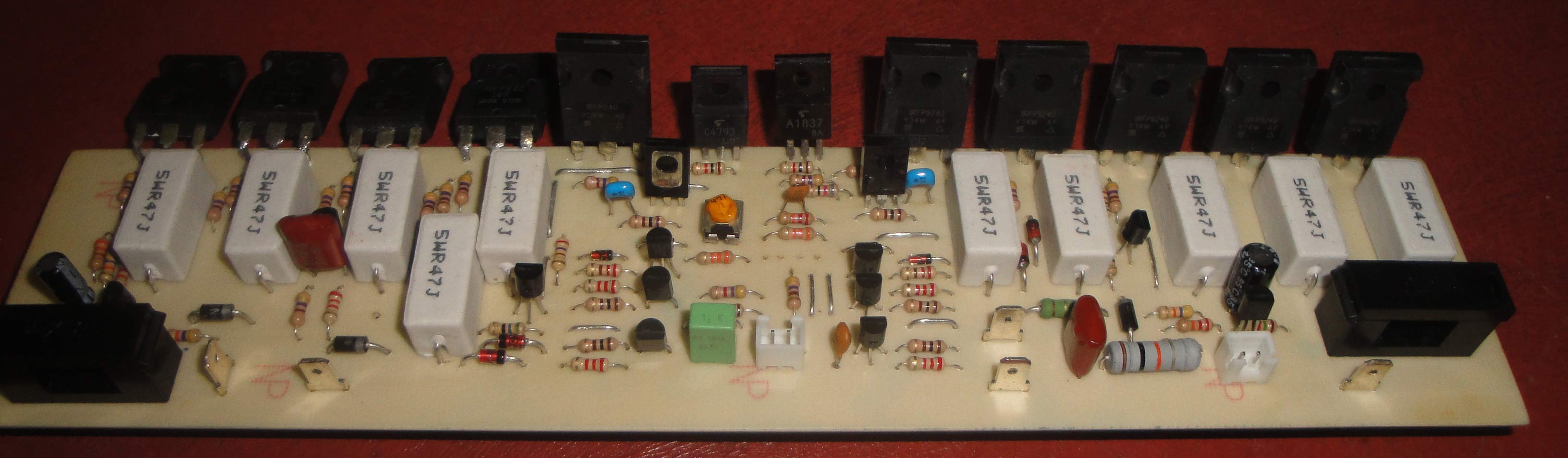

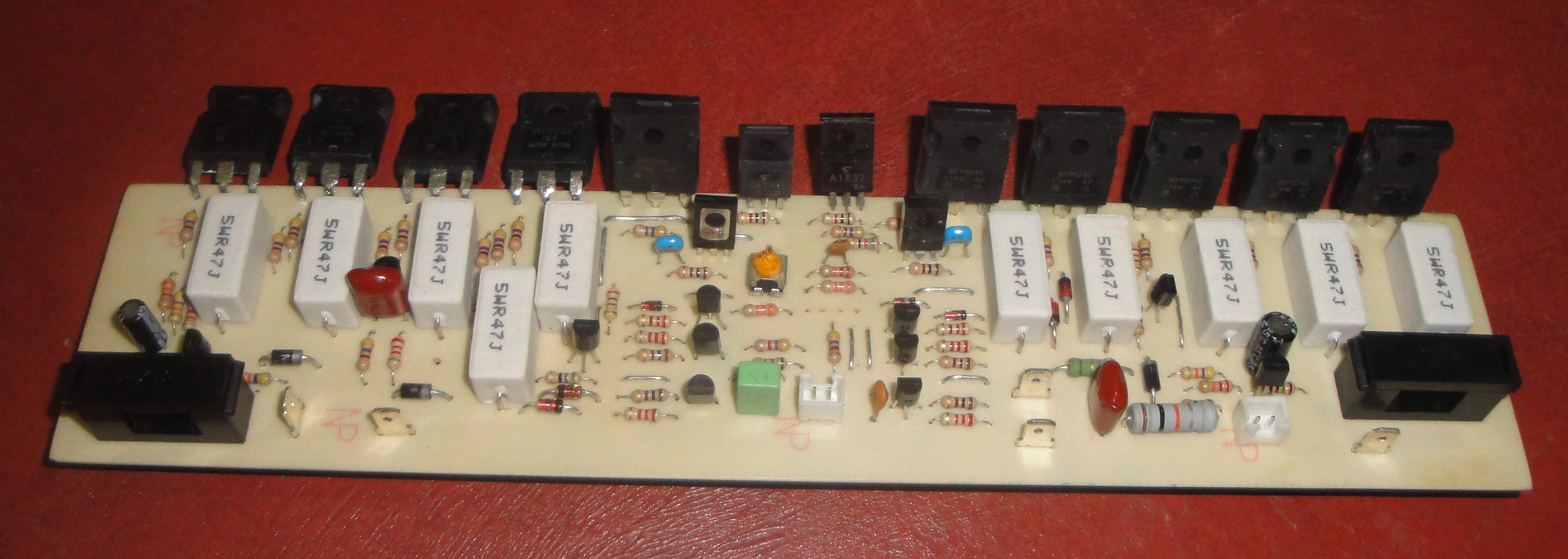

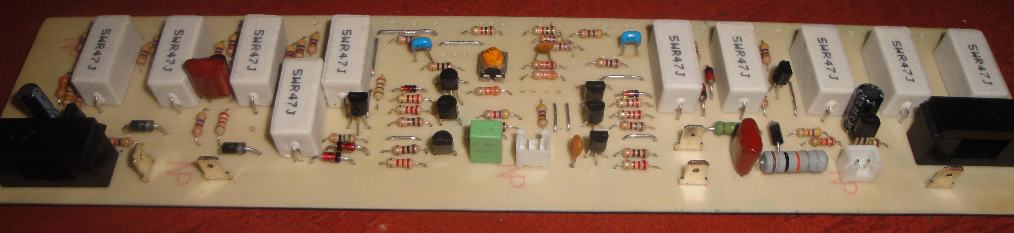

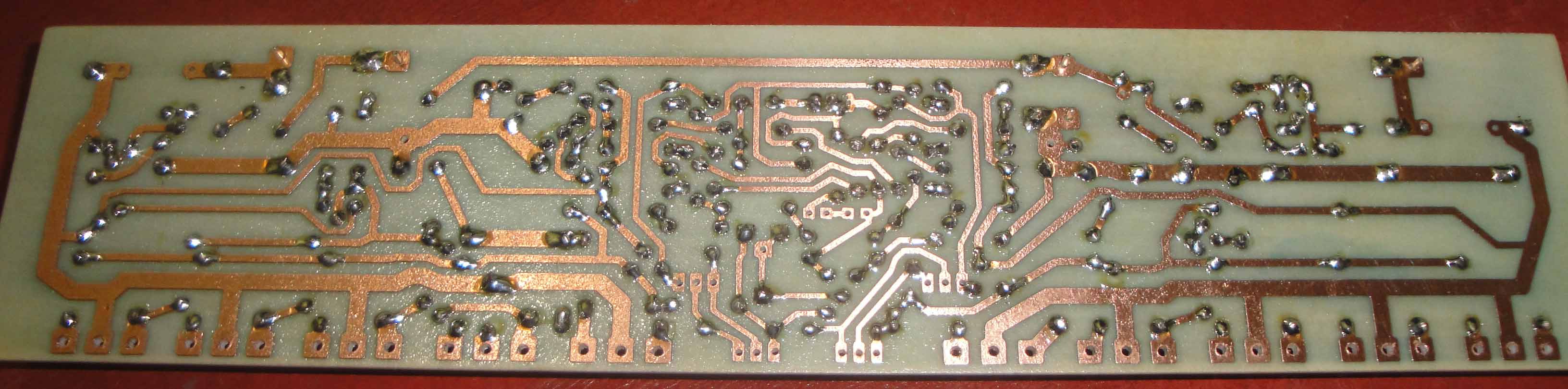

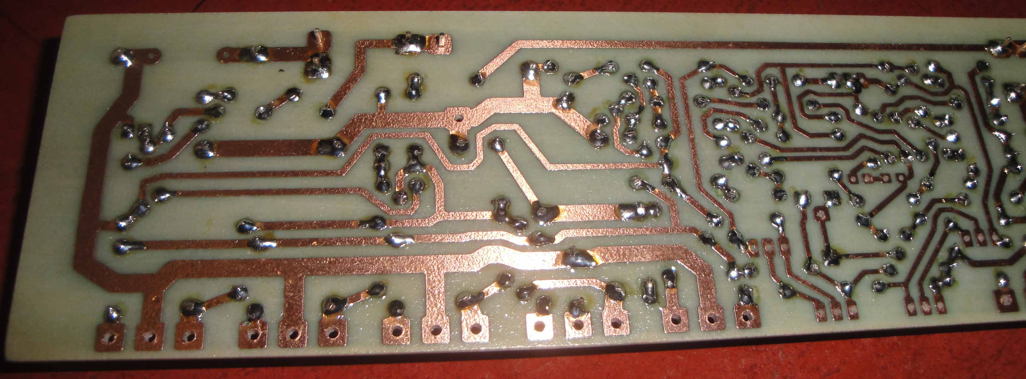

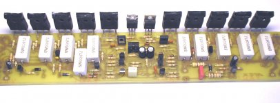

hi apex sir,
hv23 5 pair output in progress.
