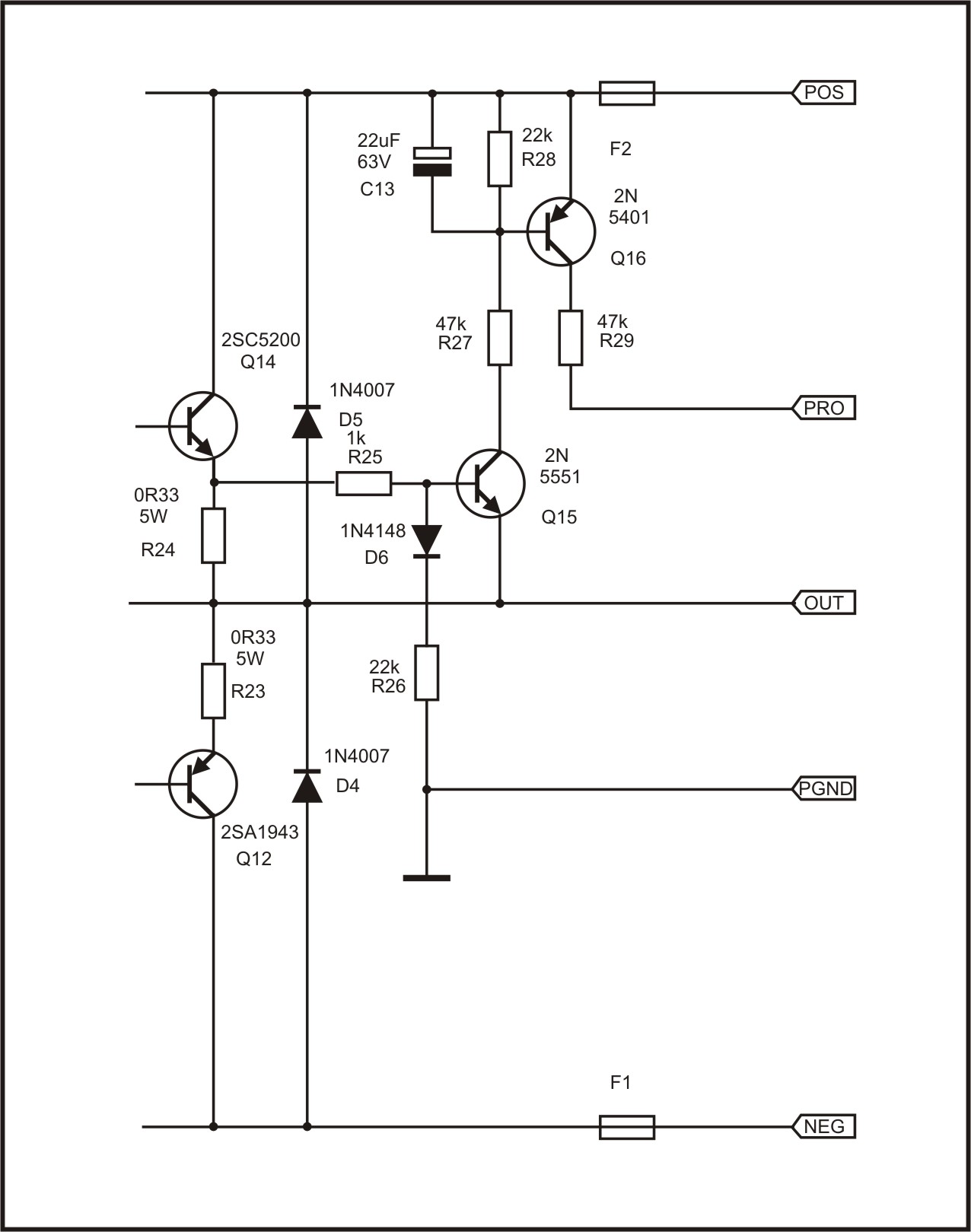

Could you explain working of circuit in post 383 so we can adapt it to other amplifiers? How is the overload/short circuit detected? What current?
Victor
Over current detect circuit give positive DC voltage on PRO out if current is over 1,5A thru outputs (short circuit) or 10A (full power), C13 give time delay for peak current.

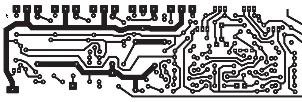

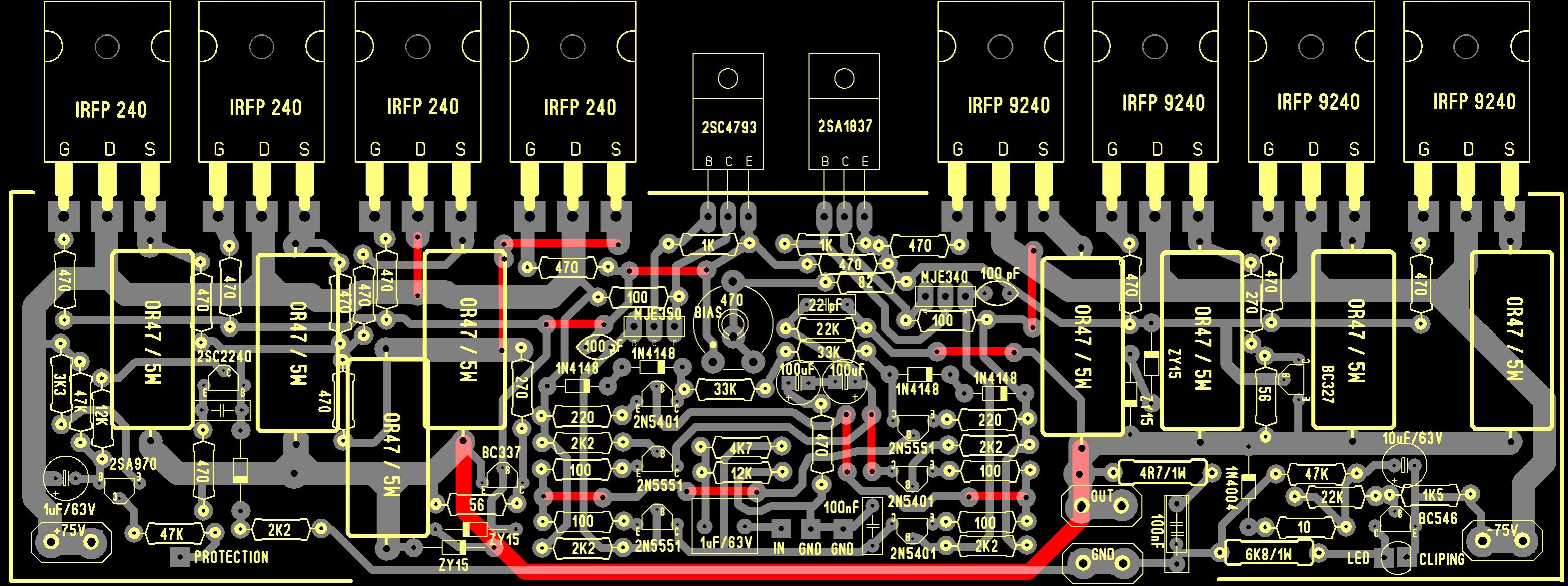

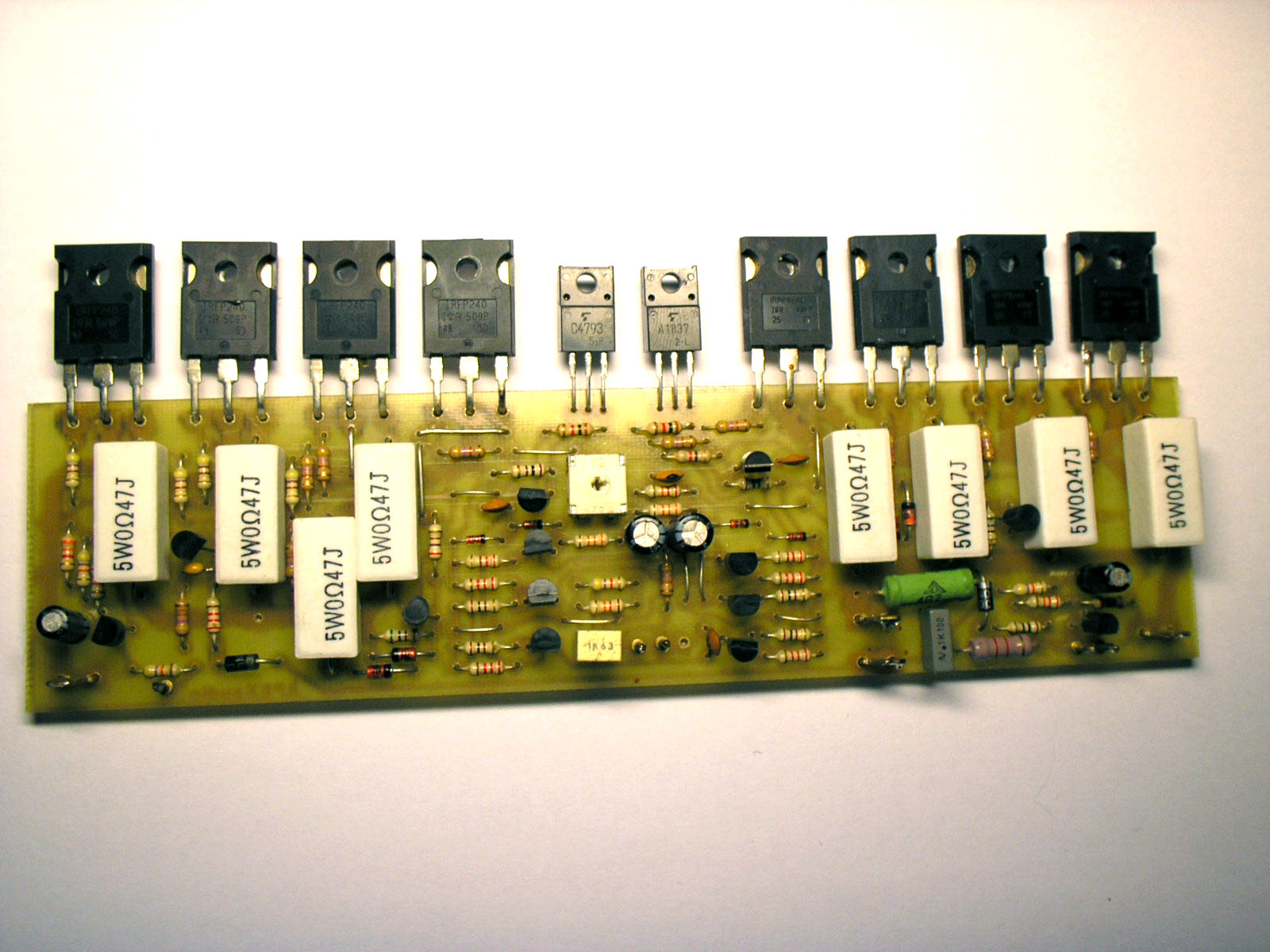

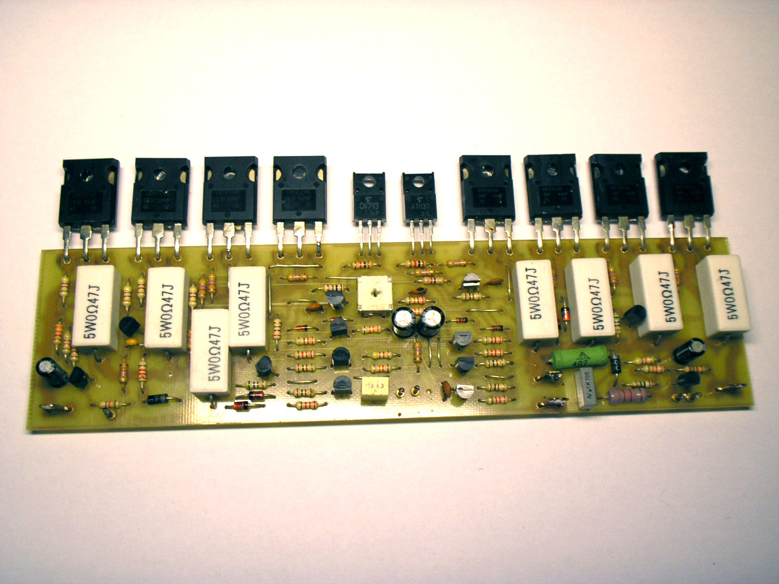

hi apex sir,
see the image below, each image is different , so can u tell which version is this images.
On picture is first version HV350.

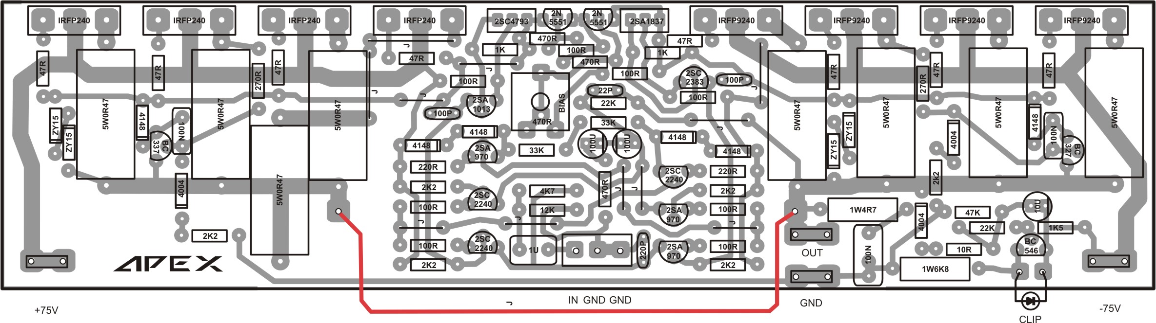

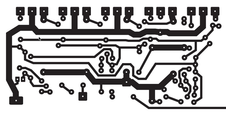

I can't find this files, I suggest HV23 with +/-75V rail and 4 pairs of IRFPs is OK.
hi apex sir,
can u share ur hv23 pcb in pdf.
hi apex sir,

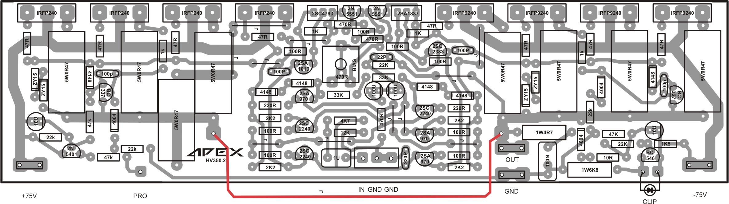

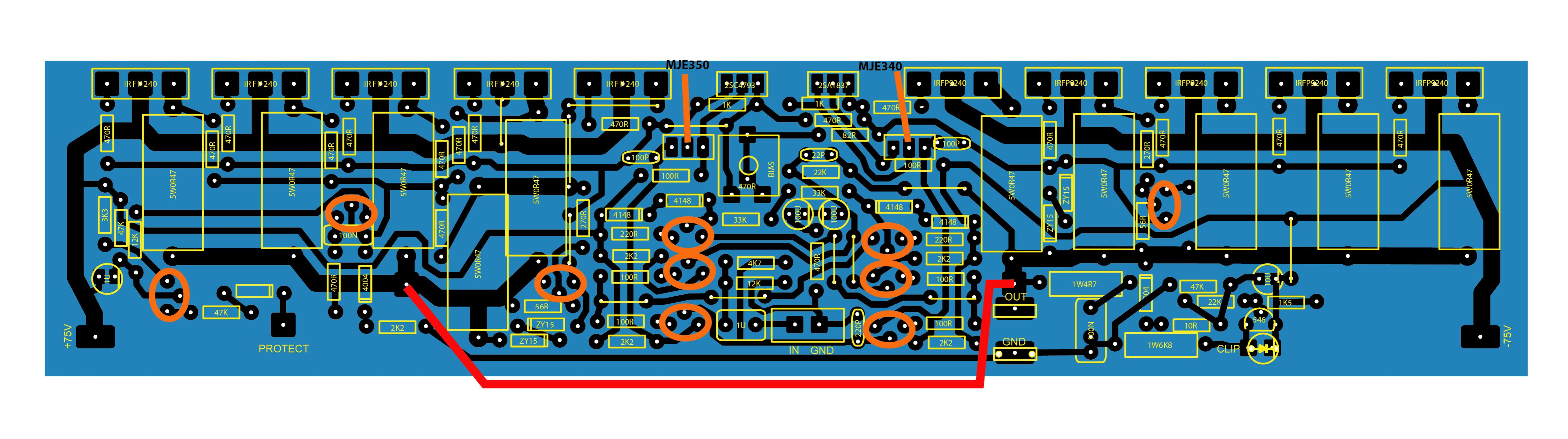

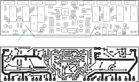

hi apex sir,
i pointed 2.2k resistor place.
in hv23 image in that place one diode have, any mistakes?

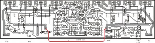

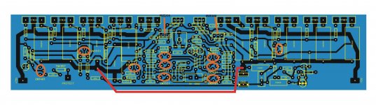

if u can pls share ur hv25 pdf.
i think the latest pcb is hv350.2 am i correct sir?
if u can, pls share hv350v2 in pdf.
thank u for sharing ur hv23.
