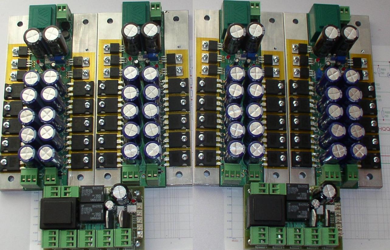

Hi, anybody interested in my PCB work for HV350.2 without the Toshiba transistors. I replaced all the 2SA/2SC series Toshiba transistors with available 2N series. I cont find the Toshiba transistors in my city so i cont comment the performance difference b/w the original apex design and my design.
Just now i finished the design work so i didn't tested that.......
I will post my pictures after the testing now find the attachment ......
Thanks Mile
Regards
Udhay
