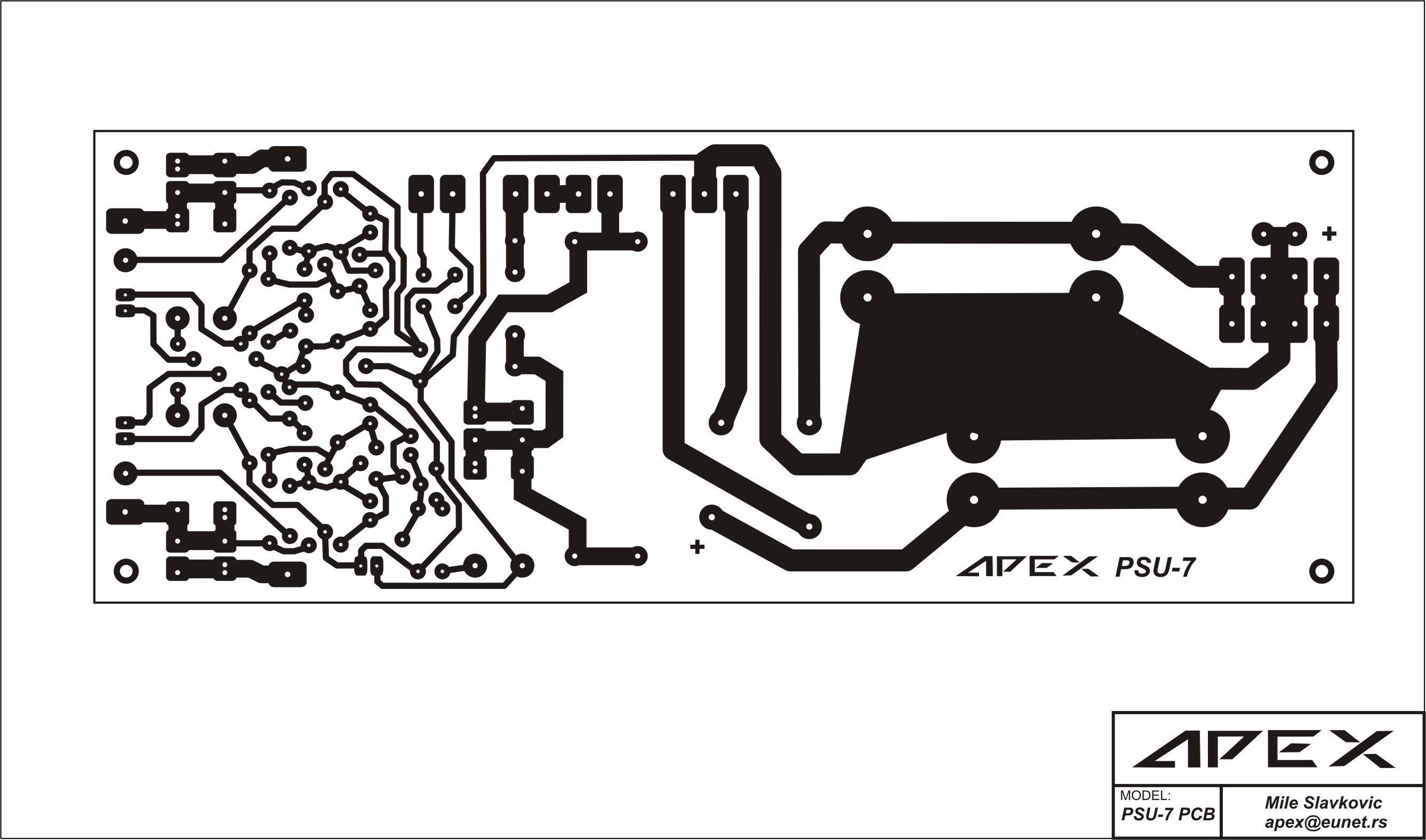

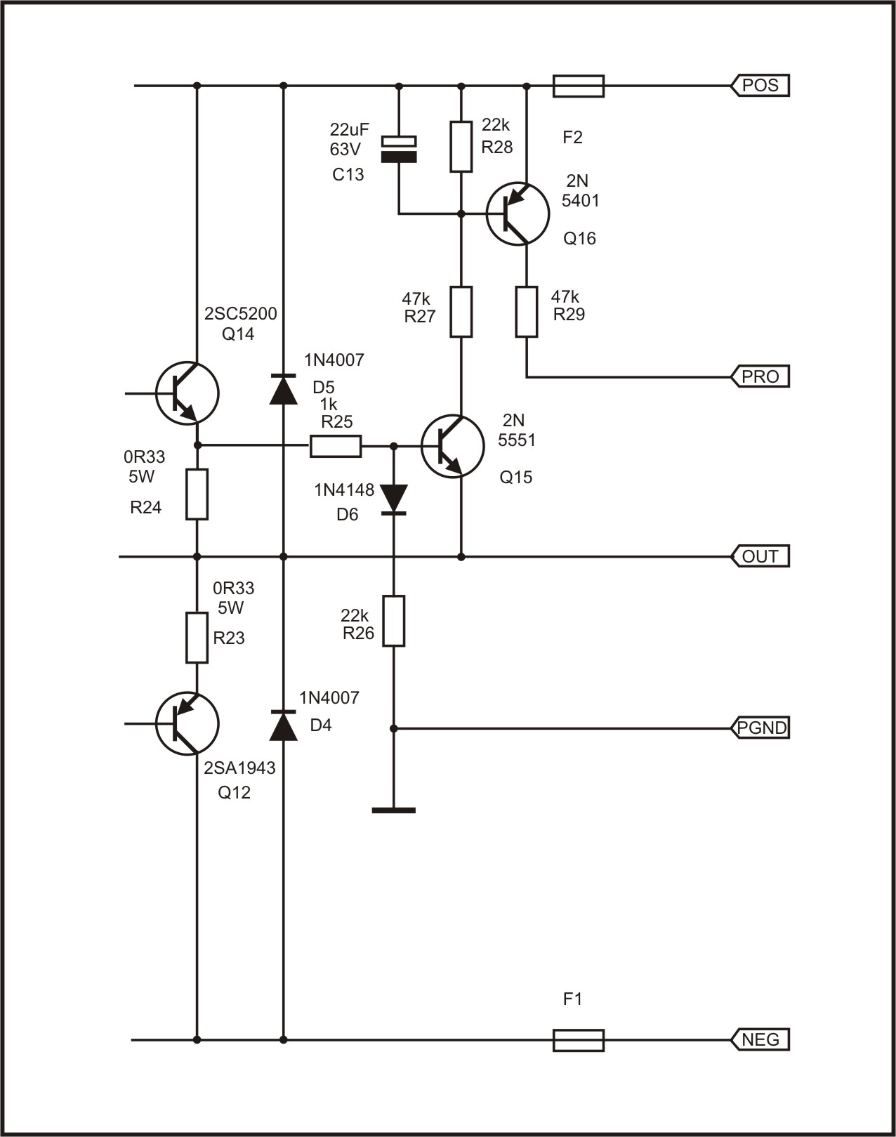

Hey Miles, what is needed to activate the speaker cut on on this PSU-7 design, you say the PRO signal from the B500 does not work....why, can we make a change to the B500 or to the PSU-7 so that is does work....so glad I read this posting...Yes, but PRO signal from B500 will not activate cut out speakers on this protect. Anti-click and DC protection will work. PSU and Soft-Start will work with any amp. I try to find schematics.
Regards
You must change over current detector on B500, use this circuit.
Over current detector..
thank you Miles...I had just looked at the original HV23 circuit and saw this detail, was about to compare it to the B500 circuit and see how it could be amalgameted...you are a gem Miles, will now do more work on the PCB to make this fit....my B500 pcb is looking quite busy now..but it is going to work well. thanks to you....ciaoYou must change over current detector on B500, use this circuit.
Can is use this protection circuit for N Mosfet amplifier +/- 85V Rail (quasicomplementary) too ?
This circuit can be use with any amp, just 5W resistor must be 0,33 ohms.

Hi Apex posting #383
protection circuit is different from this schematic...
Why does you using 5 x 470R to Q22
does protection work with 1 resistor to Q 22 like in #383 http://www.diyaudio.com/forums/soli...mplifier-irfp240-irfp9240-39.html#post2476177 too ?
Finally: Is it possibile to add this protection and clip circuit in quasi complementary mosfet Amp ?
Protection circuit from post #383 is different and can be add to any amp and for quasi complementary mosfet amp also.
