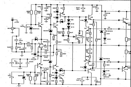

Output seems like mosfet IRf 240 and 9240.
mile is it new ciruit ?😕 seems like all new componets😀
HV23 is circuit from post #1.
Regards

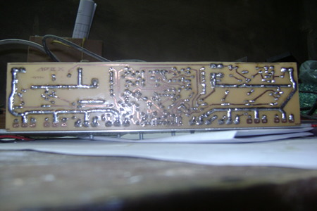

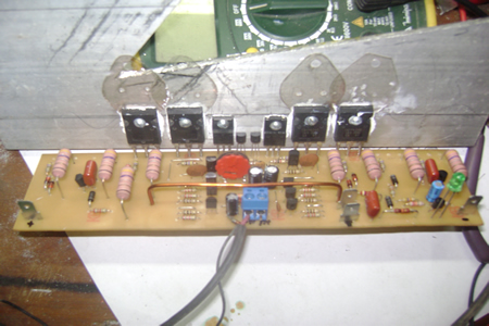

Apex, i back !!!! haha... sory... finaly I can modificate the pictures of my HV350, gooood sound !!!
Nice work, what is rail voltage, bias, speakers...?
Regards
The rail voltage is +/- 80v, I'm not remamber the bias now, speakers I use 4 WPU1509 (450W RMS - Selenium) is a BOOOOOMMMM... but sub-used with this amplifier. Do you undestand me ?
Maximum rail voltage +/-80v is for 4xIRFP240/9240, with 2xIRFP240/9240 use +/-60v max. Do you increase volume to light clip LED?
Regards
I put those modules in the box with good sink, tell me one thing when the clip LED lights, I mean the the sound is bad?
No clip LED light in case output voltage is 12v to rail voltage, amp clip about 5v output to rail.

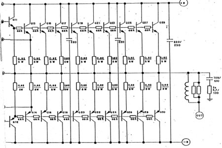

Apex, do you know the "Times One RF802" power amplifier ? Is a big amplifier !!!!
No, do you have schematic?
which is best performance hv23 or hv350/hv25
Same performance only BIAS circuit different.

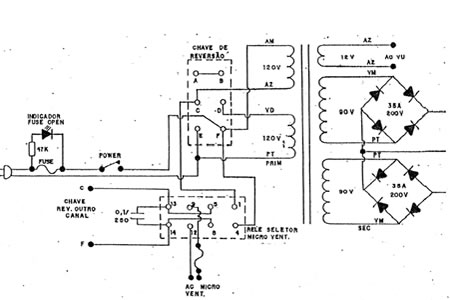

😉Apex, look this!
Thanks for the schematics, but 10 pairs of outputs no thanks🙂
Apex, What's wrong with the 10 pairs? The price of the project? The important thing is that the amplifier is very strong with quality right?
I prefer class H for powerfull amps. For 2500W use 10 pairs and triple class H step driver, like in my VERTEX amp.
