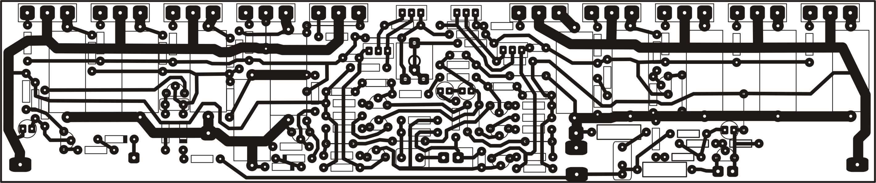

Hi, anybody interested in my PCB work for HV350.2 without the Toshiba transistors. I replaced all the 2SA/2SC series Toshiba transistors with available 2N series. I cont find the Toshiba transistors in my city so i cont comment the performance difference b/w the original apex design and my design.
Just now i finished the design work so i didn't tested that.......
I will post my pictures after the testing now find the attachment ......

On your pcb track from emiter of BC546 (clip indicator) to -75V missing.Hi, anybody interested in my PCB work for HV350.2 without the Toshiba transistors. I replaced all the 2SA/2SC series Toshiba transistors with available 2N series. I cont find the Toshiba transistors in my city so i cont comment the performance difference b/w the original apex design and my design.

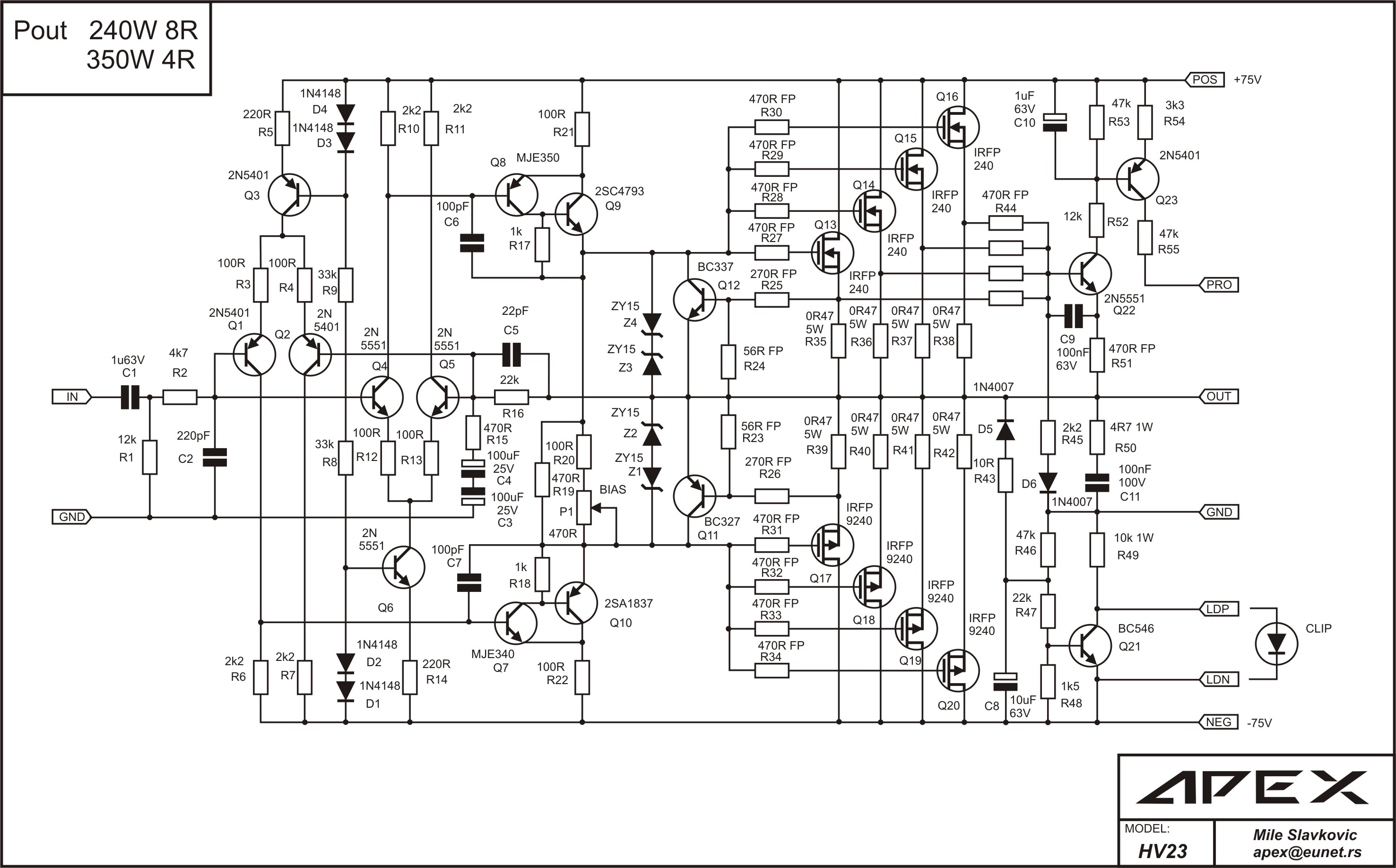

Hi Apex, i dont think your vas is unusal, its a cfp, I use it in alot of my amps, what is unsual is the your temp compensatiom circuit, Im still guesing how it could work.
The thought has come to mind that the cfp transistor that gets mounted on the heatsink has something to do with it but Id have to build it to see the exact effect.
Yes CFP in VAS give temp compensation to the amp, but when amp is hot this circuit reduce bias to almost half of adjusted current: 200mA to 120mA per MOSFET, that is the reason to add Vbe multyplayers with one transistor on heatsink and other not, there is no problem with underbiased. Temp compensation without underbiased can be made with LED in emiter of Vbe multyplayer like in my DC Servo Mosfet Amp.
Temp stability of this amp in usual home aplication is satisfacted, and underbiasing with full power in PA aplication reduce disipation.
Any version of this amp work great, and build it to see effect.

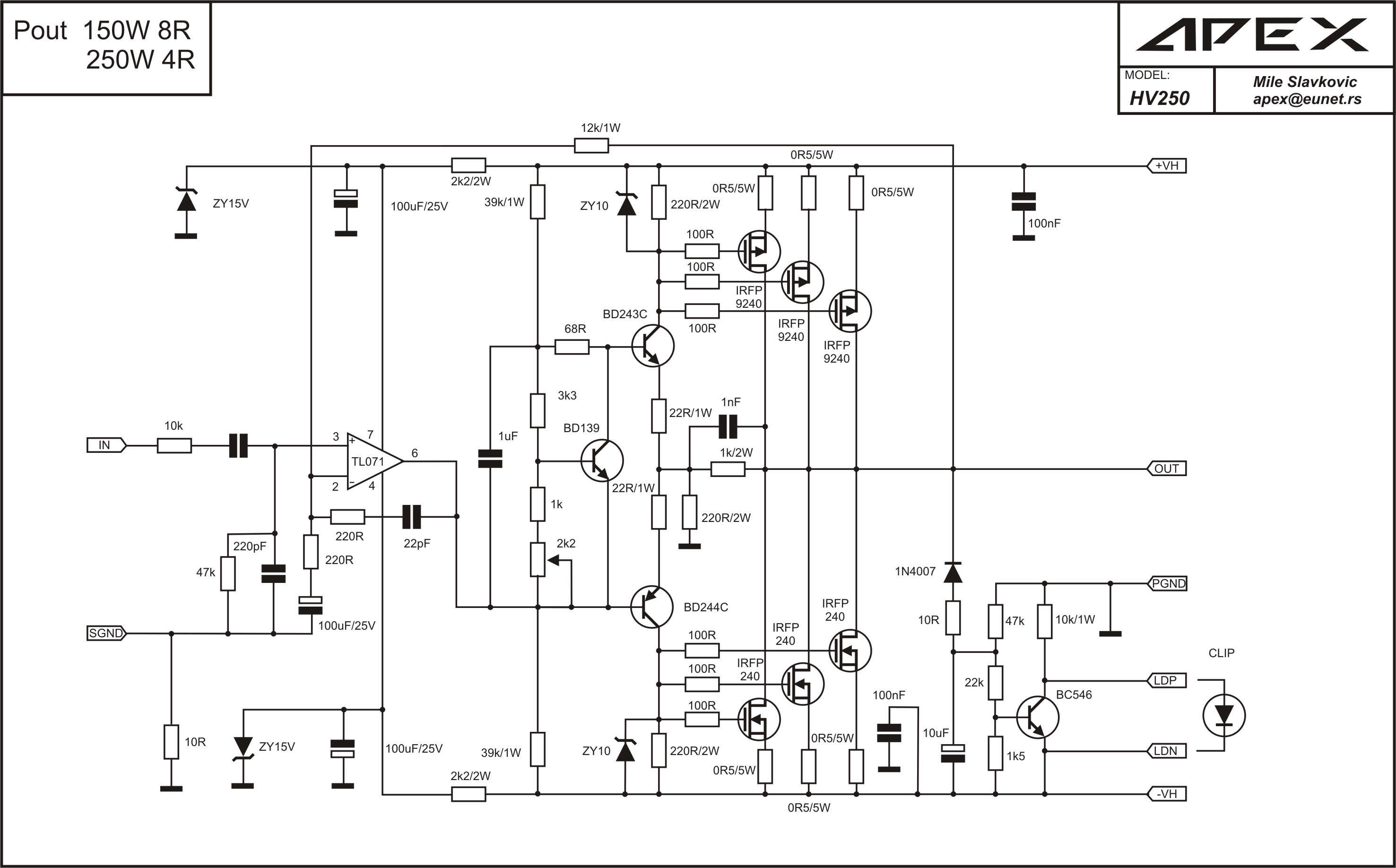

Hello Mile
Do you mind posting the schematics for the OP based version?
Thanks!
HV250 schematic

Do you have a schematic of this? Thanks

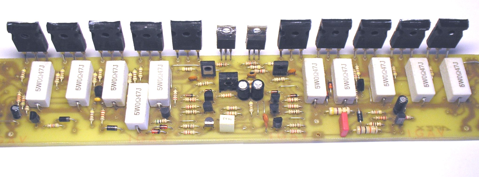

hi apex send the pcd drawing 5pair mosfets
Use this if you want, but I not suggest to use IRFP240/IRFP9240 for that power and rail voltage it's not realable.

Hi Mile,
why did yo say you don't suggest those IRFs for that rail voltage? Is that too high?
How about if we use +/- 67vdc? (or 45-0-45 secondary transformer)

Hi Mile,
Regards.
For safety reason +/-80vdc is maximum suggested voltage, and U can use 4 or 5 pairs outputs.
With +/-67vdc ,and 4 pairs outputs U will have very realable amp.
Regards
