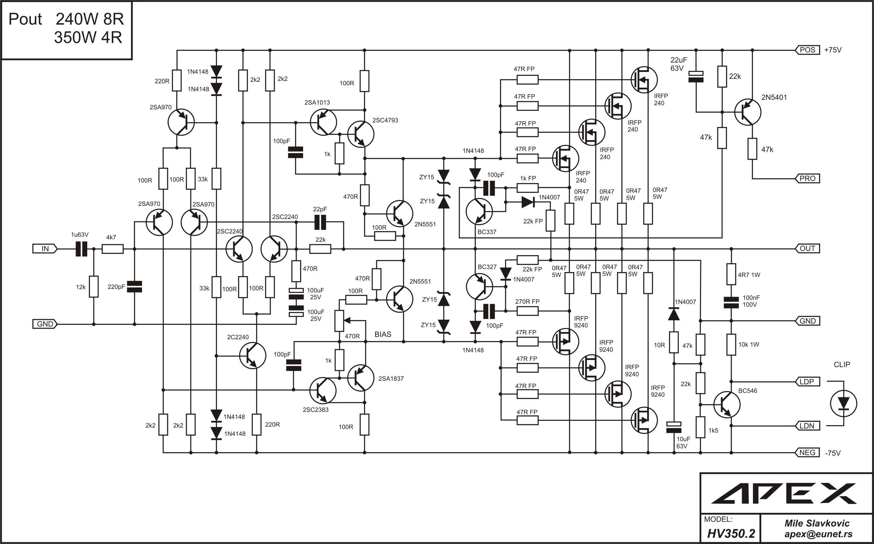

With +/-33V single pair of output FETs is enough, you can see circuit in post #239, and wireing in post #145. Bias adjust to get about 20mV on 0R47/5W resistor. Power will be about 50W on 8R load with +/-33V DC. You can use this amp for any aplication, and I think beginer can build it with my help.

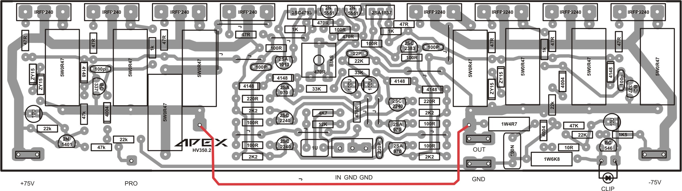

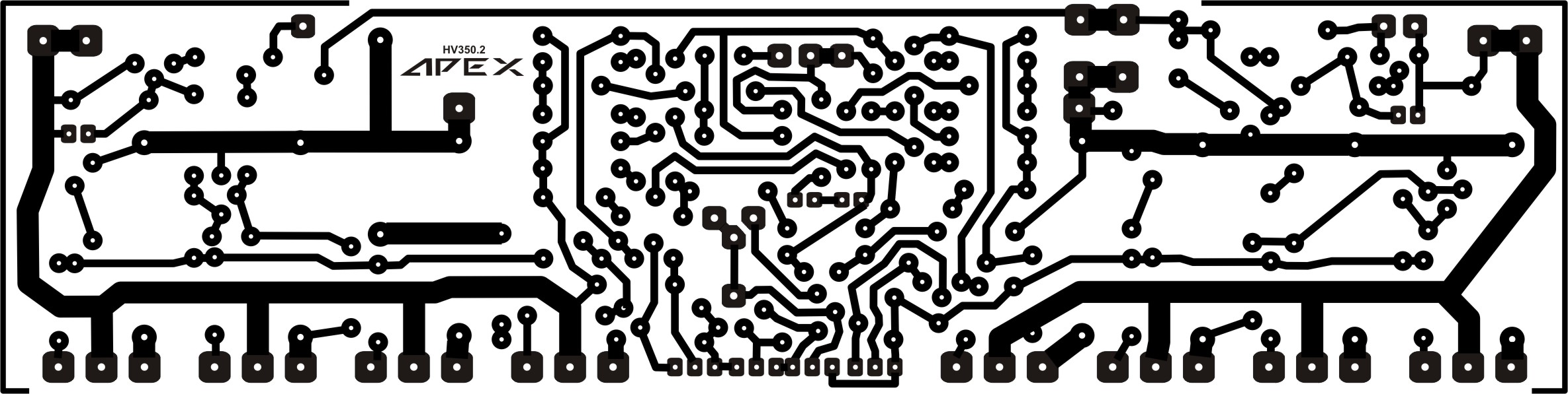

Better buy same number of IRFP9240 and build HV350,Apex, can you look this chematics.
If it is ok, I would draw pcb for this because I have loot of IRFP250N fets.
Regards

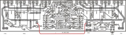

RegardsHi apex, do you have PCB of HV350.2 with cut out protection?
This amp use fully complementary output stage with P/N MOSFETs, you can find amp with QUASI NMOS output stage in thread (post #197):hi apex,.,may i use irfp250n for final TR?in this amp

For NX14 not for AX14,do you mean irfp250n can be use for AX14?
