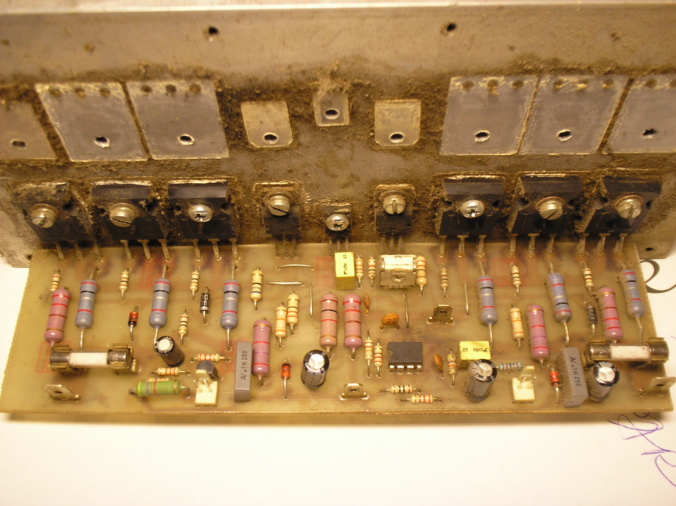

I made version of this amplifier with OP amp in front. The MOSFETs used are IRFP9240 (P) and IRFP240 (N). They are assembled in a common source configuration so they can be completely saturated. Good sound, but audiophiles don't like OP amp in front, I can't change what people like or not, no metter what is the best.

Hello Mile
Do you mind posting the schematics for the OP based version?
Thanks!
I have two OP based mosfet amplifier, and I will post both schematics,Hello Mile
Thanks!
Regards
OP based amplifier useing OP in input stage, not for DC servo like thisHello Mile
Thanks!
http://www.diyaudio.com/forums/solid-state/162081-dc-servo-mosfet-amplifier.html
