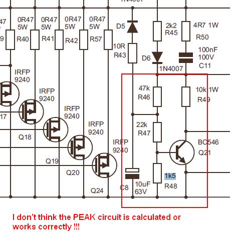

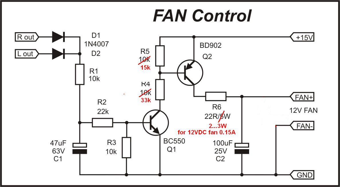

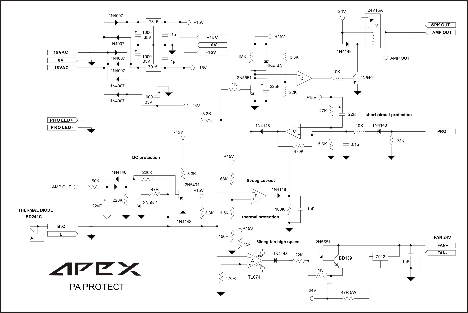

apexaudio, I corrected your diagram above. It's better that way.
And I don't think the PEAK circuit is calculated or work correctly!!
PEAK LED will light on if voltage on amp out increase about 6-8V up to rail voltage, it's correct for me.

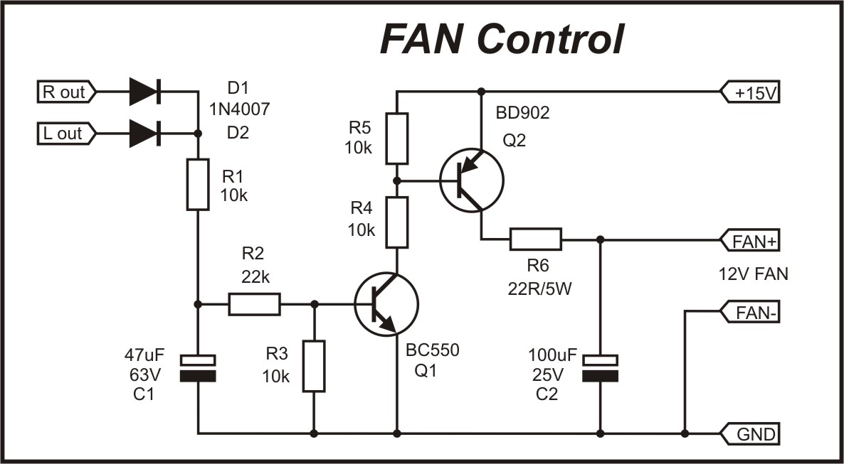

No need to change fan control circuit, corrected or not it will work anyway.

what is this the pro on the schematisc?
Well, Pro is short term of Protection. It's an over-current detector and in case of short circuit on the output, it sends the error signal to the protection board.

Hello Mile,
Could you explain working of circuit in post 383 so we can adapt it to other amplifiers? How is the overload/short circuit detected? What current?

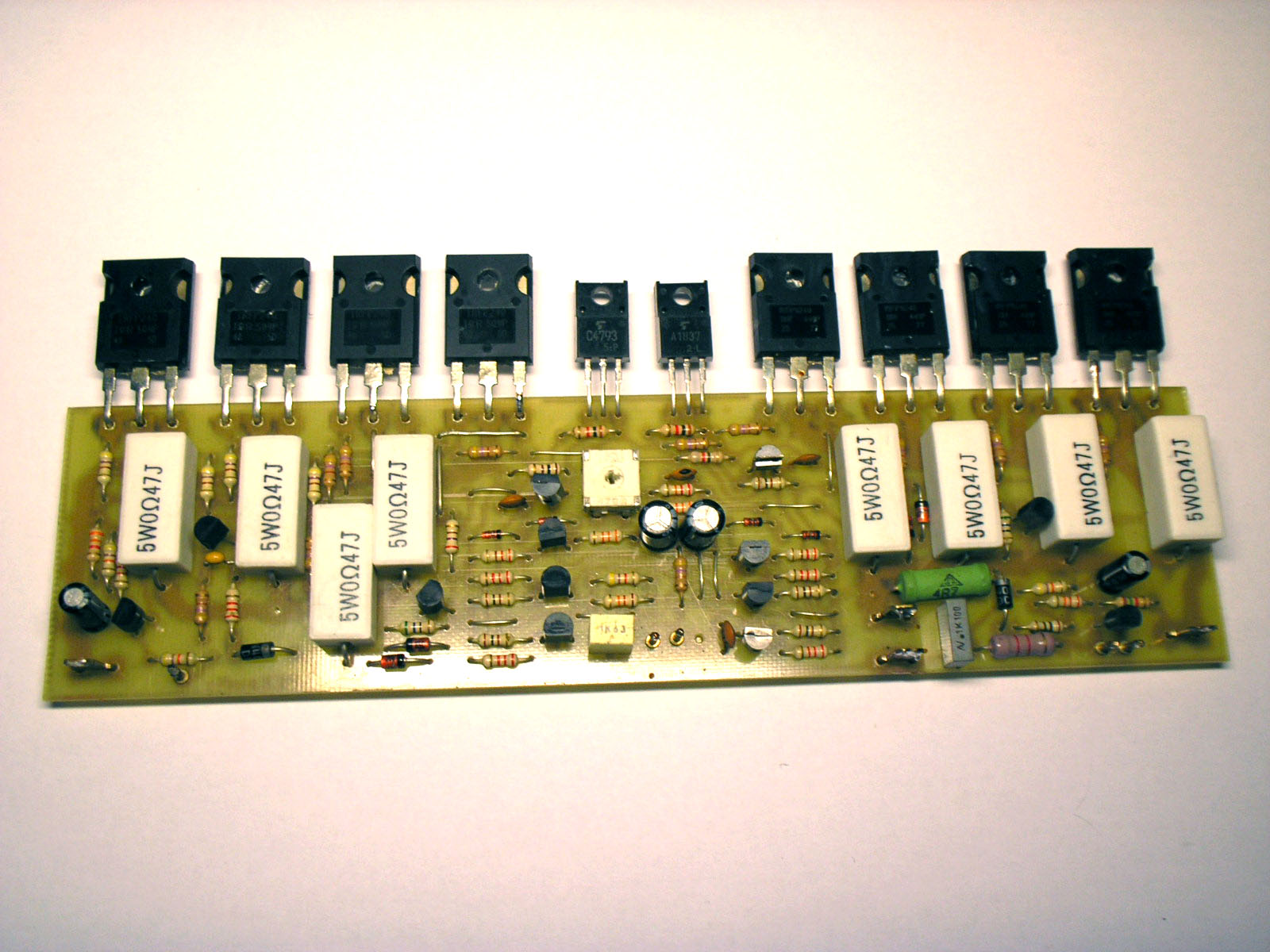

hello, is it safe to use 2x63V for 3 pairs of IRFP240/9240? This should give about 250W to 4 ohms. There is no problem at 1khz and 10khz, but when we go close to limitation at 100hz in 4 ohms, then all IRFP240 burn. Maybe these transistors are fake?
3pr of 240/9240 adds up to ~900W of output devices.
Divide by 4 for MosFETs and you get ~225.
Your target of 240W into 4r0 is close enough to 225 to be considered as reliable.
However, your target of 240W and +-63Vdc do not seem compatible !
I get 300W to 320W from +-58.5Vdc supply rail using BJT output stages.
A mosFET output stage may require upto 5V more on the supply rails to achieve that 300 to 320 target.
But you are showing a target of "only" 240W from supply rails that are 4.5V higher. That seems odd.
