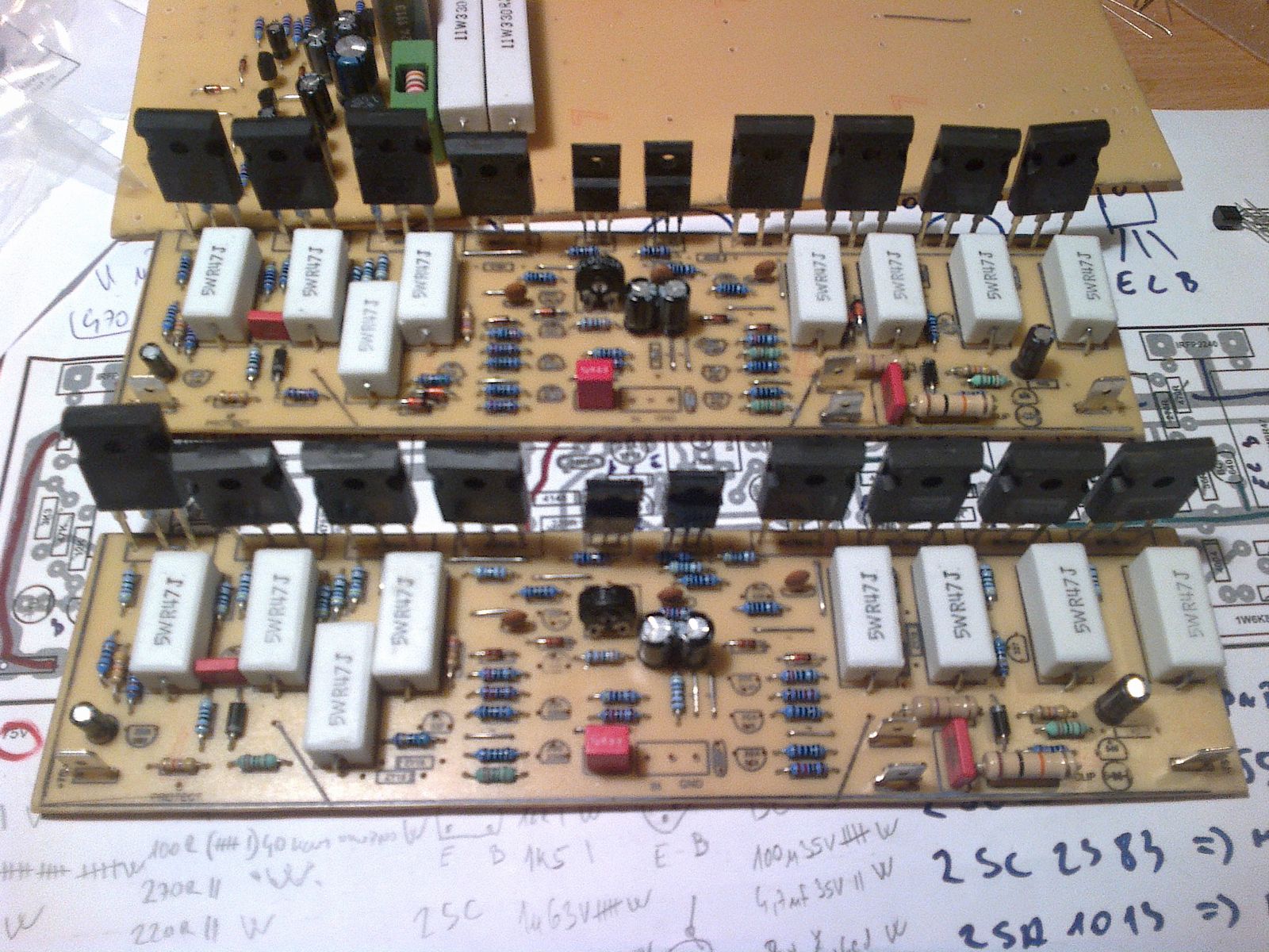

Hi, do you actually make this pcb's?Simple Full Complementary Simetry +/-80V. Voltage amplifier/driver biased with 30mA. This driver circuit stabilized BIAS in output stage. Exelent stability without oscilation, hum and noise, sound great.
RMS Power: 240W 8ohm, 350W 4ohm
And if so, would you sale them?
I have few questions about this design:
If I want more or less power i just need to add or remove amplification degree(i'm not sure how it is really named in English.. ) of mosfets?
How can I calculate needed power supply voltage for this amplifier if I remove or add another pair of mosfets?

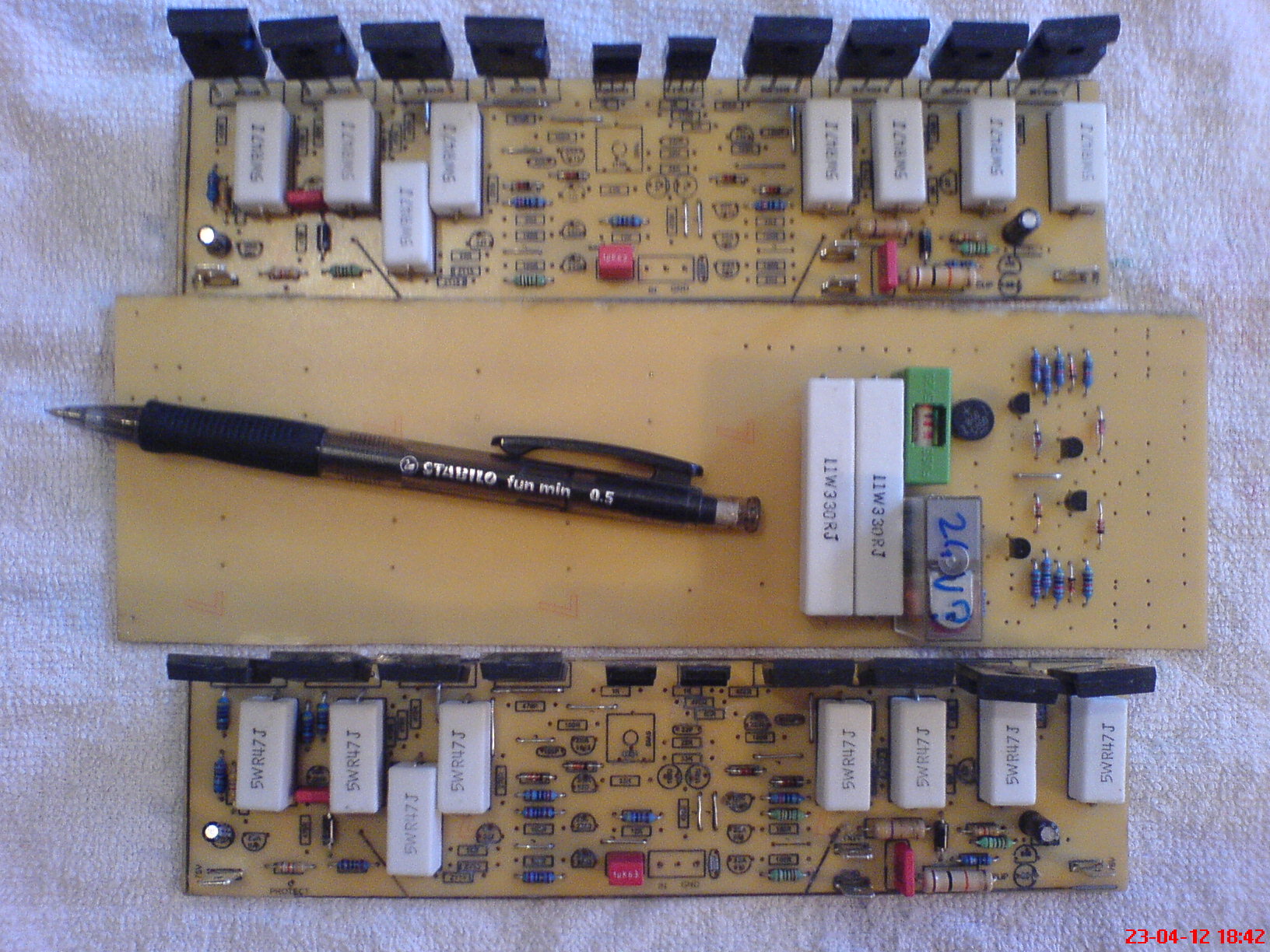

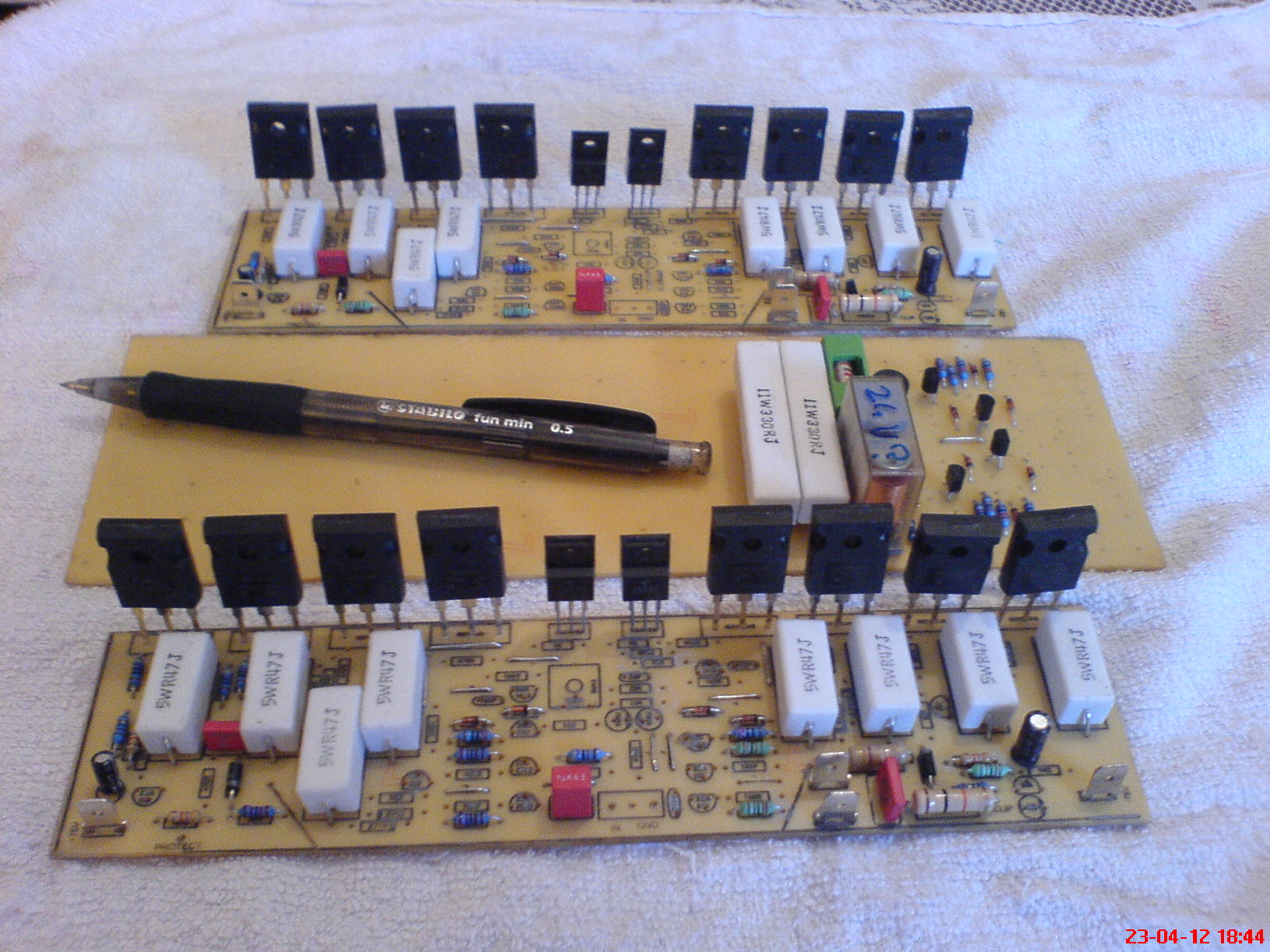

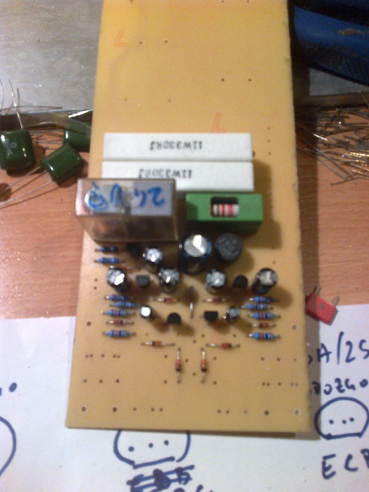

It is going to be something like this:
Nice work, that will be valuable amplifier, thanks for shareing.
Regards

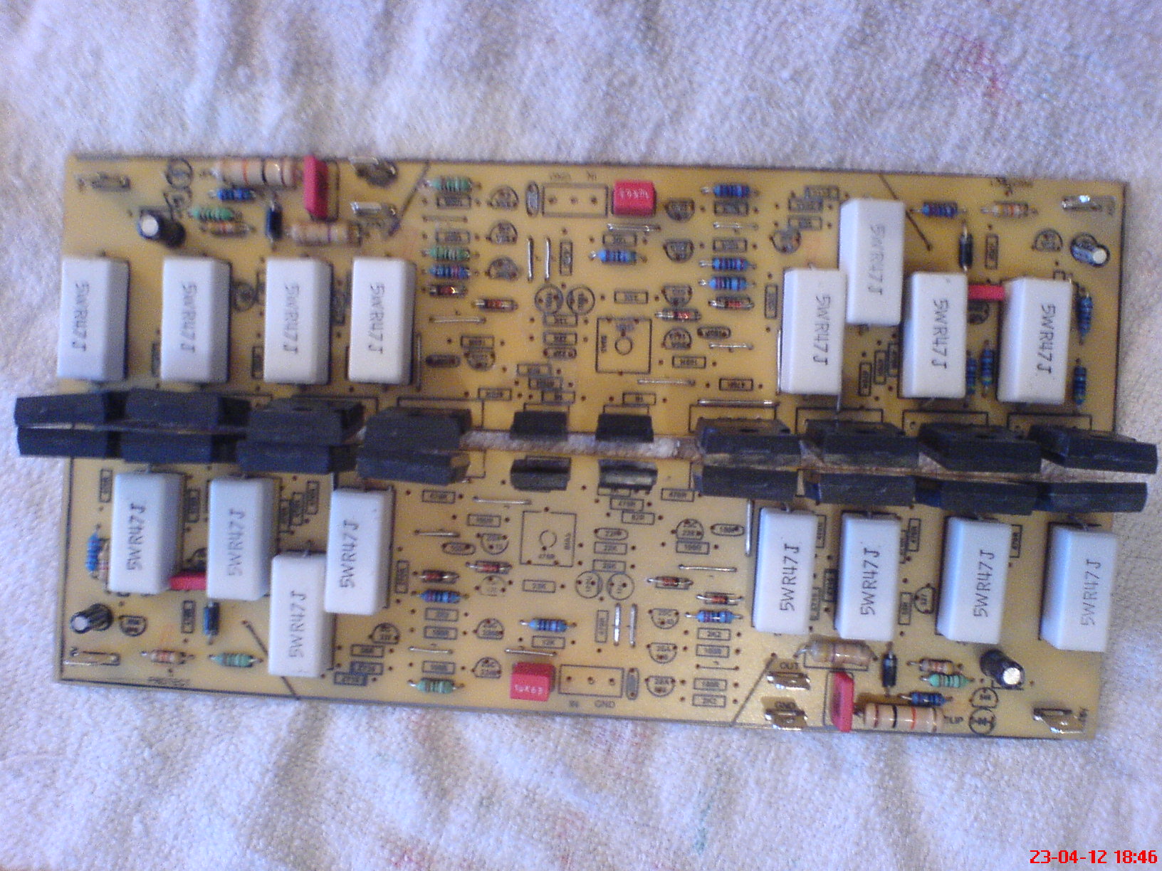

some more pictures...
Heh,THANK YOU for sharing all this with us! 🙂
One thing must be considered,and that is if anyone uses *2N5401/5501 MJE340/350* than must be careful with pin-placements because the pcb was made for *2SA-2SC* combination with BC639/640. BC327-337 that replaces BC639-640 also has a different pin-placement,so be aware...

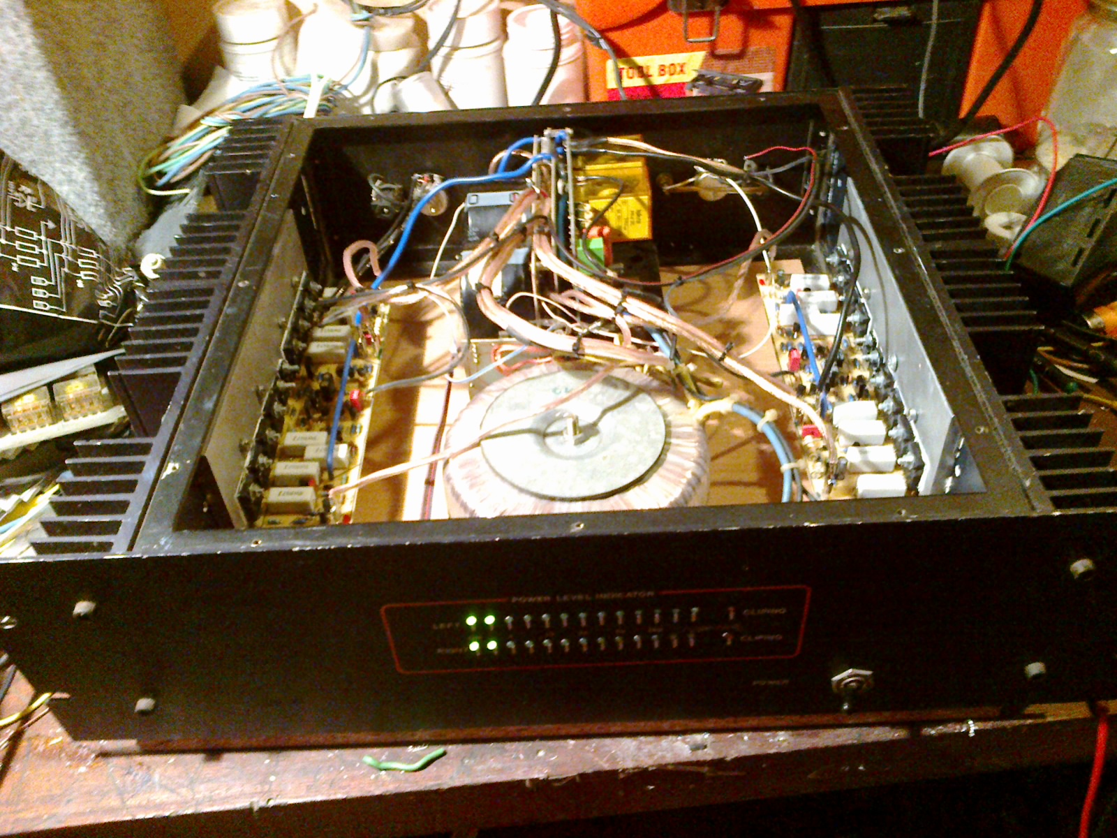

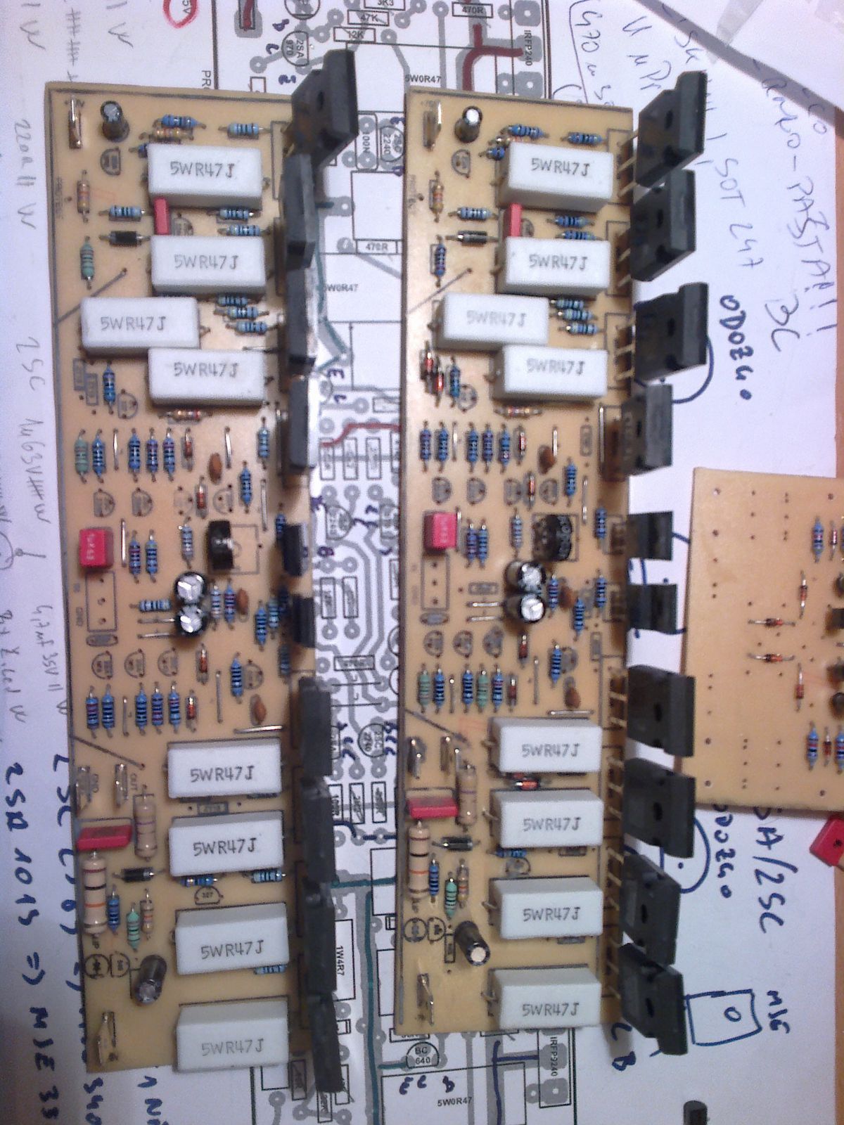

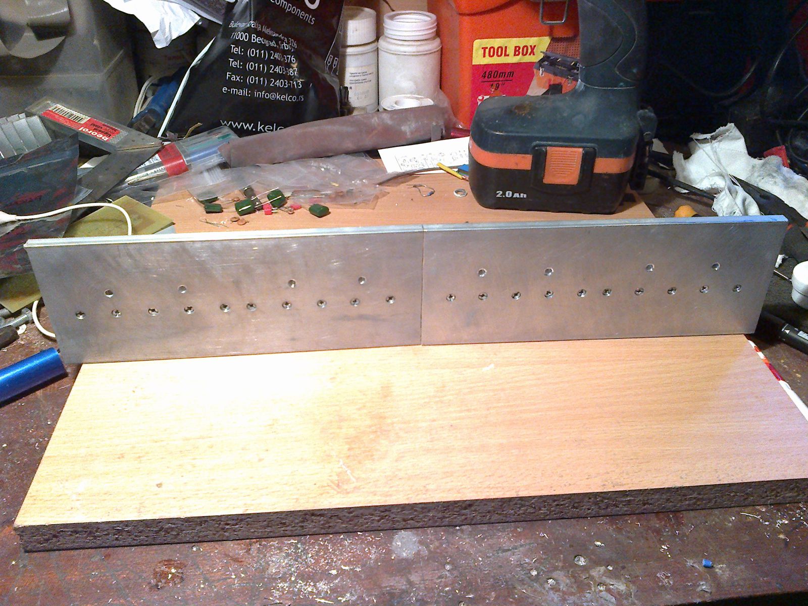

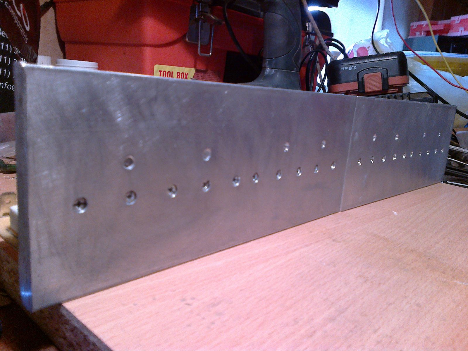

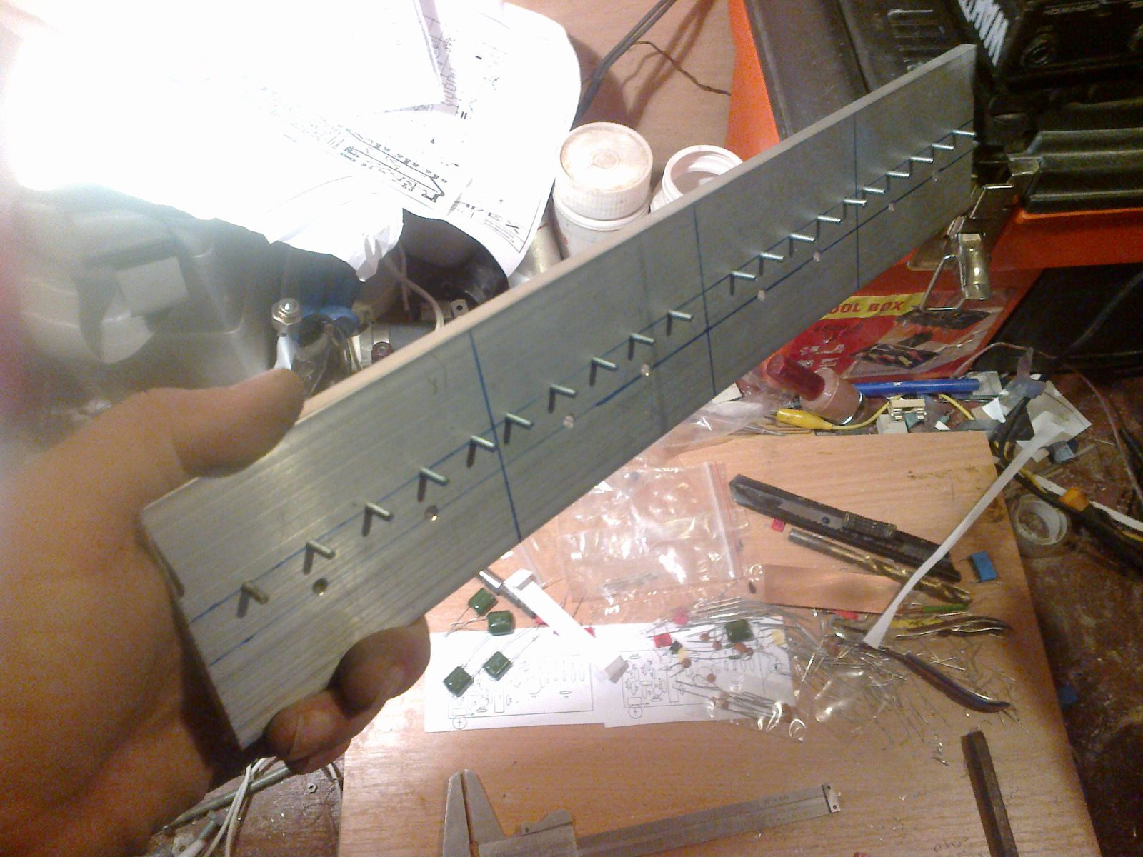

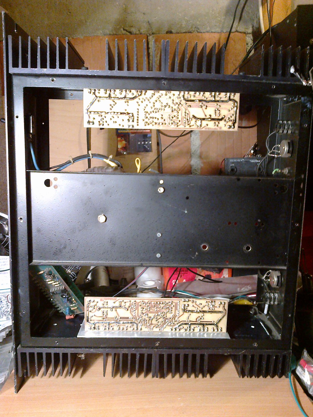

Some pictures from tonight:
Regards
Power Amplifier
So, do you have this for sale? fully populated or bare pcb's?Circuit diagram work good even in PA amplifiers. I made over 120 PCBs in last 5 years. Beginer with basic expirience in DIY can easy made this amp. Usefull not only for hobby.

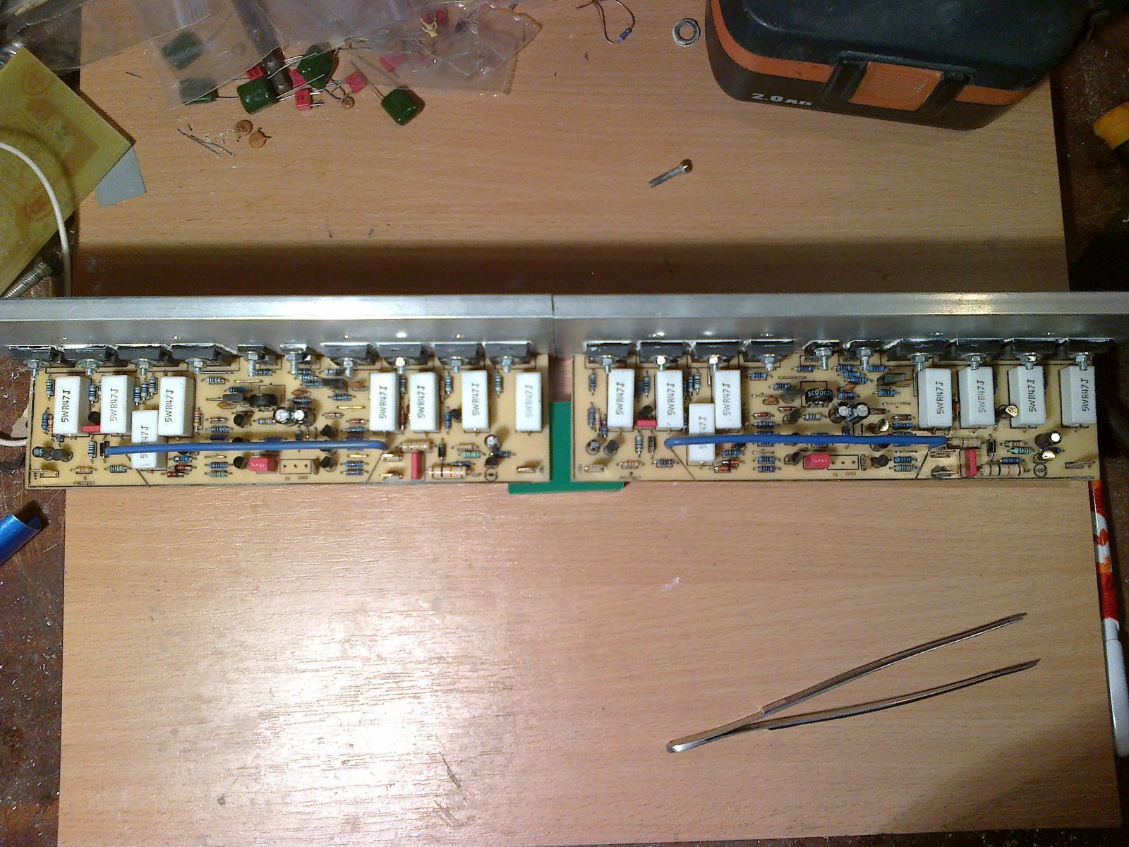

today...

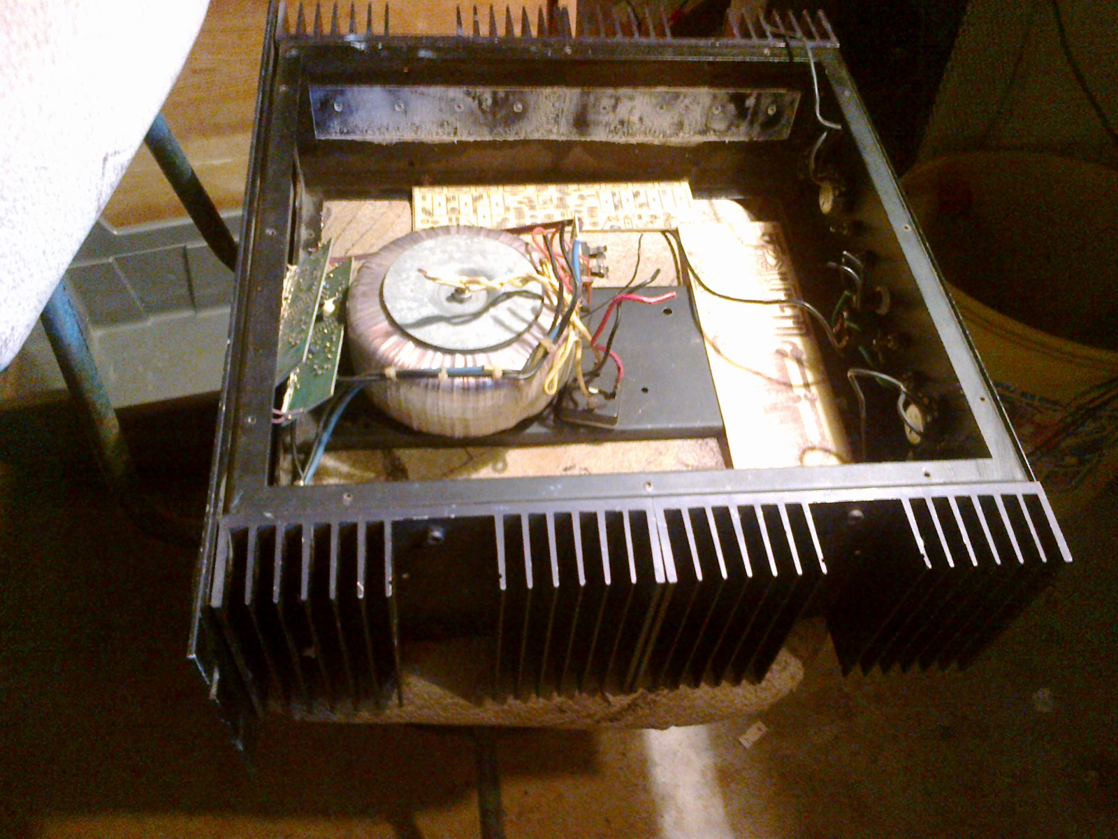

Did something today,here are some videos

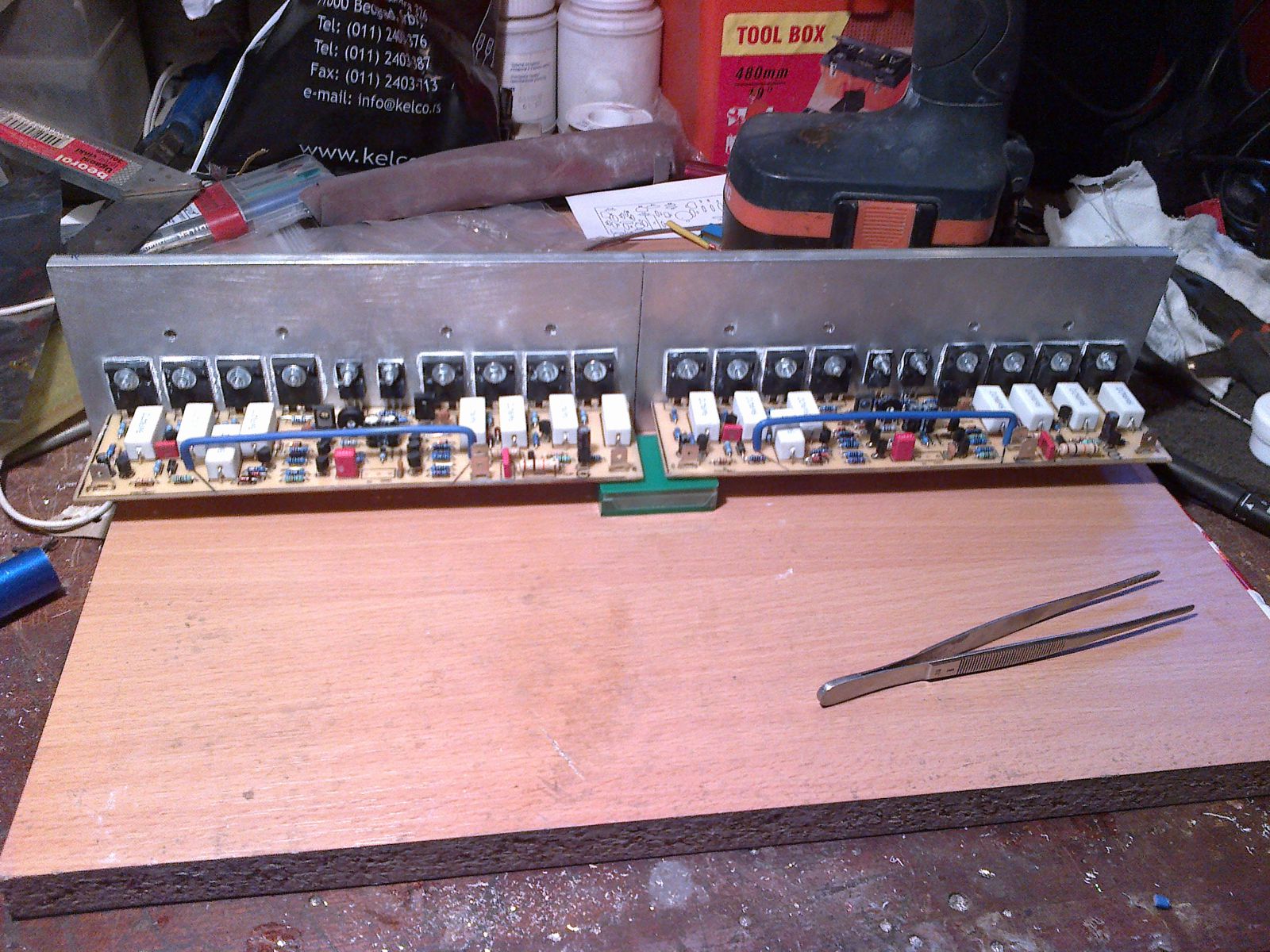

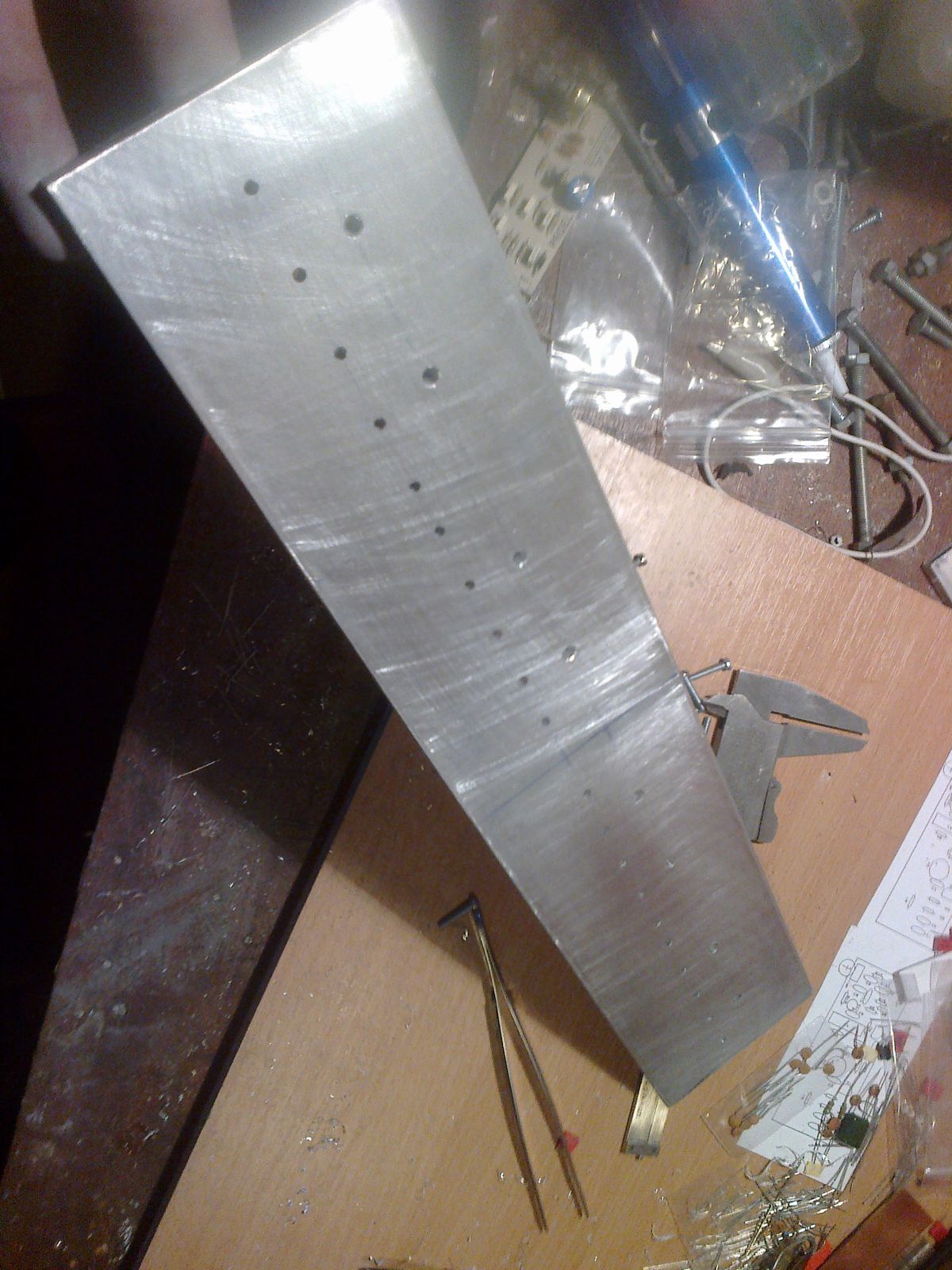

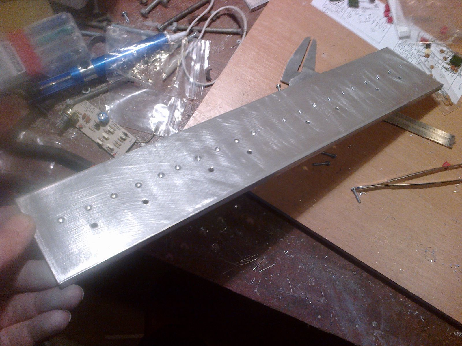

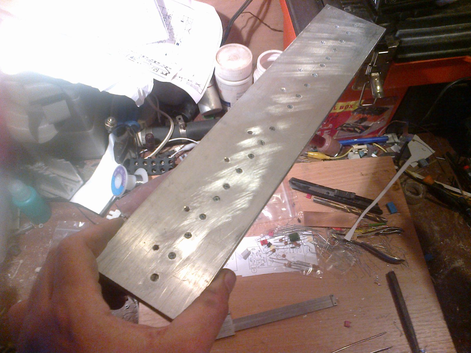

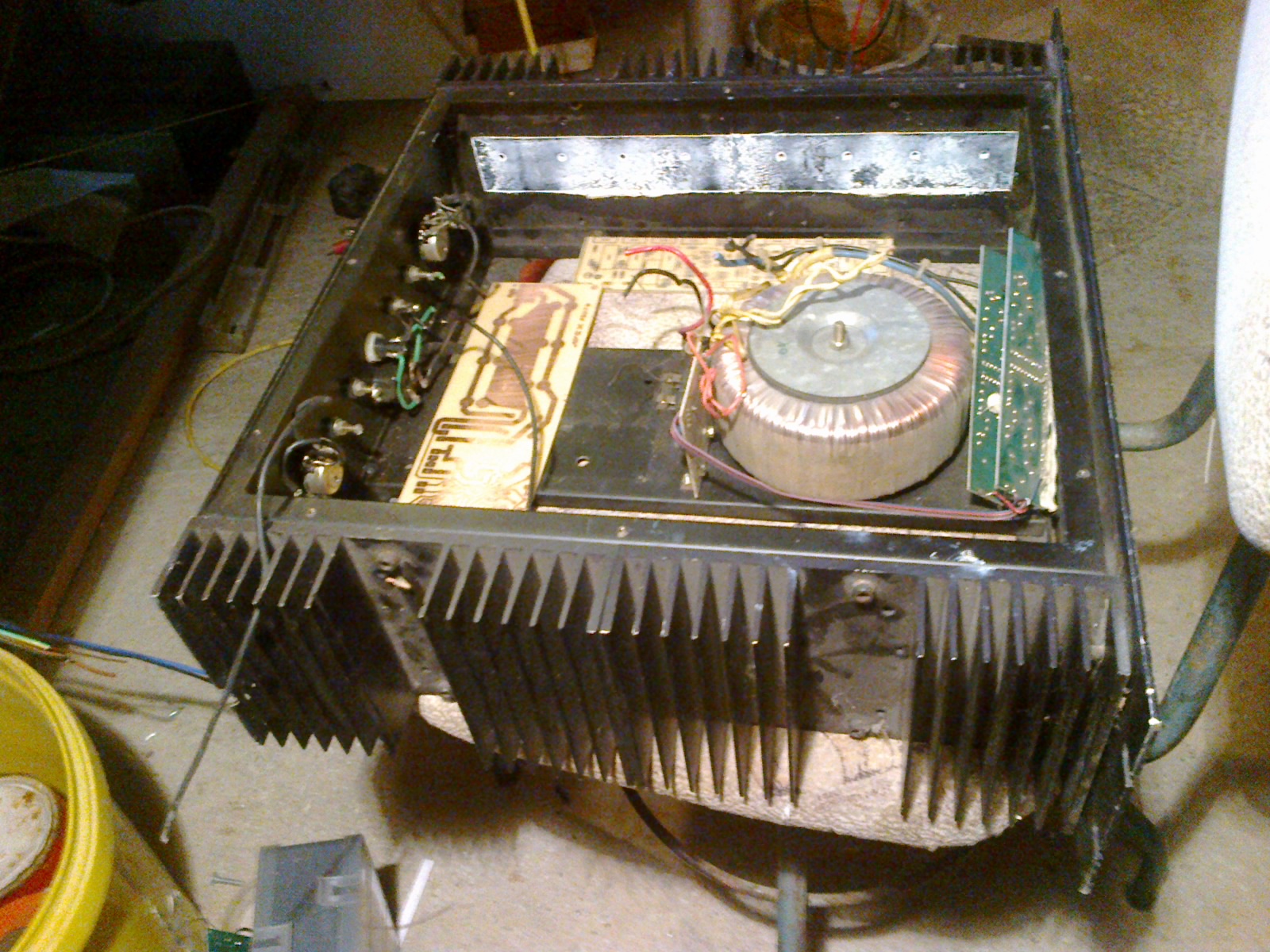

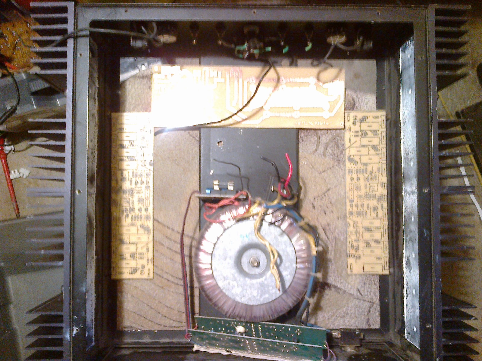

pictures before and after mounting on a heatsinks:

It actually sounded clear all the time at all volume stages.
Now i see that microphone on camera has eaten most of high sounds and that was happening when the amplifier was at loud,when i lowered volume the microphone was able to pick up sound pretty well. Nothing strange,all that sound in a 40 square meters... First time when i get a chance to use it on an open field i will record a new video and than it will be possible to see that the amp does not wreck high sounds. It sounded clear all the time at all volume stages.
