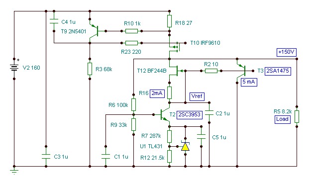

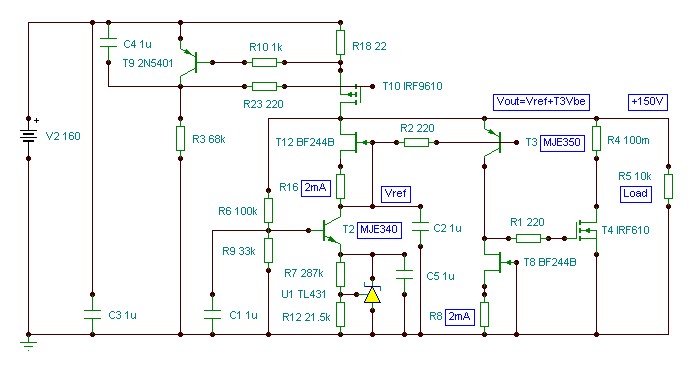

That would be suitable place for using two-bjt-transistors Zener-substitute (which I used for instance for 100V)
This is pretty much conceptual. I have some problems with choosing devices and bias current.
I would not fight for very high stabilization factor, the simpler shunt PS solution - the better pulse responce, which is of the top priority here. From this point of view, I consider the popular shunt PS by Salas as a bit misconceptual for audio purpose.

Ripple suppression is not a problem, simplest virtual battery and its done. All difficulties start from the need in good pulse responce, i.e. "ripple eater" must be extremely fast, and simplest parametric shunt reg with a Zener or LEDs provides possibly best pulse responce.

For instance, the nominal dynamic impedance of TL431 is 0.15 Ohms up to 100 kHz.

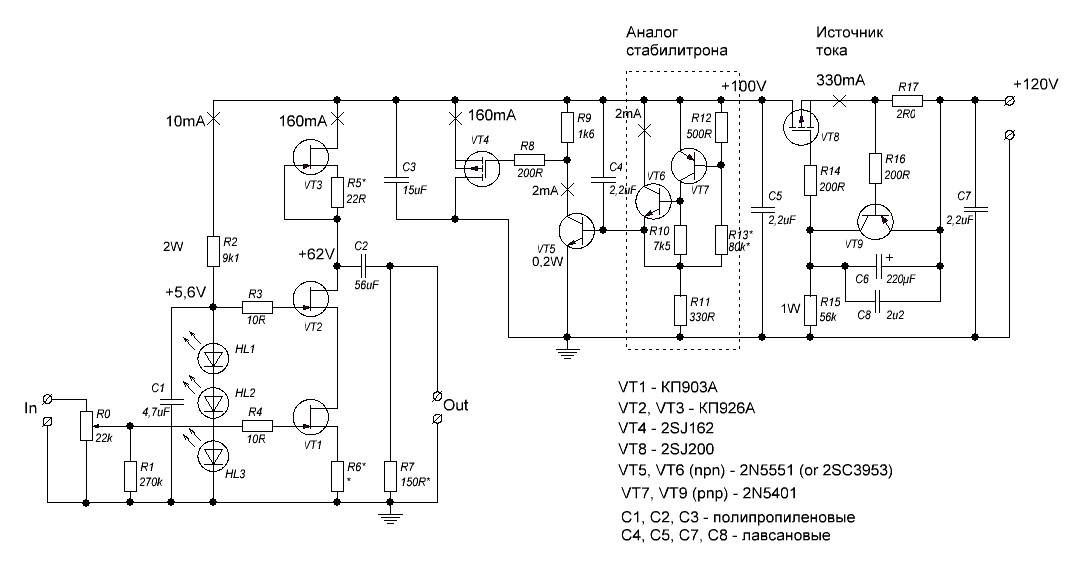

GoranB,
can you see the difference between Ciuffoli`s way of biasing and mine?
Honestly i dont understand the circuits in that level to notice differencies of biasing. All I can notice is that You are using Ic and several active devices for biasing. The biasing implemented in Andrea's circuit looks more simply. The advantage there according me is virtual battery circuit.
Anyway, in his confusion about signal route, signal ground and electrolytic capacitors, Ciuffoli came up with a substandard biasing method and power supply, constituting bottlenecks for the Follower-99.
