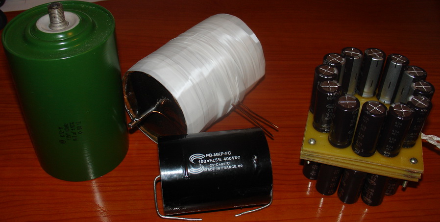

These are my toys that I am playing with now. On the left side - 4,7uFx125V teflon capacitor, it is manufactured for power industry, for passing very large high-frequency currents through it. I have taken them out from the metal case, and even without it, the weight of teflon cap maybe 5...7 times more than 100uF polypropylene one. I wrapped it in natural leather (good vibrations damping material), then in teflon tape. It measures excellently, but when I used it as a shunt cap, the effect was very small, 100uF polypropylene gives much more noticable sound improvement.

One reason why polypropylene is good for capacitors is the fact that it is stretched before the metalization...then after winding they can be baked and thus form a mechanically solid body....this is not possible with teflon and thus they are more loose in the winding...And also bigger as teflon is no so thin...so the plates can't be as close together...and thus they have to be larger...Tinfoil is the only foil that can be cut without edgeburs..so that is good with polypropylene film...copper foil can be sharp so it needs some thicker material..and thus grows bigger....bigger means also more inductance and less high frequency performance...
The drawback with metalized polypropylene is that the plates are so thin that they don't conduct very well...typical less than 1 um thick and not very even..This is tha same also when the metalization contains copper silver or gold.. The layer is much too thin for my liking...A reason why its kept so thin is the self healing aspect... which means that the film pores that causes DC leaks can be burnt away with a high voltage chock...
To me the best compromise for audio is the tinfoil/polypropylene caps...as plates conduct better and the foil is still thin..Some may think different...and my preference is from making loudspeakers..so I may be wrong when it comes to electronics...though the cap here in question is for loudspeaker....🙂
I can't say about Solen...I use the Mundorf tin/foil in my loudspeakers. And for my application I still haven't found any better...regardless of price...

Polystyrene caps have absolutely nothing in common with paper caps, and polystyrene film caps is generally recognized as being superiour to polypropylene. The only problem with them, similar to teflon, there is no big enough uF with polystyrene, usually less than 1uF.
Referring to what MiiB has pointed out, it seems that polypropylene has no alternatives in Solid State designs, for PS and output caps, since somthing less than 20uF has almost no effect on sound. Those 0,1uF put on PCB power traces, I think they only help to make circuit more stable.
