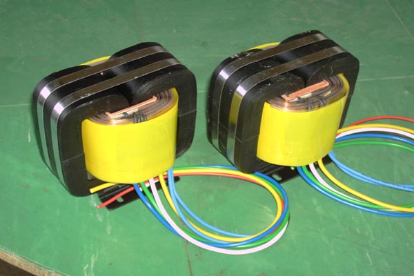

It seems that Goldmund's designers make a point in using paralleled parts. Concerning caps the subject is clear, but what goes on with trafos?
The Telos 600 achieves its very high power from ten separate high-speed transformers and 40 specially designed ultra-low-impedance capacitors."
