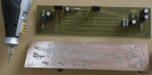

here is my approach for the Andrea's original version
pcb created in expresspcb
"etched" with a minigriner in 20 minutes
partly assembled, watch the place for parallel output caps🙂

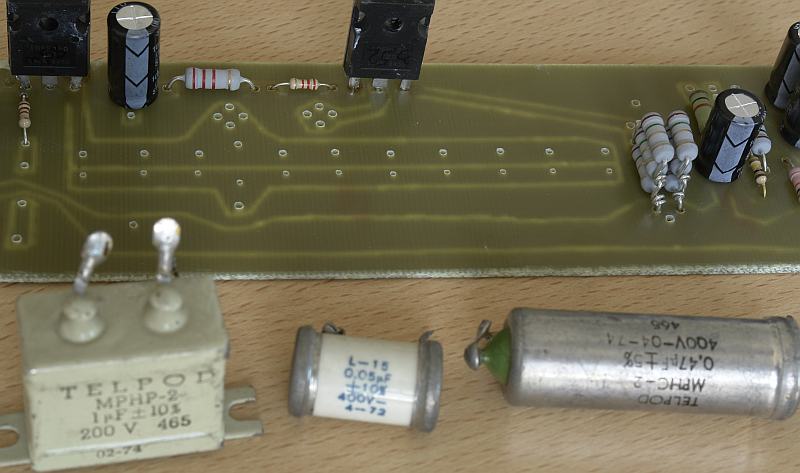

I would suggest you to consider Wima MKP 22uF polypropylene caps, seems possible to put 3-4pcs of them from the copper side.
I have paper in oil caps - it would be a bit of hard to mount them, but...
here are the possibilities.
You can see paralleled 1,5 ohm 2W low impedance resistors (unsoldered) for 1,5/3A switch.

Those paper-in-oil caps (if we speak about not too expencive high-end parts), they kill sound details. I have bought and tested various kinds of them, voltages from 160 to 600V. They affect sound similar to ordinary electrolytics. Now I have nearly 10kg of them, without use. Strongly not recommended, better wait a bit for decent polypropylene, in order to avoid dissapointment.

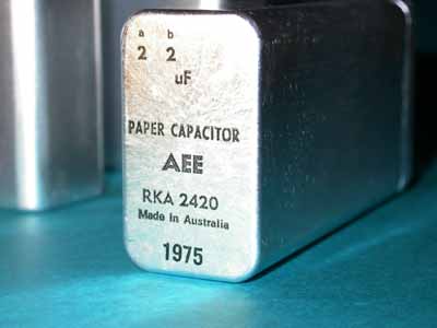

Ups, my mistake. They are not PIO but paper capacitors.
Add/Edit:
Small size paper caps (pF) are well known to give enjoyable sound. Many good sounding commercial amps are using them. But they are also known to give "unnatural" sound. I don't know about "natural" highs, but I love them. Cheap, but who cares. The big size paper caps (uF) that I use in crossovers also give the same effect. Airy, enjoyable highs.
