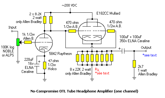

100Hz square signal on the output on my tube preamplifier looks awfull, a triangle shape, does anyone knows the reason for that? I measured also the comercial product the push-pull topology Marantz PM44SE on 100 HZ square signal, little better but far from good.

In my previous post I attached the circuit of tube preamp im using, the comercial product im keeping just for comparation. Anyway i should try to encrease the value of output caps, and add some mkt in parallel.

I would omit the E182CC stage.
You mean just to use a gain stage? As You know the E182CC stage works like catode follower lowering the impedance, so i think its crucial stage to drive ans SE PF99. Ok if i omitted it i should add an capacitor on the output of the gain stage, so, ill have the worst situation...i think.
